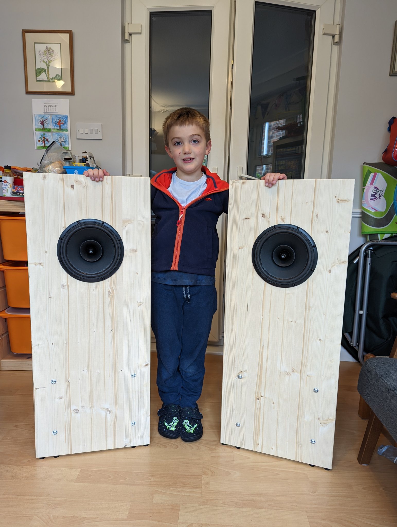

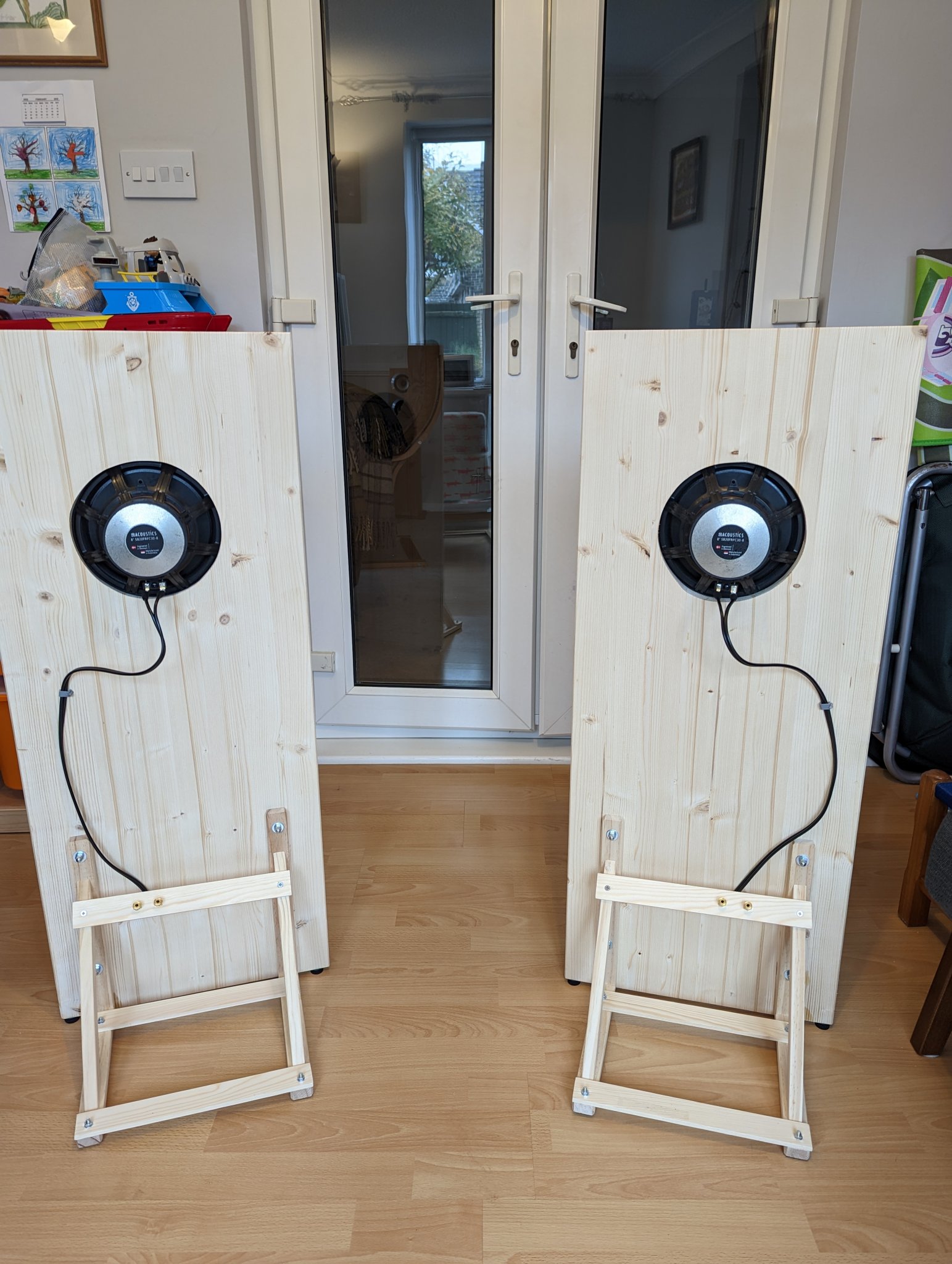

My son and I made an open baffle set (out of curiosity) from these drivers before I make the 'proper' speakers next year. Baffle dimensions are 40cm x 100cm by 18mm thick using solid pine. We started building yesterday and by this morning had a pair of functioning speakers - they have been running in since then.
I'm impressed TBH - a lovely 'floating' sound with good stage depth,
clear midrange and the treble certainly isn't lacking. Bass is a little 'thin' but fortunately the Arcam A18 I am using them with has excellent (no downside) digital tone controls and a +3 out of 8 bass lift sorts out things nicely - will be interesting to see how the drivers settle over the coming weeks.

Nice. Since this setup is temporary ... if... you're interested in experimenting I would cut them nearly in half and put the driver much closer to the floor and tilt them back say ~10 degrees. I think you'll get better bass response that way via floor/room effects. If it sound better you could use the cutoff pieces to glue on and double the baffle thickness which may help a bit too given this wood looks like low density and probably resonates some.
It's counter intuitive the have the driver NOT be closer to ear height - but reports are it really works better for OB's to have the driver closer to the floor.
Perhaps a seemingly cooky idea is to just lay the speakers on their sides and tilt them back somehow, if possible.
That might be TOO close to the floor and sound bad, but it's a no-effort and reversible experiment.

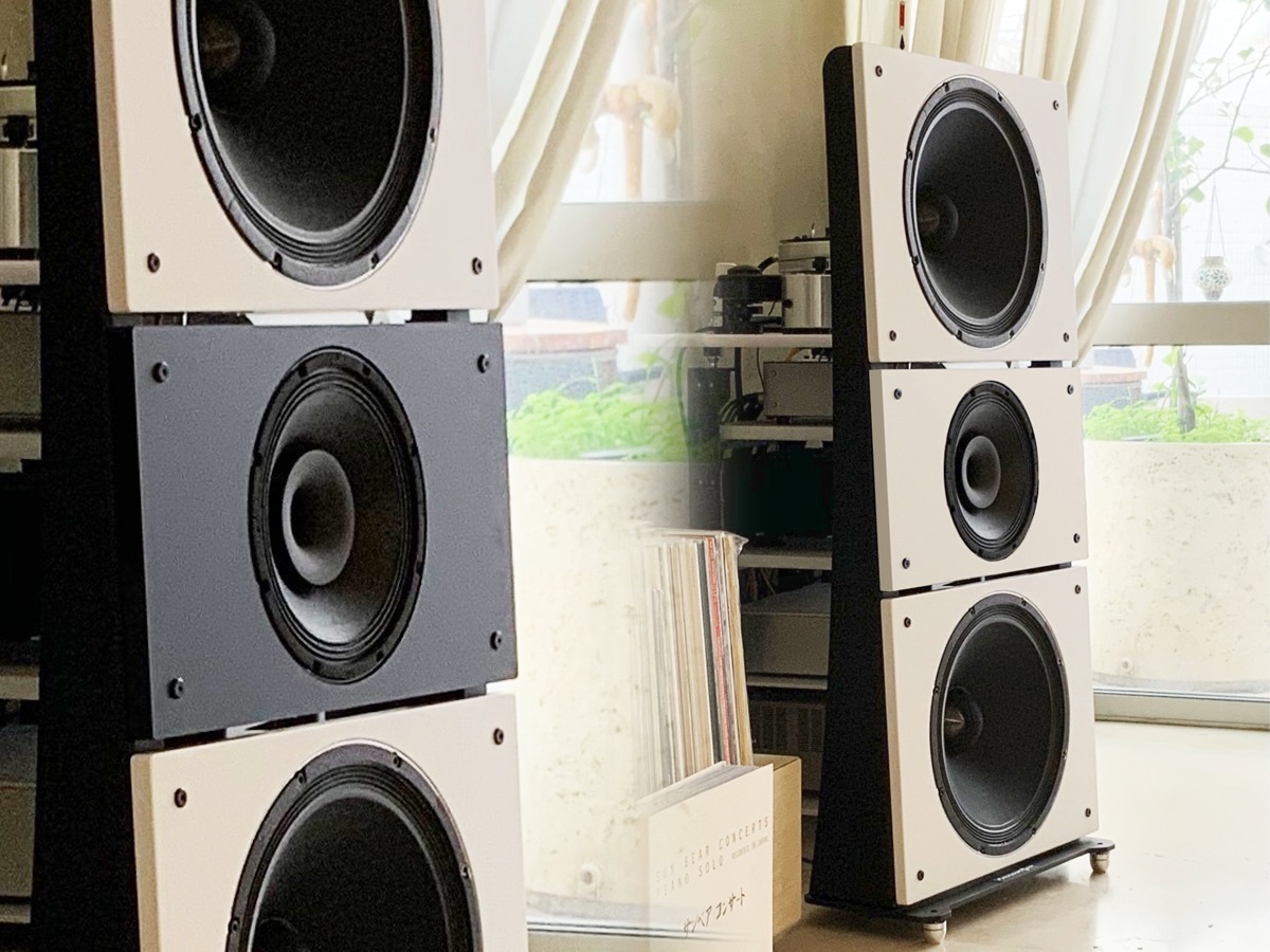

you mean something like this?
Thanks for the info and ideas. I plan to add a frame at the back of the main panels which should stiffen the baffle up and hopefully reduce any resonance. I will experiment with putting the speakers on the sides to see what effect floor reinforcement has.Nice. Since this setup is temporary ... if... you're interested in experimenting I would cut them nearly in half and put the driver much closer to the floor and tilt them back say ~10 degrees. I think you'll get better bass response that way via floor/room effects. If it sound better you could use the cutoff pieces to glue on and double the baffle thickness which may help a bit too given this wood looks like low density and probably resonates some.
http://jelabsarch.blogspot.com/2012/06/open-baffle.html
Incidentally I played about with REW a little bit last night and the bass actually has a bit of a lifT circa 50hz and the bass control on the Arcam adds to that area. The driver has an FS of 39.4 and bass certainly audibly drops off below 40hz when playing test tones. The strongest response seems to be between 250 - 500 hz with a gradual drop from there. All this is measured from my LP about 2m the speakers using the Spectrum app on an iPad to not the most accurate. The room is not ideal (small) but in this space the speakers seem to work best about 75cm from the front wall - FR smooths out and depth is better.
