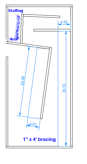

To get a real backloaded horn for 8" drivers you have to get up in size like the old Schmacks horn or that that Norwegian Big Fun Horn, Lowther TP-1 they all are about 500 liters/ 20 qf.
I should like to try with the more narrower cabinet that you have posted here.
Not as narrow nor small ;-)...

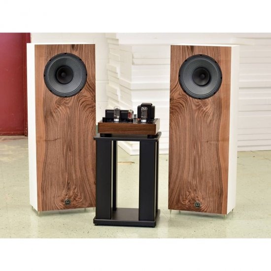

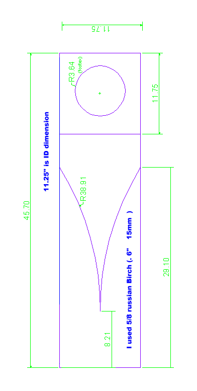

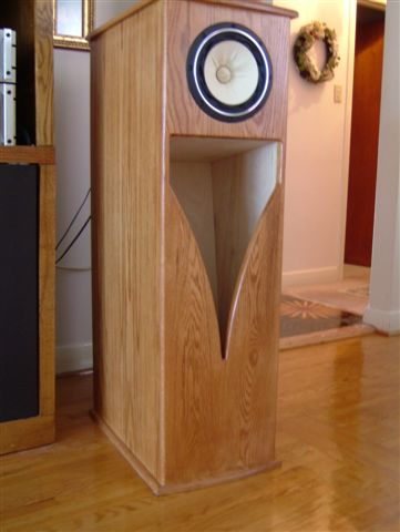

years ago I built a large back-horn for an 8" fostex driver.
It had amazing bass performance given the driver and sounded very good overall - I sold my Decware HDT speakers (also in the pic) and kept these monsters. 😎
It was called the "RCA-Fan horn" using a slightly modified Fostex FE206E driver and a Karlson slot on the horn mouth exit.

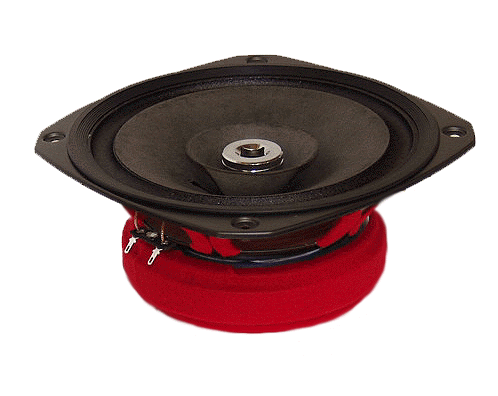

Wow nice wish that it's meant for a Coral Flat 8. Very nice felt cover on the magnet too

The horns is similar to Schmacks Isophon but with the horisontal part of the horn path split in two and the driver centrally located. The best driver I have heard for Schmacks was JBL 2110. A driver with a Qt similar to the SB driver but with a higher Fr. The Sb should be a good fit for the bass horn part of the speaker. However I am not sure about those diffusor vanes in front of the driver, they might do more harm than good for a modern driver.
That Altec with a Fr= 84 Hz and probably a very high Q and a very light cone is not an ideal horn driver, so weak and perhaps one note bass is not surpricing.
Any more measurements and pictures on the horn?

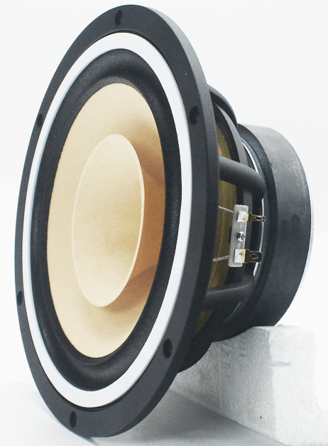

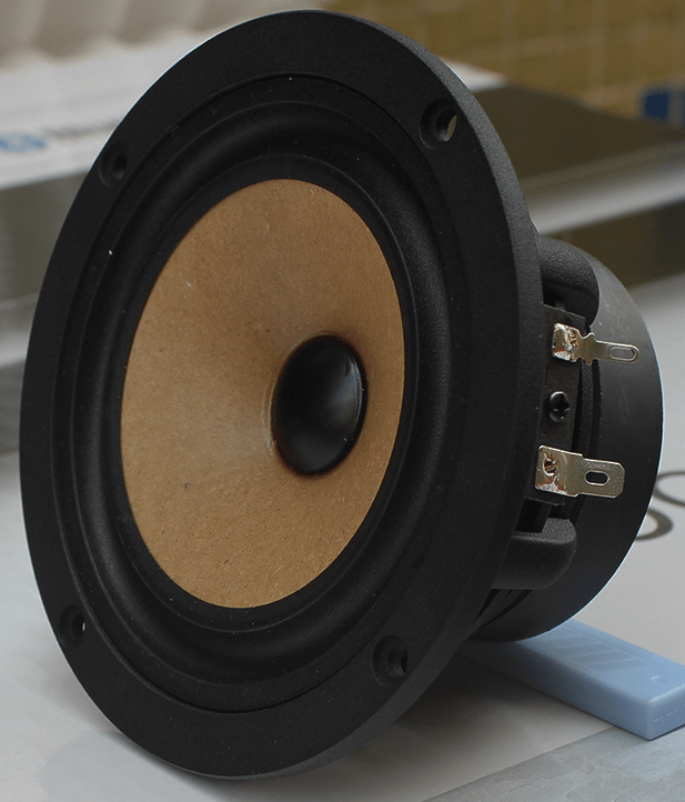

Yikes, didn't used to do that.... Sorry. MKHIFI (new brand name, was HiFi bird or Michael's Audio) 8" (~$140/pr) and 5.5" (~$70/pr). Compay doesn't seem to cater to "looks". Translated from blurbs: company HiFi bird founded 1991 by Redmond Reebok, HQ'ed Kent, England. Chinese names "cooperative birds" or "birds joined forces". Innovative use of very thin, imported English "drum paper" with "nanometer" coating.
Reactions: gnat_leader
The 5.5" (labelled as 6), 4.5" (labelled as 5), and 4" (labelled as 4) are/were sold by several China online retailers with or without cabs; the 8" is recent and (as far as I know) sold by one new shop driver-only.
(I started with the 4.5" in piano black cabs, upped to 5.5", just ordered a spare pair of drivers, and will probably try the 8".)
BTW, the SB20FRPC30 can't be found on taobao or idlefish (China's eBay).
I have just ordered a pair of SB FR 8 inch from Willy’s HiFi - I am UK based. After much deliberation I am going to keep it simple and will produce something inspired by the Omega Super 8 XRS - effectively just an FR driver in a well thought out cabinet.
I have modelled in WinISD and a 40 litre sealed cabinet with a QTC of 0.706 gives and F3 of 67hz. The cabinet will be window braced, 35 mm egg crate open cell foam applied to all internal surfaces and possibly mass-loaded at the bottom in a sealed chamber for stability - I will use something like Atabites. The cabinet will be made from 18mm MDF with painted sides and top but veneered front and rear. The plan will be that they end looking something like this:
I hope you have something for the low end.
They model very well as MLTL, btw. Will reach lower than 67Hz. Something in the 35-ish Hz.
If necessary I will build some bass ‘modules’ using the SB Acoustics SW26SFC38-8 Shallow Subwoofer and amplification with crossover and phase adjustments. I tend the prefer the flexibility of this approach.
TBH, from an aesthetic point of view, I haven’t been overly keen on the look of many transmission line speakers with FR drivers - they don’t quite look like furniture to my eyes. These speakers will be used in our ’family sun room’ so visuals are very important. I did model a PR version using the matching 8 inch PR and I found that the cone excursion of both the PR and the driver was rather alarming below 50hz or so. From memory I think F3 was lowered by about 10hz but I didn’t think that was sufficient to risk too much cone excursion - I thought I would leave that to dual 10 inch subwoofers if I need them.

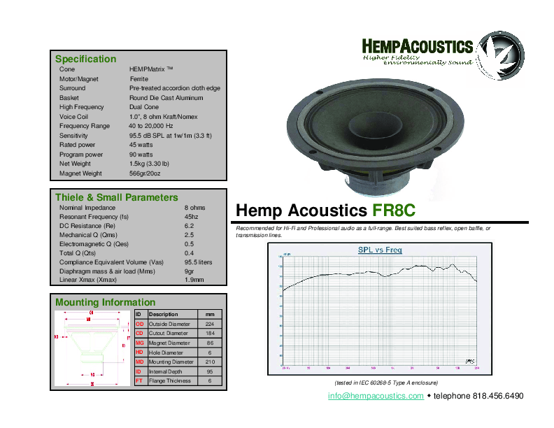

FYI, I recently spotted some other cabinet designs that should work well with this driver - take a look at this post where I'm trying to get confirmation that these cabs will work OK. I'm finding more of these cabinets by searching for cabs that work with the very similar driver (which no longer exists) called the Hemp Acoustics FR8C.
