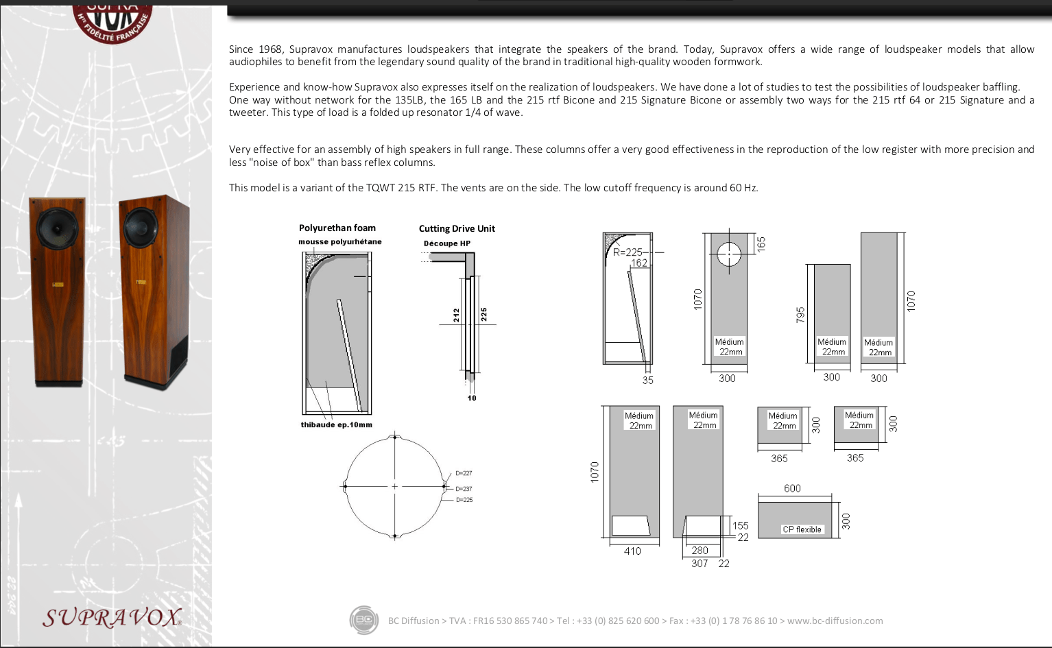

@nandappe Have you seen this TQWT cabinet design similar to yours for an 8" FR driver that has similar spec's to the SB20
I guess there are dozens if not hundreds of cabinet designs out there that could work.
