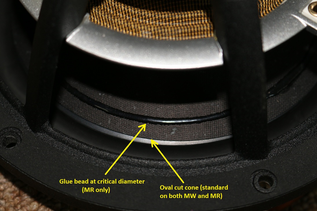

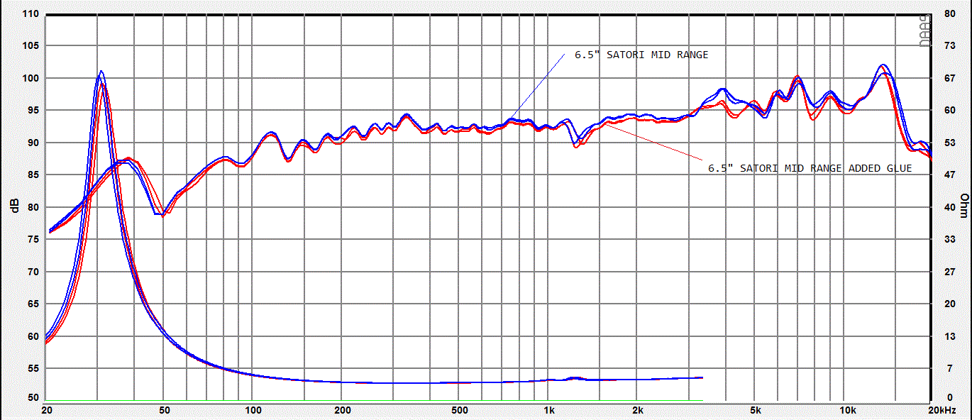

Newer satori midbasses "MW16" will have a vented voice coil former to eliminate the small 600hz helmholtz resonance. The dedicated satori-mid "MR16" already has it (and ring of glue applied to the cone to fix the first 4khz break-up.
I found this out when talking to Ulrik Schmidt/ /Danesian
The MR16: (also MW16) but to be honest don't see the 600 helmholtz as a problem in earlier versions of the MW16.
