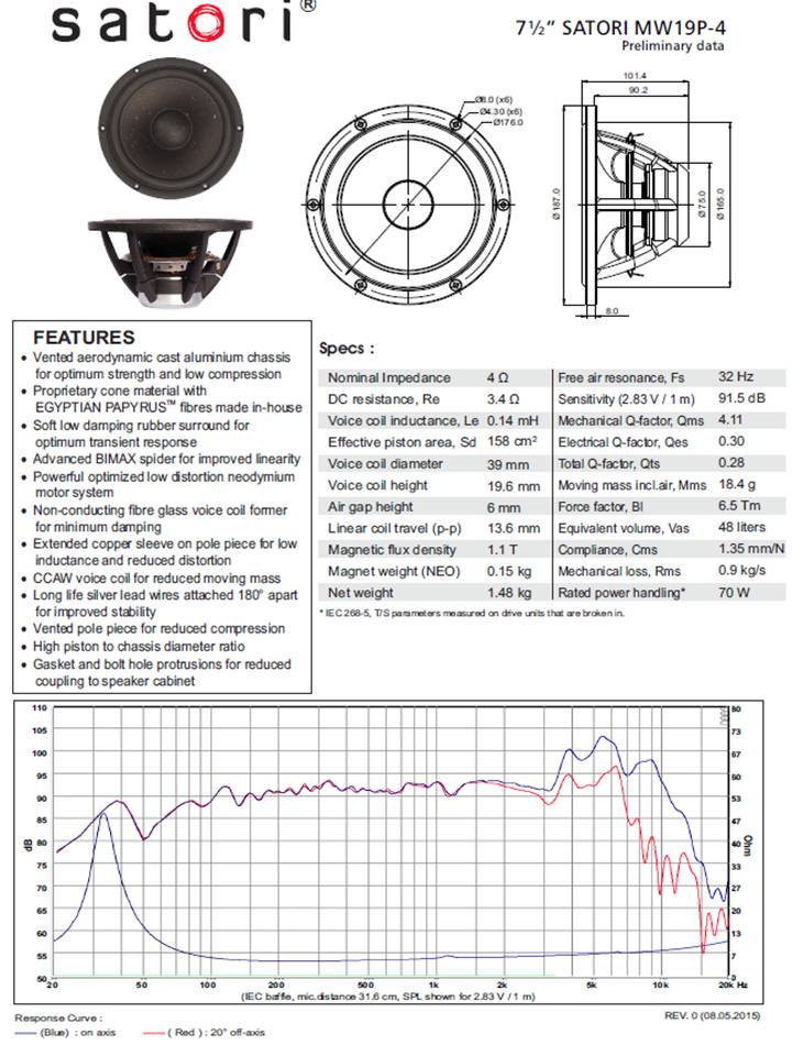

with two Satori 7.5"/8 ohms in MTM for a +6 DB to match the efficienty of the 29RN tweeter (96 db) could be nice... The FS of the TW29RN is 100 hz higher than the TW29R but the impedance peak at FS seems smoother... could it give a better Mid to tweeter XO ?
Too bad Zaph doesn't have distorsion measurement of the Satori 7.5"... if very low as the 6.5" this MTM in an OB with EQ could give enough level < 600 hz without too much distorsion at home level (and with a plated amp sub....but this OT).
Could the roll off on an OB around < 600 hz could help to have a LESS energic slope for the SB29R ? LR2 ?

For the SB Acoustics SATORI TW29RN tweeter, has anyone removed the •Two part aluminum faceplate with integrated mechanical decoupling• and attemped a direct on-baffle mounting to reduce the Center-to-Center distance between the midrange?
It seems a "shame" to pay for the small NdFeB magnet diameter TW29RN and not be able to use it for improved lobing from mounting the TW29RN-core directly against the midrange.

Despite its better electrical damping and + 4 db efficienty (which does not help instead a R version with a standalone Satori), the RN is not so good for a XO < 2000 Hz
