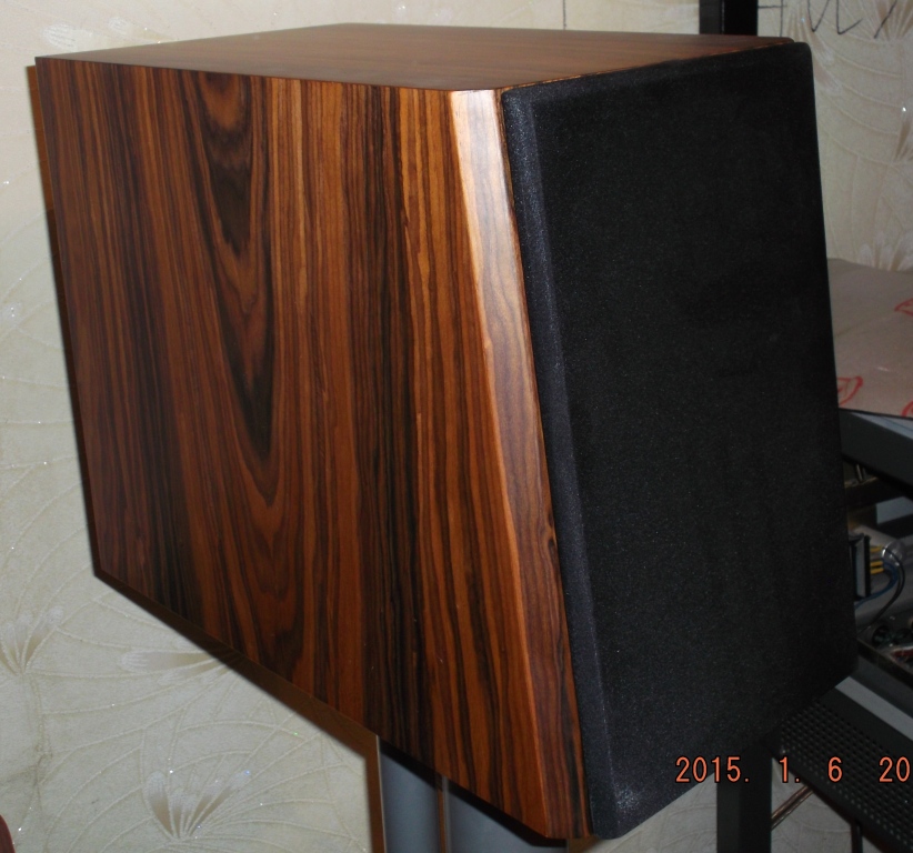

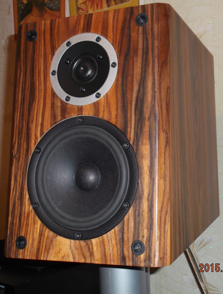

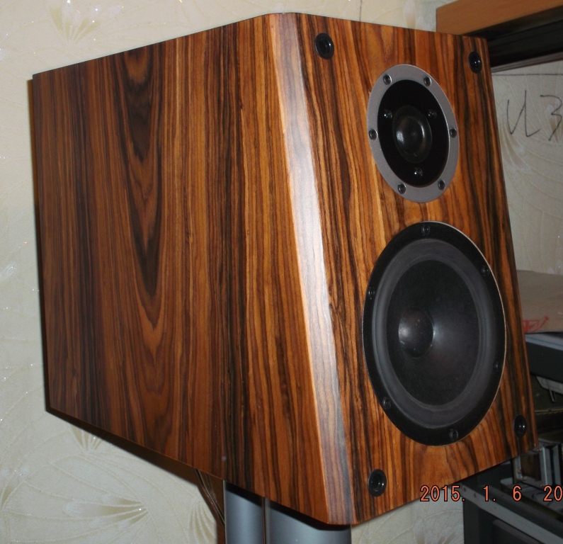

This are photos of my KALASAN.
Nice work Anatoliy. Would you be kind enough to share the measurements of your cabinet and the port size? Thanks.
