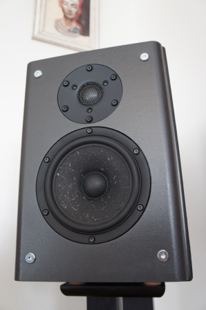

I recently bought Joachims Kalasan speakers he had for sale here. The Crossover has to be built in a separate enclosure, because there not much room in the speaker cabinet, they are pretty small, actually, but really beautiful and obviously very well built with excellent damping.
Today I had a first listen and all all I can say is I am really floored. I never heard a speaker with such a high resolution.
Okay, my experience with audiophile Monitors is limited, but I am running a small recording place and so I heard and used quite a few high end studio monitors (Klein Hummel, Geithain, PSI) and I can say that this small speaker is better than most of them concerning dynamics, imaging and resolution. Features you really need in a Monitor. Of course it is lacking in the bass department, I am measuring usable lowed to maybe 60 HZ, but just listening to music I am not missing much, but if these are going to be my main mixing monitors (And it looks like that), I will probably need a sub for them. (DIY recommendations are very welcome🙂
By the way, I like the sound best with both ports closed, the bass is really tight then and I do not hear more usable deep bass with the ports open, only what is already there gets louder but also a little blurry.
These are only first impressions, I will see, how they grow on me.

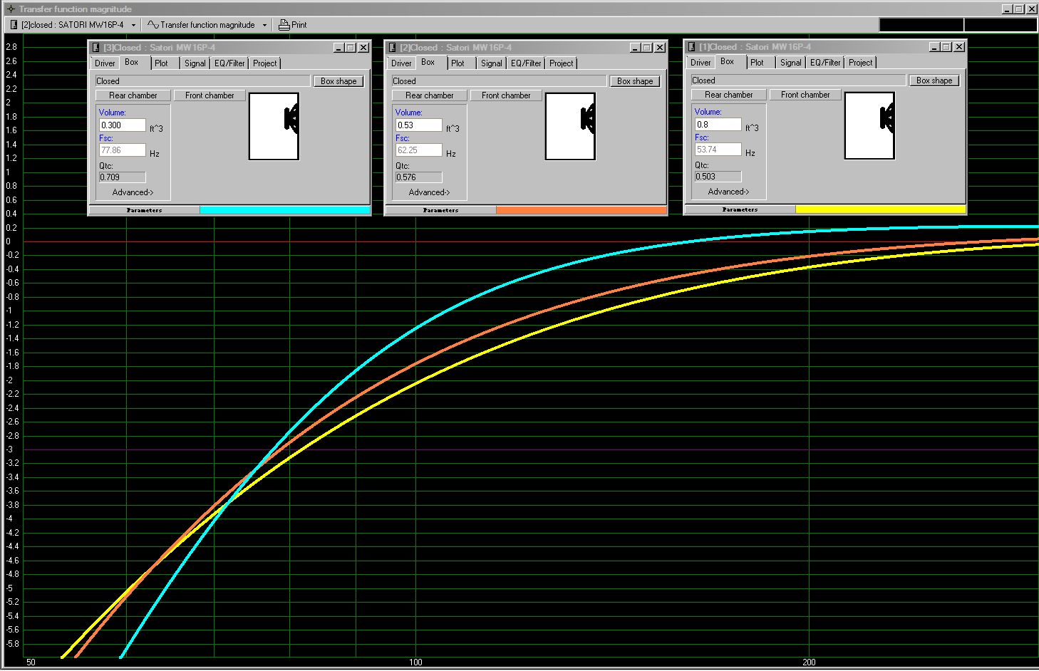

Continued campaign for 3-way SB kit using sealed box Satori MW-16P for the midrange. Two 8" SB23NRXS45-8 bass reflex, or one 10" SB29NRX75-6 BR vs. TL? Ports can be always be sealed for alternative bass transient goals.
Attached WinISD plot of a in three different sealed box volumes:
0.3 cuft with Qtc = 0.709 ~ maximal flat ButterWorth function
0.53 cuft with Qtc = 0.576 ~ uniform delay Bessel function
0.8 cuft with Qtc = 0.50 ~ critically damped function
What is the best solution for time-alignment?
Stepped baffle(s)?
Slanted baffle + modest Xover compensation tweek?
Flat baffle with phase shift compensation in the Xover?
TM box + separate woofer box? Flexibility.
Single TMW box?

What the satori does so well is midbass. Seal the cabinet and cross to a sub. You will have to show me a high quality midbass to take these duties from the Satori, hence the excitement over a possible 8" version. If that comes your idea becomes REAL interesting.

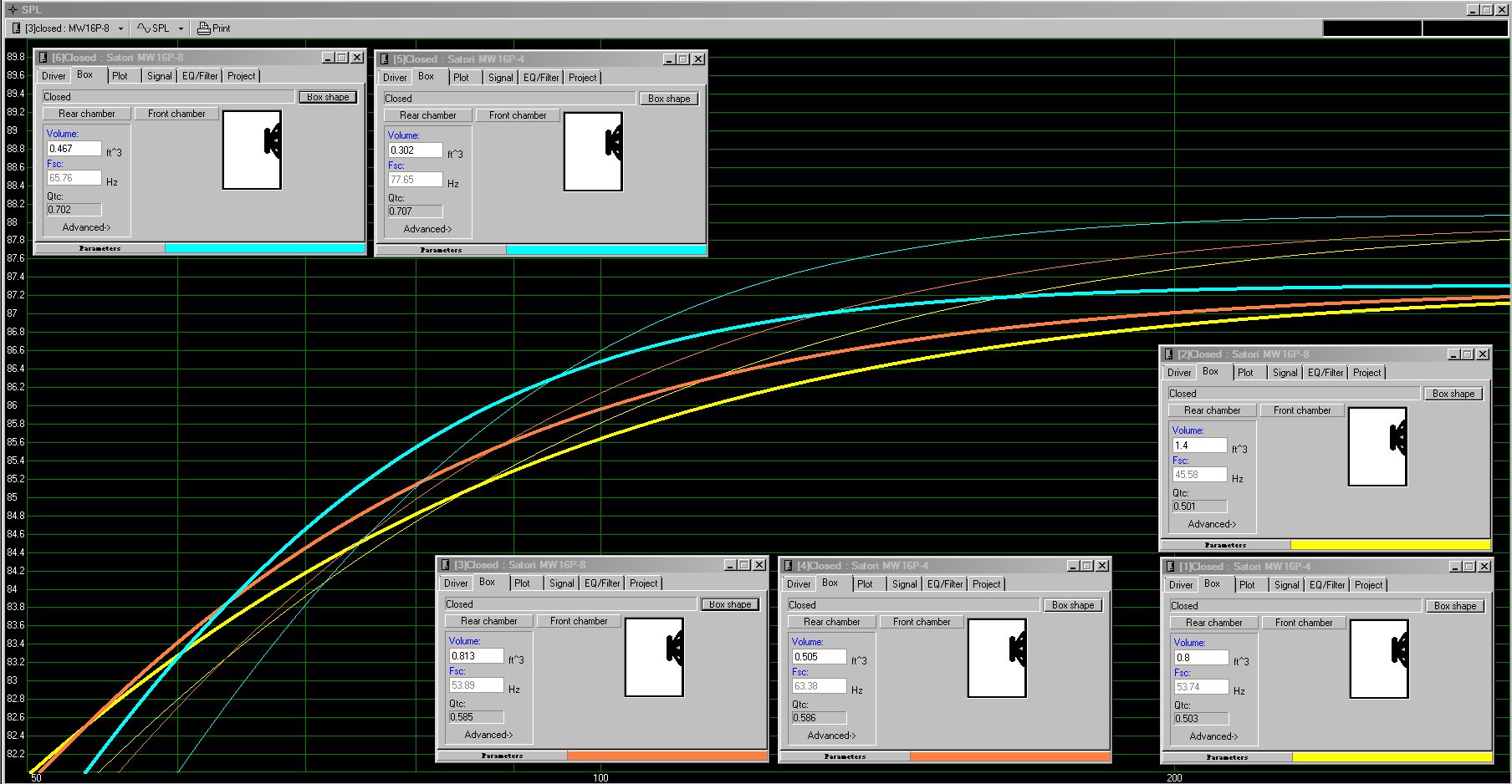

Comparison of sealed alignments for Satori MW16P.
Thick line plots for 8-ohm. Thin line plots for 4-ohm.
Both provide adequately low F3 for good woofer integration.
8-ohm provides lower F3 frequency.
F3 ~70Hz @8ohms F3~80Hz ~4ohms
4-ohm provides higher 2.83V sensitivity.

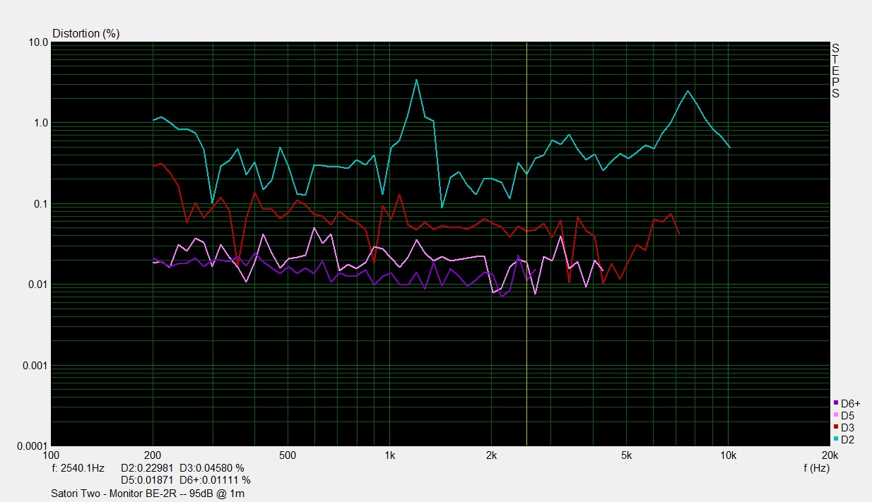

Yes, The 6640 has its own sound character and is very low distorting and in that aspect match the Satori mid-woofer very well.
The attached picture shows the distortion profile for 95dB @ 1m. The odd-order distortion is very low, but the second-order is somewhat elevated.
