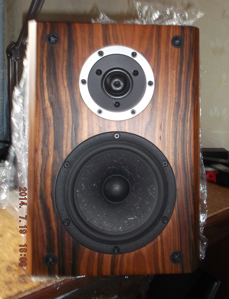

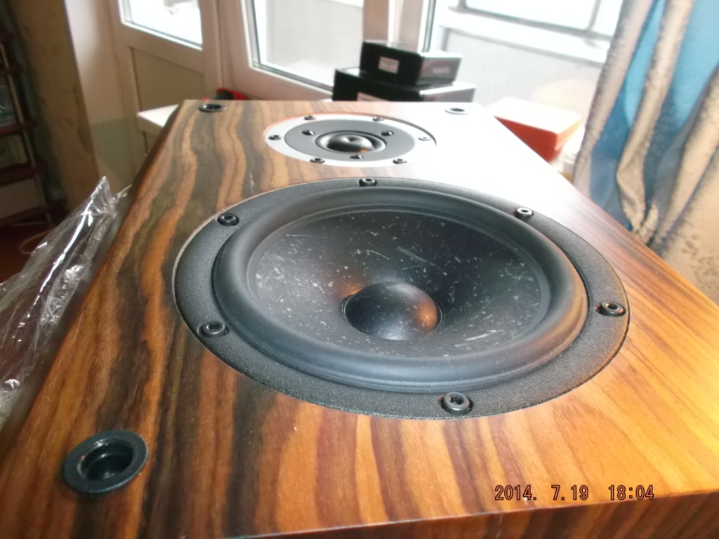

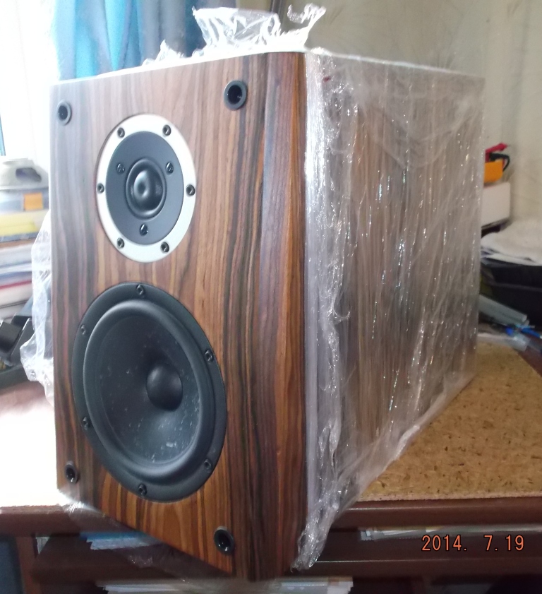

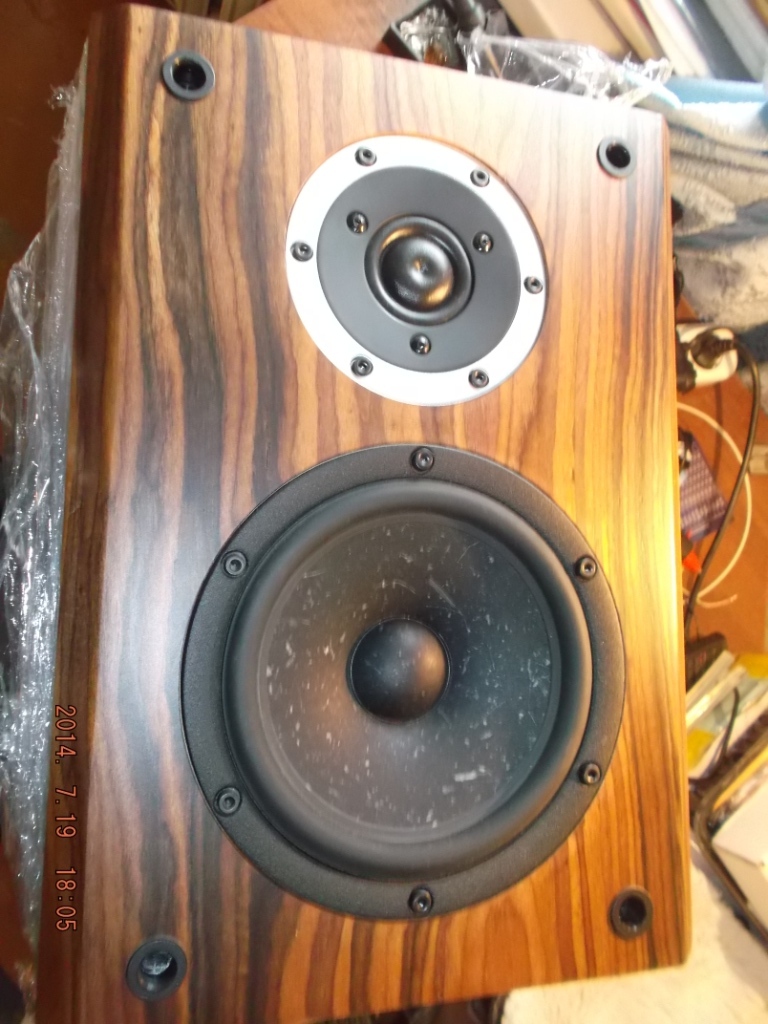

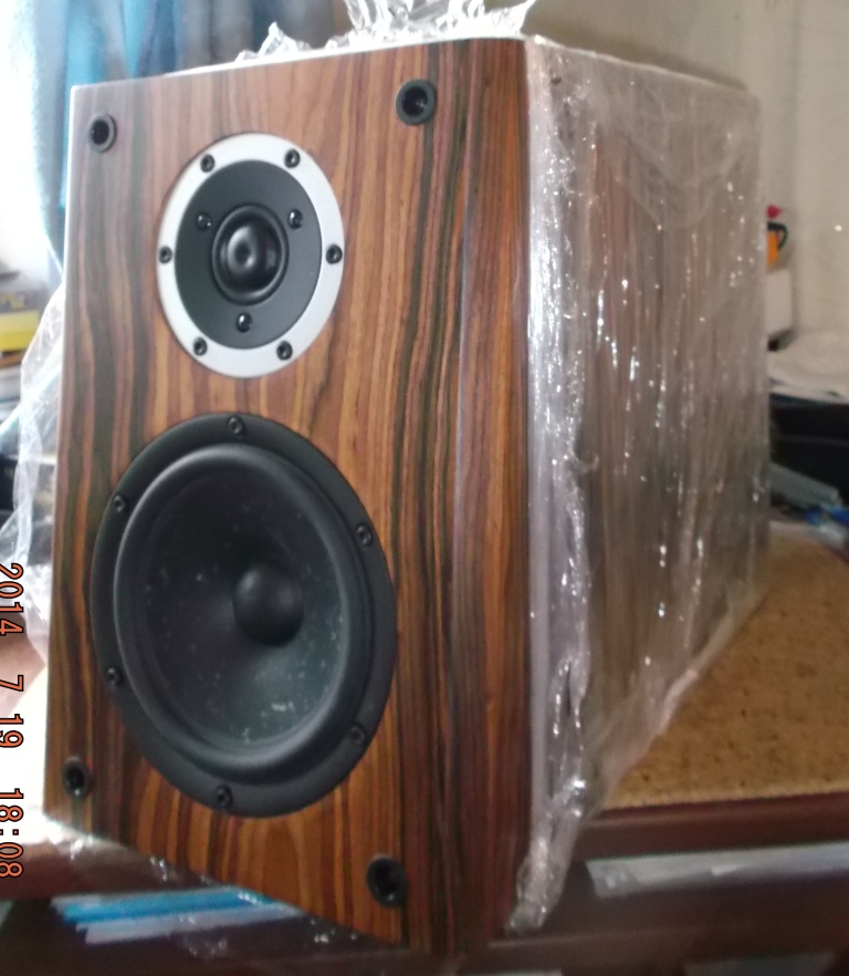

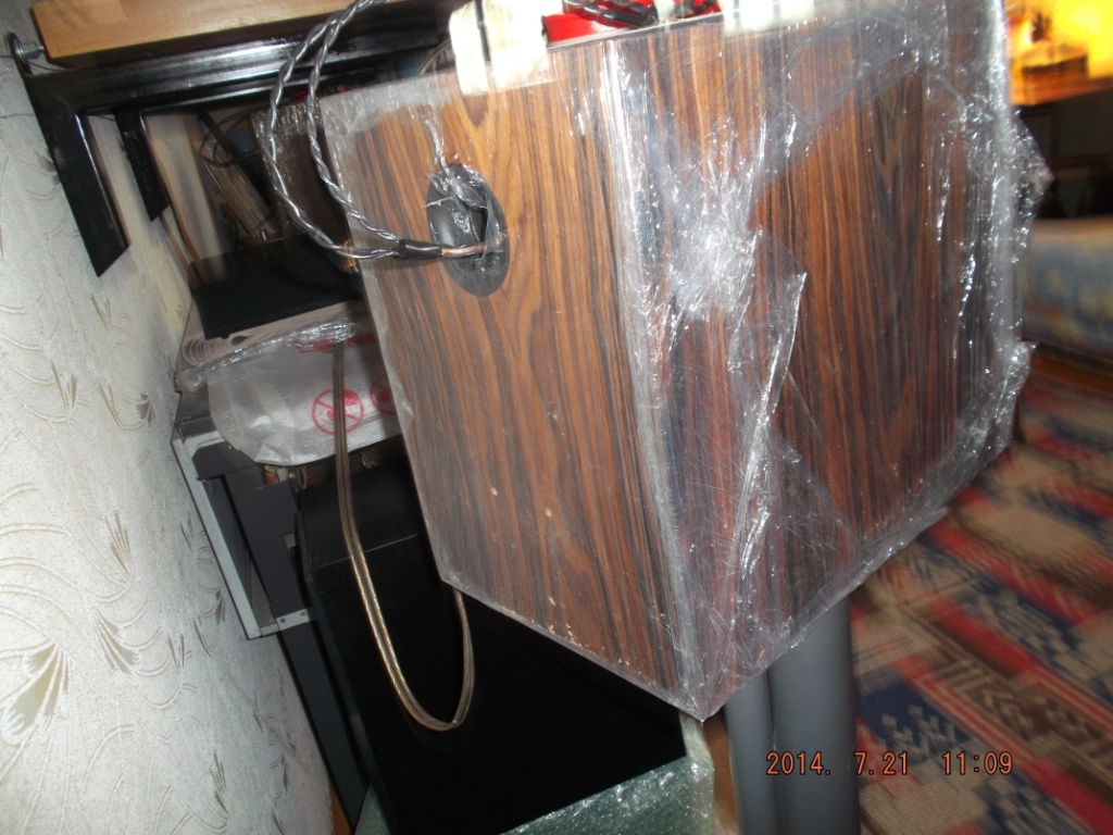

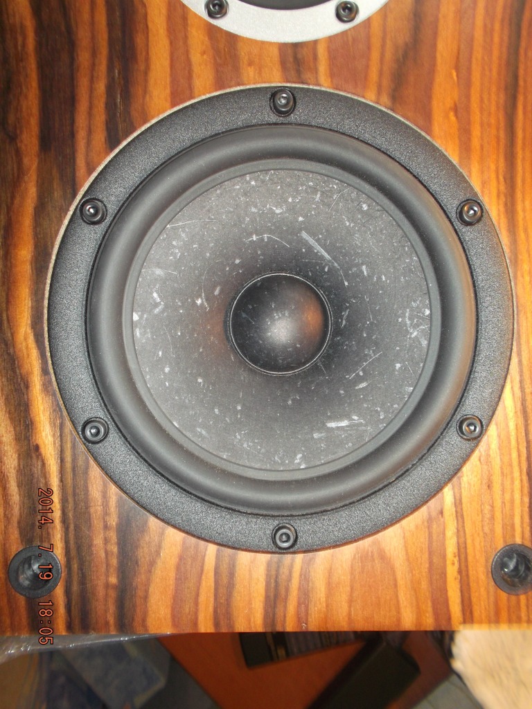

Hello! I have made it!

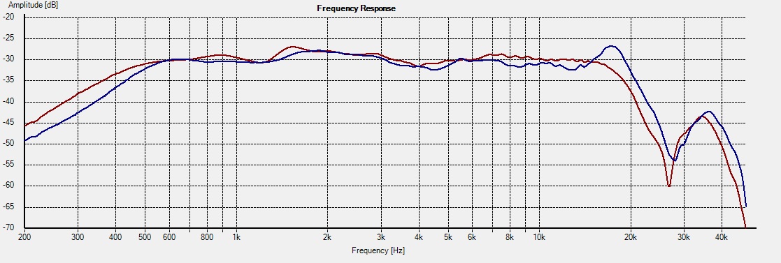

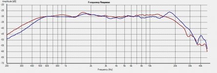

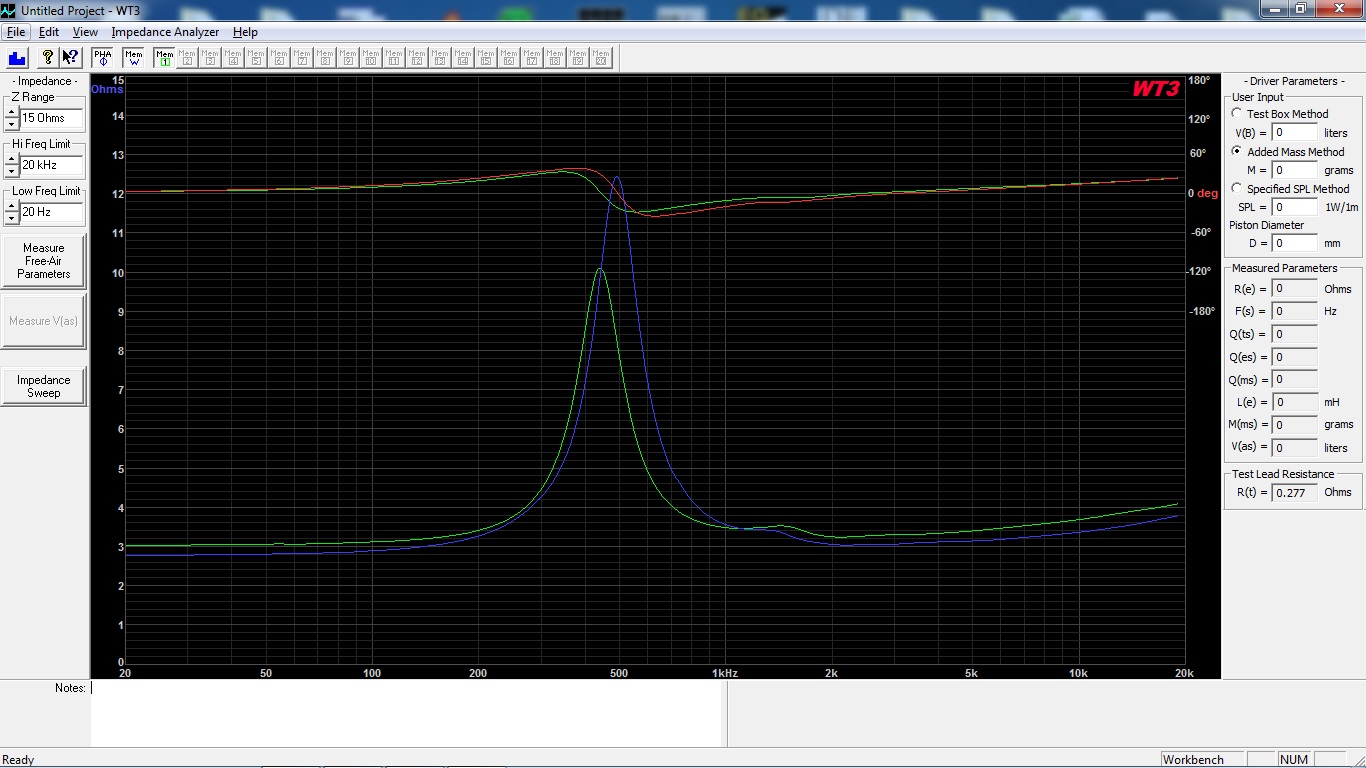

Sorry, I'm not Gillinger.

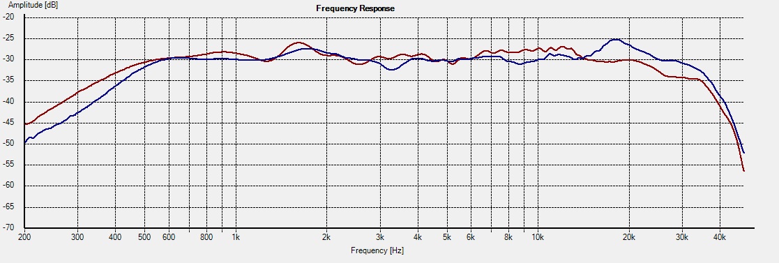

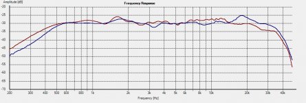

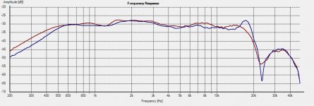

Main differences of the D3004/602010 compared to D3004/660000:
- Smaller and differently shaped face plate, 62mm vs. 104mm
- No AirCirc motor layout
- About 2dB less sensitivity
- Lower Fs, 425Hz vs. 470Hz
- Slightly higher distortion profile
- Decreasing frequency response from 15kHz vs. increasing frequency response from 15kHz (see pictures)
Attached pictures:
D3004/660000 = Blue
D3004/602010 = Red
Note! The graphs are normalized to about the same SPL.
For measurement details see:
www.audioexcite.com ScanSpeak D3004/602010
www.audioexcite.com ScanSpeak D3004/660000
For the price the D3004/602010 is a great tweeter. For a small face plate tweeter it's a great choice and is almost if not equally good sonically as the D3004/660000.
Regards
/Göran

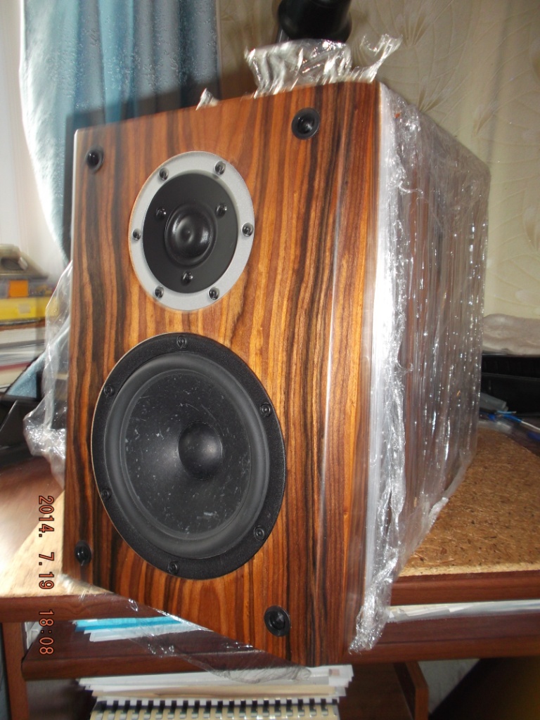

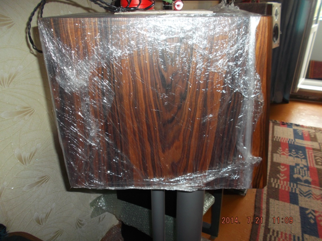

I came up with this shape for the cabinet.
So, is there a plan published for this cabinet ?
