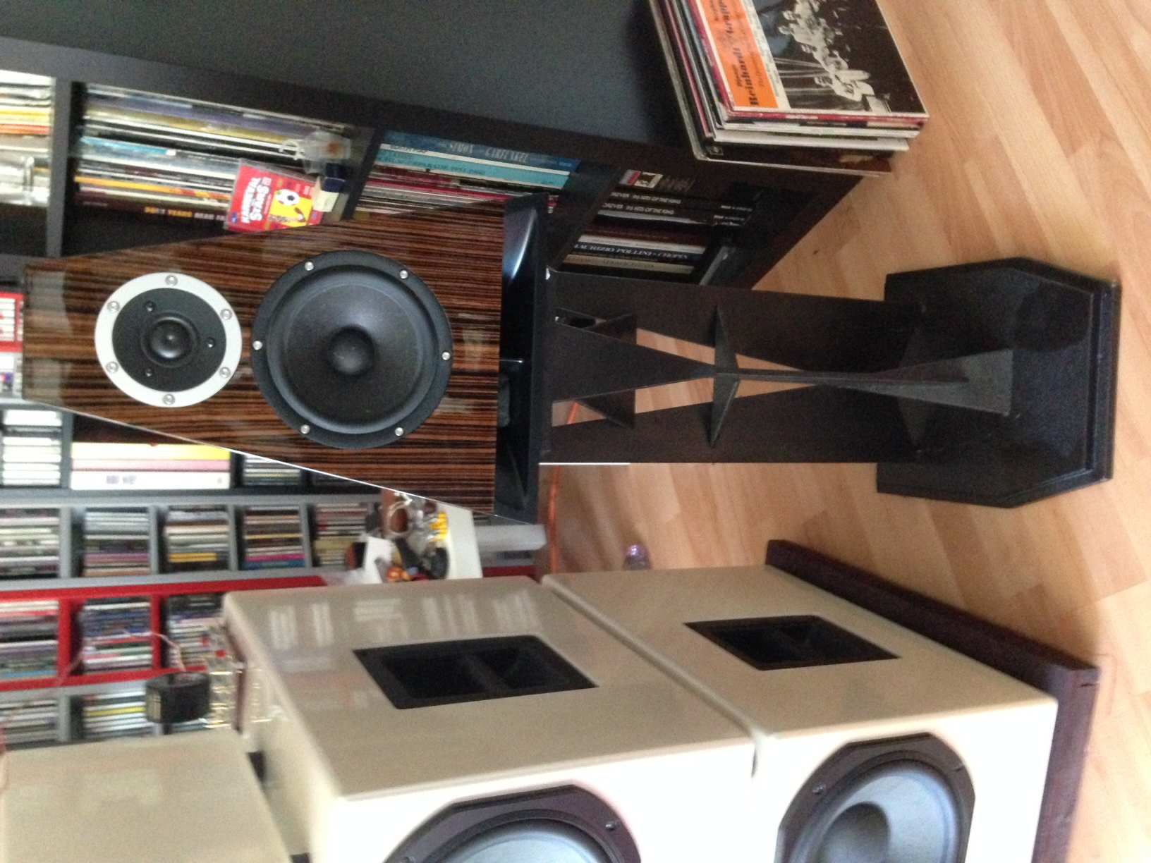

Here are some pictures of my setup.
First i tried vinyl.
Now i am listening to digital.
