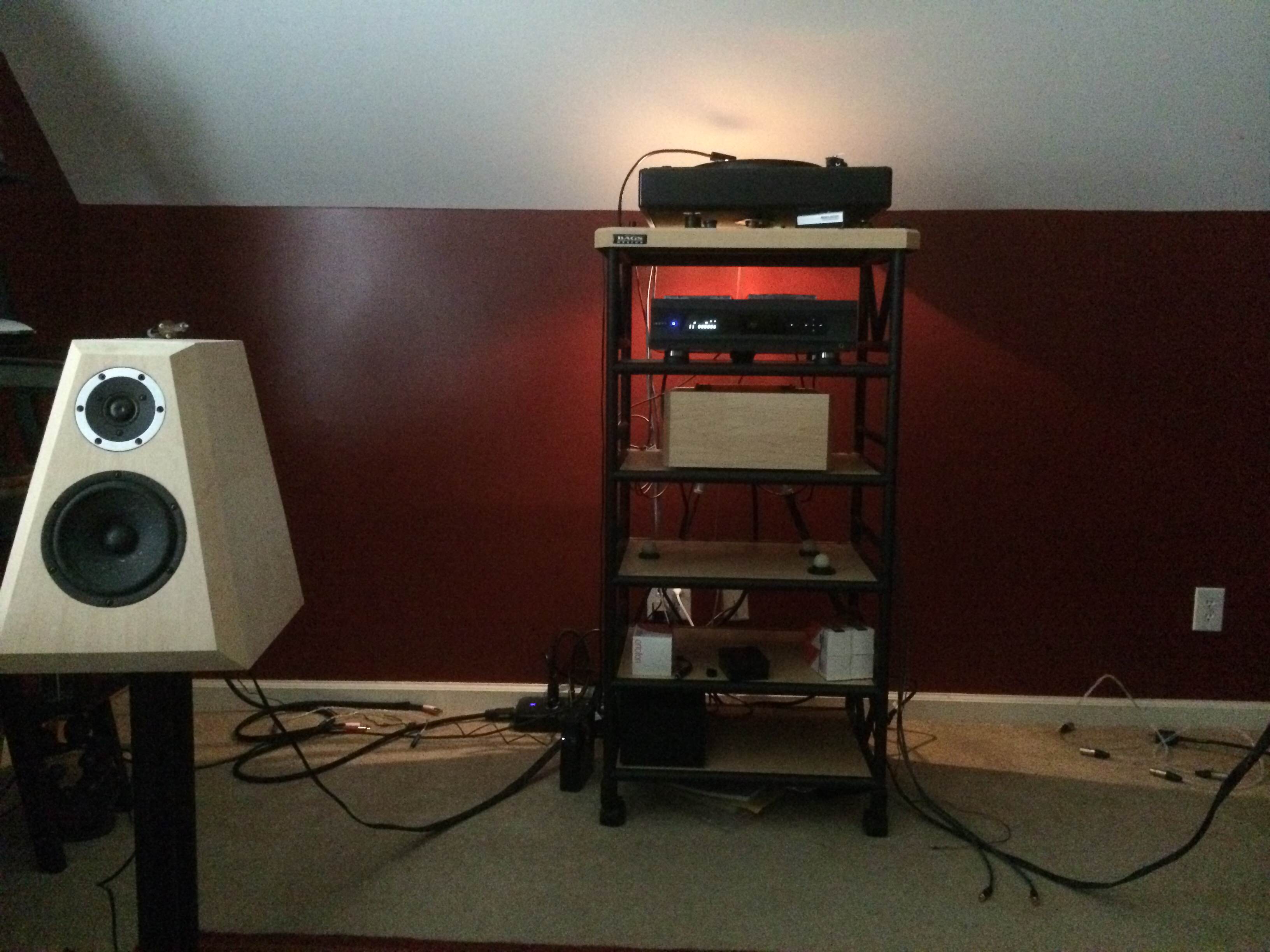

Here is almost finished speakers.
We had planned on extrenal crossovers, but went with internal. I have not veneered them and may opt to go back for flexibility. I have no doubt Joachims version is awesome, but these sound so good as they are.
FE is either oppo 105 or Sota Saphire with Ortofon Bronze. LP12 with Rotofon Ruby is on the way. Power amps are J2 clone and Funny amp.
Music will flat out engulf you. Better the recording, the better the sound.
I am adding SS26 aluminum woofers to them, but their bottom end is excellent for their size. I have a slightly large rrom. Of course, nothing can replace surface area, but these do it as well as anything and if you haev a smaller room, would be sufficient for all music. I have heard C Quenze 18h drivers, and while they are different in sound slightly, these keep up for half the price. I think Joachim is right in the fact that these are excellent midwoofers. I would like to think that SB would give up some Xmax and add a pleated surround and come out with a true midbass. If they were able to maintain the distortion profile and extension and gain efficiency while dropping the cone resonance, this would be truly world class. That is the benefit of the C Quenze. So much flexiblity. I can assure you that if you get this kit, you will not be lacking on the speaker front.
