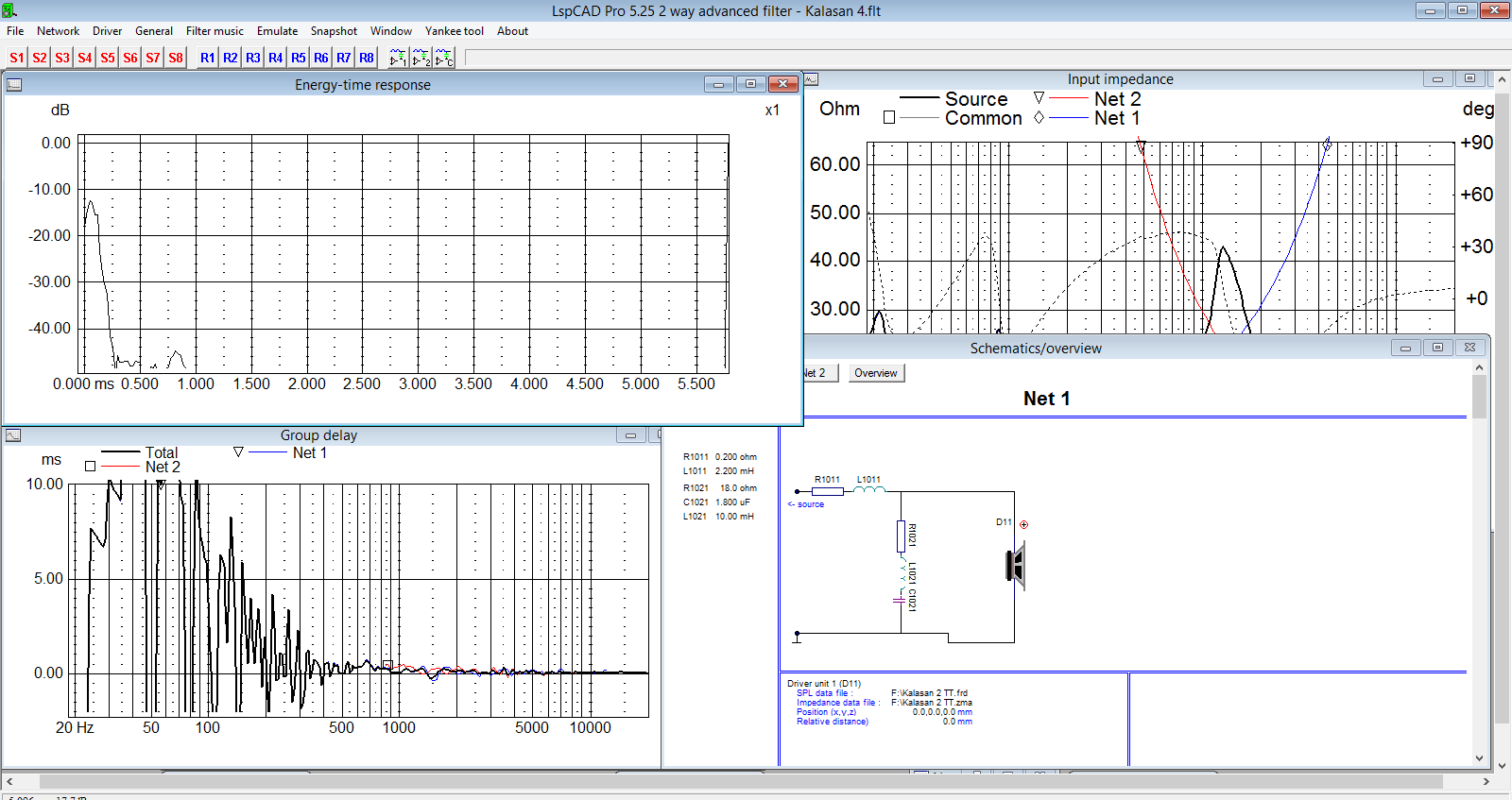

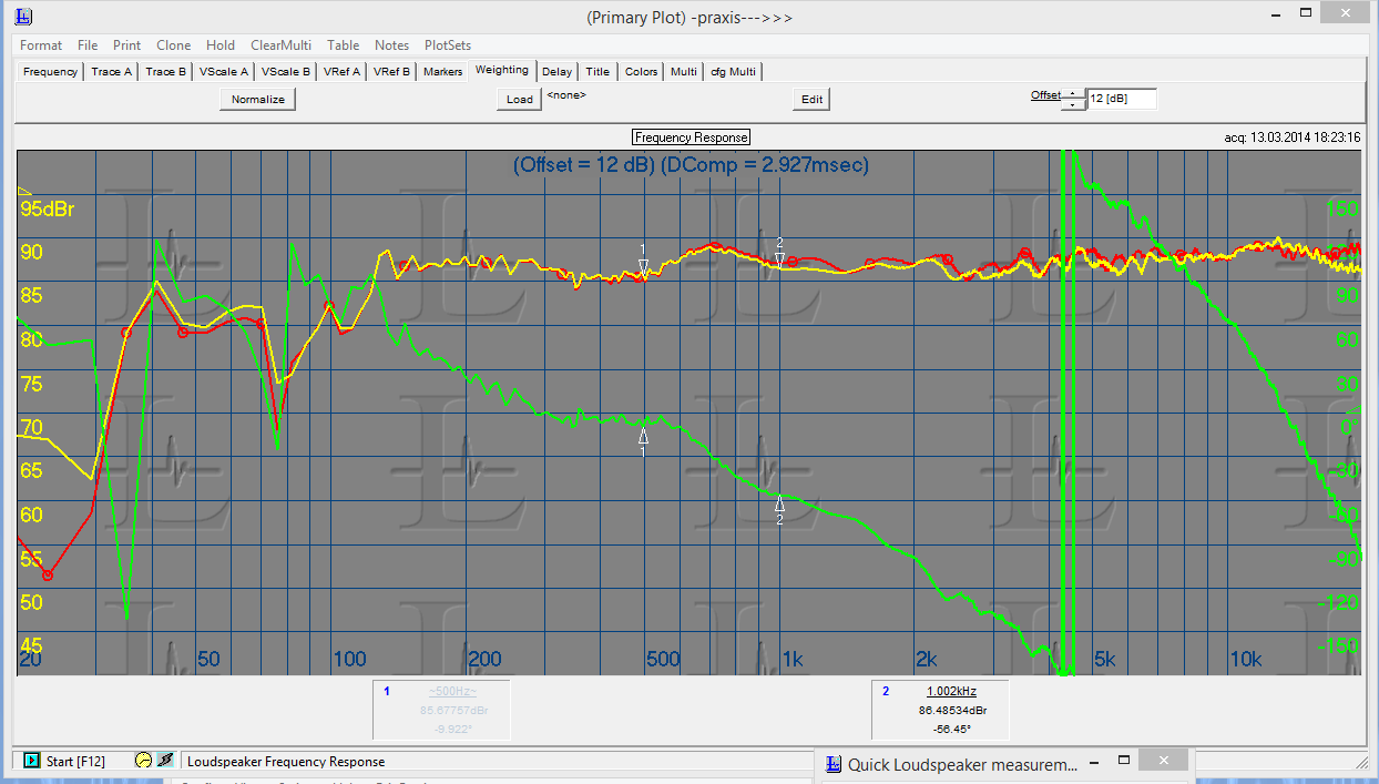

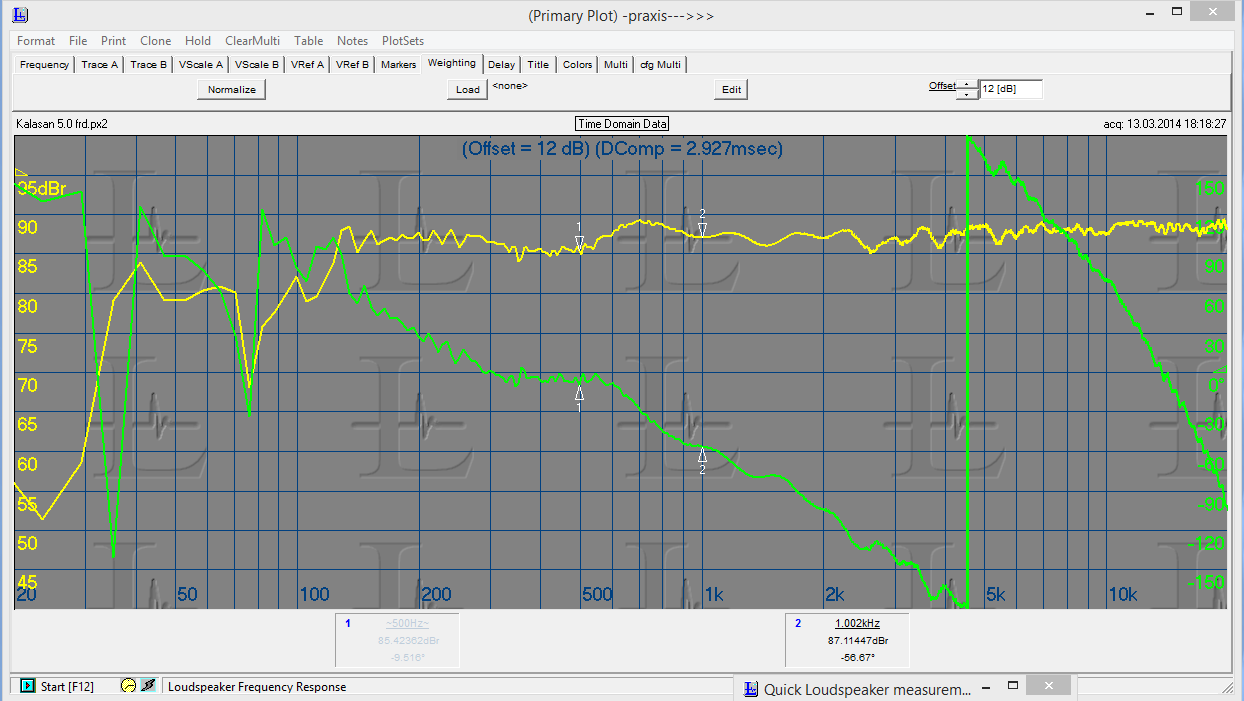

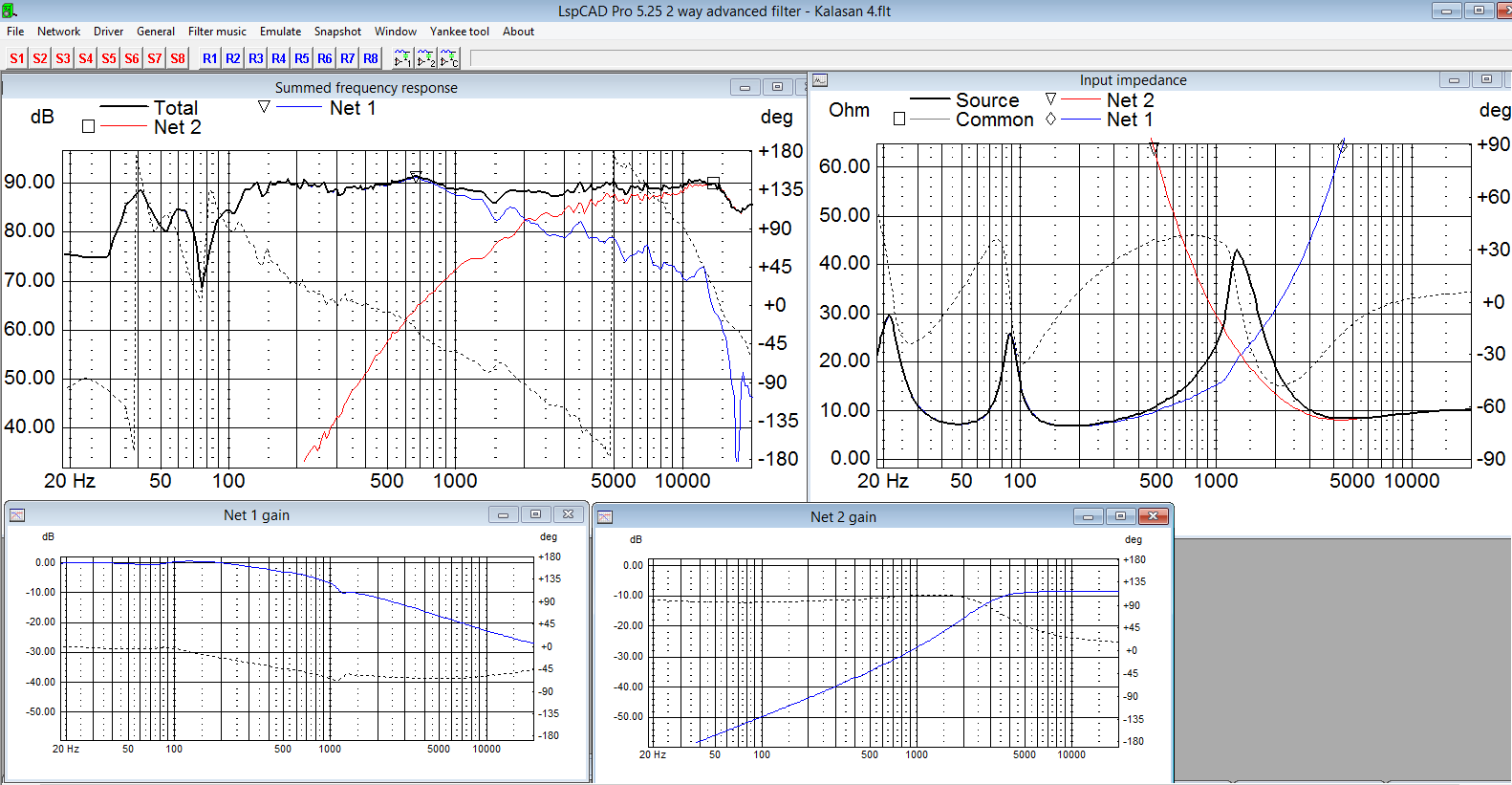

Here are the measurements. You see that the edge resonance of the Satori Mid-Bass is now tamed. I build in a very slight supression between 1,2kHz and 4kHz.
That avoids any honkyness in the region where the ear is most sensitive and should improve the subjective sense of depth. In absolute term this is minuscule.
You will not find many speakers on the market that are this flat.

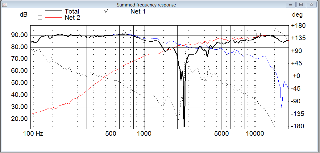

This will also hold very well off axis. The really deep notch i get when i reverse the tweeter ( actually the tweeter is reversed so this shows when the tweter is with positive polarity ) shows the great phase tracking i get with the drivers.

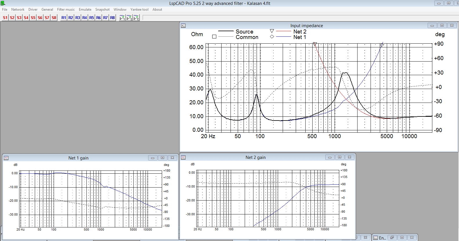

The impedance curve is benign and shows the reflex tuning at 45Hz. That is decent.
This is with one bass tunnel closed. Opening both bass tunels shifts the resonance up.
In this setup you will get less deep bass but the upper bass, lower midrange get louder.
I do not puplish the schematic at this time. I really whould like that David from SB hears this and gives me " green light ".

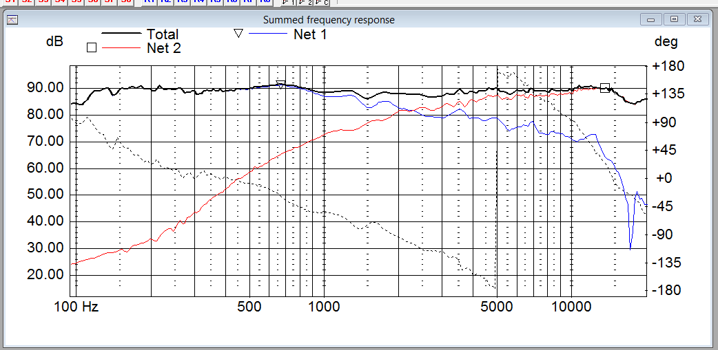

I now finished the design of the new crossover and i have put it in the pair i have so i can listen now.
I also found that the pair i got from Madisound was not adequately stuffed so i stuffed it new. I made a stuffing guide that i will publish.
In the meantime Ulrik from Danesian got a pair of Kalasan too and he will dublicate my result.
I can already say that this speaker sounds perfect.
