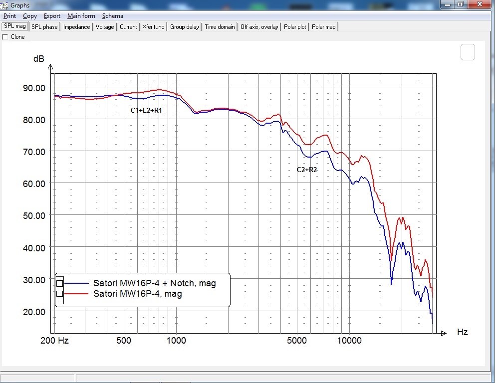

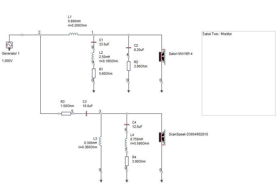

Yes, I did some response shaping in that area in my design (see picture).
Satori Two – Monitor
Perhaps if I used a steeper LR4 filter with a larger coil (L1) it wouldn't been necessary, but when using a shallow sloped LR2 cross-over I think it really is necessary. It would of course add some cost for the extra components.
Regards
/Göran
