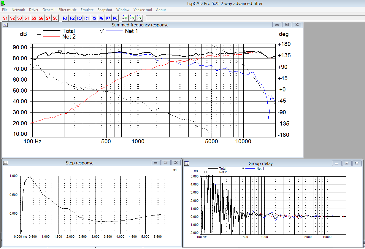

As i told you i got the Kalasan back from Madisound. I found that there was a raise in the presence region and the sound was reported rather thin. Very good soundstage and ransparency but simply not fully fleshed out. Well, this will never be a bass monster, no matter what, but it should at least reproduce acoustic bass, guitar, cello, kick drum, etc. rather well.
Instead of analysing what went wrong i decided to design a brand new crossover where i could put in some new good things that i think are beneficial.
One thing right at the beginning that is very important because it created some confusion before : THE KALASAN USES THE 8 OHM VERSION OF THE SATORI WOOFER AND THE TWEETER IS REVERED IN PHASE.
So here we go :

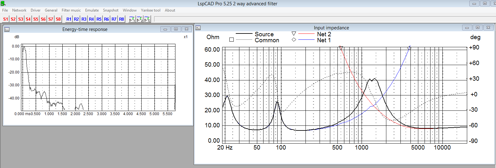

First i decided to equalize the impedance peak at the fundamental resonance of the tweeter. The tweeter is without Ferrofluid so this LCR circuit should give the crossover a more linear load and also protect the tweeter at fundamental resonance decreasing distortion and giving more dynamic range.
Then there is a series resistor before the tweeter that is somewhat higher in value then before.
The cap and the coil with series resistor form a rather soft filter.
The woofer got a bigger coil.
I also was able to improve phase matching, the very deep and symmetric null shows.
This speaker is very fast. Energy storage is low, the fast dropping ETC shows.
Group delay is very low down to low frequrncies, the Step response is fast and clean without ringing.
To differentiate it from the first version i call this version Kalasan 2.
I will now build the crossover physical and listen.
I hope the result is so good that this is the final version.
By the way, the reference axis for this measurements are the lower screw of the tweeter and 10° to 15° off axis, hence the small drop in the highest treble.

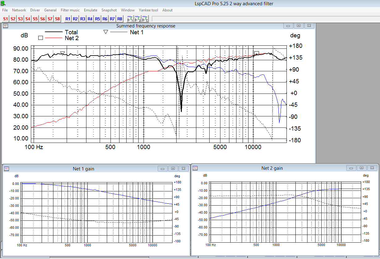

Hi Joachim,
I couldn't help but notice that your LSPcad screen shots show the "Kairos" as the data files used.
Jeff B.
Hi Joachim,
Jeff B.
i think he confused between kairos and kalasan 😀
Hey, my god, holy Mac Donalds burger, i see it !!!!!
The schematic says Kairos !!!!!!!!!
How can that happen ?
Maybe it is this phenomenon :http://de.wikipedia.org/wiki/Freud’scher_Versprecher
