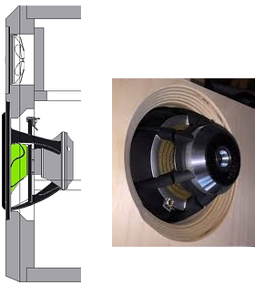

Is there a diference between the two mid-woof due to their different magnet material : ferrite vs Neodynium ? Tighter "bass" with Neodynium vs more fragility with aging (thermal issues of the Neodynium) ?
Stronger magnet >> Smaller magnet >> Free backward airflow.
Detailed cone resonance will be different too.
So the only difference between the two material should the result of a smaller size ? (less back side reflection)
You can check the products specification to see what differs in the T/S parameter. If the neo magnet is designed with the same strength in mind then there will be little differences. The biggest practical difference I believe is the effect of the backward airflow in typical box speaker.
When the driver is mounted from in front of the baffle, some of the backward airflow is blocked and this affect midrange quality. See common solution on the picture. And see how the magnet of Scan-Speak Illuminator is designed regarding this airflow (the sketch), using also neo magnet. It is one of the best sounding midrange driver available.
