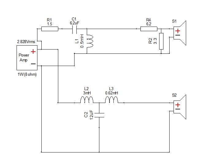

Does anyone have the cabinet plans for the Kalasan 5 or if they are on this thread somewhere, could anyone be so kind as to point me to the correct page? I've had a brief look through and can't seem to find it easily.

The kairos and kalasan are two different designs by different people. The kalasan crossover is in this tread and designed for the 8ohm woofer, I think they used the original ferrite tweeter however.Hi!

@Mordekai: Yes, I have noticed thar the Kalasans switched to 8 Ohm Woofer, but I could not find the crossover - or I did find severals crossover named from 2-5...

Better phase alignment with lr2 crossover and smoother response from tweeter slightly off axis. The versions 2-5 were just evolutions of the crossover Gerhard tried.
Slanted baffle helps you to physically allign the units to compensate time delay.
