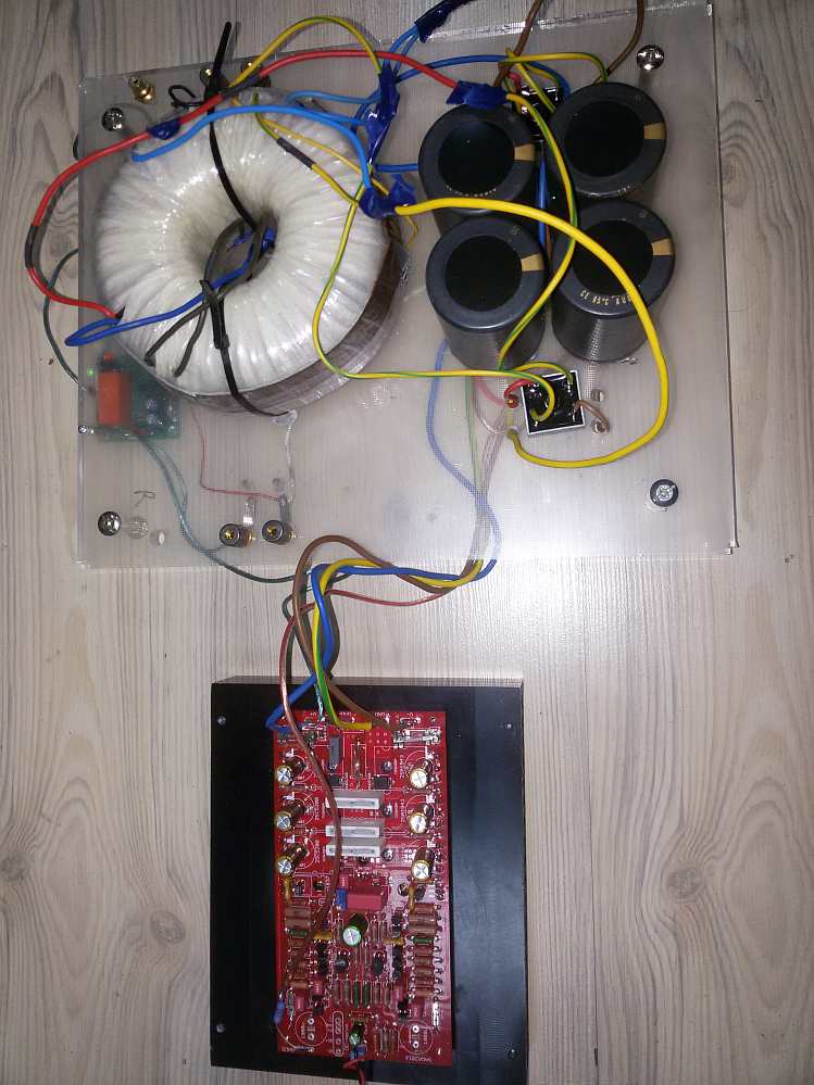

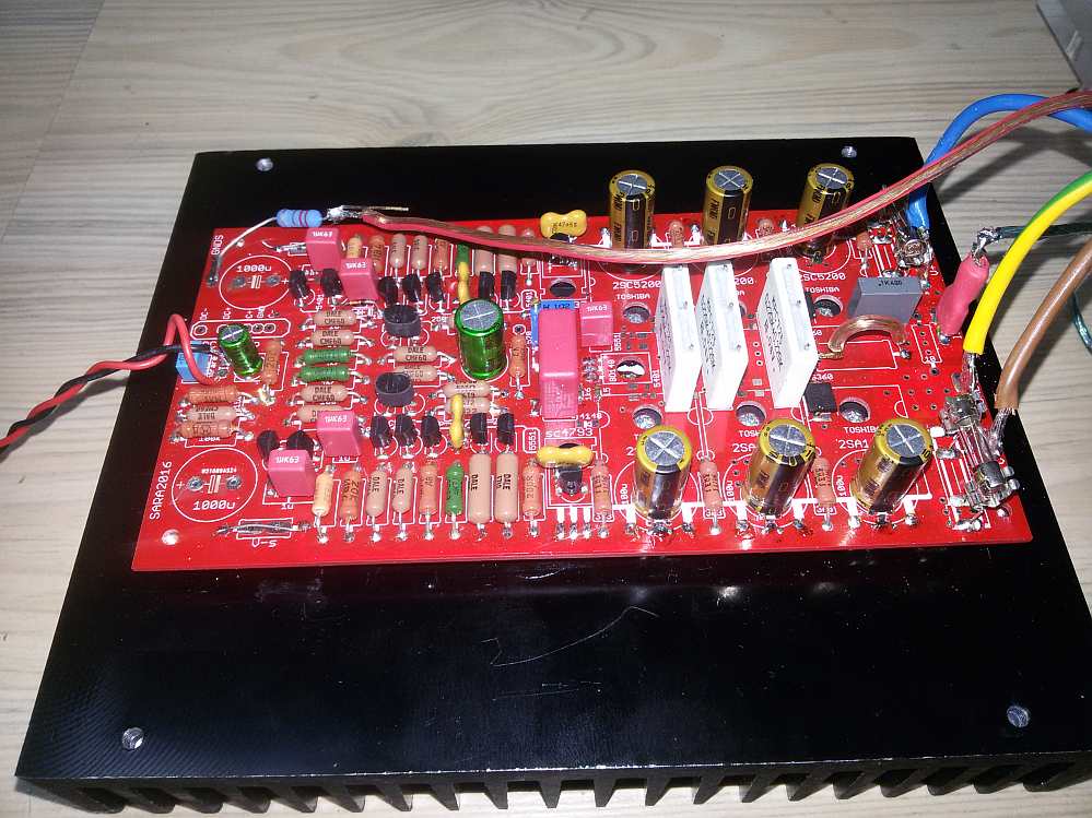

The prototype-ptil 😛
In 2012 was a more complex schematic. It is harder to build SARA-2012. For these reason I redesign the schematic, I simplified it. The result it is SARA -2016. All the variants from this topic are based on SARA-2016. So, I recommend you this road. SARA-2012 it is a closed road.

I understand. The reason I asked was because I did not see the transistors, but I inspected the picture and can now see that they are mounted underneath the PCB. Rather unusual placement but works I assume.
