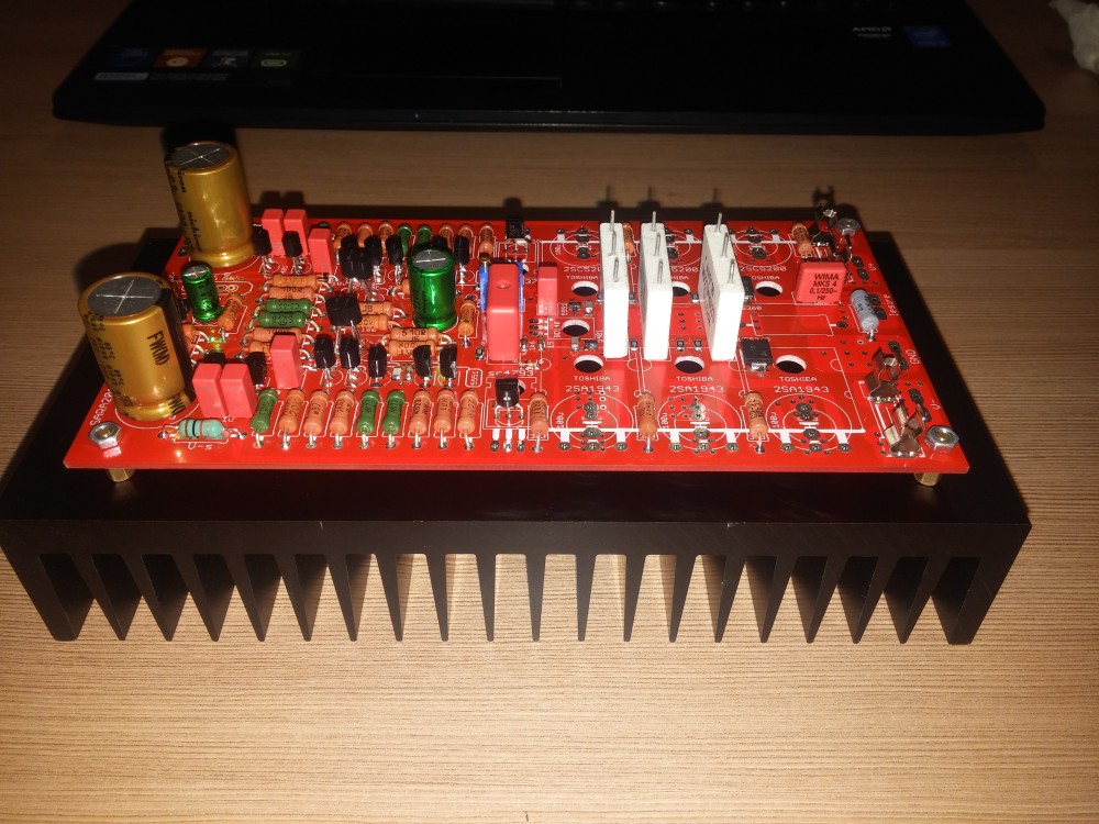

SARA-2016

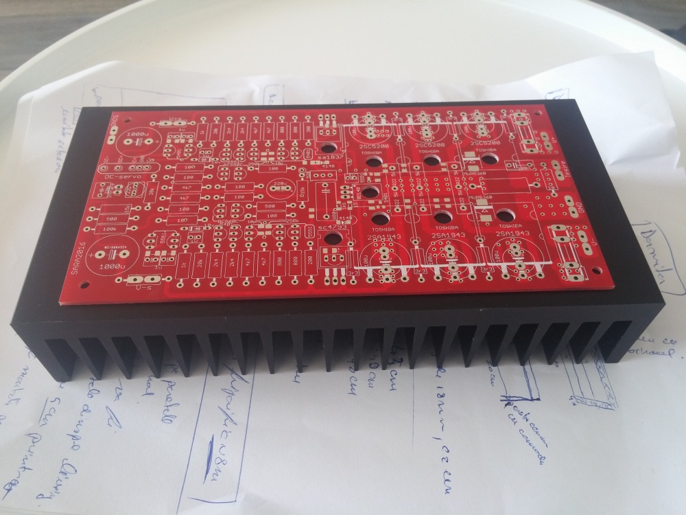

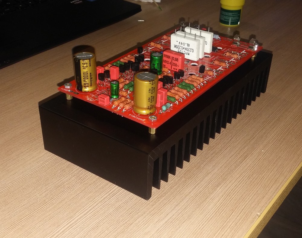

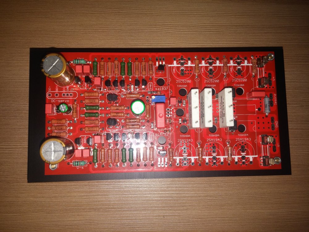

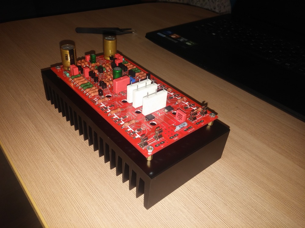

We have a new version of PCB. It was created by Palade Vlad.

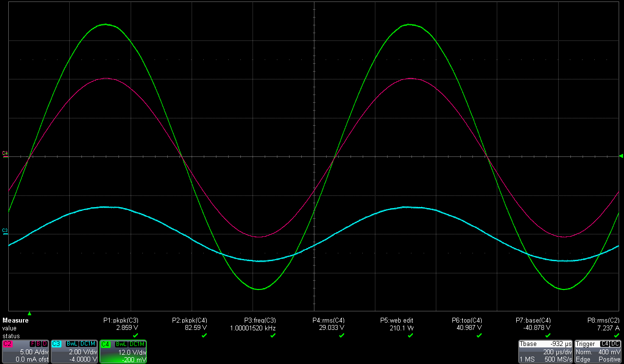

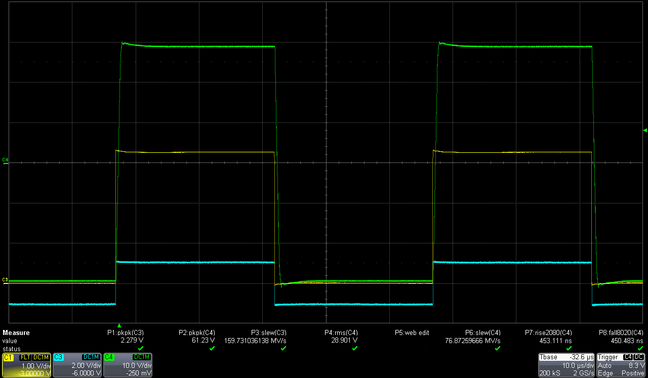

Some tests... 210w in 4 ohm, full power bandwidth on 4ohm = over 1Mhz (-3dB). DCpower at +-50v stabilized voltage. Slew rate 77V/usec, rise time and fall time smaller than 0,5usec betwen 20% and 80%.
Cyan it is input signal, green it is output signal on 4ohm.

Ok. Some are in english, some in romanian. For romanian files:
-"fisiere eagle adaptor rezistenta dubla" means "Eagle files for double resistor adapter"
-for the gerber files you don't need the translation.
- in the BOM file there are:
A - tip componenta - component type
B - valoare - value
C - putere/tensiune - power/voltage
D - spatiu intre pini - the space between components pins
E - cantitate - amount, quantity
26 - Semireglabil multitura de 1 Kohm de tipul BOURNS seria 3296W - resisting trimmer multiturn, 1kohm, type BOURNS 3296W
4 - rezistente - resistors
25 - rezistenta dubla - double resistor
29 - condensatori - capacitors
43 - diode - diodes
49 - tranzistori - transistors
62 - diverse - miscellaneous
63 - conectori putere - power connectors
64 - soclu pentru sigurante - socket fuse
67 - Linkurile de mai sus au scop pur informativ referitor la dimensiunile exacte ale componentelor avute in vedere la proiectarea cablajului - Links are only informative for the dimensions of the components
68 - Toate componentele de mai sus sunt pentru un singur canal - all the components ar just for one channel.
70 - Pentru rezistentele duble din emitorii finalilor voi proiecta un cablaj mic pentru un adaptor pe care se vor putea folosi mai multe tipuri (3 tipuri) de rezistente legate in paralel pentru a putea obtine valoarea necesara - For the double resistors from the emitters of the power transistors which is hard to find, I'll design a PCB adapter for 3 other types of resistors. There will be parallel resistors for the optimal final value.
71 - Componentele cu fonturi in coloarea rosie sunt componente optionale care fac parte din protectia SOA - The red components, are optional. That component are for the SOA protection circuit.
72 - Cele doua diode de pe layerul top marcate NM nu se vor monta!!!!! - The two diodes from the TOP layer, "NM" marked, they will not mount !!!!!
