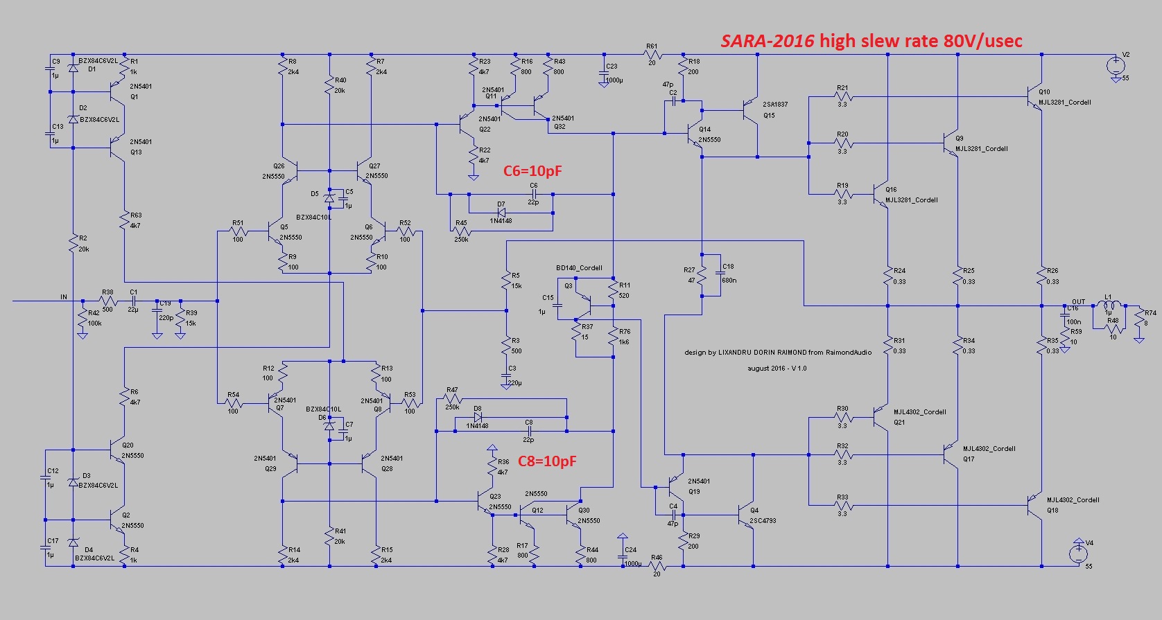

No way. With D5/D6 to the ground we will lose the constant voltage on the input transistors. After that we will have a parasitic BC capacitance in action, which will be multiplied with the gain of the input stage. We will have Early effect too with common mode distortion.
So if you want an "upgrade" in the front stage, use of CRD's is the optimum solution or a CCS's in the place of the R40 and R41.
You are absolutely correct, with one exception. R40 and R41 cause much more common mode distortion that early effect. Probably if You drop all cascoding (around diff pair and CCS too), You'll get better performance.

My suggestions was different, by the way. I've suggested simplification, by removing cascodes and so on, like in my schematic from my previous post. Additional CCS was proposed by someone else, and I agreed that it's good idea, but too much complications.
You can simplify but lose the essence... The input stage is not under negative feedback, so, it must be properly linearized. There will not be differences in the amplifier open loop gain perspective, but you will lose the input stage linearization.
From my point of view, the real and beneficial upgrade, it is the change R40 and R41 with a Curent Regulator Diode. The cost for this change it is 4x2$=8 maybe 10$. We can swap too the input stage transistors 2n5551 and 2n5401 with high beta and low noise BC550 and BC560.

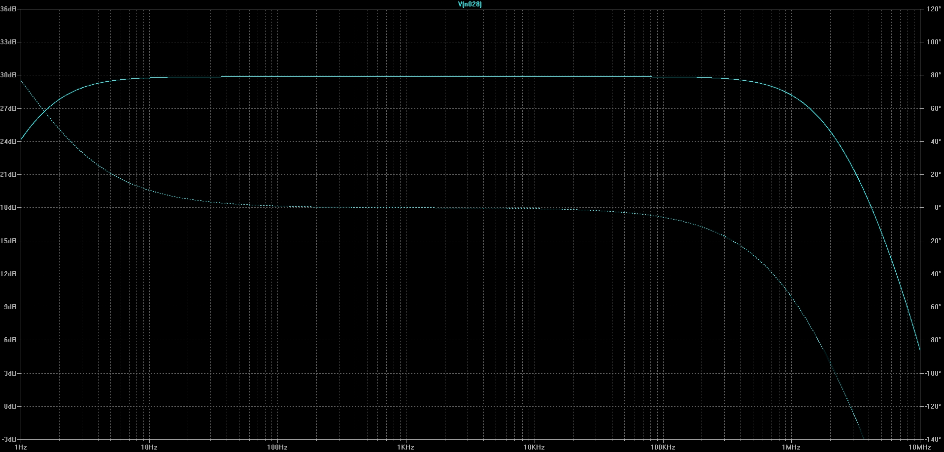

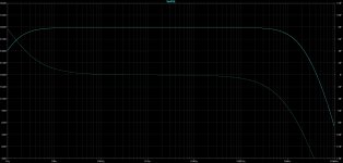

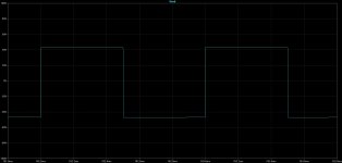

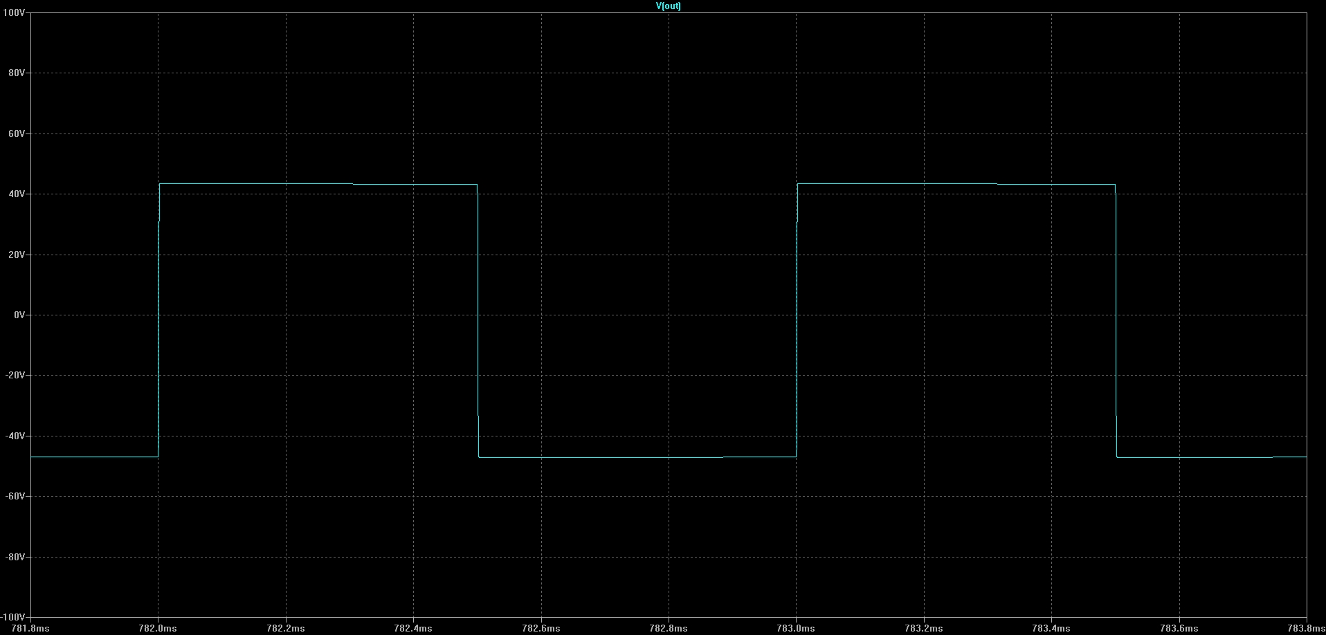

I went back to the drawing board and I pushed things even further. We can push the slew-rate and above in a safety margin. Phase margin 80 degrees, gain margin 16.5dB.

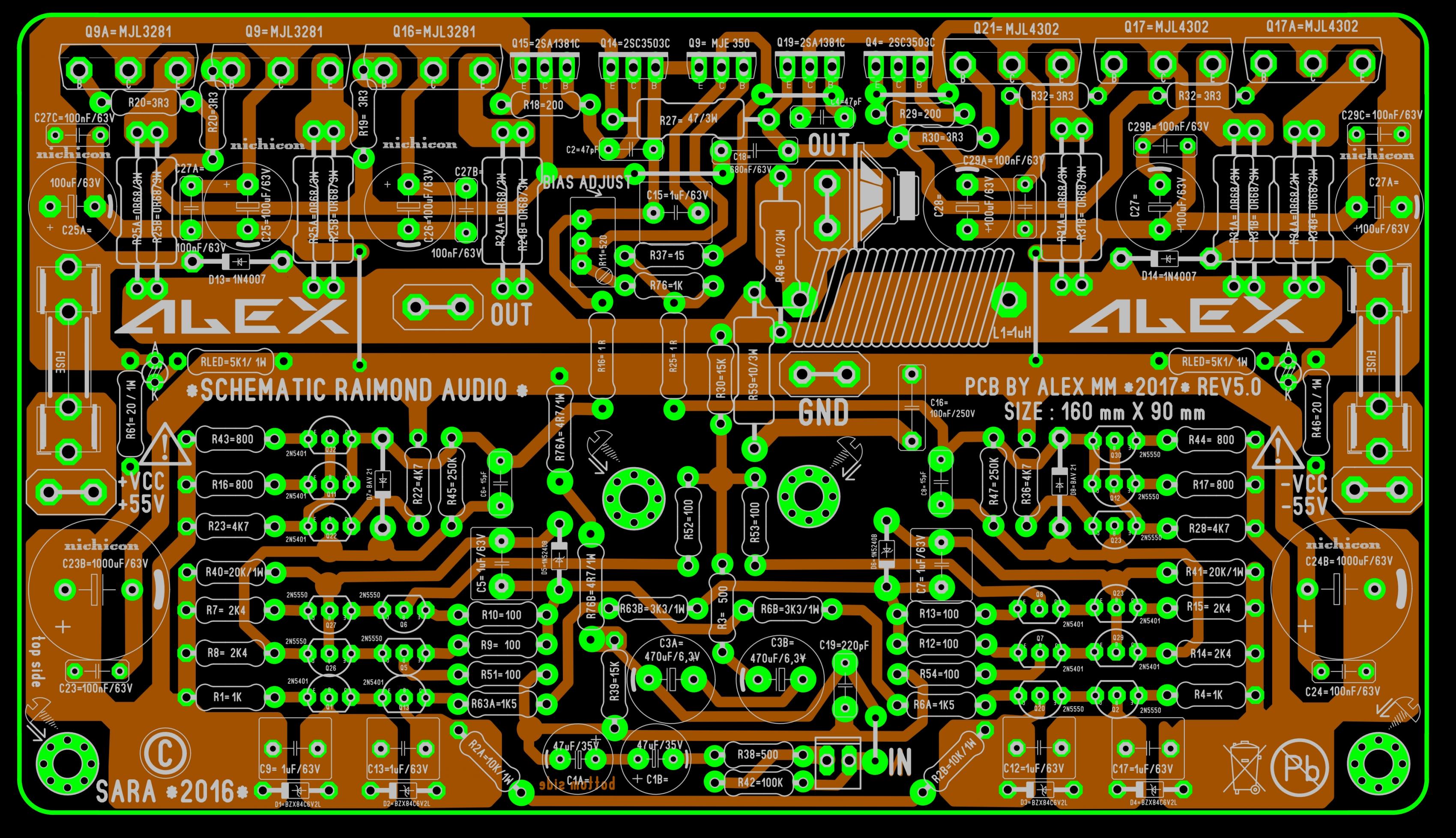

Have layout another PCB for the same schematic with OT in line ....not tested 🙂

Hi Alex,
A very nice circuit board. Great work. I would like to use the circuit board. However, with 3 pairs of output transistors. I will transfer the board to Sprint layout.
Gerd

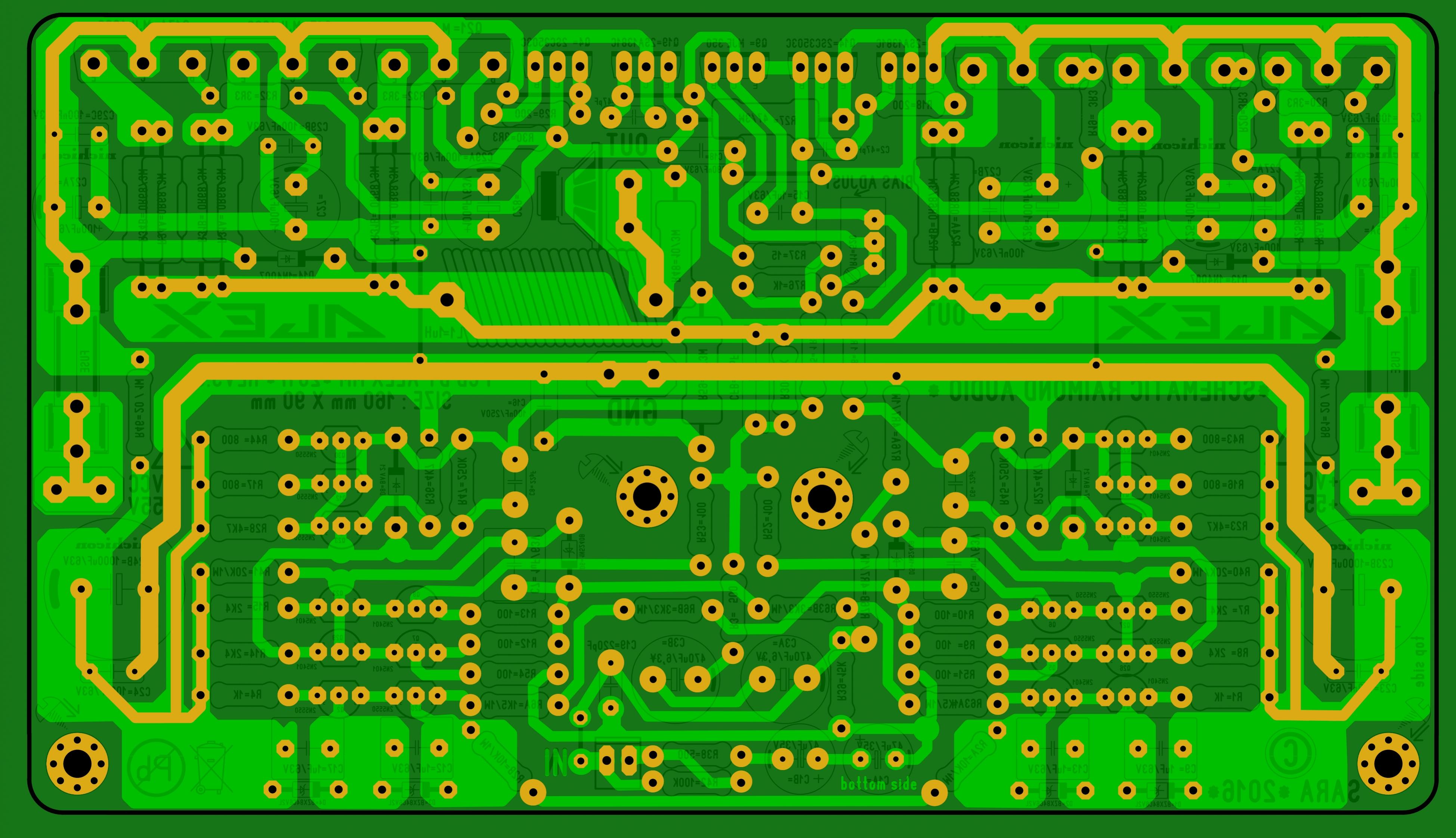

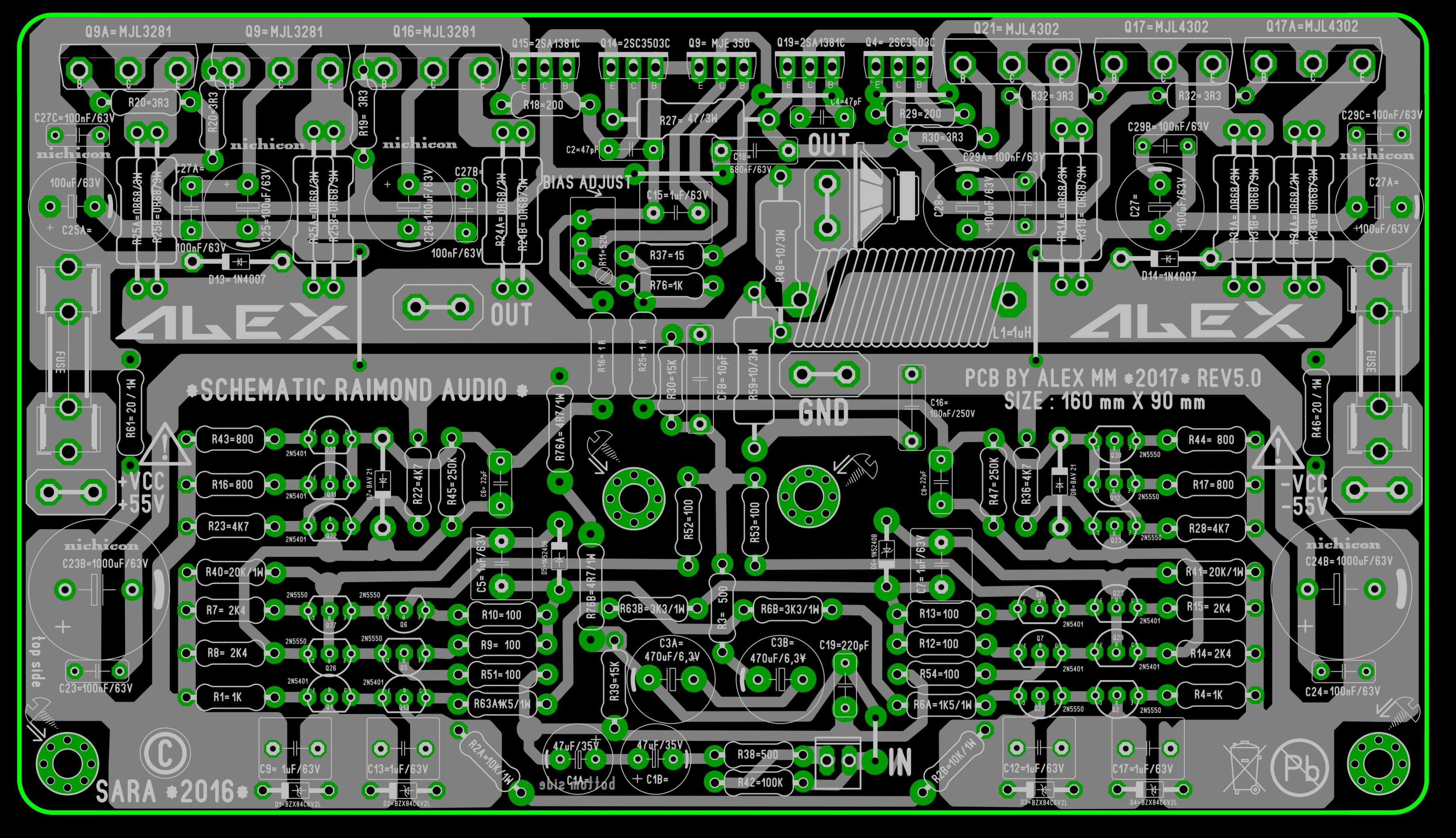

Schematic v.2 and PCB rev.5
PCB layout with 3 OT in line 😉 It's a beautiful, singing, amplifier ,I love it. 😀
Regards,Alex

Good you are back, Alex!
Every new pcb brings a smile to all of us! I always print it off in colour then walk to my local café for a careful examination with strong coffee........ always a pleasure.
Beautiful work, congratulations to our resident da Vinci........
