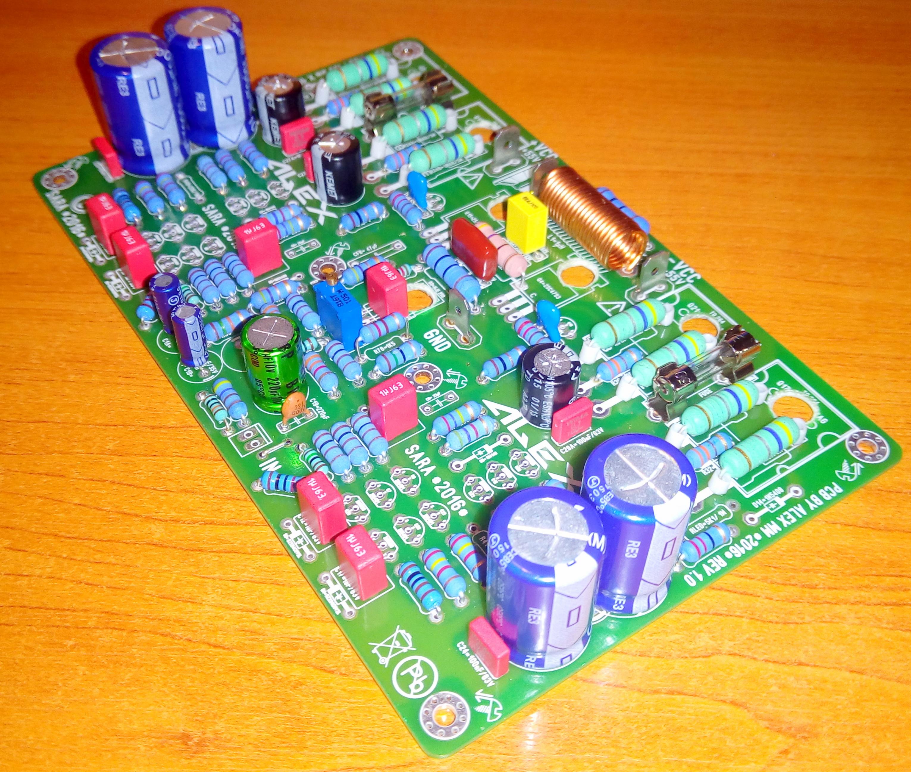

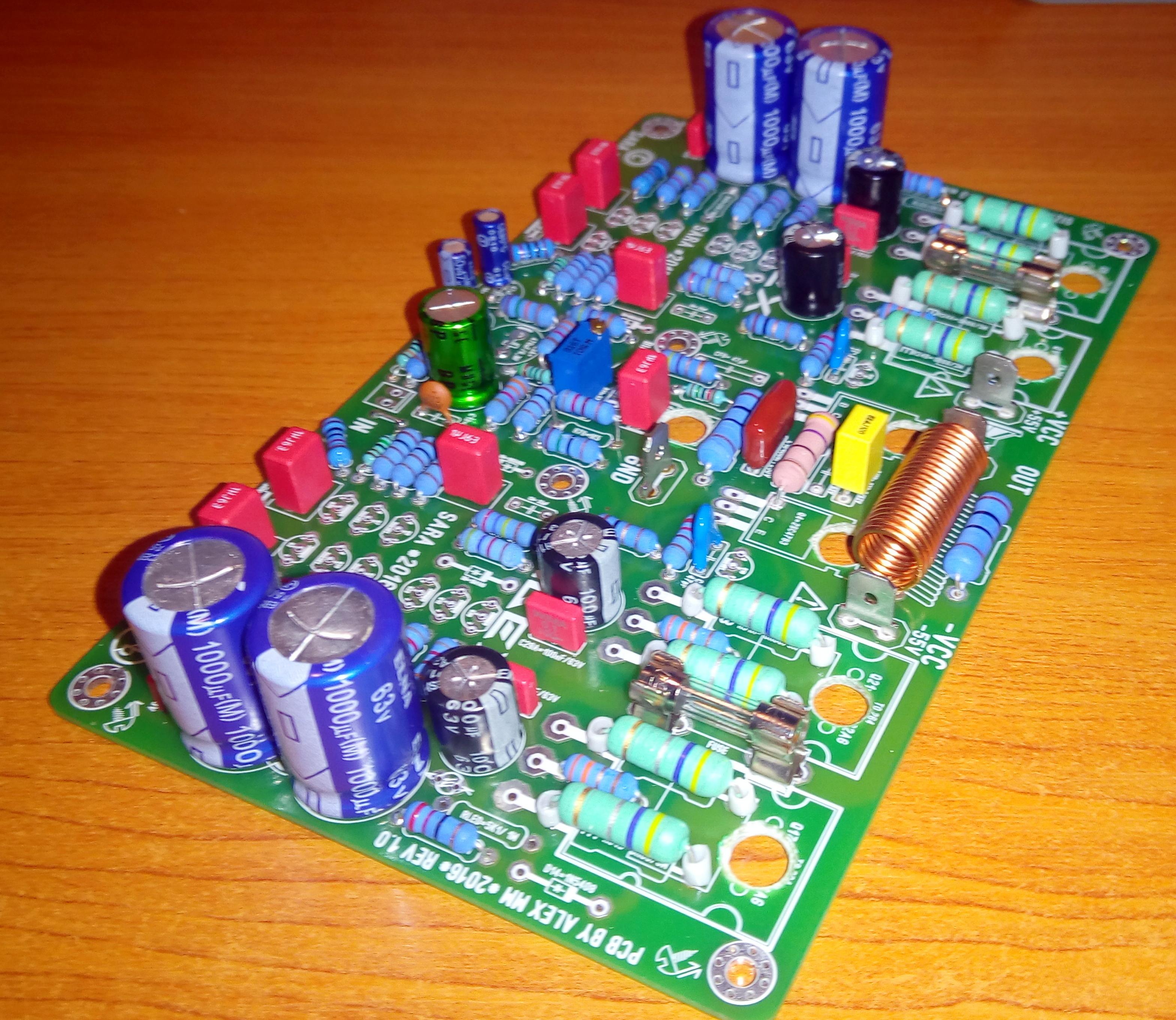

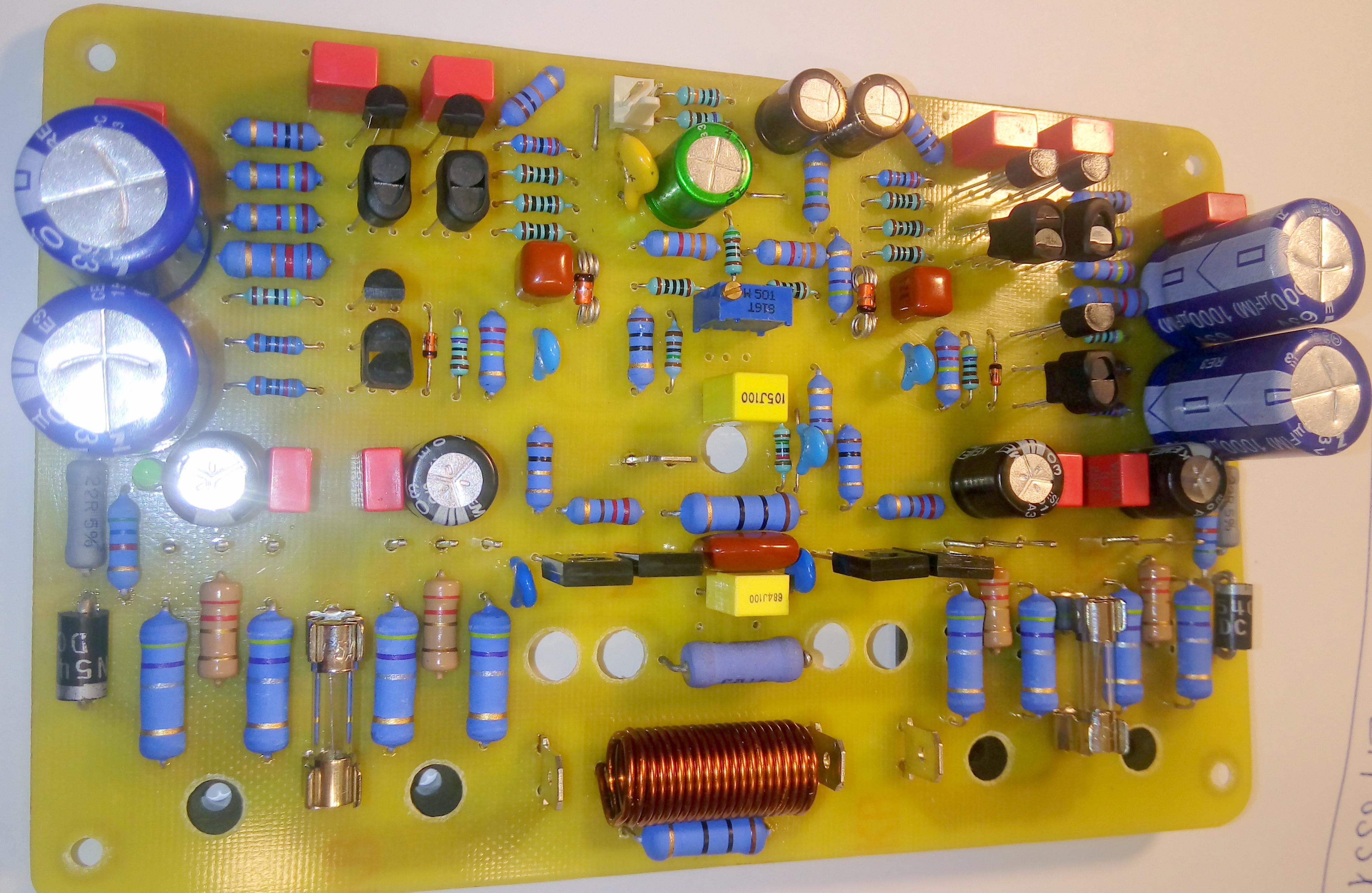

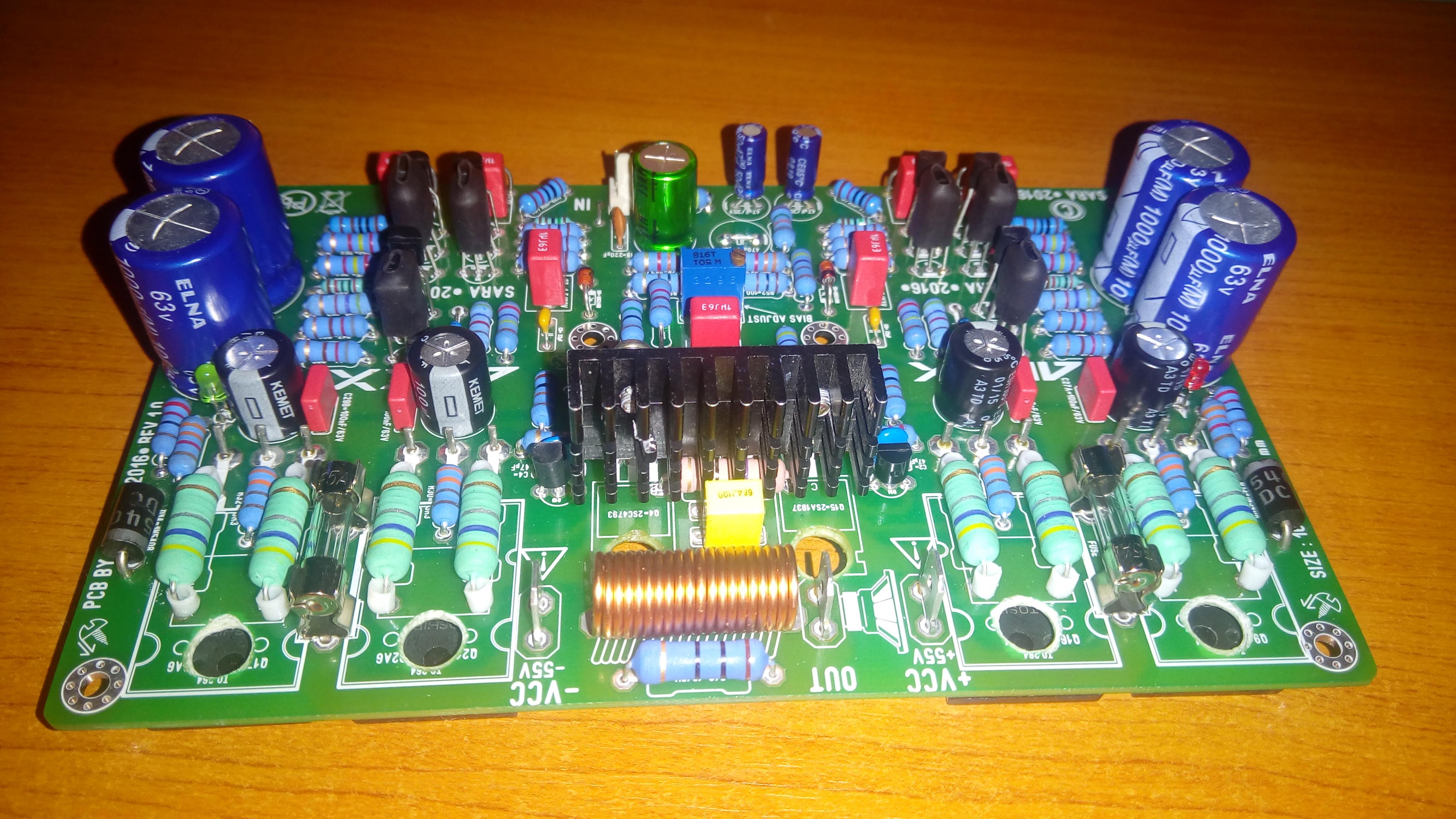

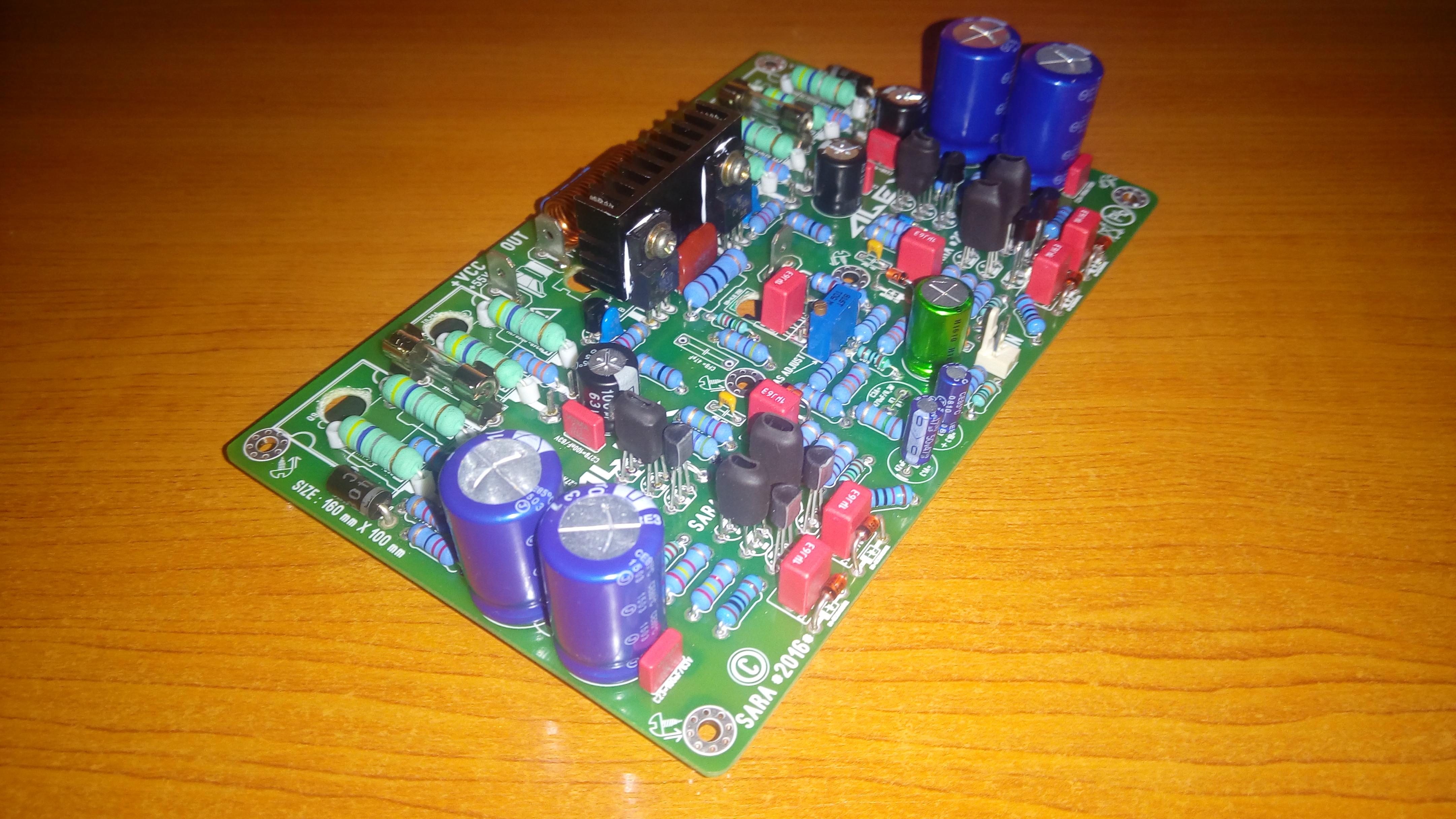

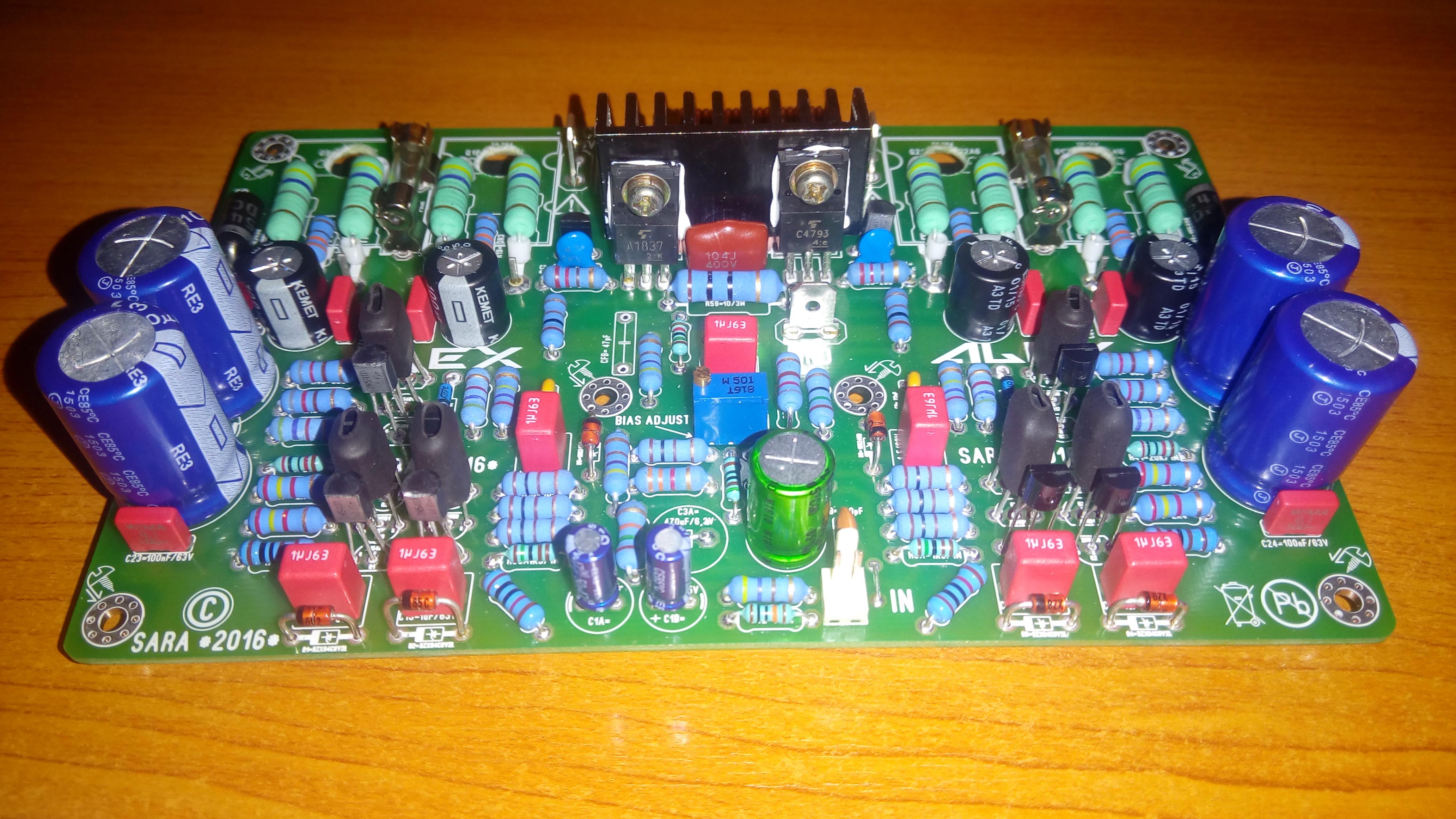

Stil missing parts...😱 Input capacitor, now changed ,to bipolar one , thermally coupled pairs on input transistors . 🙂
Regards,Alex
Regards,Alex

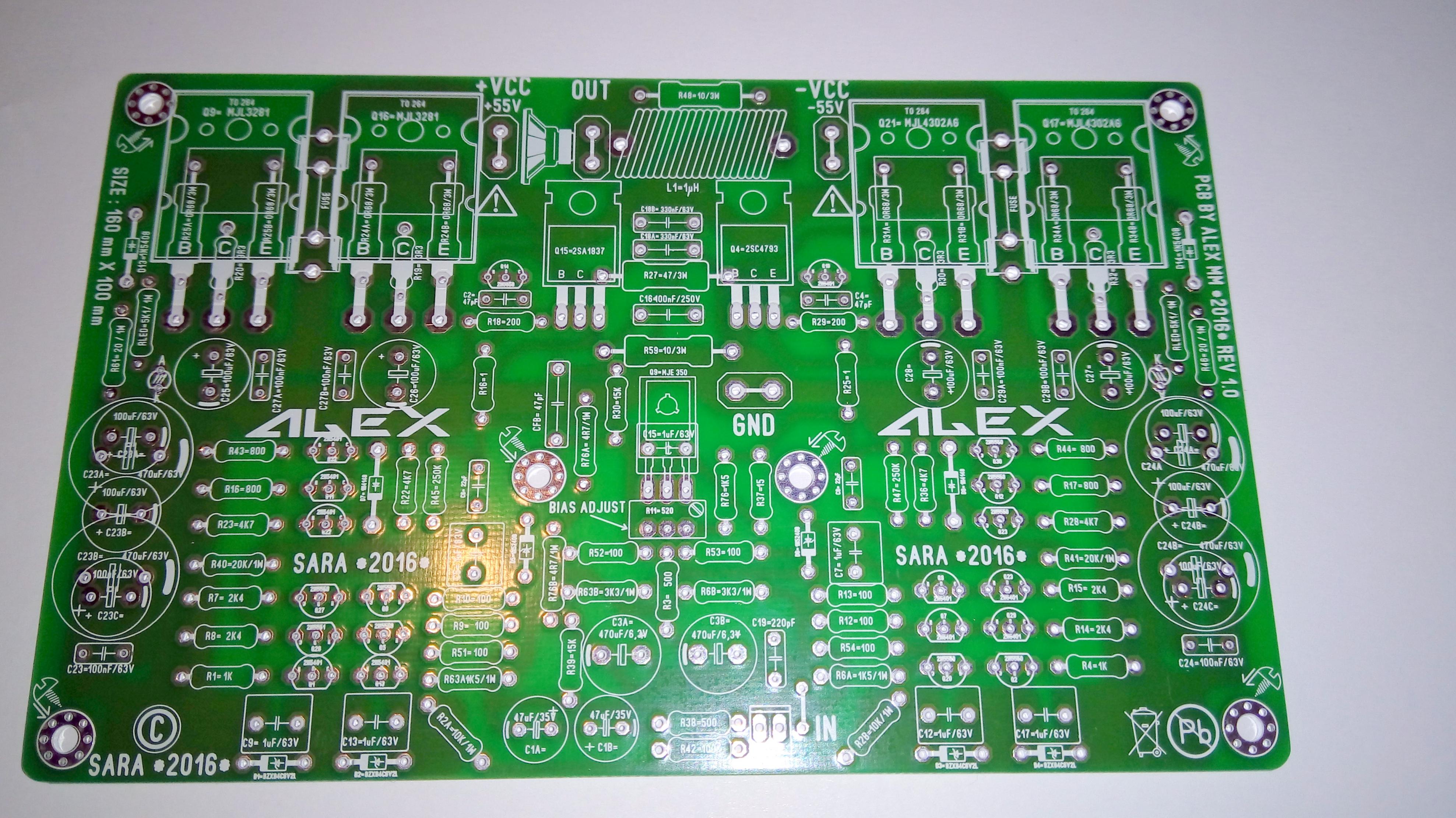

SARA 2016 v2 in progress ....🙂 just missing some parts as usual .....😉

Hand made at home ....🙂
Regards,Alex

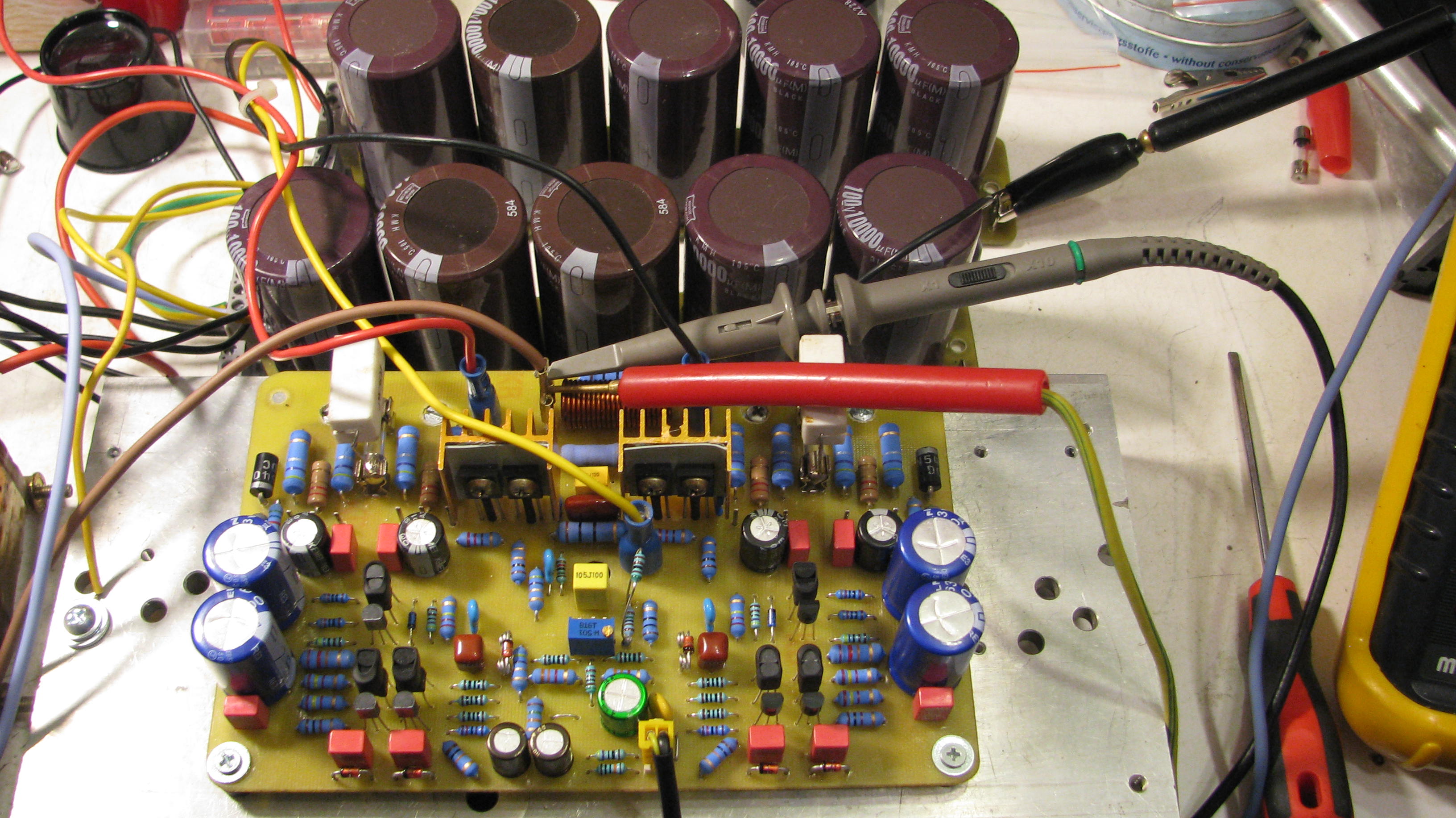

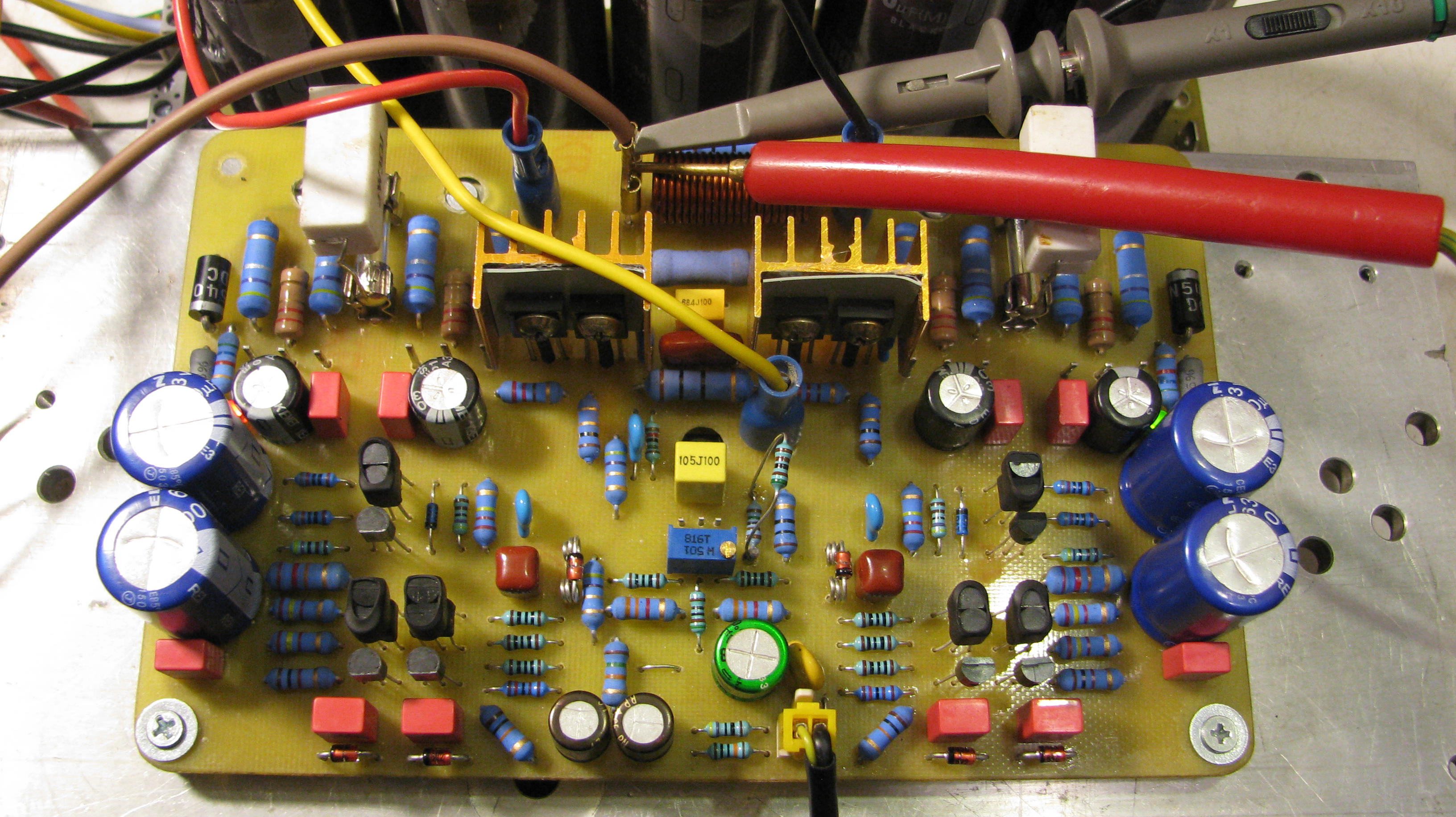

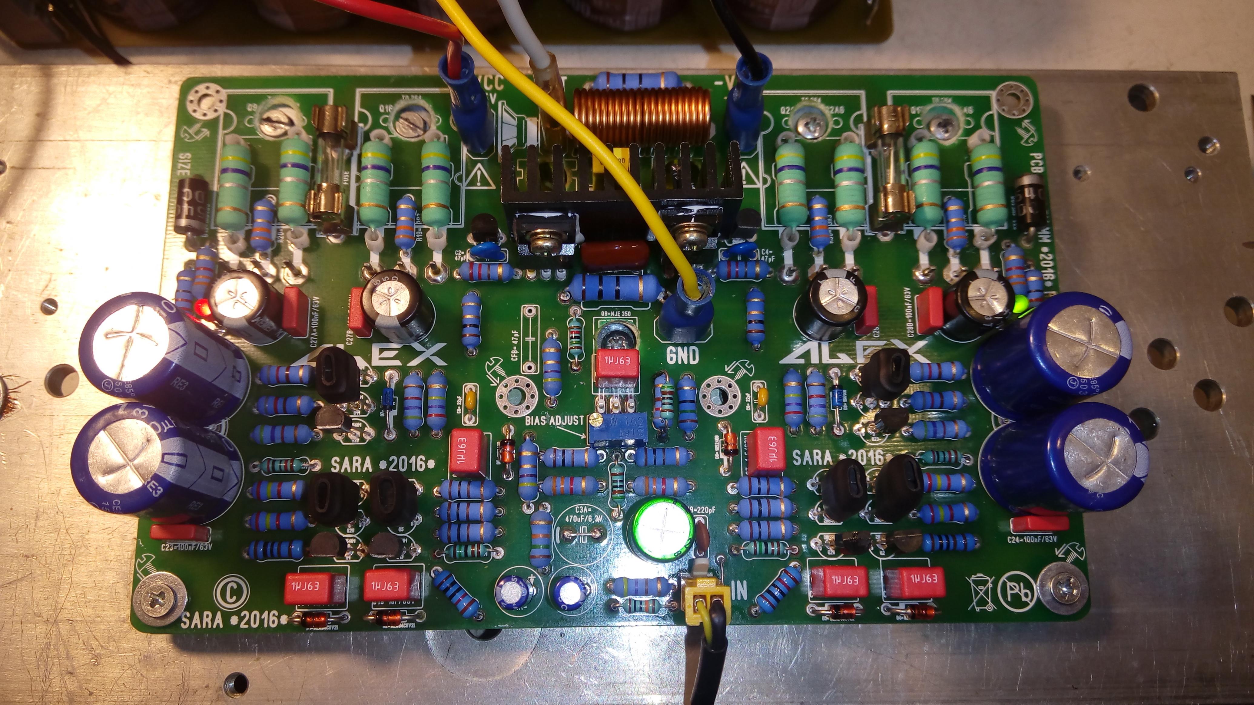

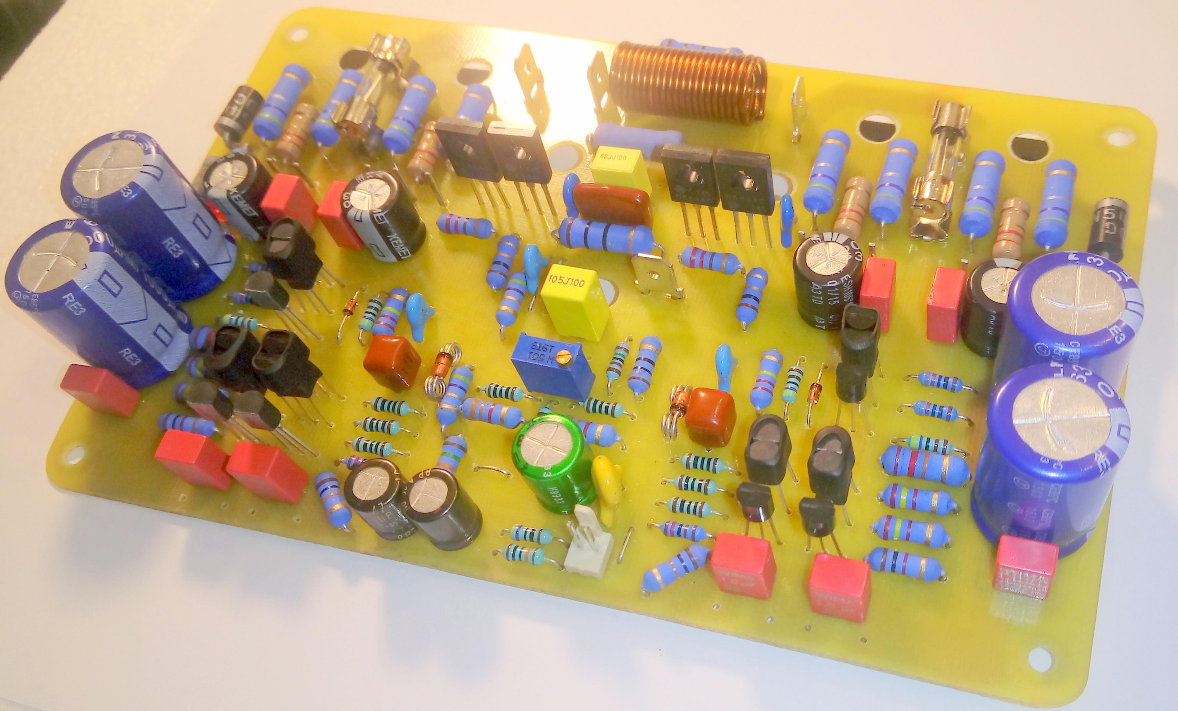

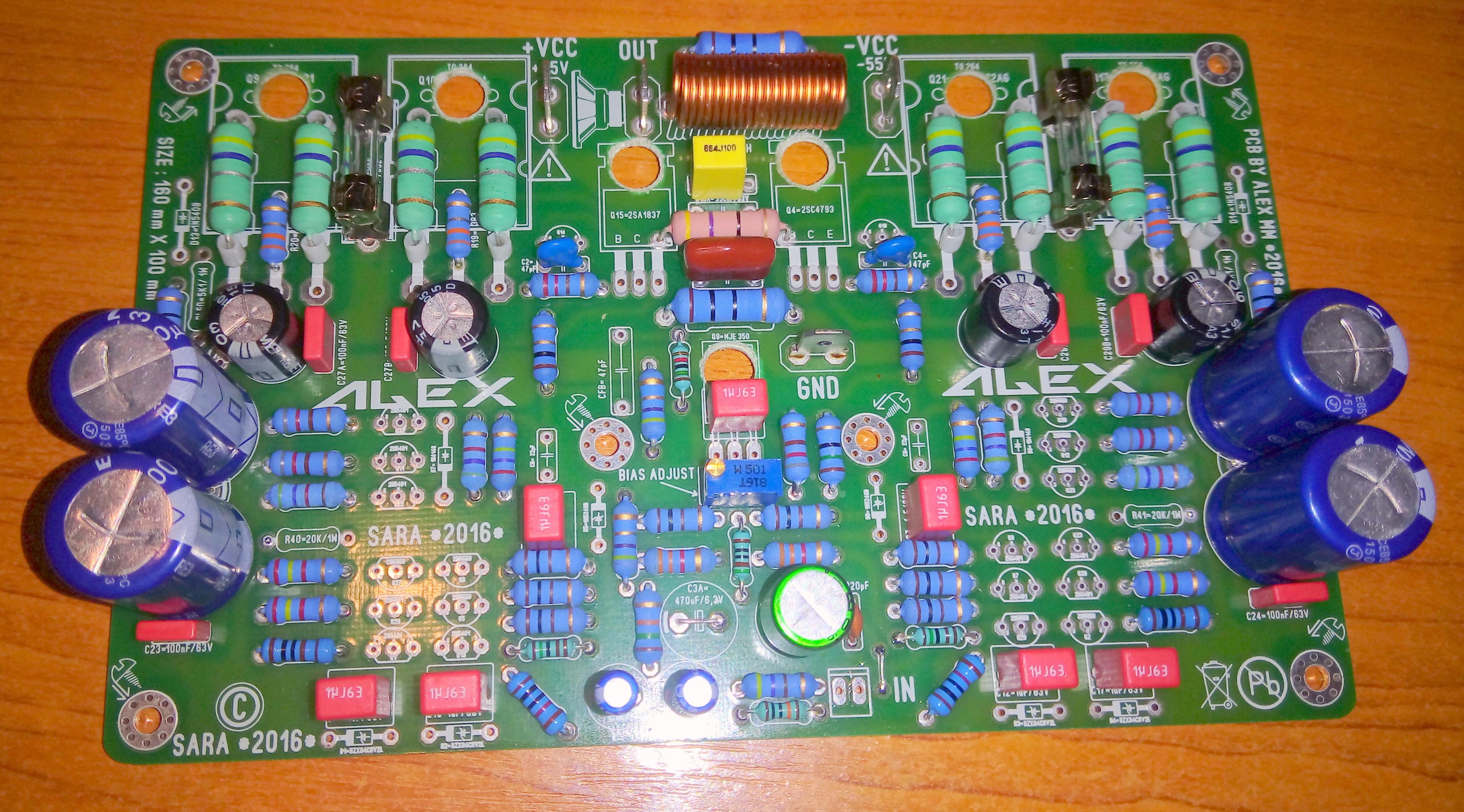

Finally I got the last components .....😉
Regards,Alex

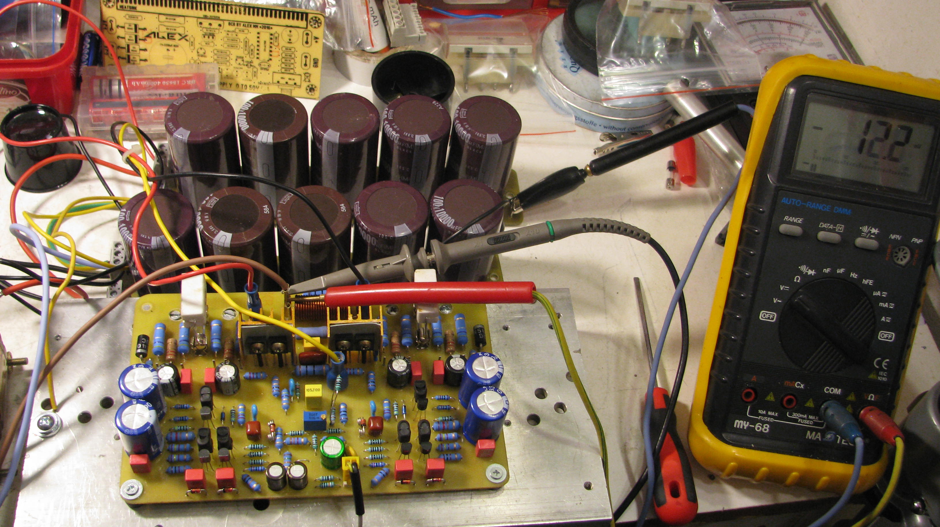

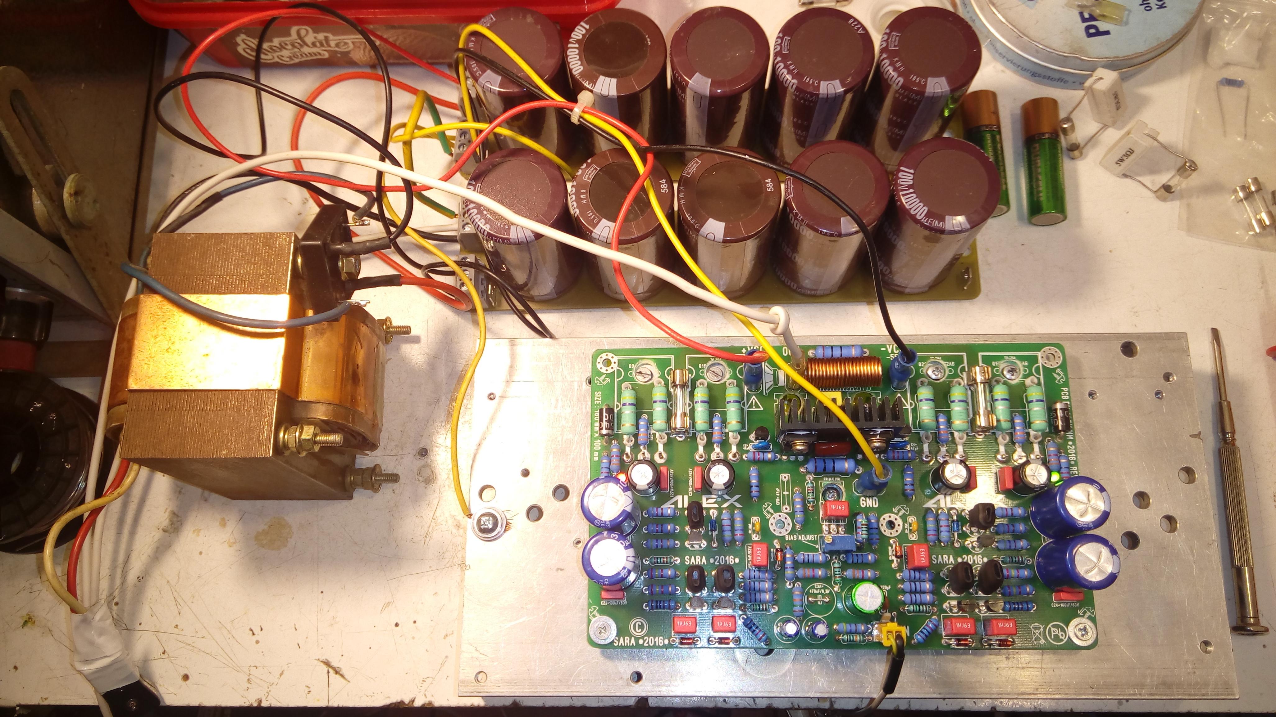

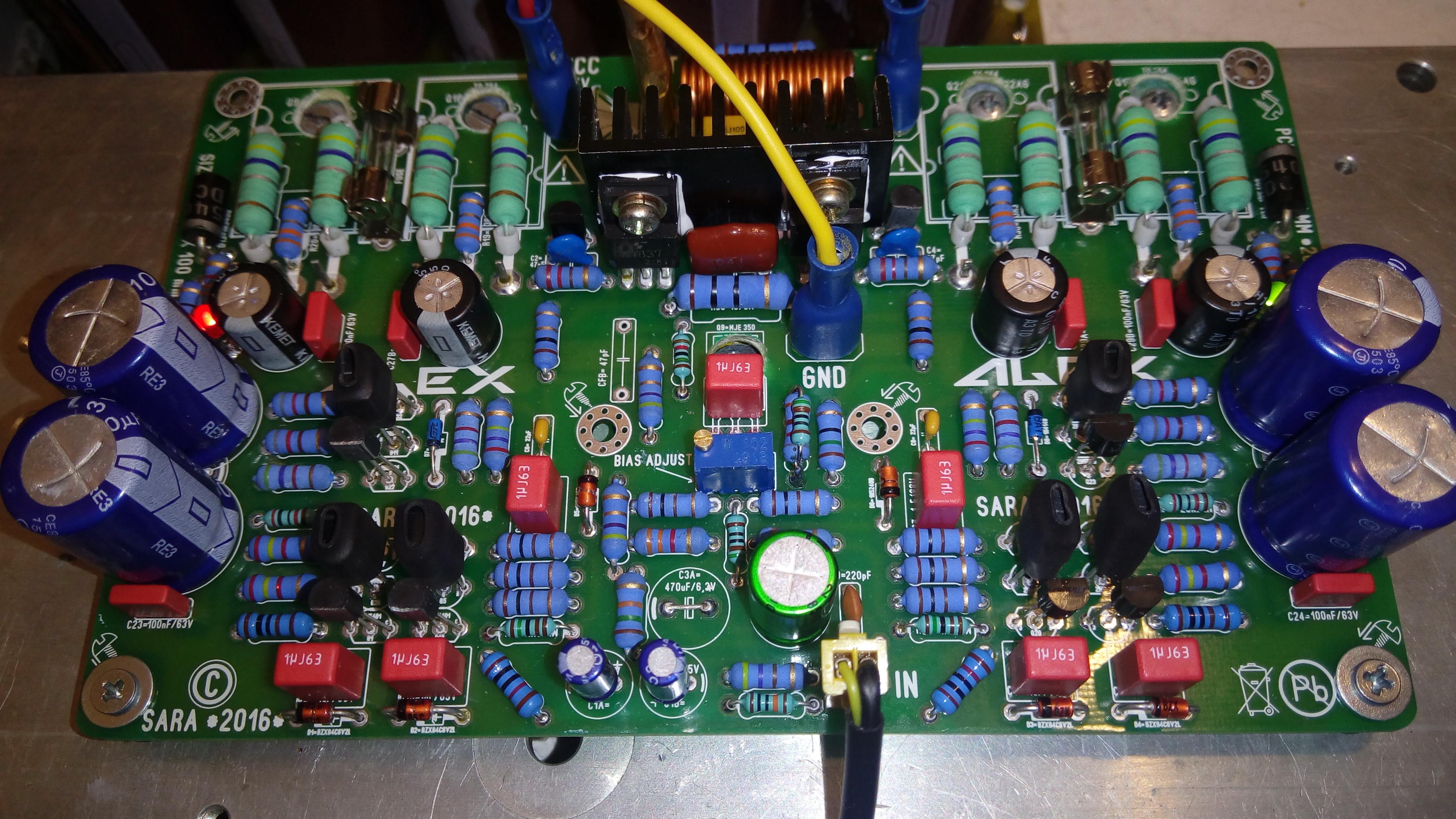

SARA 2016 - tested
Happy new year ! to all .
Good news 😀 ,I have tested SARA 2016 with success ,it's a live and playing well.
Power rail supply only for testing +/-35V , load 6 ohms , offset 10 to 12 mV .
Ton correction, not used ,at all in this case . Short movie with amplifier in use ..... https://www.youtube.com/watch?v=KG_K_8rEDu0 😉
Regards ,Alex

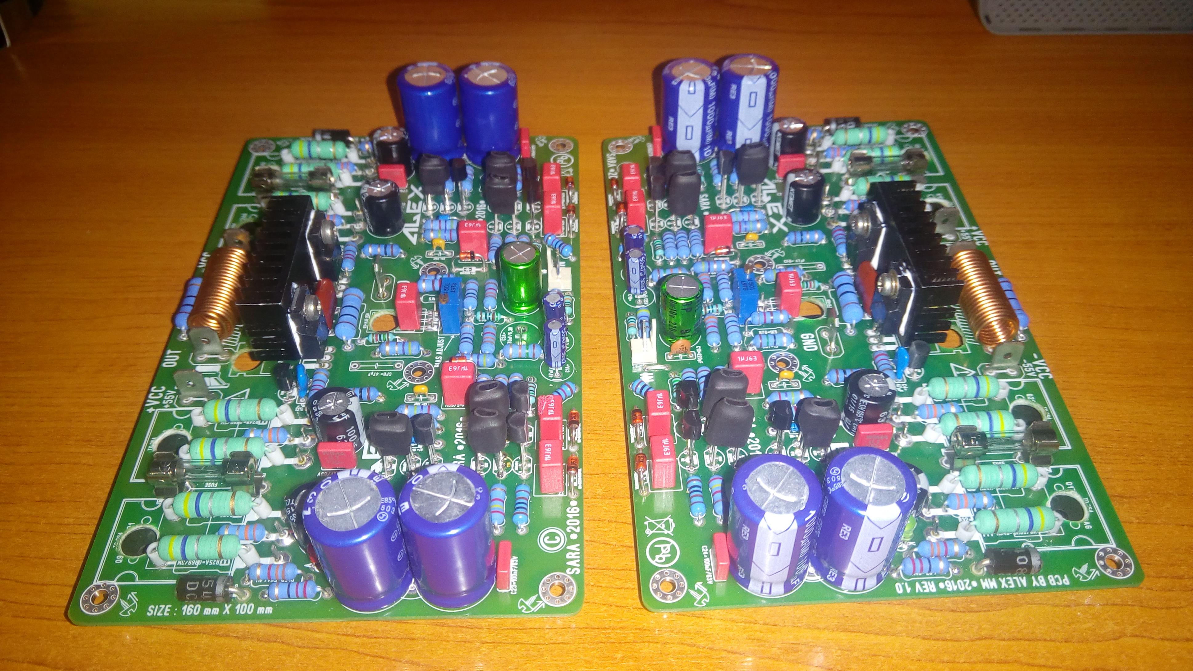

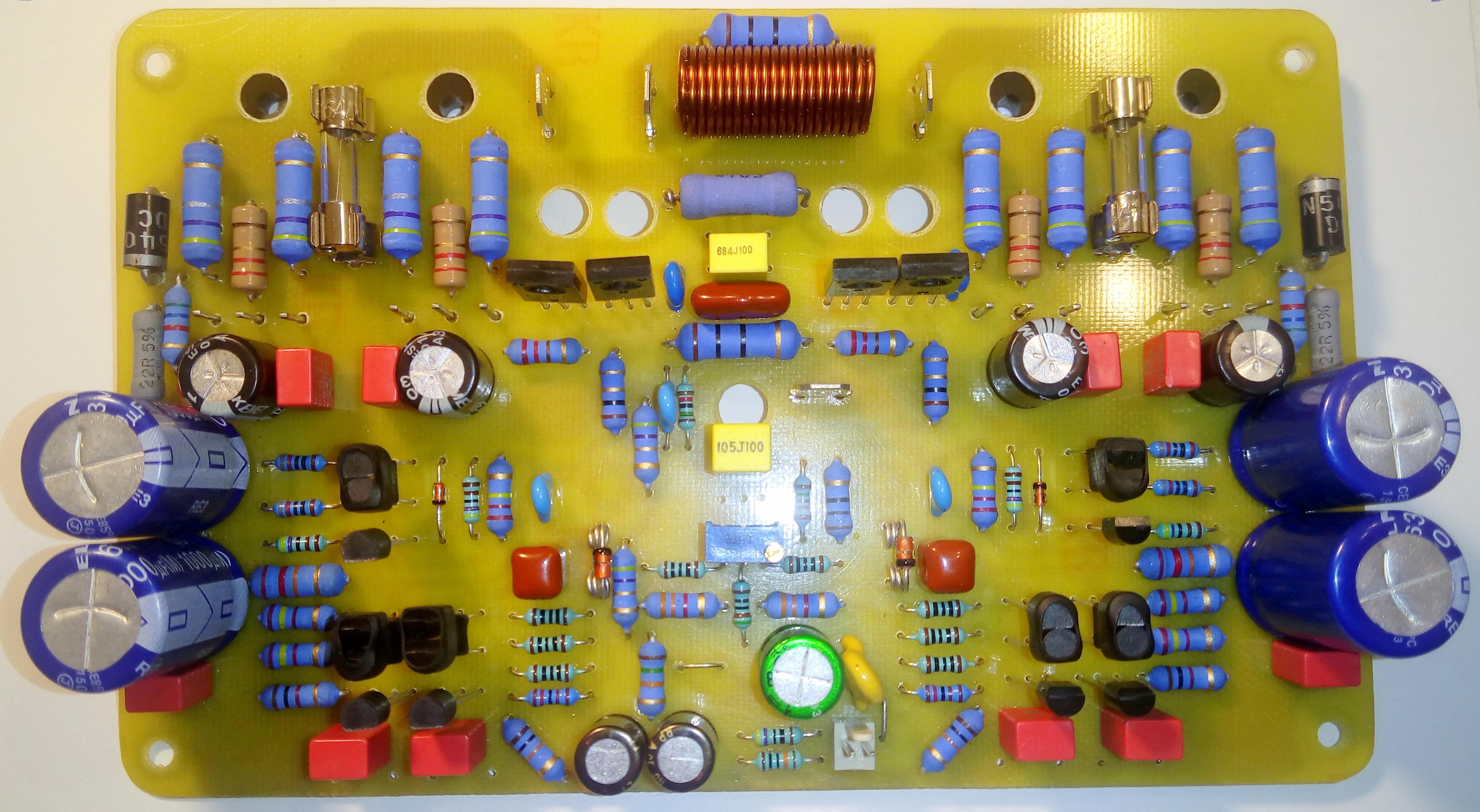

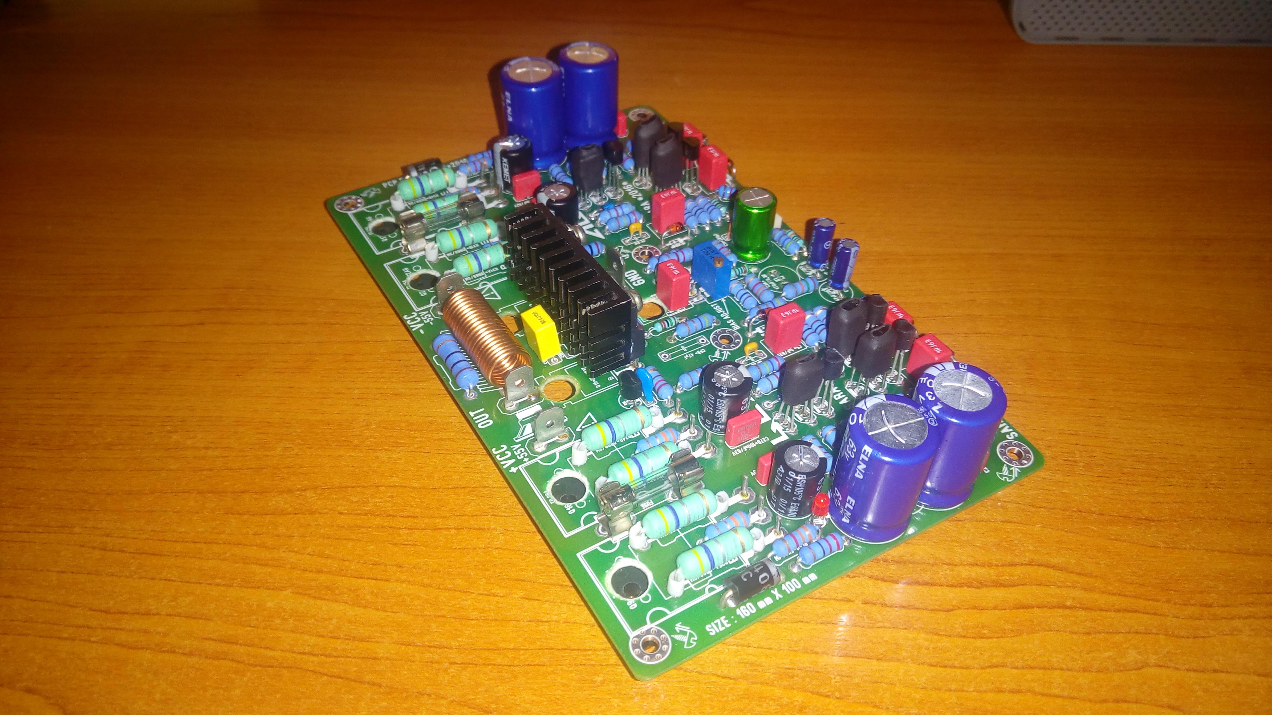

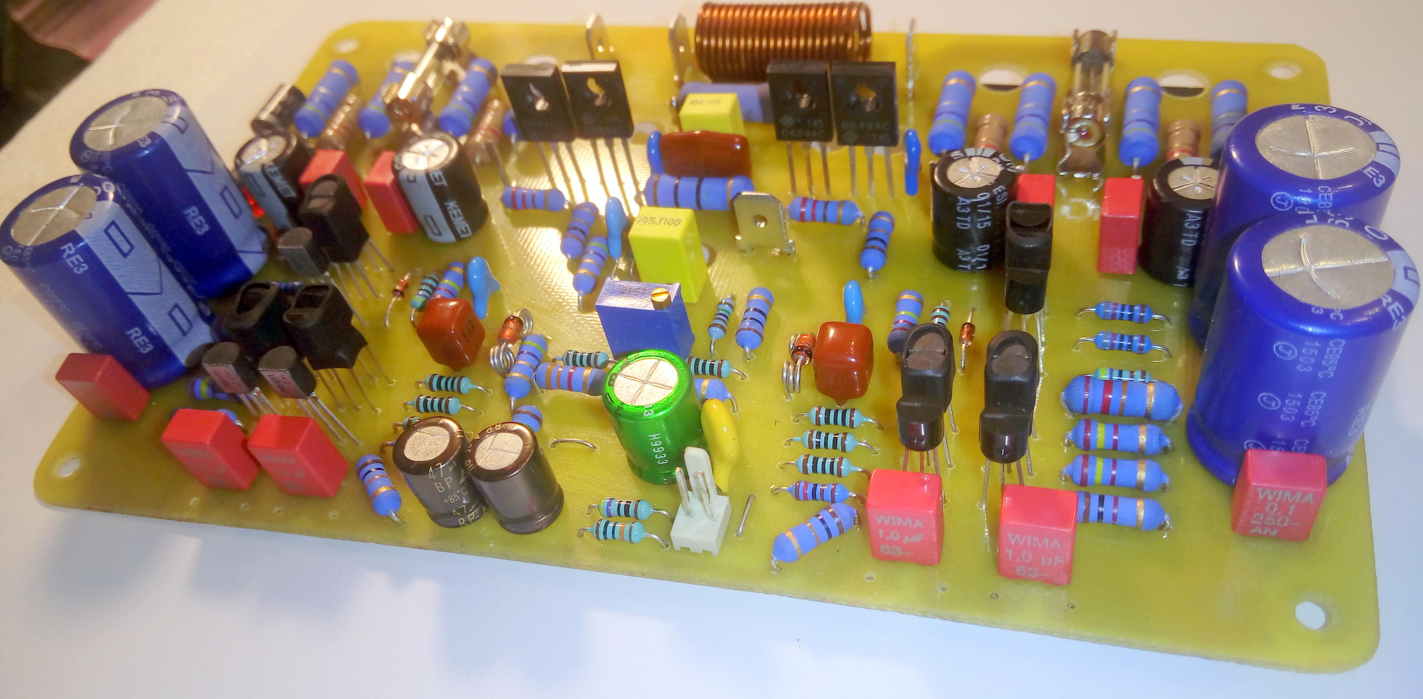

Finished ,populating boards with components 🙂 will test soon 😉
Regards,Alex

Great amp.
If it only half that good as simulation, is still great.

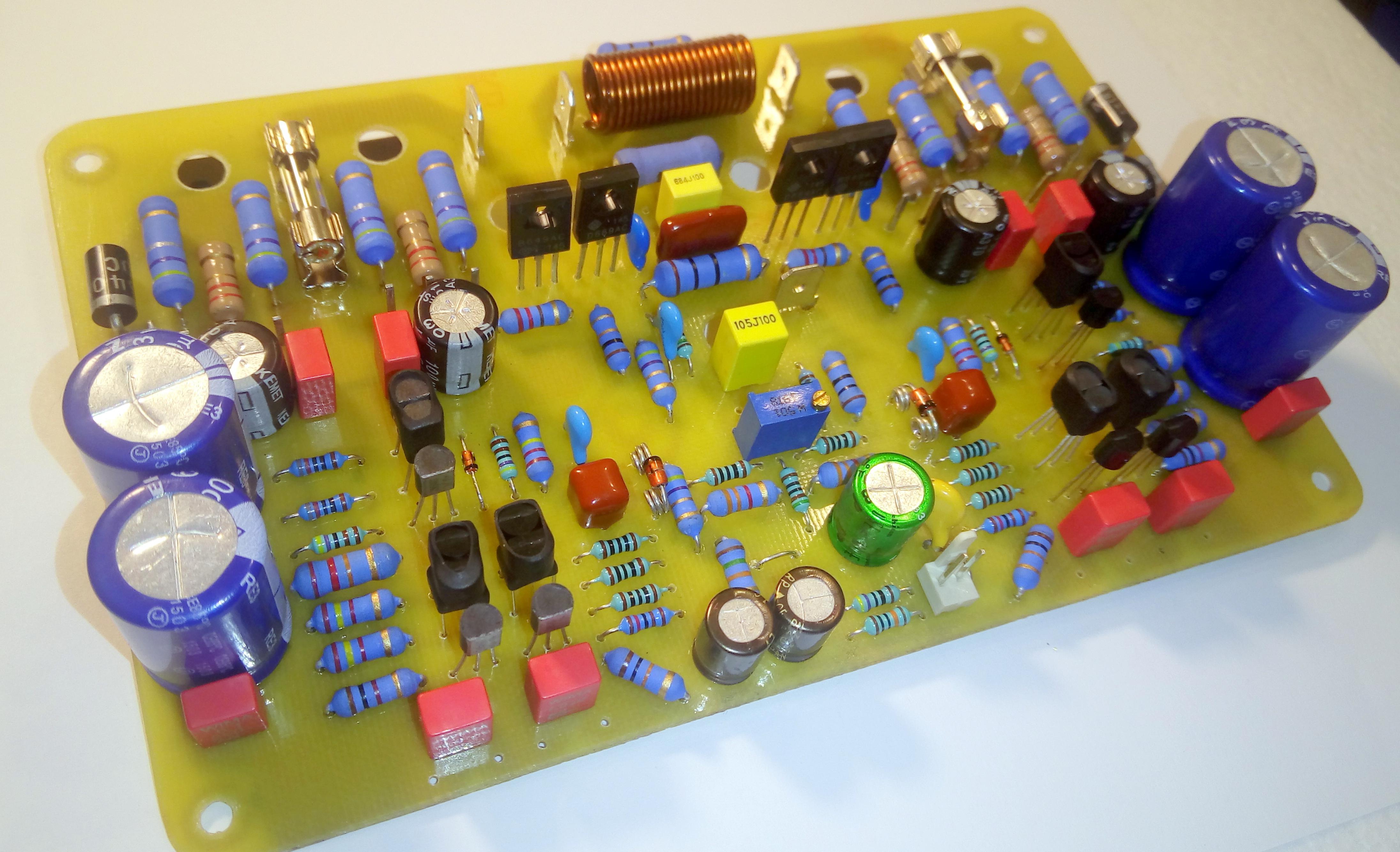

In my opinion CCS-s (Q1, Q2, Q13, Q20) are too complicated. They are effectively bypassed by R40 and R41. You can replace them (CCS) by resistors, like in Leach Amp, and performance would not be affected too much.

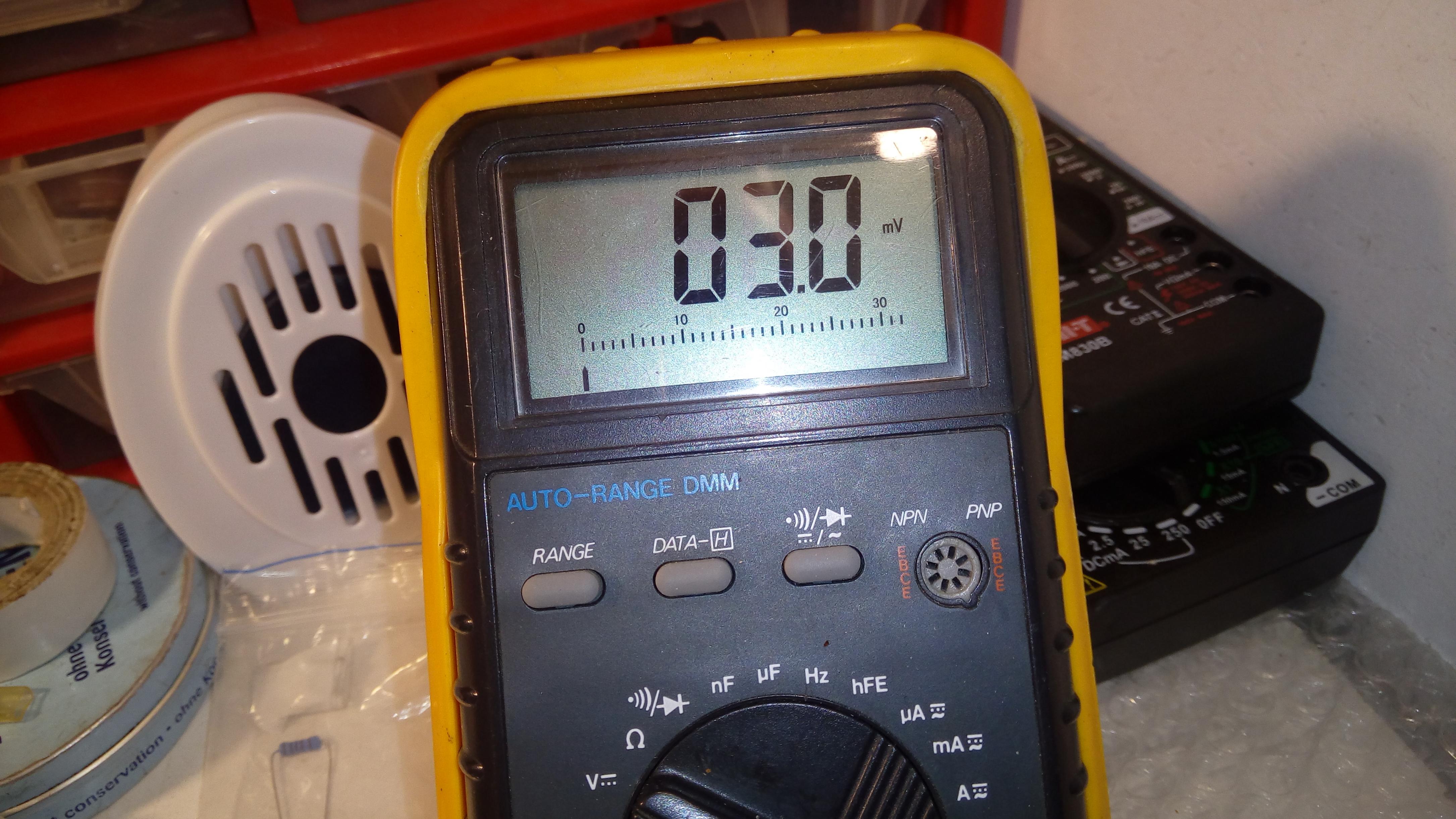

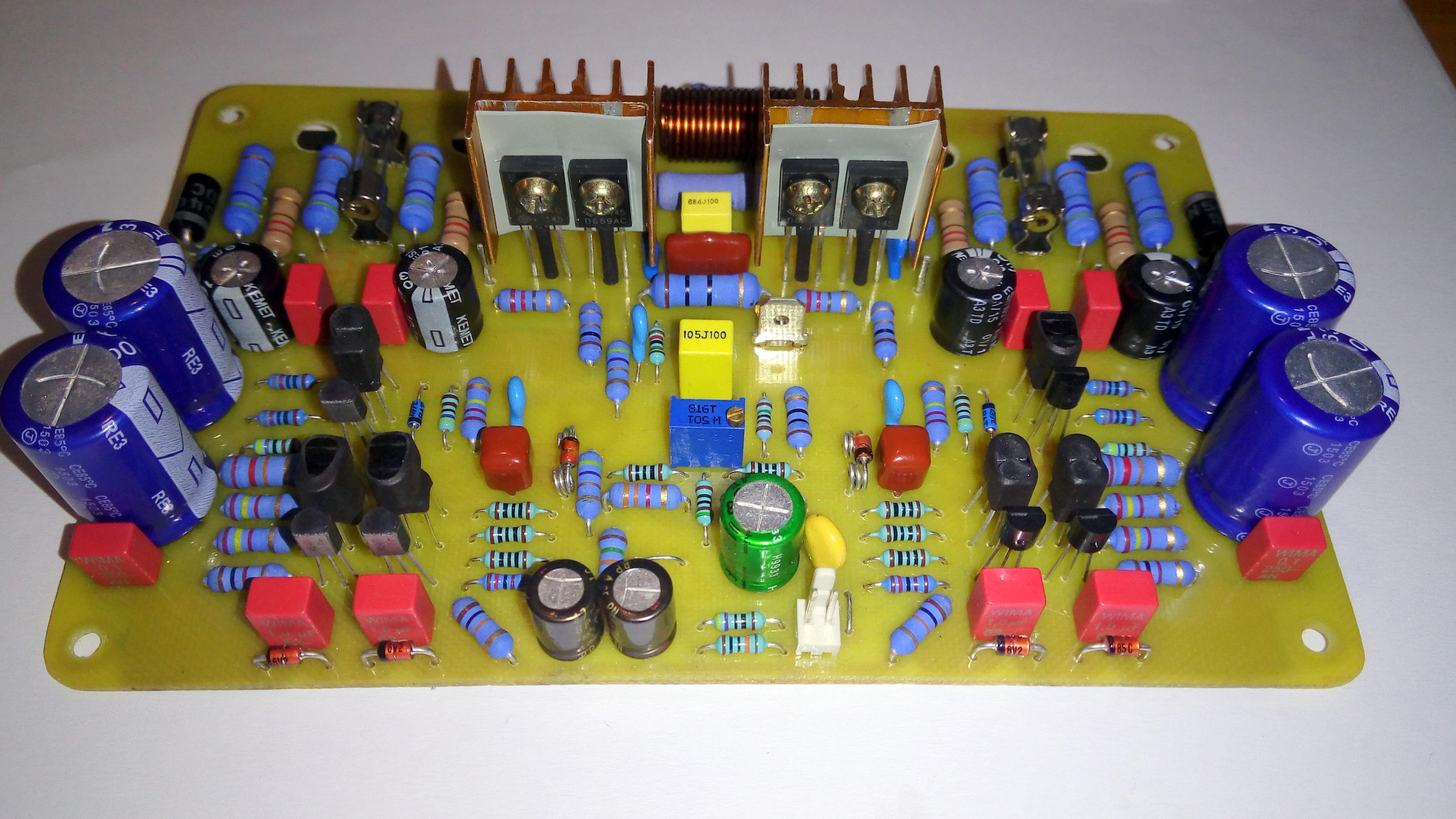

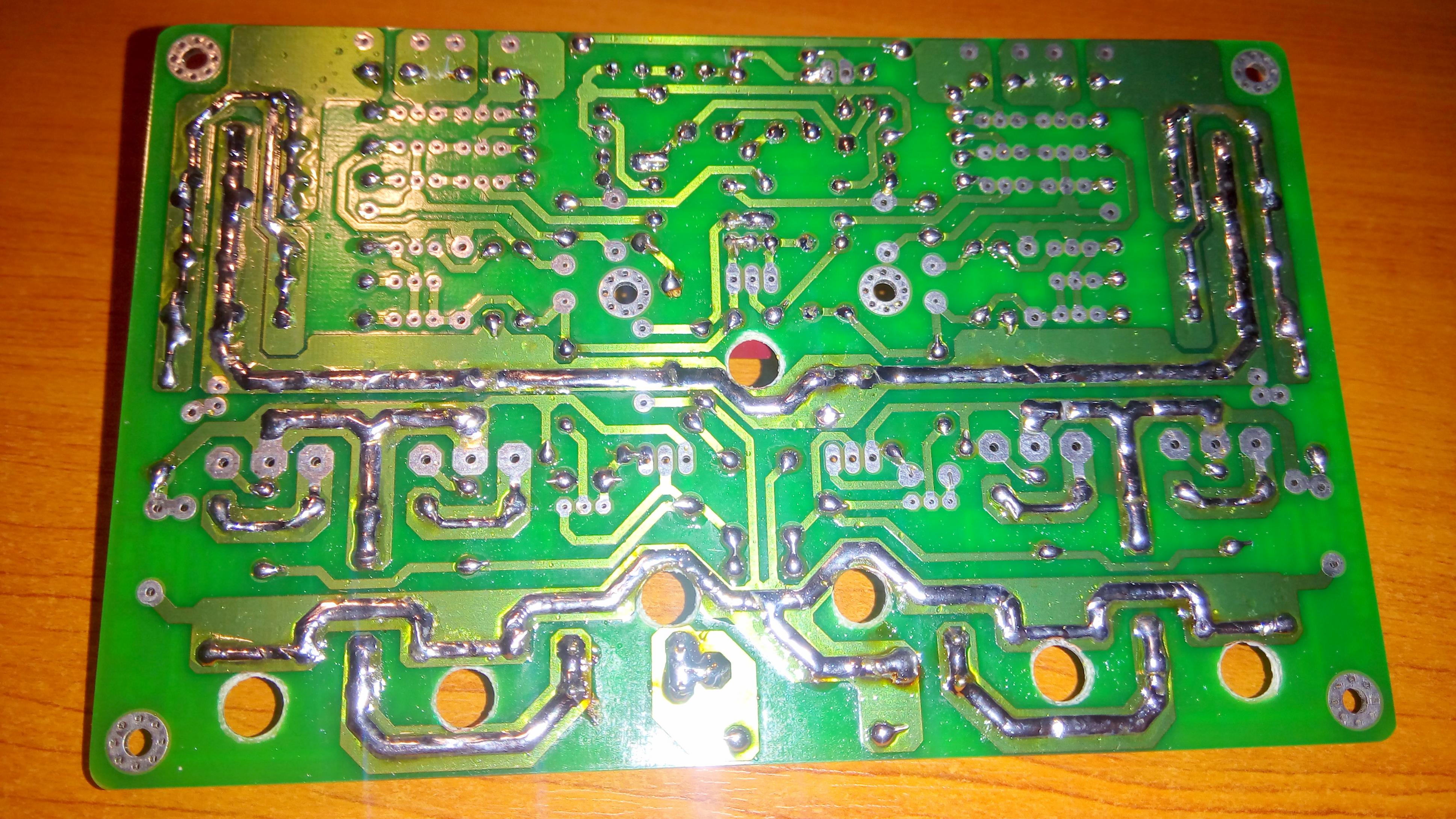

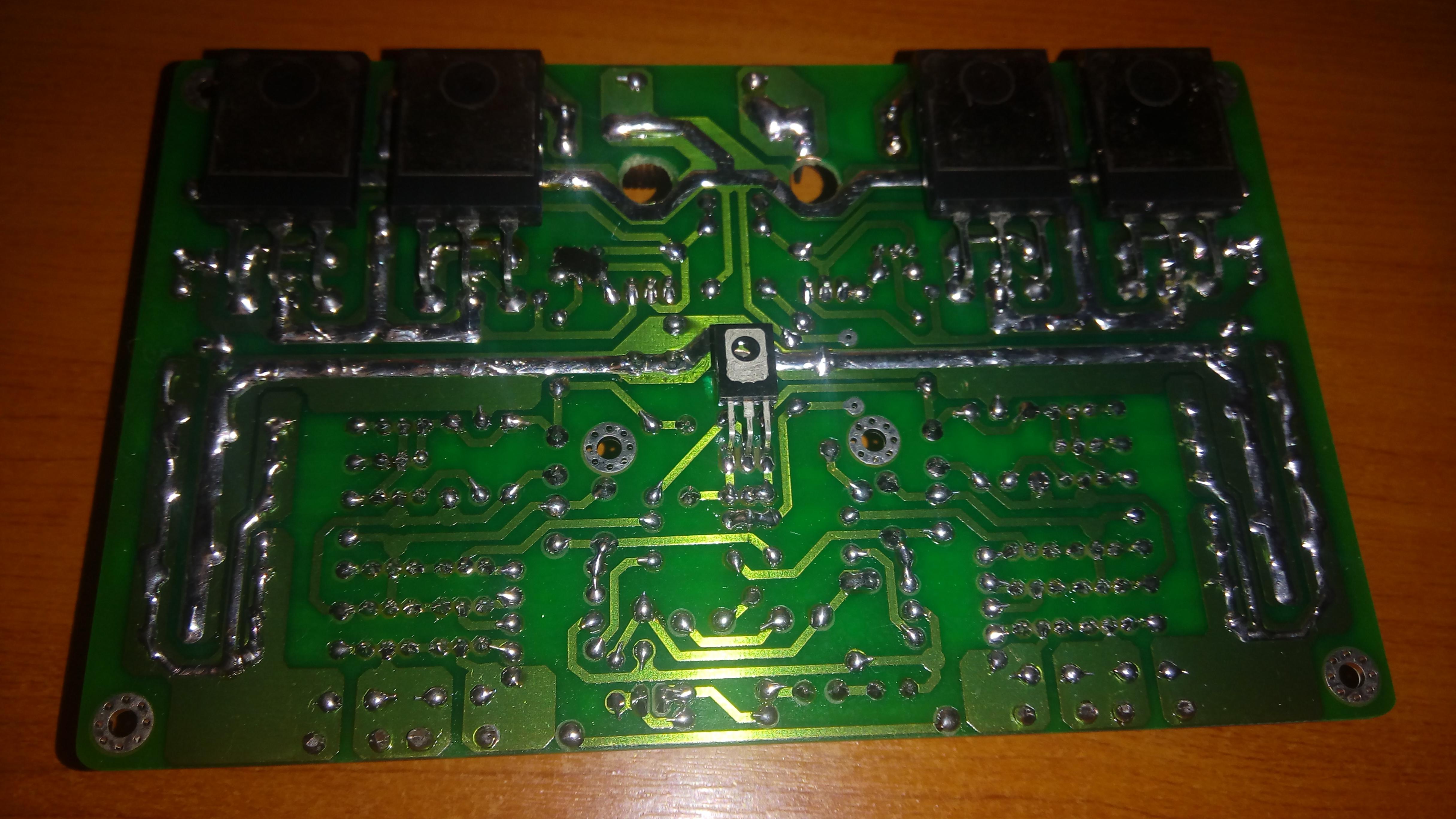

I'm only builder of the amplifier 🙂 Tested also SARA 2016 v.1 and work very well , offset only 3mV 😀 Some pictures ..... 😀
Regards,Alex
Nice work!I'm only builder of the amplifier 🙂 Tested also SARA 2016 v.1 and work very well , offset only 3mV 😀 Some pictures ..... 😀

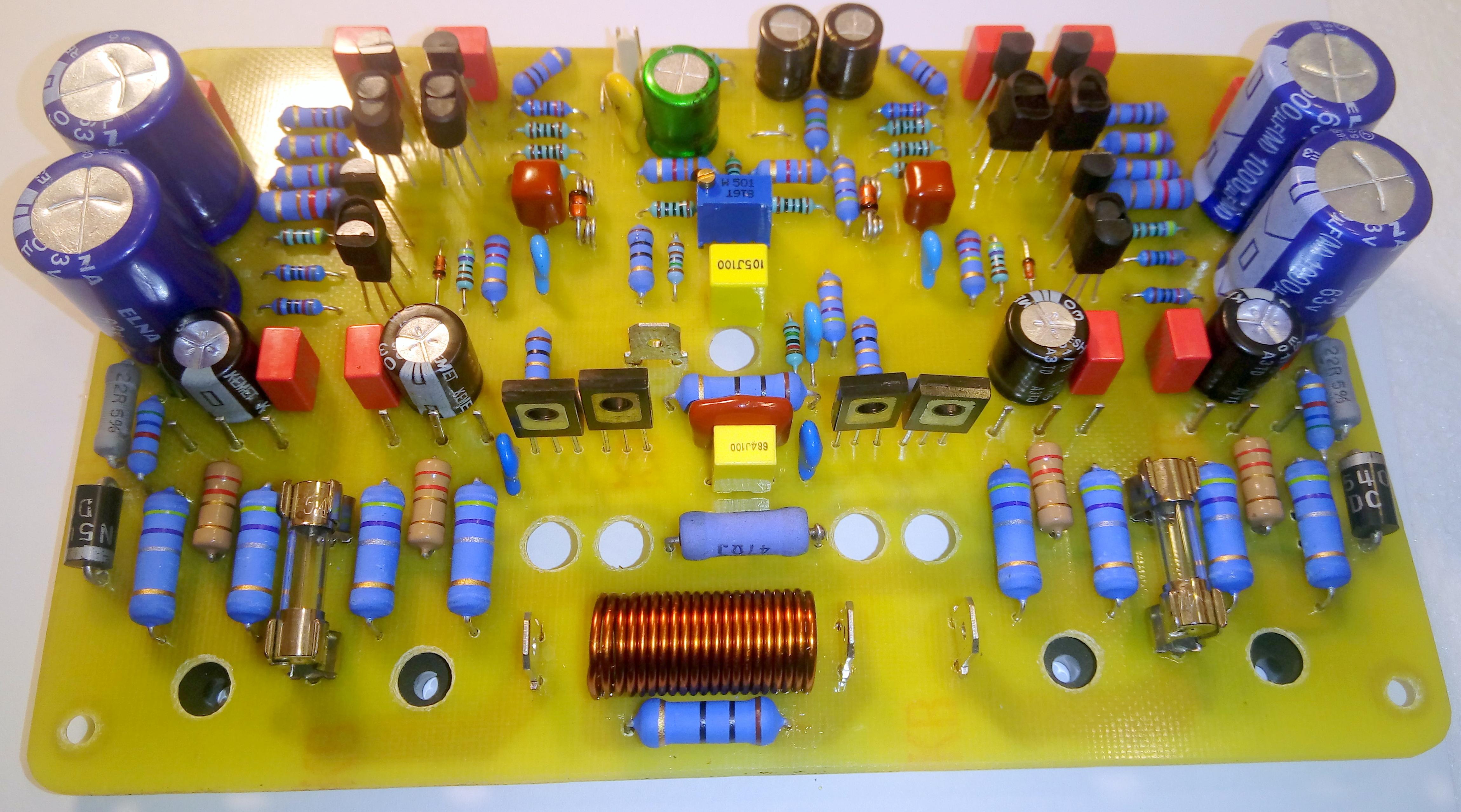

Is it any reason you are using metal oxide 1W resistors?
Nice work!
Thanks, reason was only quantity limit of order , for 0.6 watts minimum was 100 pieces ,and for 1W was only 20 pieces .😉

Yes, you could replace the CCS's with resistors, no problem, but you will lose most of the "constant" of the current from the input stage. For better work, R40 and R41 could be replaces with CRD diodes. In fact, initially, in SARA-2012, there was again another CCS's in that places but I removed them because the schematic was too complex. The CRD's could be the most right parts there. Simple and effective.
The cascode of the CCS ensure a very high impedance and a great input stage immunity against noise of the rails.

Currents provided to diff pairs are already non-constant, because they vary with input signal, due to R40/R41. R40/R41 also makes PSRR worse.
What i wanted to say is that simple CCS with one transistor and Zener is enough. All what You get from cascoding is swamped in R40/41.
CCRD are good idea, but little too expensive (just quick look at mouser.com, maybe You have better/cheaper source).
