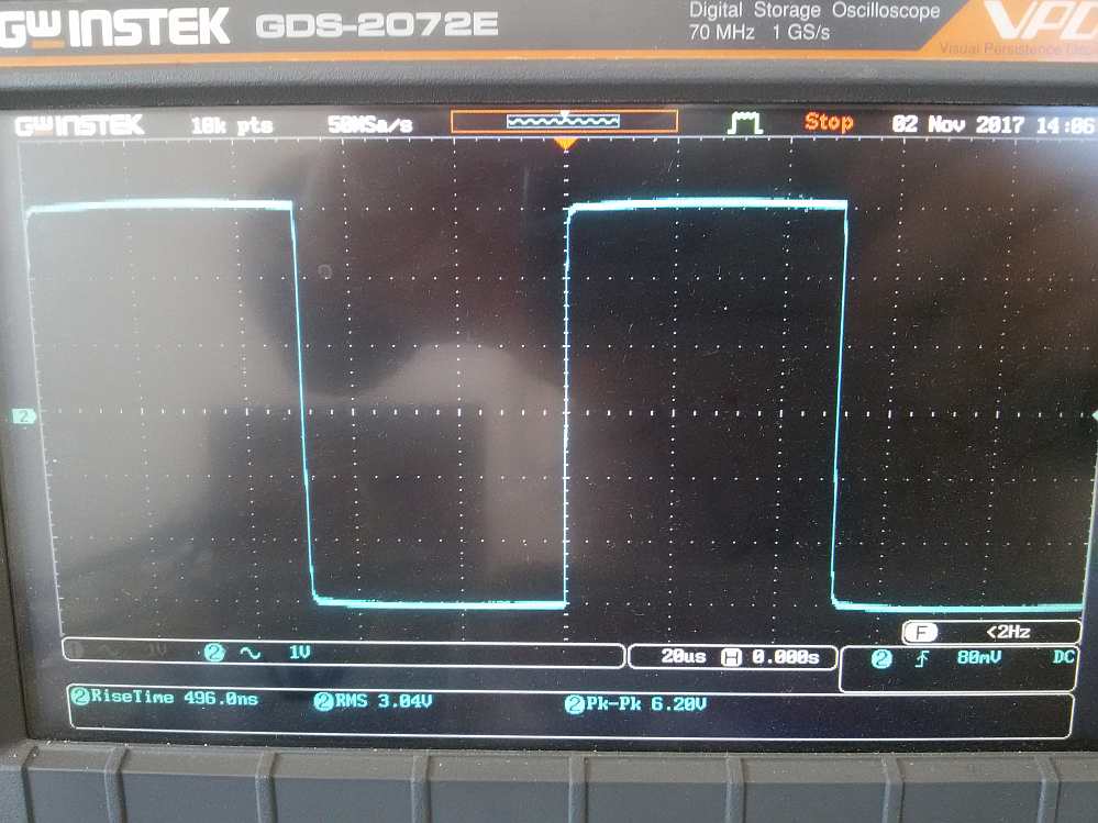

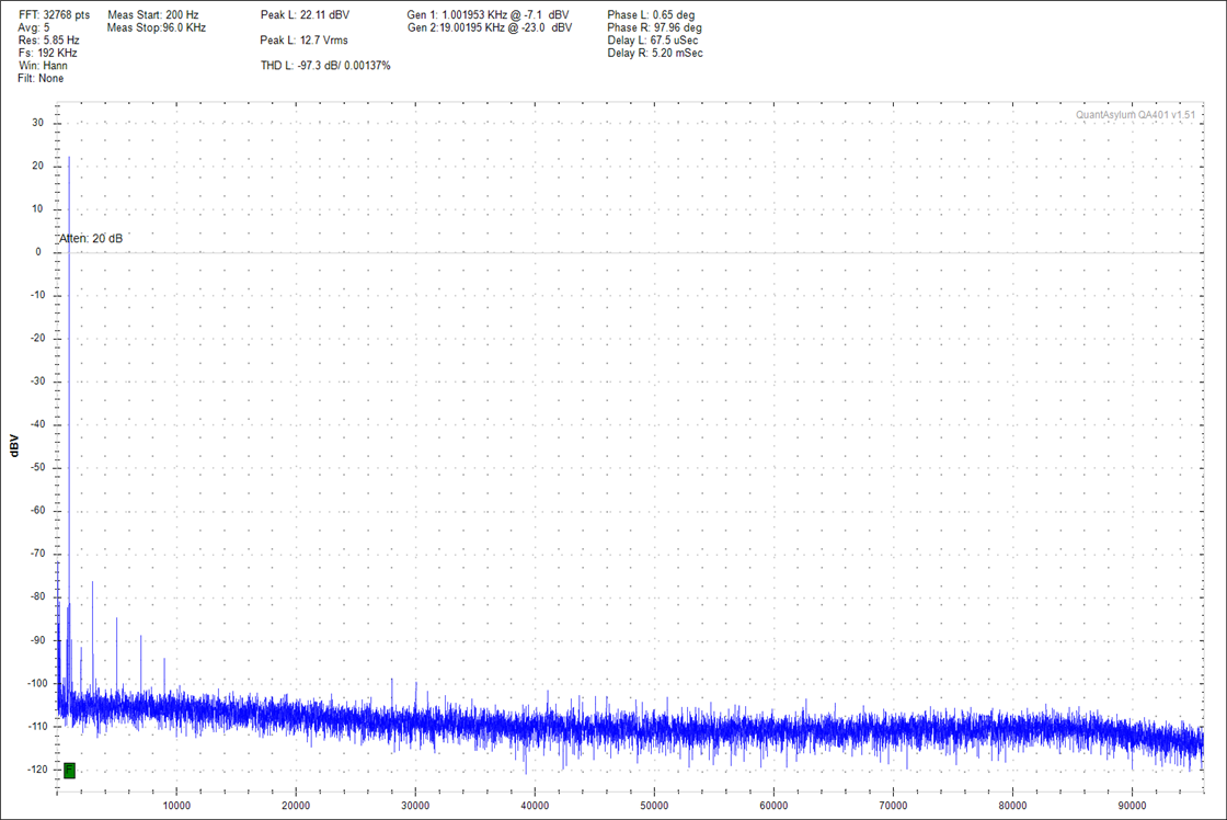

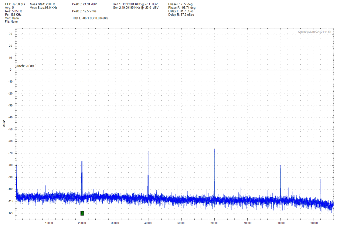

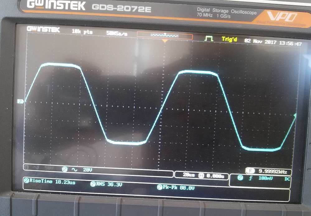

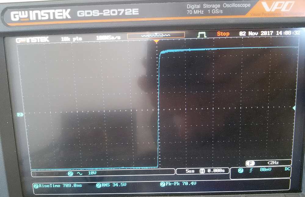

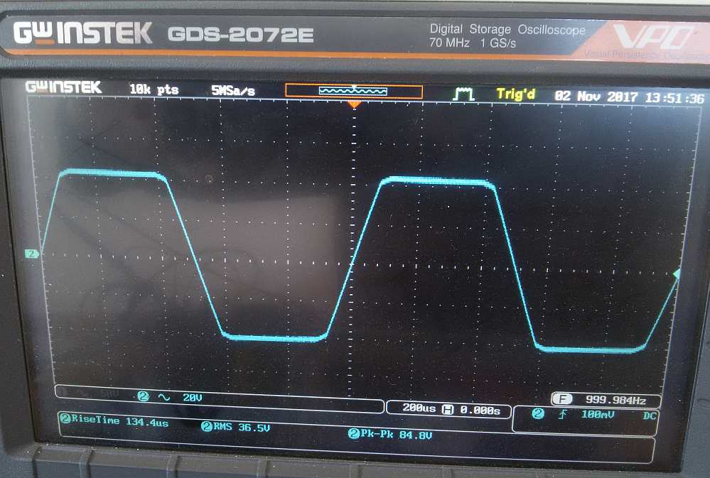

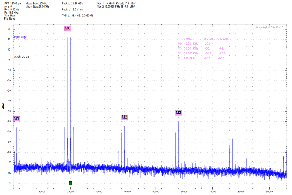

Some measurements with SARA-2016. Small signal bandwidht (-3db) - 850khz. Slew-rate - 100V/us. THD-1khz 8ohm 0.001%. THD-20khz 8ohm 0.004%
