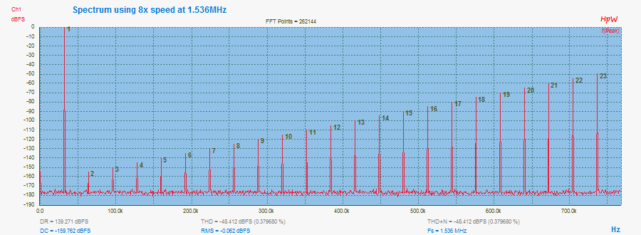

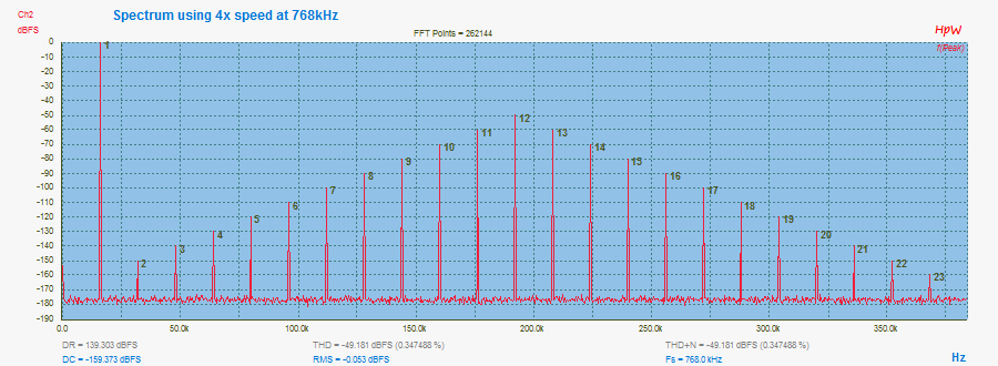

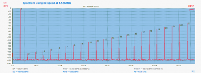

Exactly,
Supporting 24 Bit (as USBStreamer allows):
- Stereo 2X Speed (2 * 192kHz = Final SR = 384kHz)
- Stereo 4X Speed (4 * 192kHz = Final SR = 768kHz)
- Mono 8X Speed (8 * 192kHz = Final SR 1536 kHz)
on Input and/or Output using 100% bit perfect ASIO interface 😀
See pictures...😀
Hp

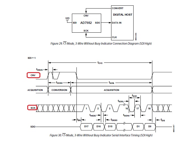

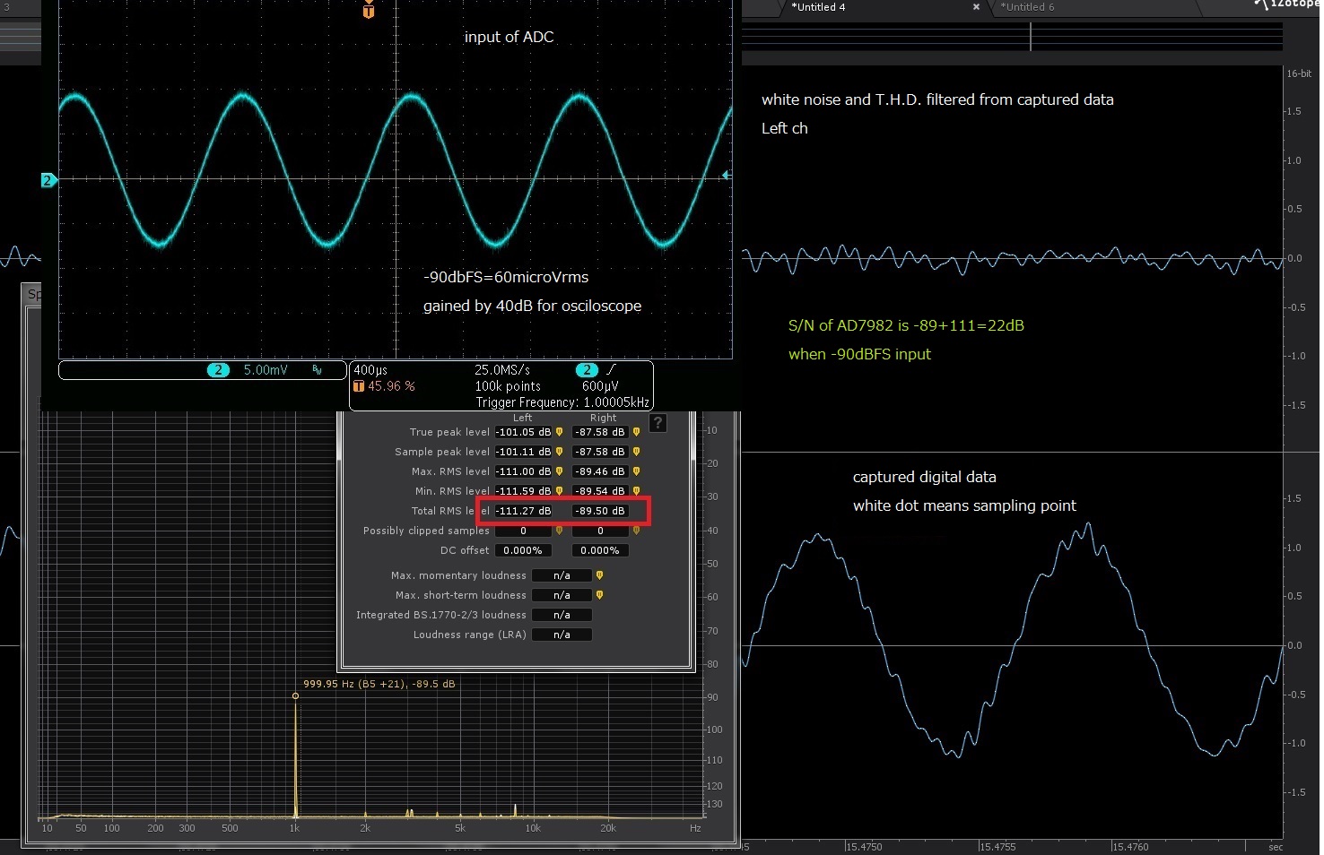

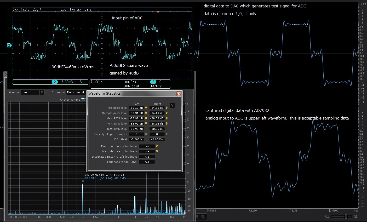

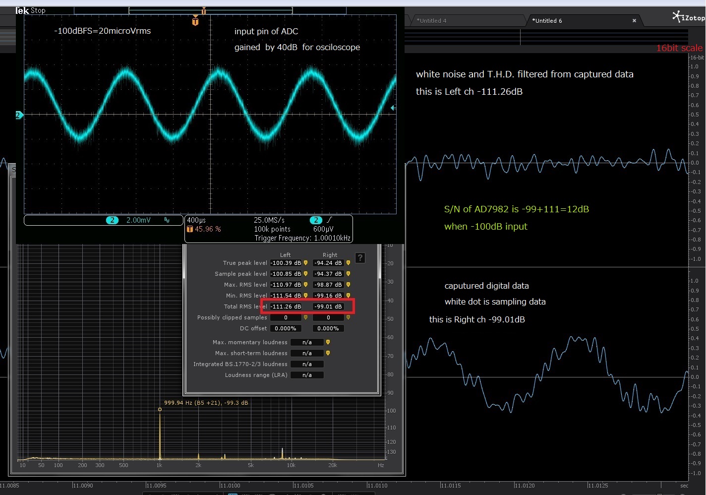

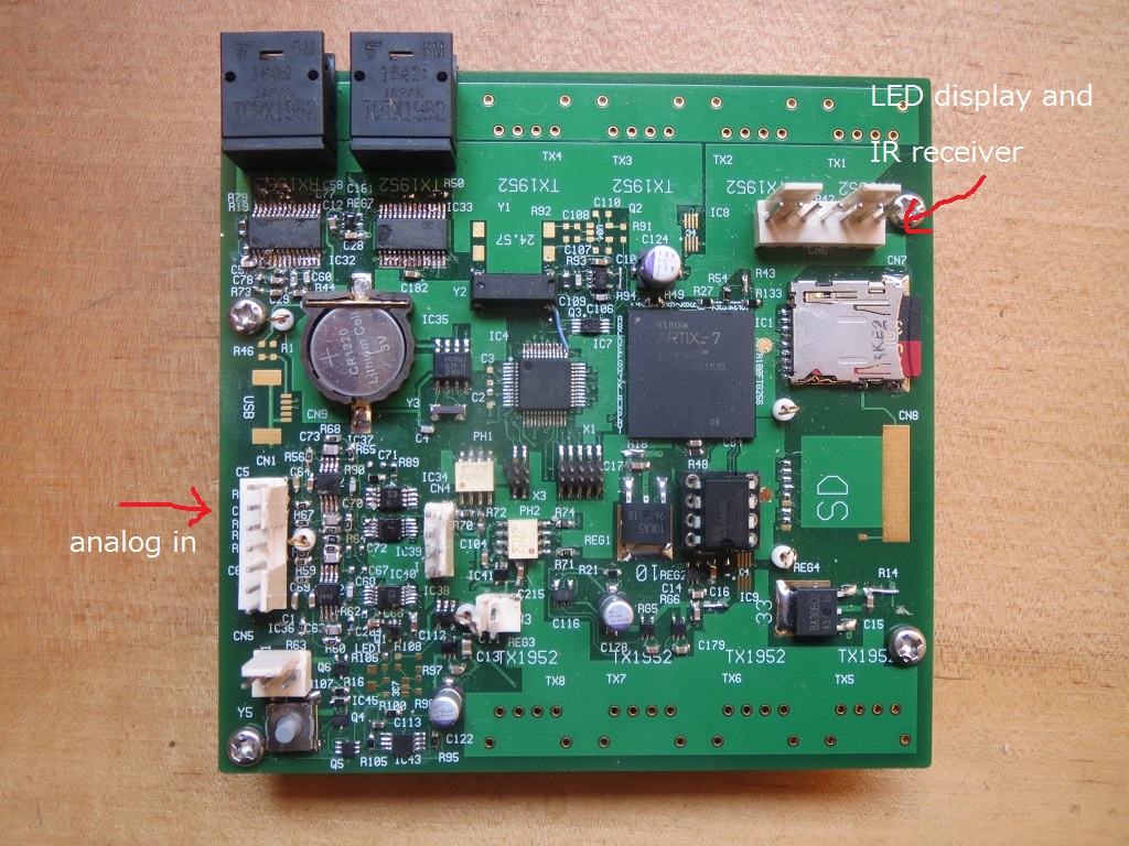

Hi, I found this site recently.This is the very concern thing I want to know.I made ADC to digitalize a record one years ago.
I prefer SAR to delta-sigma because I couldn't get good result from pcm4202 before and my DAC use multibit DAC chips.I chose AD7982. This is the PCB.It works well for digitizing.
This is analog signal and analysis of captured digital data when input
is -90dBFS sine.
This is -100dBFS sine.
This is -90dBFS square wave.
These measurement is done in 768k/sample. Sampled data is filtered by FPGA and downsampled to 96k/sample with 22kHz band limit like CD.Processed data sends to PC via SPDIF or writes into SDmicro(fat32).
T.H.D.+N of AD7982 is -111dbFS(almost 18bit). High sampling rate(768k)can improve S/N.If in 768k/sample,S/N is around 100dB as is specsheet data.
Now I want to improve S/N of my ADC to 120dB(20bit) which is enough for measurement. AD7982 is a little bit noisy for that purpose,though it is enough for a record.LTC2380-24,which I couldn't find at the time I designed the PCB, is very interesting part.
I think it's passible to get 20bit resolution. Thank you for the information.🙂

Very nice. How did you solder the Artix 7? Did you use a reflow oven, or hot air/IR?
BGA is annoyance for self-making. I usually don't use this type of package because I can't solder by myself.I had no choice about this PCB to use BGA because I need somewhat large memory(512kbytes).
There is a PCB manufactures who arrange assembly including BGA soldering.It needs metalmask whose cost is almost same as PCB.In this case,both are probably US$450(PCB cost include 5pcs PCB,metalmask cost includes 4pcs BGA soldering fee).
If PCB doesn't have BGA,total cost is half.BGA is annoyance indeed.😕
One merit of BGA is reliability.BGA soldering is ckecked with X-ray.QFP soldered by myself sometimes has contact failurs.I don't know the merit is worthy of cost.

I use RX4(iZotope) for audio analysis.It is mainly for editting audio signal to controll declic,denoise,equalizer and sampling conversion.I used this for the first time to degitalizing of my records.Then I found this was also good tool for analysis.
By the way I read your measurement data at #56.You got -115.1dBFS noise level at 48kHz/s.That's great.My ADC board as I posted at #130 was -111.2dB.This was sampled at 768kHz.If it was sampled like you(1.5MHz),it can gain 3dB,total noise floor -114.2dB.
I think this doesn't depend on a chip used.Your data is almost close to physical limit.My board still has some problems.After fixing them,mine probably becomes close to you.My goal is -120dB.From your data and another consideration,the key to reach -120dB is high sampling rate(6MHz)and carefull board layout.I think it's possible.🙂

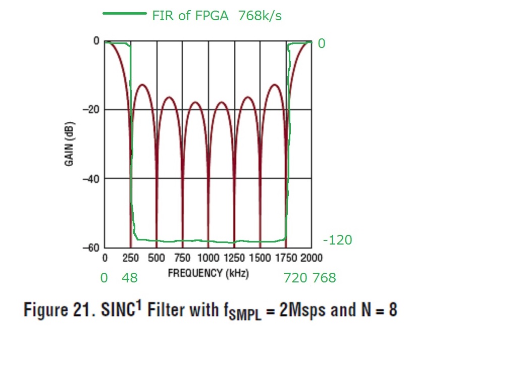

Hello xx3stksm,
Too bad that izotope price list is so high, that seem a good tool.
What do you use as processing in the FPGA ? Decimating FIR as me ?
Note that i don't know what clock you have used, but low phase noise and short path
is essential to meet the full ADC specs.
Regards.
Frex
Regards.
Frex
The processing in FPGA is plain FIR(40kHz cutoff,1024 order). It has sharp cutoff to eliminate spectrums which have potential chance to be aliasing noise.
High sample rate SARs like LTC2380 have internal clock for its conversion. External clock into the chip acts only for shift clock of sampled data acording to datasheet.
I think stable power and analog signal layout are more important than external clock.

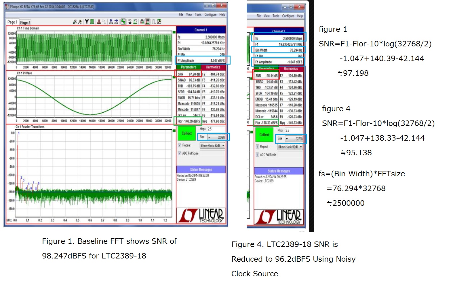

Hello xx3stksm,
The internal clock of the ADC is only for the SAR process, it's not the ADC sampling clock.
The SNR of any ADC can be limited by the jitter of sampling clock.
Designers take care about this with high-speed ADC, but but even for lowest speed high resolution ADC
a poor jitter can result in lower SNR.
Of course as you say, a very good multi-layers layout is essential to get the full performance of the ADC.
But also proper grounding (no loop) and low noise power supply are also required.
Regards.
Frex

Hello Frex. I agree with you.What I wanted to emphasize is that CNV is real sampling clock and SCK is only shift clock of sampling data in many SAR ADCs like this.I need to take good care about jitter of CNV.
BTW.I'm now considering to redesign my ADC board to be capable of measurement use which require much accuracy than recording one.I have almost finished fixing up problems on the ADC board. One concerning thing is jitter of clock,as you say it's important factor for high resolution ADC.
I have measured noise power which may come from jitter of ADC clock.But measured rezults is not what I expected.I thought I can find out some imfluence caused by jitter.I fail to find increase of noise power so far.
One reason for this is probably my measurement circumstance.Test signal for ADC comes from my self-made multibit DACs(pcm1704 and LTC2642) which doesn't have low THD+N for good measurement.They are almost -100dBc which mean less than -100dBc is vague.But above -100dBc level,I can't find footprint of jitter in spite of dirty clock.
This is good explanation about jitter.
Solutions - A Low Jitter Clock is Required to Evaluate High Resolution ADCs Please see attached.
I calculate jitter of Fig 1 with clean clock and Fig 4 with dirty clock.I think the calculation is probably correct and proves clock jitter decreae SNR.But that is against my measurement.Why can't I find decresed SNR ?
Is there different bandwidth between Liner-Tech simulations and my measurement ? Liner-Tech is 1.25MHz while mine is usually 20kHz.SNR is almost dominated by suare root sum of noise-floor.It depends on bandwidth
.The less bandwidth, the less decrease of SNR. Bandwidth of 20kHz means better SNR than 1.25MHz by 18dB (10*log(1250/20)).That's reason why I can't find jitter imfluence ? Do you think this is reasonable ?
This is complex issue.I appreciate if you reply to my question when you have time.
best regards.
