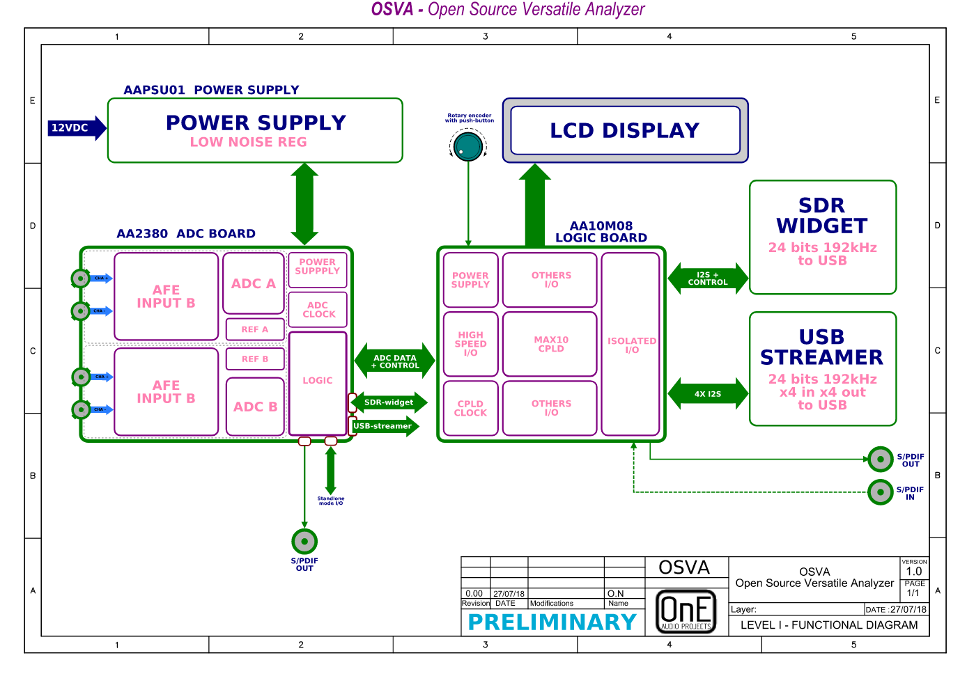

Start of project : OSVA "Open Source Versatile Analyzer"
Hello all,
After some time to think (and some holidays too), i had progress on define what would be a real analyzer
design from my previous work with the LTC2380-24 ADC.
The name of this analyzer project is OSVA as "Open Source Versatile Analyzer"
I define first a specs for this design ;
-- DIY friendly build (as possible).
-- Open source hardware and software, to allow users to contribute to the platform development.
-- High performance and versatile design.
-- Modular for fitting to users needs
With this, the analyzer would be build using up to 5 different PCB ;
1) AA2380 ADC PCB -(2 channels ADC board) with :
Two channels high performance analog front-end (AFE).
Two LTC2380-24 24 bits 1.6MSPS ADC
ADC voltage references
Low noise Voltage regulators (power supply)
ADC low jitter clock
A small CPLD for logic interface
2) AA10MXX LOGIC PCB - (digital board) with :
Intel 10MXX CPLD
Dual Clock oscillators
High-Speed I/O connectors
Voltage regulators
Isolated I/O interfaces for SDR-widget and USB-streamer
LCD display interface connectors (HDD44780 compatible)
Rotary encoder input
Connector for future DAC PCB.
(and more TBD...)
3) AAPSU01 - Low noise power Supply PCB
Generate voltage for AA2380 and AA10M08 from
a single 12V source.
(only Small wall adapter required)
4) SDR Widget - (CPU board only)
Already existing design from George Bourdeau (Open source).
This I/O card allow 24 bits/192kHz (AD+DA )data transfer operation
via USB link (Class 2 audio device). Link to analyzer is isolated.
5) USB-Streamer - Third party I2S to USB (Proprietary design)
Connecting USB streamer to AA10M08 allow 24/192 kHz on 4 channels
used to reconstruct 24 bits 768KHz sampling rate.
(require compatible software)
The preliminary functional synoptic of the OSVA can be show on file below :
-- OnE Audio Projects // OSVA preliminary functional synoptic --
This hardware configuration allow several user configurations.
Indeed, there is multiple building options :
The AA2380 PCB alone provide some direct digital interfaces :
isolated stereo S/PDIF OUTPUT (stereo)
Sampling rate selection : 48/96/192 KHz operation
Sinc digital Averaging filter ratio selection switch : x32 to x1
Isolated I2S output (up to 1.536 MSPS)
Buffered clock output
Direct connexion to SDR-Widget or USB-streamer(*) for USB output.
So, some user can only work with this board.
The AA10M08 PCB allow to extend signal processing and
add some GUI feature with LCD screen and a rotary encoder.
It provide also two fast isolated extension port to send data
to "SDR-Widget" and "USB-streamer" USB adapter board.
So the interface allow stereo 24 bits 768kHz or mono
24 bits 1536 kHz operation by using the four 24/192 channels
of the USB-streamer board and concatenating them in a single stream.
(Require compatible software like HpWorks).
The CPLD include FIR brick-wall filtering to avoid spectral aliasing.
Because all the CPLD code will be open sourced and available on Github,
writing your own filter is possible.
The LCD screen display in real time main input frequency and
input signal peak amplitude in dBFS.
It display also filter type selection (FIR,SinC, others), averaging ratio and more...
All settings are controlled with a rotary encoder and it's push button.
The SDR-widget and USB-streamer(*) are optional solutions to provide direct USB
connexion for the analyzer.
For both ,the USB ground is fully isolated from the analyzer ground to avoid loop issue and noise.
The AAPSU01 is a board that provide all required voltage to AA2380
and AA10M08 for proper operation from a single wall-mount 12V adapater ( low noise type).
The SDR-Widget and USB-streamer are itself self-powered from USB power.
* : USB-Streamer require a little hardware modification to be used with analyzer
master clock.
Of course, if others hardware interfaces are available to transfer data, it would
be great that they can be used in the analyzer (even if not open sourced, but available for DIYers).
I think about the XMOS design of JenSH in it's analyzer, and also on the current work of Mkc.
This is a first attempt to define the analyzer, and i hope that satisfy much DIYers needs.
It also a first step before to start the first PCB design of the analyzer, the AA2380.
Any opinion and advice are welcome. Thank you.
Regards.
Frex
master clock.
Regards.
Frex
What kind of analog frontend do you have in mind?
One that is designed for single ended audio line in? Or differential audio line in? Or single ended/differential selectable?
Or more geared towards test & measurement? With selectable gain, AC and DC coupling, single and differential, all modes switchable with software, jumpers or the like?
A 24 bits 1.6MSPS ADC would be a nice platform for measuring ripple and noise, higher order harmonics and so on.

The real contain of the front end is in study for now,
but i will publish very soon the full detailed synoptic of the first AA2380 PCB (drawing in progress).
I can say that in my mind, the ADC board would include a very clean fully differential front-end
with very low noise and THD performance that don't compromise ADC specs.
It would work indifferently with single-ended or differential signals.
I have in mind too, that many users use already some external tools to make
amplitude level the best for THD measurements (Auto-ranger or my AT2380 attenuator and probably others..).
I think that another board could be designed (in second step) to be interfaced
with ADC board to provide an extended analog front end functionality as :
Auto range level with 300mV,3V,30V and 300V.
High or low input impedance mode
AC/DC coupling mode
Over-voltage protection in all range
And maybe more...
(others idea are welcome)
Separate the function allow also to make the construction cost much lower
if you don't require such front-end.
Actually, i try to separate the different functions in the analyzer to let the DIYer choose what he really need.
Using a Raspberry pi is a great idea !
The ADC board can send multiple I2S stream (at any sample rate up to 1536k)
so interfacing with the raspberry pi shouldn't be an issue.
So, if you want to help you're welcome.
Regards.
Frex

Hello,
Using SPI instead of I2S for Raspberry Pi interface shouldn't be a problem.
You are right, by using a proper CPLD firmware we can use I/O for needed purpose.
About the isolating, it's not yet decided. I must think more about this.
But IMHO, the specific use of the R pi with the AD board can be done by adding small
specific isolating interface. That don't force others user to paid for the isolator on the AD PCB if not required..
Frex

Hi all,
I think that if the ADC board (AA2380) include a CPLD, interfacing it to send data
to almost any hardware like Raspberry-pi, SoC board , and more will not be an issue.
If isolation is required (and i know that it's often), then an isolation PCB can be added.
I understand that adding another PCB is not always satisfying, but it's the price for
some modularity of the system.
Demian,
As you, I would be very happy if the analyser could work fully in stand-alone mode
using a R-pi or others CPU boards, but there is a big software job (and not in my skill).
So, we will need to find some skilled team for that .
(It's a foot call)
