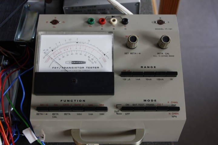

Hugo
Hello old friend!
Thank you very much for that spec sheet! I have to pull manuals to find those numbers.
I have that tester as well. I found an unbuilt kit ... and built it. It is great for fets.
Hugo, if you can find an IT-18, grab one. It is faster to use on the bench.
Otherwise, I hope everything is well with you. My best wishes always!
-Chris

I have a friend who has all the possible measurement gear you can think of. From AF to GHz's.
He gave me that Heathkit many moons ago, beautifully ready build 🙂
So, if I need something, he lends me the necessary instrument.
Hugo
