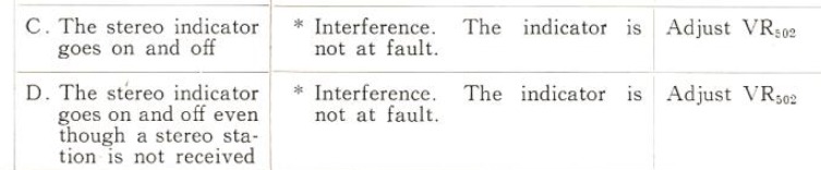

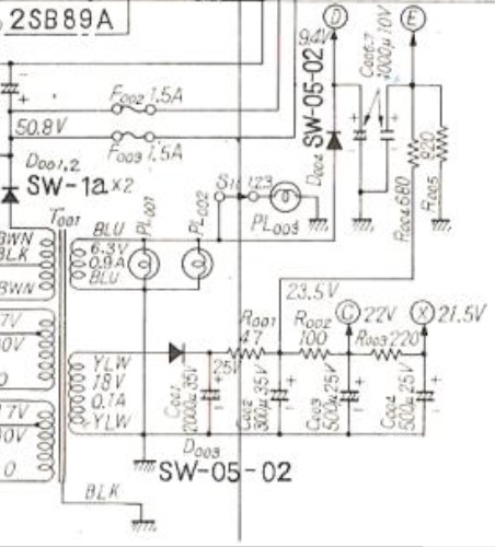

1... FM works OK and comes in strong,,, tuning meter works, but orange lamp for tuning indicator only lights when FM is first selected and stations are dialed in... It only lasts 10-15 seconds then dims off, and won't come back on until AM or another selection is used a while, and then FM tried again...
Not sure if MPX stereo is working while light is on, as it isn't on long enough to listen,, It only last 10-15 seconds then dims off, and wont come back on until seems as if something inte ckt is going out of value/overheating??
2... I have measured Voltages at all the transistors on MPX and indicator boards, and can post the results...

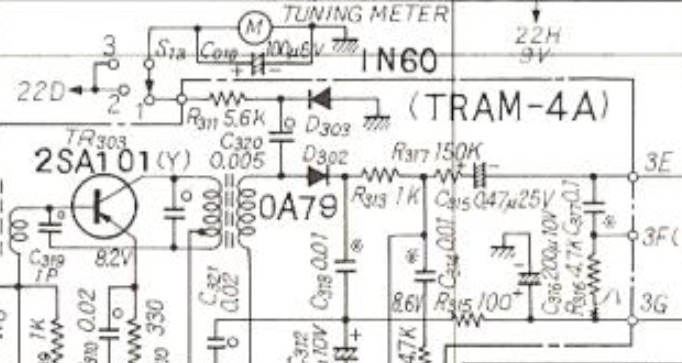

3... Tuning meter doesn't move at all in AM...

Thanks much,, yep I took it out, tested and replaced it just to not lose it!!! I asked yesterday but got no responses! Do you think it's the indicator bulb problem? I looked for those(2SB54) and not sure if they real or not,,, prices are all over place...
I read it can be subbed with a 2N3906,, but the ckt would need to be modified,, I don't want to do that, trying to keep it as close as I can with reasonable parts... I have an old Fisher 220T I went thru maybe 10 years ago, with a lot of support, just needed the preamp board rebuilt, but it was easier to access than this one,,, may have been a year or so earlier also,,,

I think the AM meter problem is going to be harder to track down,, I spent an hour trying to access the switch to trace the meter wires, and inspect the wafers/contacts,,, but I just can't see it, and removing the switch isn't an option... The FM has another PCB between the meter and switch,,, AM is just switch contacts to meter,,, it shouldn't be this hard to fix!!!!
