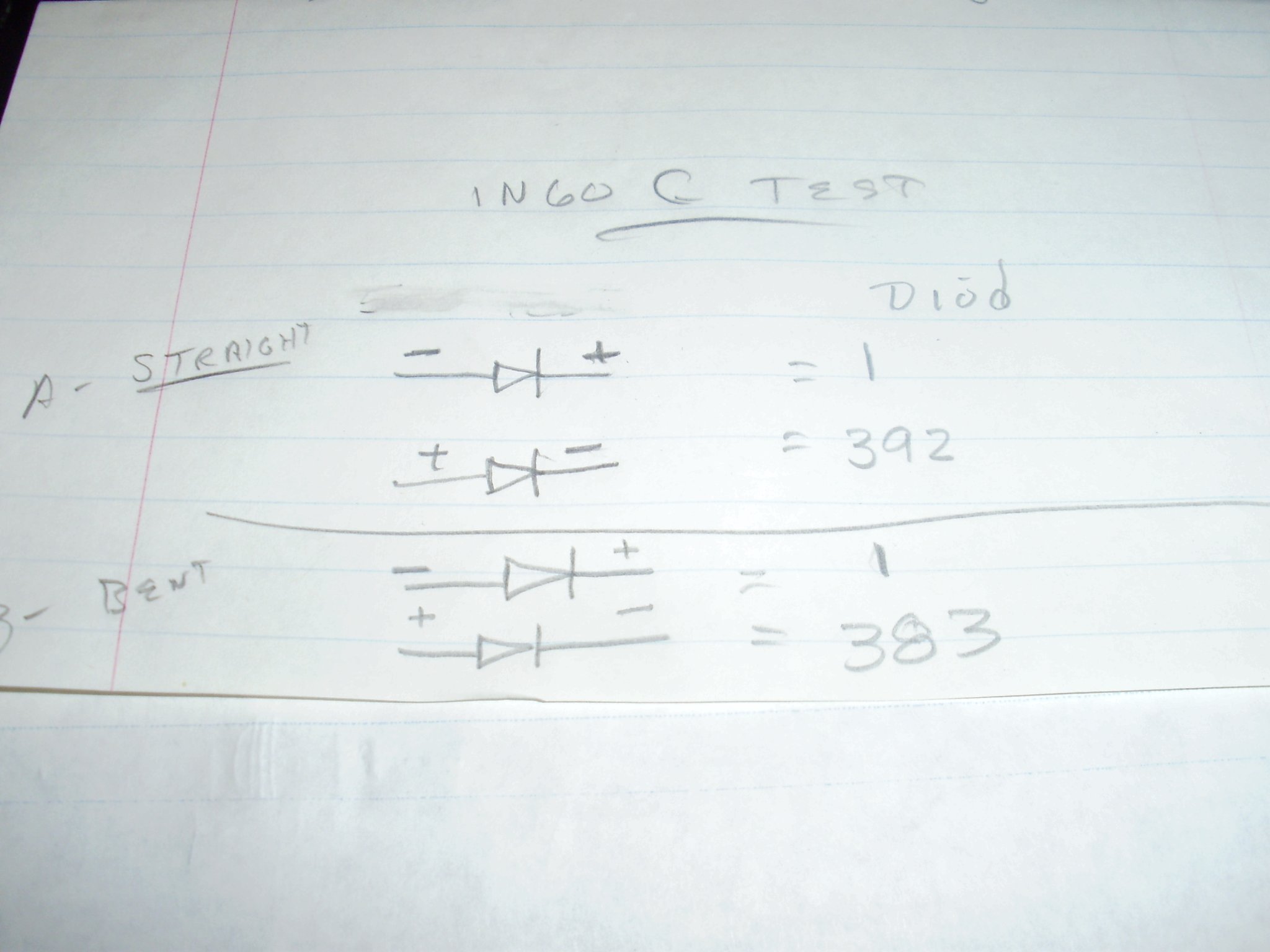

The test in post #31 is the test of these two (pic in post 31) that I found... Mosfets have three leads, no? I'm thinking the C on these is Ceramic?
Thanks again

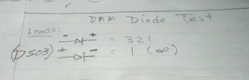

Yes, please post the same measurement for the 1N60C as you did with diode 503. This 503 is perfect.
I have no idea what the 'C' means.

Well... we got it!!!I took me a while to gain working access,,, and even longer to ensure the diode was in the right polarity... I just tacked it onto the leads from teh broken one,,, didn't want to dig it out twice!!!
I connected it to a diode box,, 3,3K,, 5,6K and 18K,,, settled on the resistor that was in it, as it gets full range,,, and dialed it in with the pot (VR-2201)
