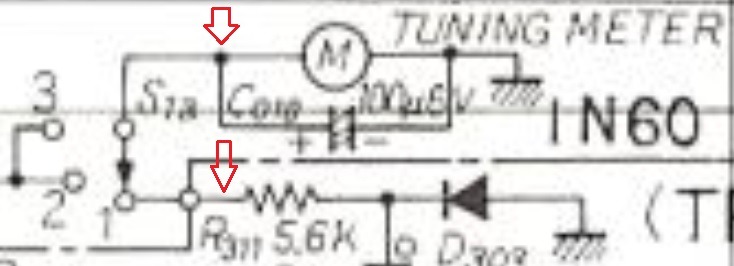

I think it's better to just first measure that D303.I just jumped 3E to the meter
Jumpering 3E to the meter will not work. That meter needs C320, R311 and D303 to work with the AM signal.
But since AM works, signal will be present at 3E.

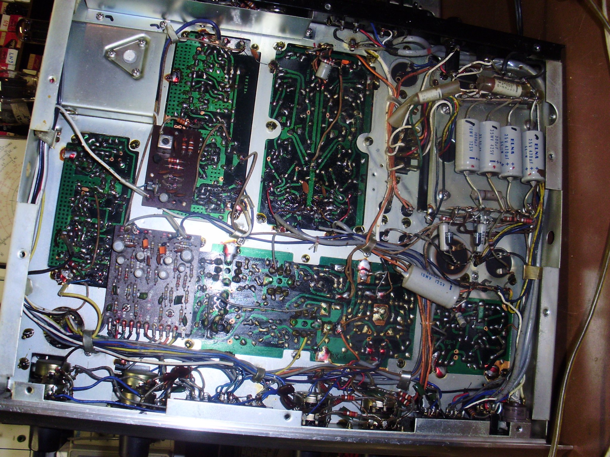

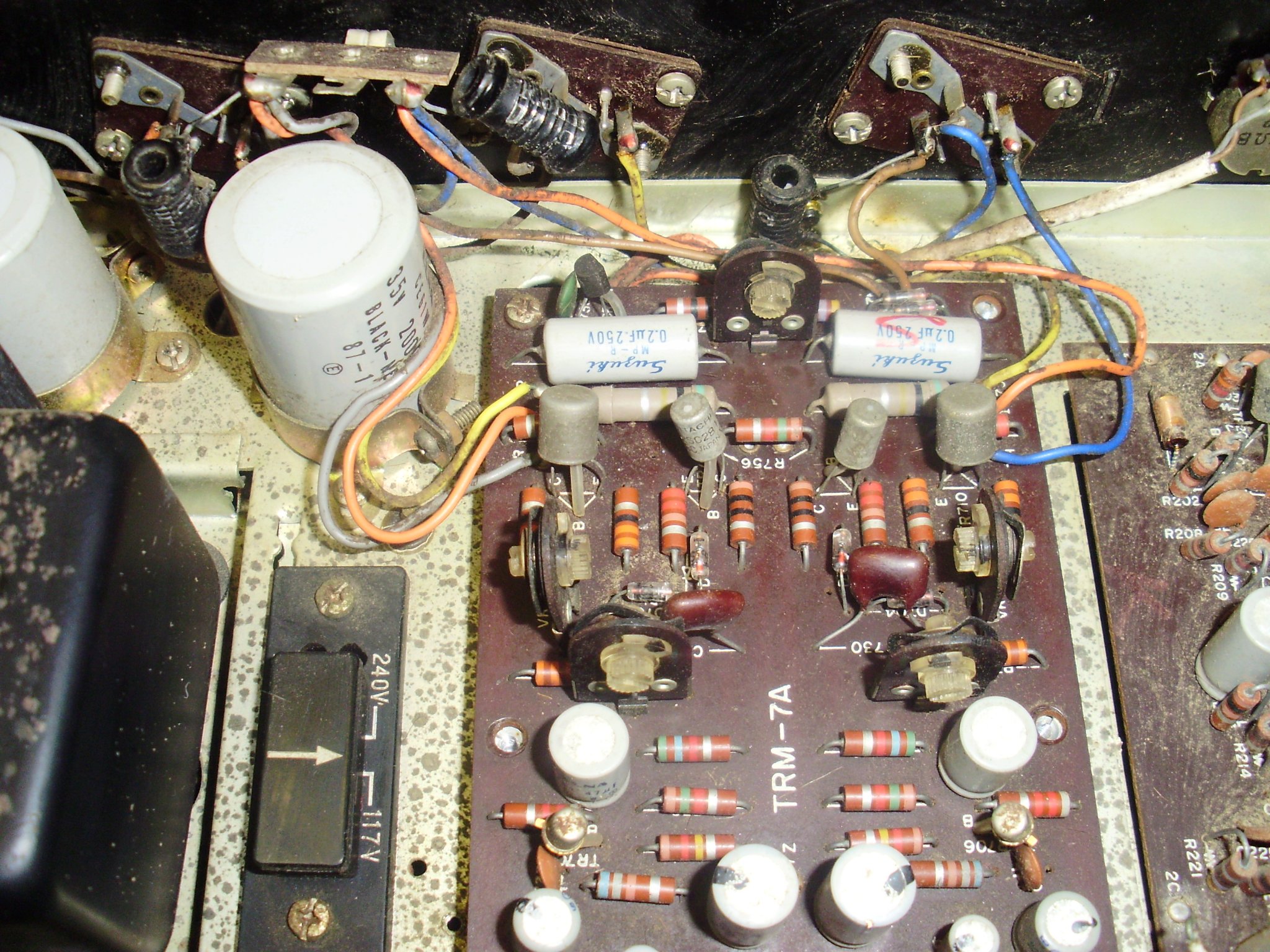

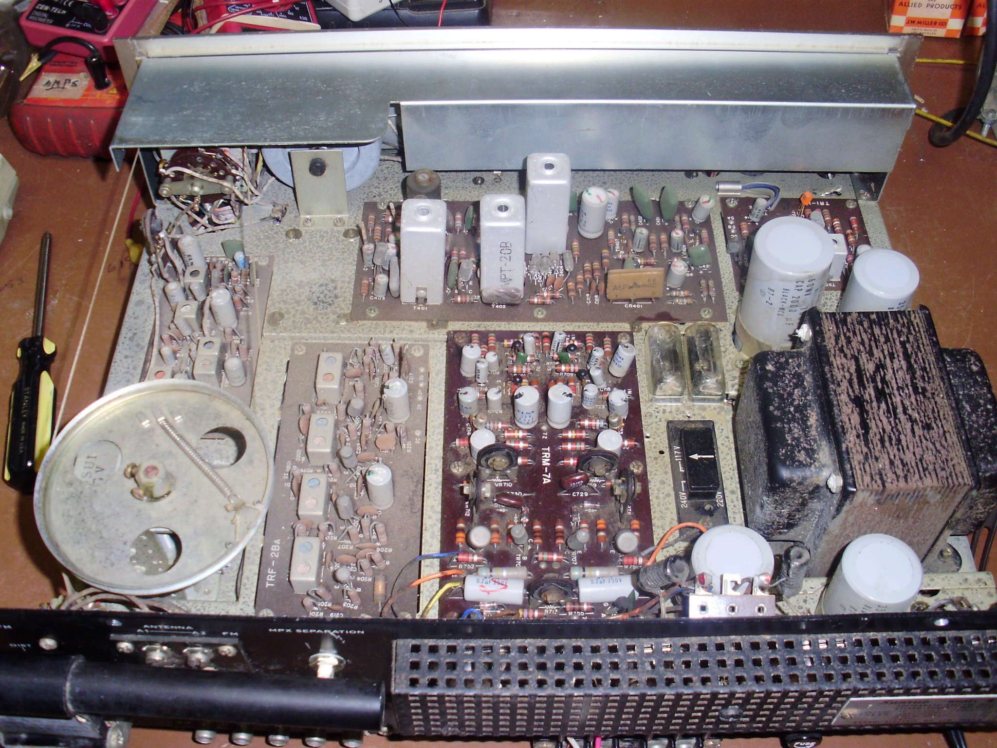

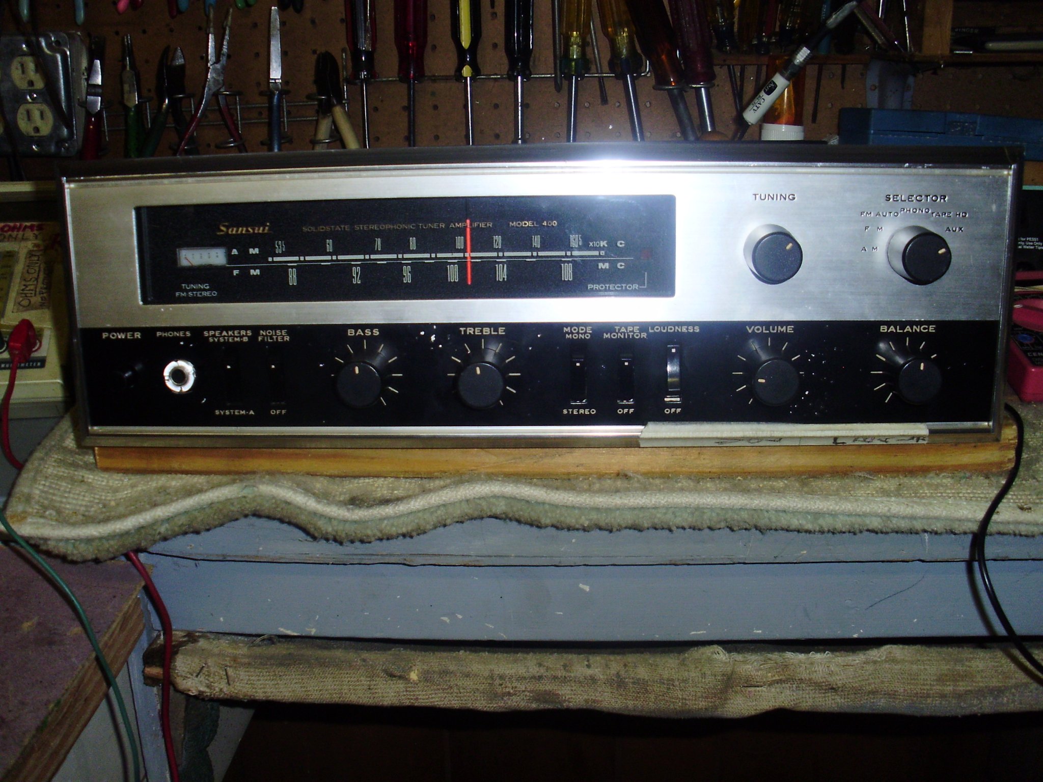

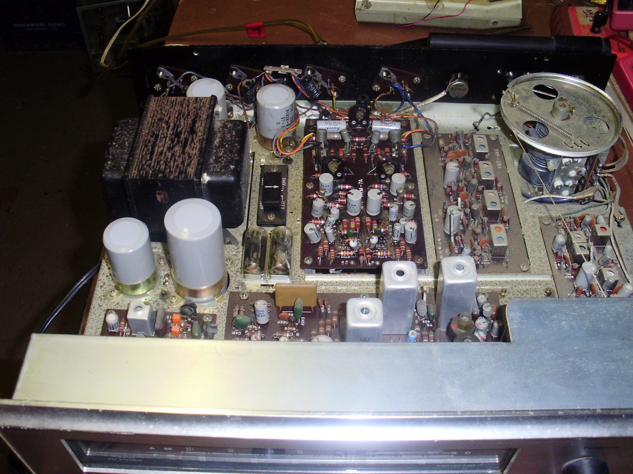

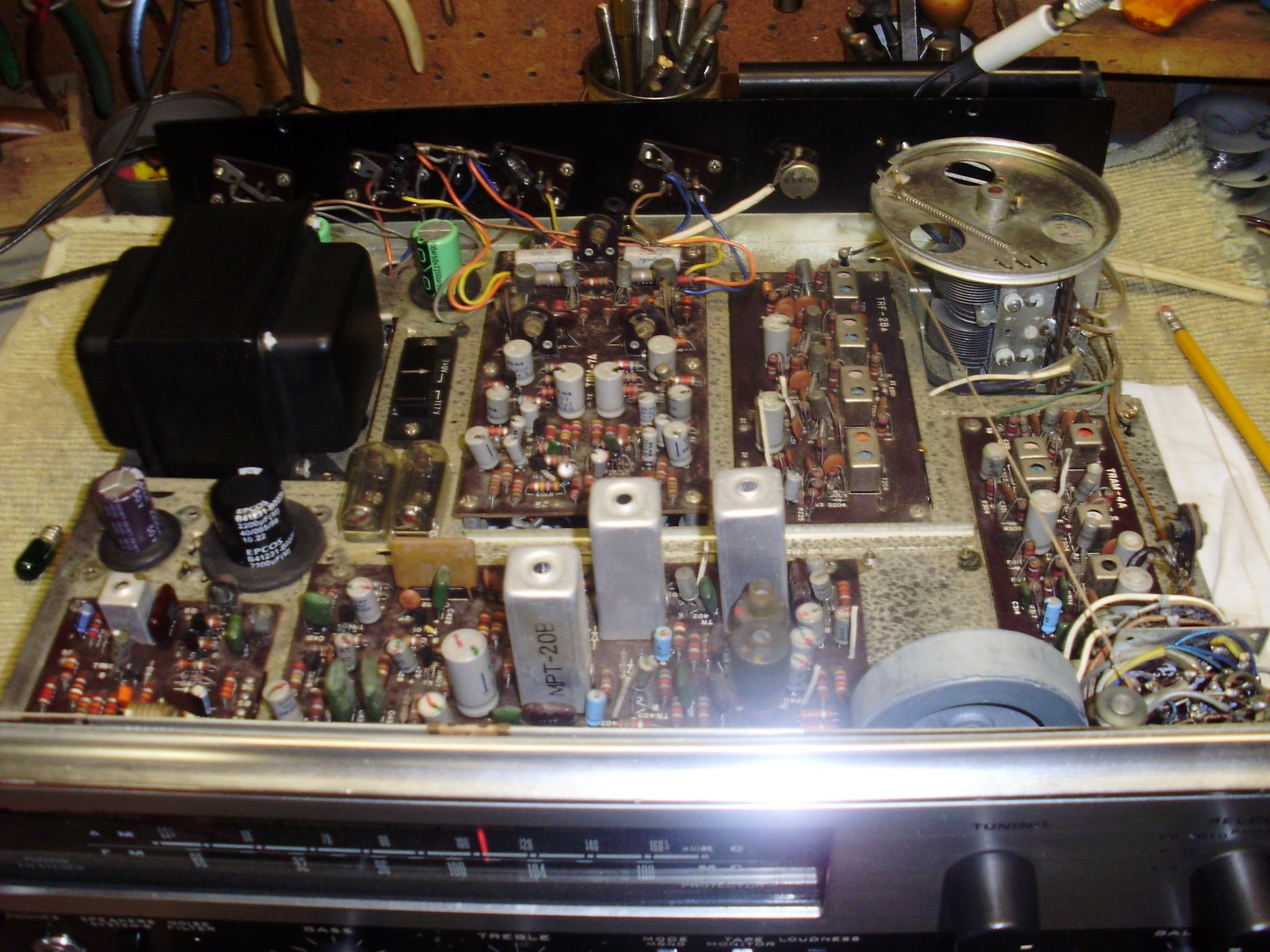

This is what's left on the camera,

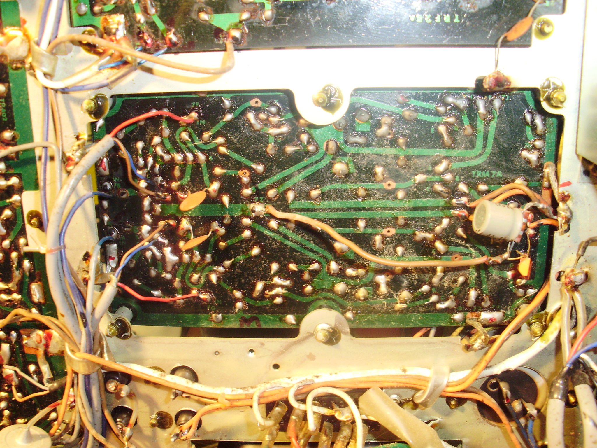

Pics 003 to 008 are as I found it... others are today... Look at the 536 trans on pic 006 towards top Right of pic,,, the pins corroded off, I soldered them back together to keep signal tracing,,, There were 4 or 5 more of those little black type that crumbled when I put the probe on them,, that's why I replaced them,, You can see how dirty this was when I got it!!!!

Nice pics, congrats. I remember the Fisher amps, they were well regarded over here. Nice job on reviving the transistors too.
DMM in diode mode - to chassis and + to cathode. There should be no leak. Or you can measure out of circuit.
While you're at it, also measure R311.

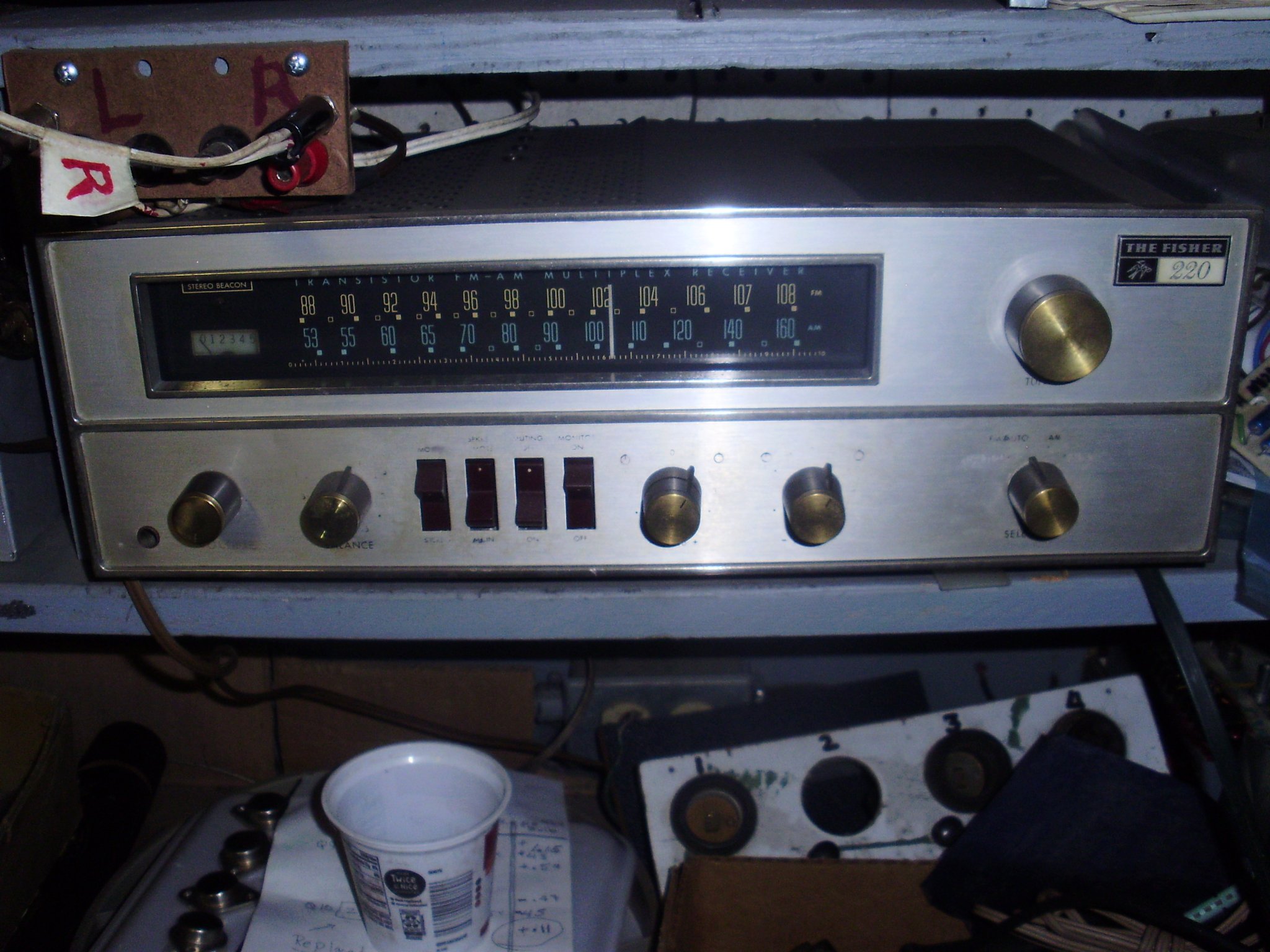

Thanks,, these old SS amps are the sound I remember when I was young,, got the Sansui 800 in 1969,,, the Fisher about 8 years ago,,, I built or rebuilt most of the tube amps!!!(avatar 811 SE) I hope this one measures up to its partners!!!
So I can measure D303 in place with Diode test on DMM?? I'll pull a pin of R311

Also, try to look at the measuring points I provided in post #33. With the input selector on AM you should measure a short.
