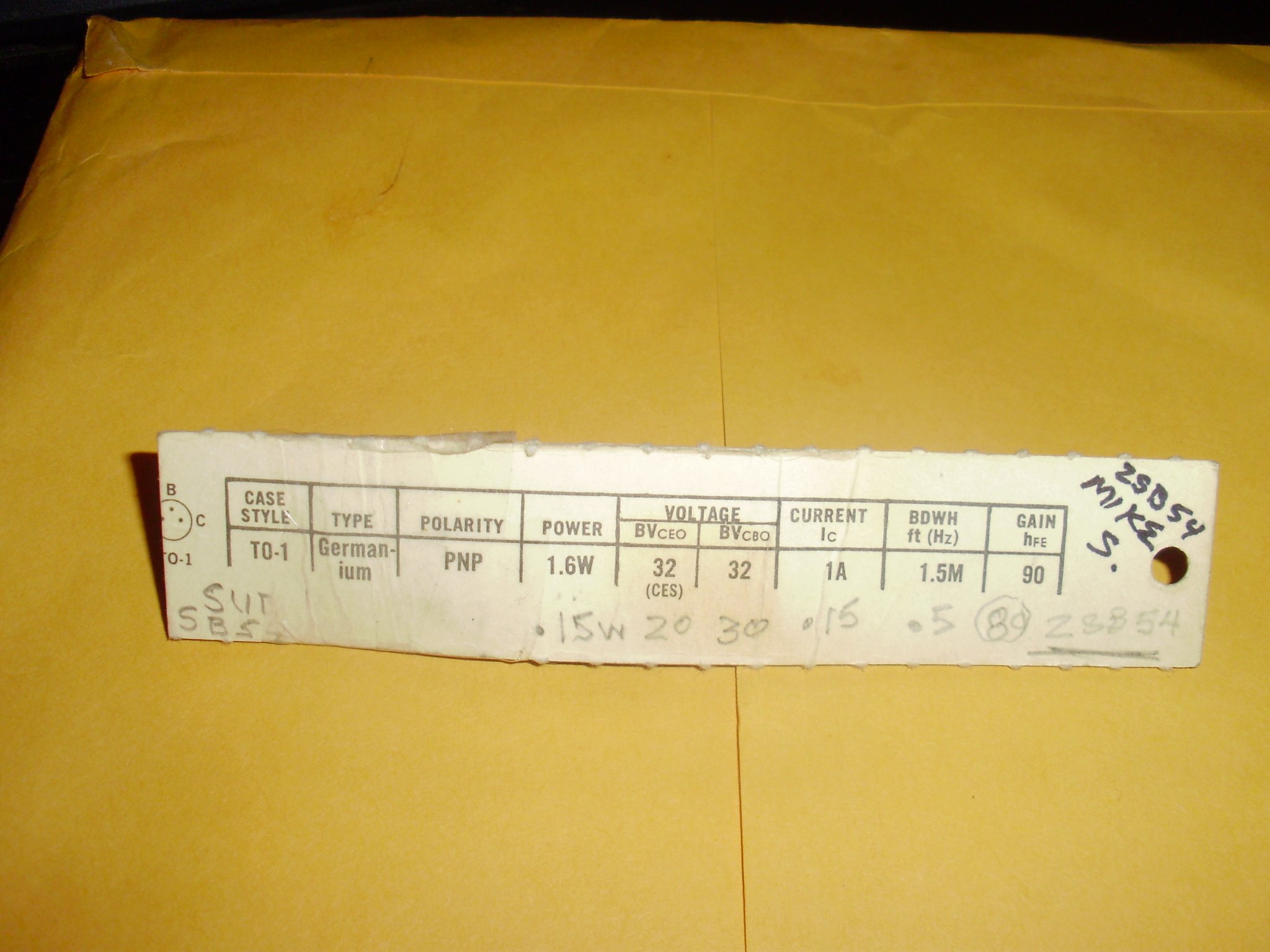

I found a voltage problem while testing the stereo indicator board, that lights the lamp... TR503, the one Hugo sent me, that got damaged, and I replaced with an NOS sub with the same or better specs... Schem calls for E-2.25V (or 22.5V) as printing is blurry and C-21V,,, with no value for B.... With the sub in place, E-20.5,, B-20.5,, C-4.8 to 5. V... Seemed to me it "could" be in backwards,, so I pulled it to test and it tests as new... So read the traces and found E-20.7,,, B-20.6 C- 0... That's with FM/MPX selected but play in mono,,, and the bulb trying to light...
Pic of sub compared to original values...
