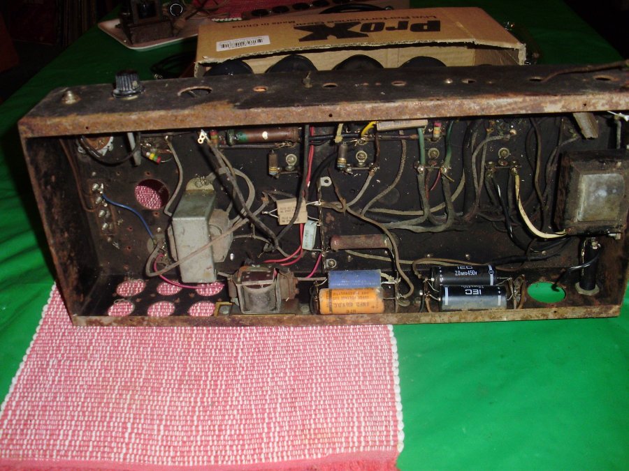

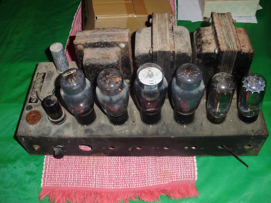

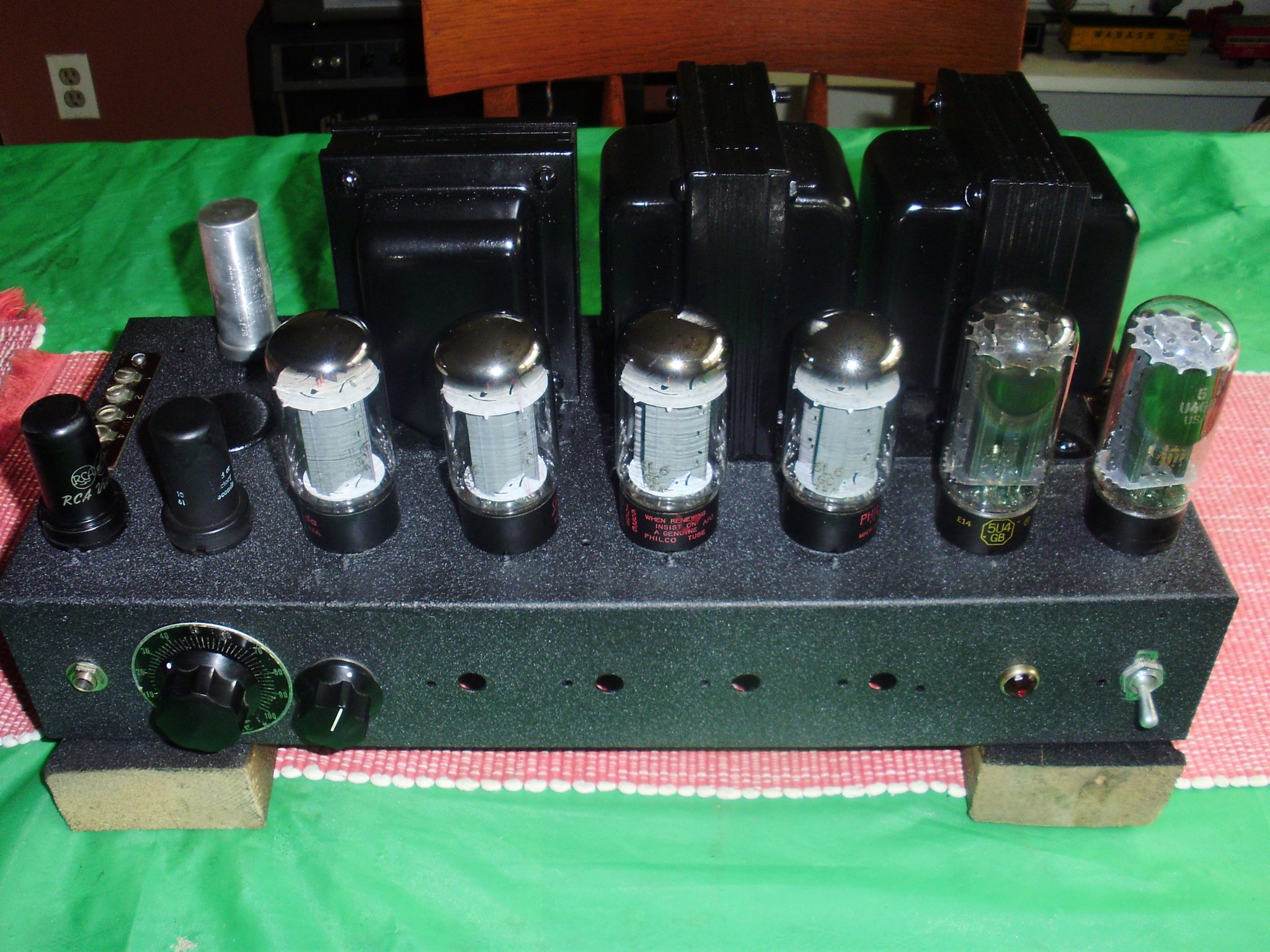

Here's pics of that amp,,, first two are as found,,, third is as it is now, it's up and running with an added tone stack stage, but still a work in progress!!! I got this the same time as the Sui,, and it became a diversion while waiting for Sui parts, so it fits in this thread!!!

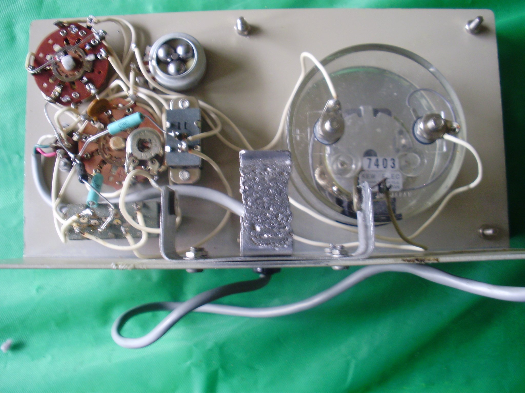

IT-18 arrived,,, looks to be in good shape,,, other than battery was left in it, and corroded the holder,,, I wire wheeled it clean,
Got this far on Adjustments page,,, Beta Cal,, Full CCW,,, however pot doesn't stop in either direction,,, so I cant index "full CCW"...

I would clean the switches and check the diodes to make sure they aren't shorted. Then of course there are the switch contacts as well. Use a zero residue cleaner, you may have to use WD-40 or something first (shutter), just make sure you follow that right away with a zero residue cleaner. Once you get it working properly, I would replace the battery holder but it might be okay for now. I haven't looked, but some contacts are plated and once you get to base metal the connection isn't nearly as good.
Makes sense,,, as I didn't buy it,,, my buddy asked me to try it out and see if its as advertised,,, Everything else is like new,,, just a concern with the instructions, opposed to operation of the Beta cal pot,,, Where is full CCW if it never stops!!!??
Battery box has one corroded hold clip,,, contacts are brass rivets and very clean...

That control is a multi-turn control. It does eventually stop.
Clean the trimmer on the switch. Verify the resistors have not drifted, their precision resistors were pretty good.
As simple as this instrument is, it is accurate and a real boon to the test bench. One of the very best things I have ever bought! I have the more expensive units from Heathkit and others (B&K also), but the IT-18 is the very best for what we do on the bench as far as determining good or bad.

The calibration depends greatly on that 180R resistor and battery voltage. My strong suggestion is to order a 180 ohm 1% 0.6W metal film resistor next time you order parts and use that. The calibration will change a bit with battery voltage. I've been toying with the idea of making a 1.5 VDC regulated supply for it. So check the cal when you replace the battery and at intervals simply so your measurements agree over time.
If you only check to see if a transistor is good, calibrate it properly and just check every now and again.
I just cleaned teh switches,,, The beta cal pot never stops turning,,, shaft seems to move in and out of the case about 1/8" I need to take it out of the ckt and check it with a ohm meter,,to see if it registers... same with diode,, cant get a good reading with it in the ckt
Darn it!
The cal pot has been broken. I took mine apart to look at it. I think a gorilla hit the end stop and forced it.
See if the back is tight to the front plate, if not press together and test.
Option, repair it. The tabs bend (carefully and not all the way!) so the rear comes off. The ball bearings form a reduction assembly, so when the back comes off pay very careful attention as to what goes where and what comes out. Take pictures!!! Somewhere the turning part to the wafer that holds the sliding contact has been broken or bent. You may be able to clean the grease off, straighten or glue (epoxy) that part together. Let it fully cure, then use fresh grease and reassemble. Cleaning the wiper wouldn't hurt right now. Test before you bend the fingers back in place. If it works, bend the tabs gently, if one breaks you'll have to file, then solder it together. It's work, but the repair should last.
Repair failed? Okay, it's a 500 meg control (mine measured 510 K approx.), 10 or 15 turn. The 15 turn will be easier to use. Half flat shaft I believe, 1/2 watt. They aren't cheap controls. Digikey #987-1626-ND at about $290 Canadian (stupid - so no!) Look further ... Hmmm, the answer would probably be surplus or a single turn with 10 to 20 turn indicator knob. No way you can use it with a single turn!
The most intelligent option if you can't repair it is to buy another meter. If it's in rough shape - fantastic as long as the shaft isn't bent. You could use the battery holder anyway. Nothing wrong with a spare meter, but if broken you should be able to get it dirt cheap!

I just tried it again as the buyer wanted pics to deal with the seller,, altho I told him the damage was internal..
As received, the pot shaft would move in and out by at least an 1/8th inch.... and would never arrive at a stop,,, how ever,, I pushed the shaft in and it seems to have clicked in place, and in watching the white wafer from the back,, the wafer does seem to stop moving after 15 or so turns,,, but knob/shaft never stop turning, so there will be no way to index the wafer with the knob in use... It seems to be gear drive with some kind of stop that is broken/dislodged?
I connected the pot, in ckt to my Fluke ohmeter and it starts at 0 and wafer stops at 505K,,, but it tracks erratically at lower ranges starting around 20K ~100k more or less, but knob/shaft continually spins,,, Is it supposed to? If so I maybe I can use it out of the case to see where the wafer is?
Just adding some info as you can't actually see it,,, Maybe it can be saved?
