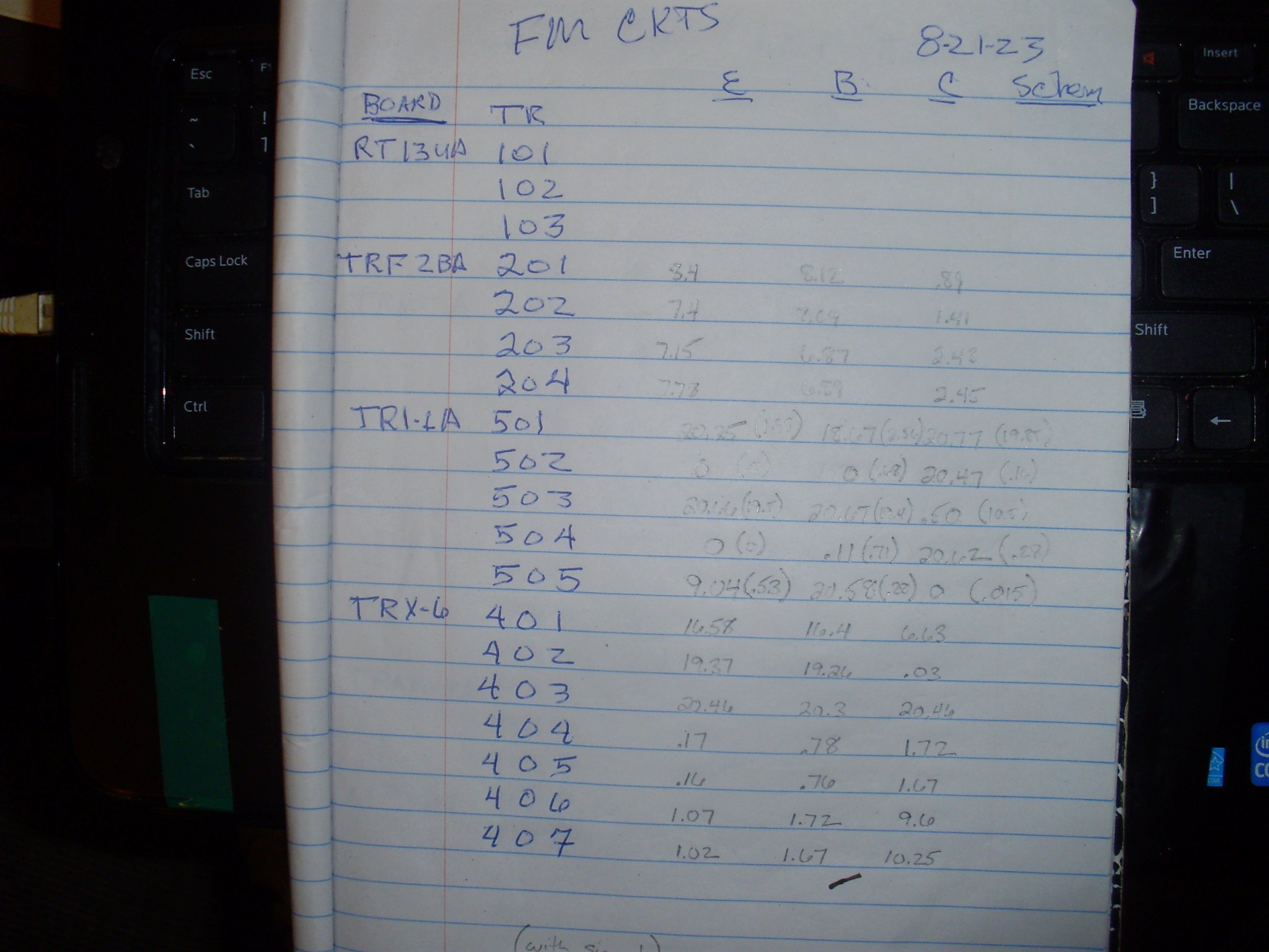

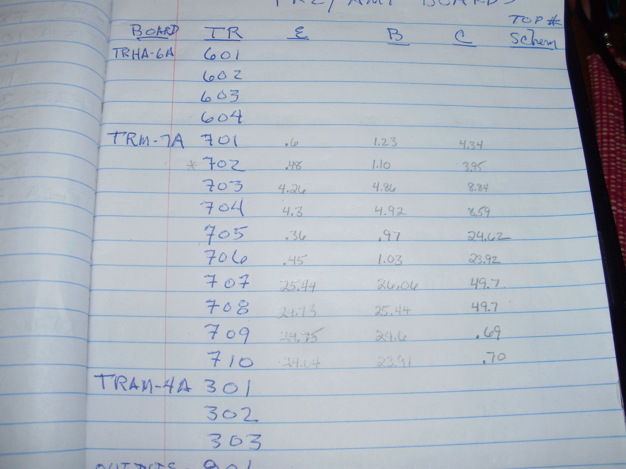

My buddy came over with a Fluke 87III, and we took and confirmed some transistor readings on FM/MPX/amp related boards...
I hope these give a better overview of what's going on in the Sansui,,,
Reading's in parenthesis are with a signal on the indicator light board,, others are with no signal... I took readings on all three leads of the transistors, but a lot of them aren't on the schematic....
Thanks...
Thanks...
Okay, try this. Measure emitter - base and simply note if the transistor is biased on or not. Also measure emitter - collector voltages. This may give you a clear picture. I don't have time to transfer your readings to a schematic to troubleshoot - sorry.
Using the diode test feature, measure the two junctions in each suspect transistor.
The voltage difference between the emitter and base of Ge transistors will only be 200 to 300 mV. Measuring from common ground the applied voltages will be much higher. So measurement error and noise can swamp accurate readings. So use the emitter of the part as a reference, that will tell you what the transistor "sees" more accurately. You can't do that in RF circuits, then we normally use an oscilloscope as the capacitance from wires and the instrument will upset the circuit. You can measure junction leakage with a careful setup. A 3458A would be sensitive enough to read directly - as is my 34465A. However, the IT-18 is cheaper and faster, so that is what I use. With Ge transistors and diodes, you do need to look at leakage as well.
Anyway, trying to troubleshoot remotely this way is ineffective unless the readings are taken in away that you can absolutely count on them. The greatest amount of time in a repair is the troubleshooting and discovering and following the clues. So unless the clues are clear and guaranteed to be correct, you are wasting your time.
So we need junction voltages using the emitter as the reference, and suspect parts need to be removed (and new, replacement parts) and confirmed to be good without a doubt. As a young technician I learned the hard way, Ge parts in new packages can be bad. I was in the practice of poking the leads out of the bag and measuring them before removing them from the store. I rejected a lot of parts. That dropped my aggravation with repairs quite a lot. I confirm light bulbs, transistors and capacitors are good even today, and match resistors (thereby checking them also). Ever try to troubleshoot a bad "new" part? It's pure loss, and very difficult.

Hi Chris,,

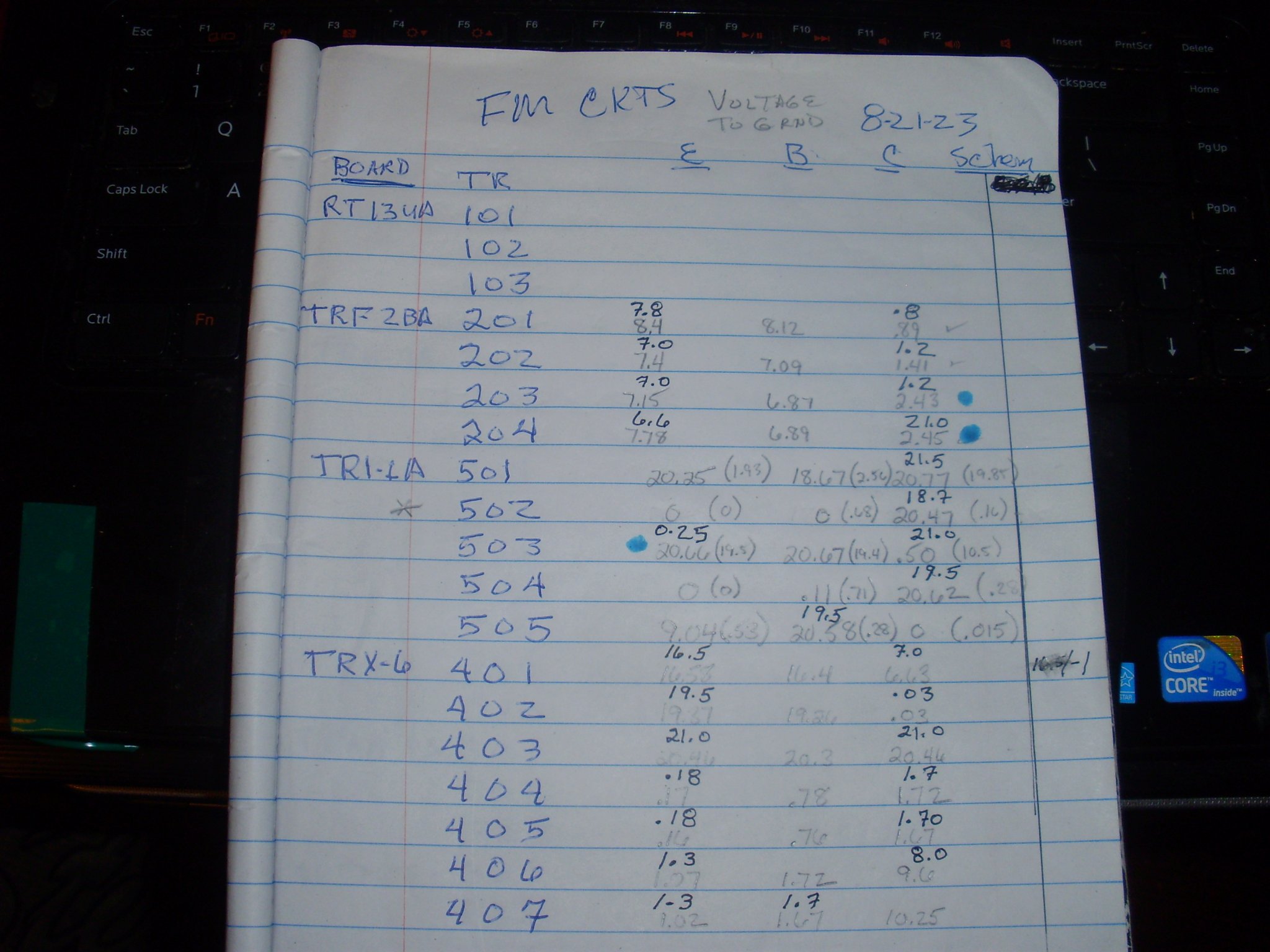

I can add the schematic values to the readings I took if will help decipher them, however many readings aren't on the schem,
I can measure E to B and E to C, if that will work better with the diode feature I can do that also...
I realize you are spending a lot of your time helping me, and I appreciate it,,, and am sorry I haven't taken readings right, but I will try again and continue to look for an IT-18 to test the transistors so they can be evaluated them,, I have a lot of Ge transistors that I got last week, and according to spec sheets I may have most I need for this receiver, which is also a major part in repairing this guy,, as long as they test good...
Understanding the test results is most important part...
Thanks again for the time and explanation,,,
PS,,, Here are the available schem readings for FM boards... Dots are next to readings that seem very wrong...

Hi John,
No problem. Education is the most important thing, getting it repaired properly is the next. I just happen to have some very pressing things to deal with lately.
There isn't an attachment to look at.
Do your voltage readings from emitter to base and emitter to collector. This isn't always normal but in this instance it would help.
The diode test is done with the circuit unpowered (off) and discharged. This is a good place to start. Keep in mind that any and all in-circuit tests are done with whatever else in parallel with the junction you are testing. So if you run into a reading that doesn't look right, remove the component and test it out of circuit.
I just had a circuit where a transistor measured short emitter - base. Removed the part, it was fine. Removed a capacitor in parallel, it was fine. O found a solder short elsewhere on the PCB. Technician induced malfunction. (TIM). This just illustrated a few things. You can't make assumptions and some tests are not accurate the way they were executed. Also it shows how important your workmanship is.
When you are troubleshooting I find one difficult thing for people to do is to separate observations (facts) from conclusions (assumptions quite often). Failure to work on pure factual evidence will often lead you in the wrong direction. That is the difference between something that is "unrepairable" and a well done job.

Hi Chris,
I forgot to include the schem readings...
I understand troubleshooting, you showed me I just dont have the proper tools to do this kind of troubleshooting properly,,, and I'm working on that problem... We calibrated a VTVM I rebuilt with my friends Fluke while he was here, and its been holding rock steady ever since,,, so I can use that til something better comes along..
I don't expect you to ever drop your work for this, as I appreciate your help!!!!!! I'll just add to the thread as I think something is relevant,,,

A quick look shows some transistors may be reverse biased. I'd have to really look at the schematic. Otherwise they are open emitter - base.
