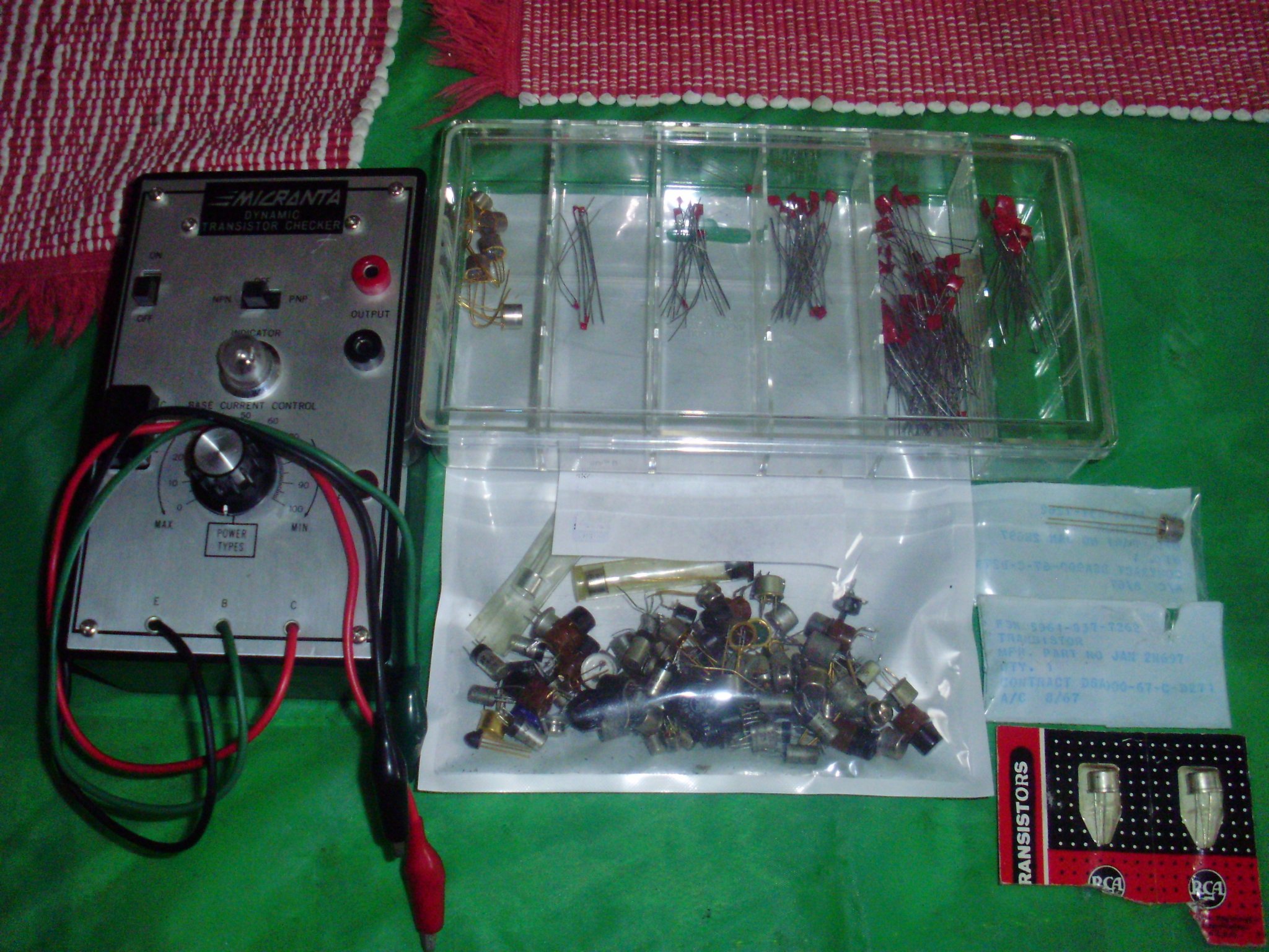

Well, I just got back and asked all sellers if they had the Heath tester, but no joy,,, I had told my hamfest buddy that I found another bad transistor in the Sansui, if he had any more Ge, and this is what he brought me,,,
Another guy there found this tester and grabbed it for me,, He checked it out, and said he uses one also, and I think its better than any that I have now, so still trying to move fwd!!!, So I got some transistors and a tester,,, just need to DL a manual,,,
If I can find any that aren't shorted or open, with reasonable values to sub for 2SA49, I can try it in the ckt...

Found 18 transistors so far that could sub for the 2SA49, just need to them... Just talked to my buddy with the alignment gear, he said he's going to align the Scott 299 he just rebuilt,, and then we'll give teh Sansui a try,,, Guess I better get that FMX board sorted by then!!!!

OK well we're makin progress because I'm finding more that wont work,,, I chose a NOS TI 2n404 from the stash I got yesterday, it tests strong on the little tester I picked up, and its values are a bit higher across the board, but not outrageous...
I get the same V reading as I did with the original 2SA49, E 19.8 B 19.6 C 19.8 VDC... I have a few more different number transistors that test good and meet the parameters, but doesn't sound like its the trans...

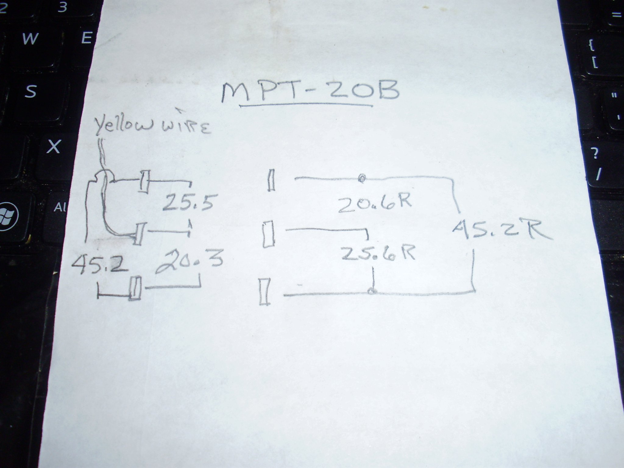

You mentioned the Tx could be bad,, shorted or open? Is there a way to test that?

Yes, measure the continuity of the coils with your ohmmeter.

The tester I got yesterday is from the Ge era,,, first out in 1967 I believe, and seems to be popular with those that use it,, I can sort the transistors I tested,,, but it may be missing something too....
I still have other transistors I can try in TR403 spot ,,,

And here's Tx resistance readings, in ckt... I also noticed that the MPX indicator lamp will briefly light if the selector is in the FM or FM stereo position...

The txs look OK...

No problem at all. I'm glad you are considering these things. They will greatly help in troubleshooting. That makes things more easily understandable and makes everything more enjoyable.
Resistance readings make little to no sense and vary widely between meters.
Try this in the short term. Take a 9V battery (or 1.5V) Stick an 8K2 (1K3 for 1.5V) resistor in series with the positive (doesn't matter, I just picked one). That will generate approximately 1 mA of current. Use your voltmeter to measure the drop across the junction and report those readings. These will make sense to you. It's a PN junction, so the positive lead goes on the "P" junction, the negative on the "N" junction. Reverse would be open with the 1.5V battery, emitter - base junctions tend to break down 6 ~ 7 VDC with silicon transistors. So 1.5 V is safer but may not conduct with a darlington transistor (3V would be nice, use a 2K7 resistor in series).

All you're doing is generating a current using a battery and resistor. You want about 1mA, so just figure out your voltage drops. Include 0.2 ~ 0.3 V for Ge and 0.55 V for Si parts. It isn't critical, but you would like it to remain in the ballpark over some time. Then all you're doing is measuring the voltage drop across the junction. Now you can see how things really work.
A reverse biased junction should not draw any current at all. So you should then read the open circuit battery voltage. Keep in mind most silicon junction will break down 6 ~ 7 VDC for the emitter - base junction.
This does not measure leakage really. For that the IT-18 places a very sensitive meter in series with the reverse biased junction and reads in uA. That is extremely useful especially with Ge transistors. Heat the part and you will see this current increase. With what you are doing, you do need to assess leakage as well as gain (beta). Silicon transistors need to measure ZERO leakage with that meter. Any at all and the part is in fact bad.
