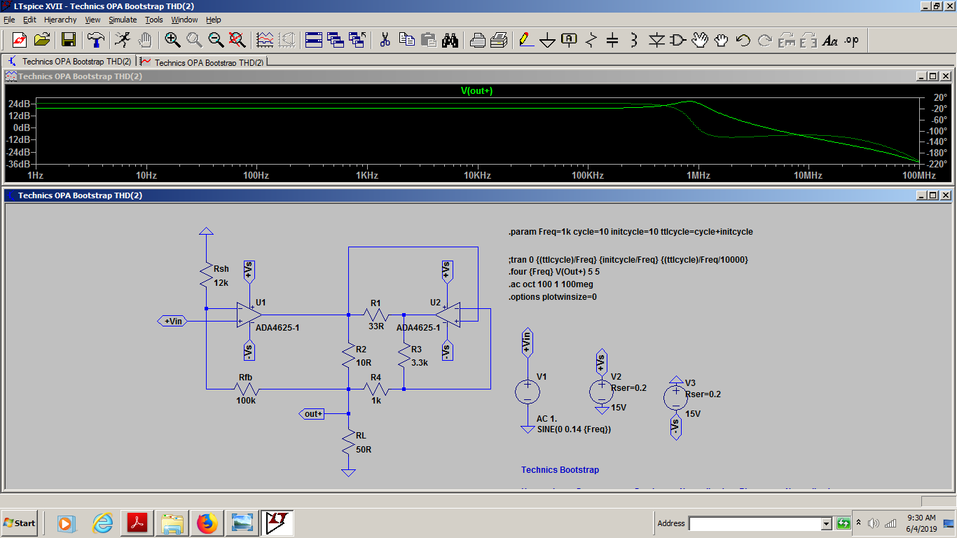

Either Spice is totally wrong, or I missed something .... Distortion is not better than using 2x opamp in parallel. So where is the benefit ?
Patrick

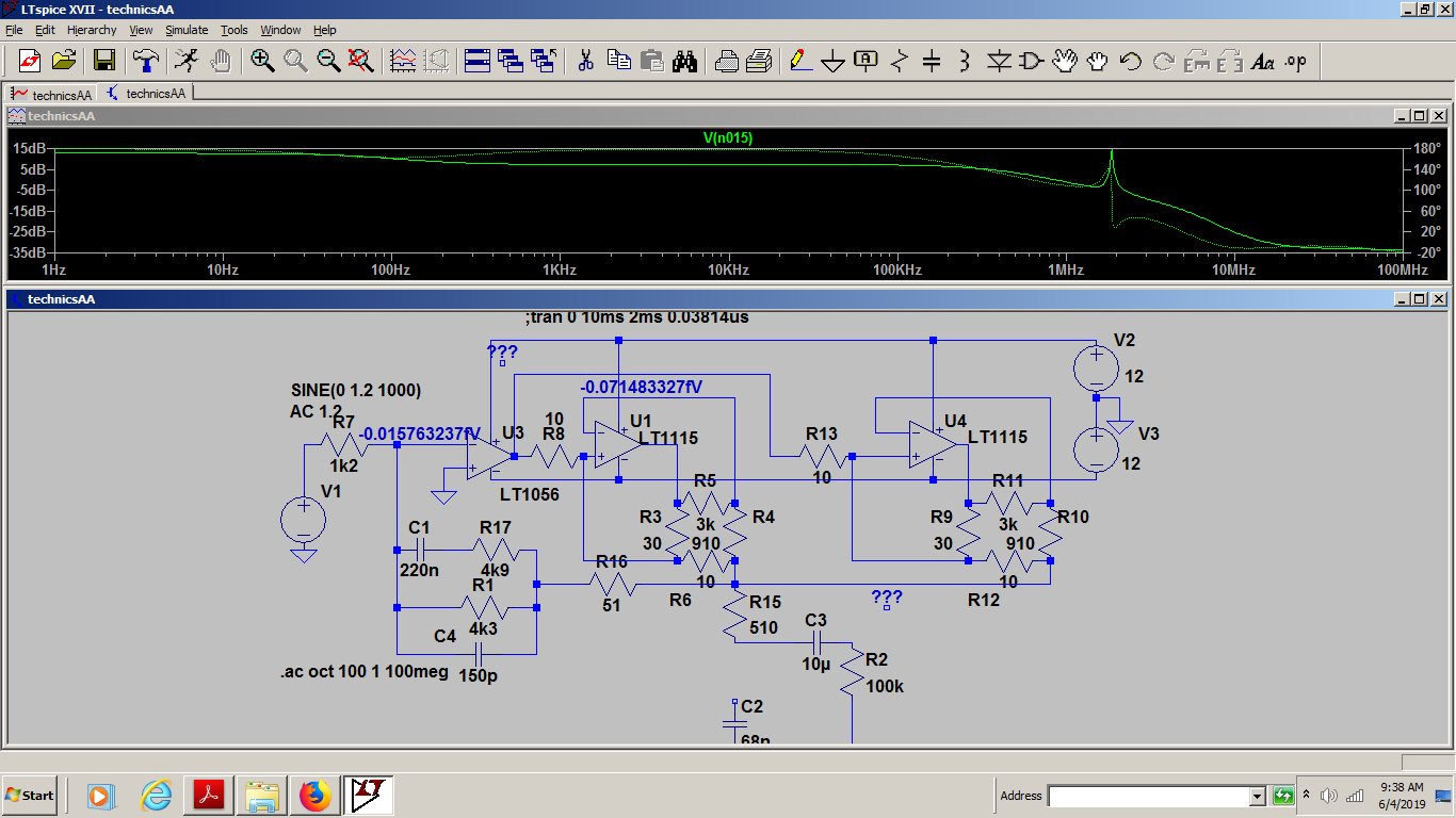

The only downside i can see with any op-amp i used in simulation is the ringing around 1...2Mhz, but i can't hear anything wrong in my real player. Any idea how could be that reduced in the most effective way?

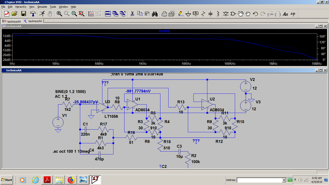

Account Closed
Joined 2010
