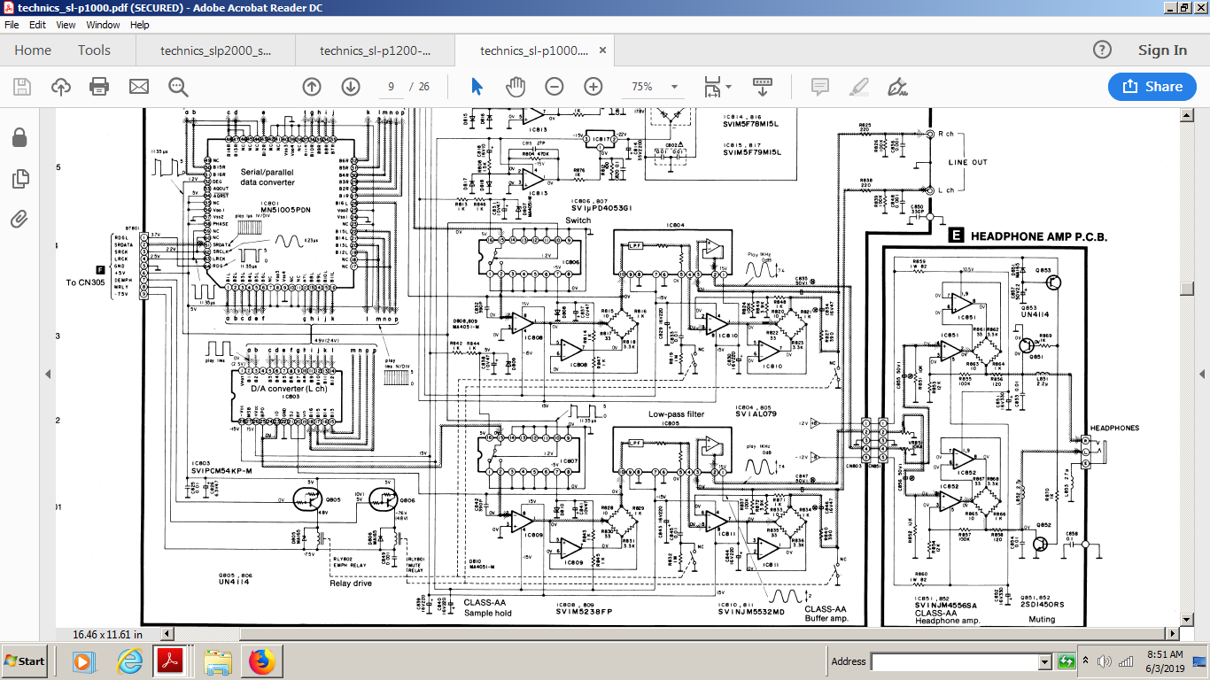

Here's the Technics headphone amp.
A2 is the load bootstrap amplifier and makes the headphone load (that's the 68 ohm and the actual headphone impedance) appear very high to A1, the main amplifier. With A1 seeing little or no load, the distortion is concomitantly low.

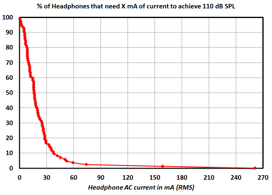

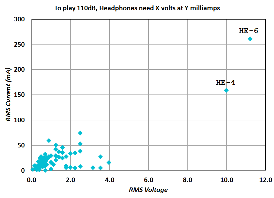

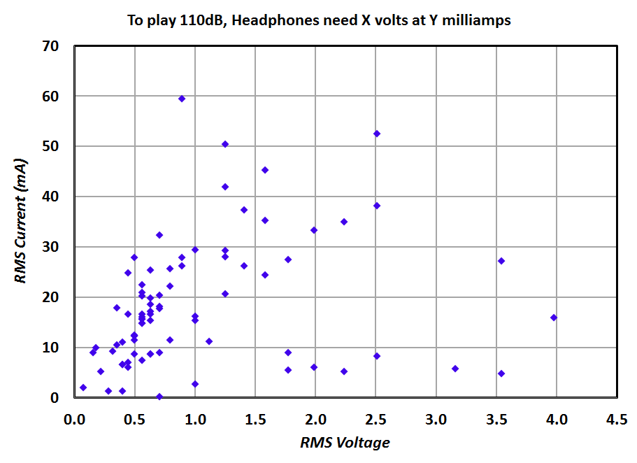

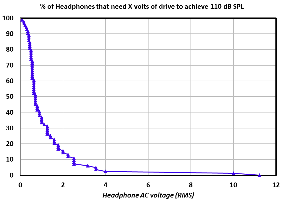

There's a nice table of electrical data covering 83 different headphones, over at head-fi.org link. They show the voltage (AC RMS) and the current (AC RMS) required, to make each pair of headphones produce 110 dB SPL (which is very loud). I plotted their data, below.
There are two "outlier" headphones which require vastly greater AC voltage and AC current, to produce 110 dB SPL: the HiFiMan HE-4 and HE-6, seen in the upper right corner of Figure 1. If we zoom in on the data for the remaining 81 headphones, the plot is Figure 2.
Figures 3 and 4 are plots of the cumulative distributions.

Very nice set of graphs, Mark

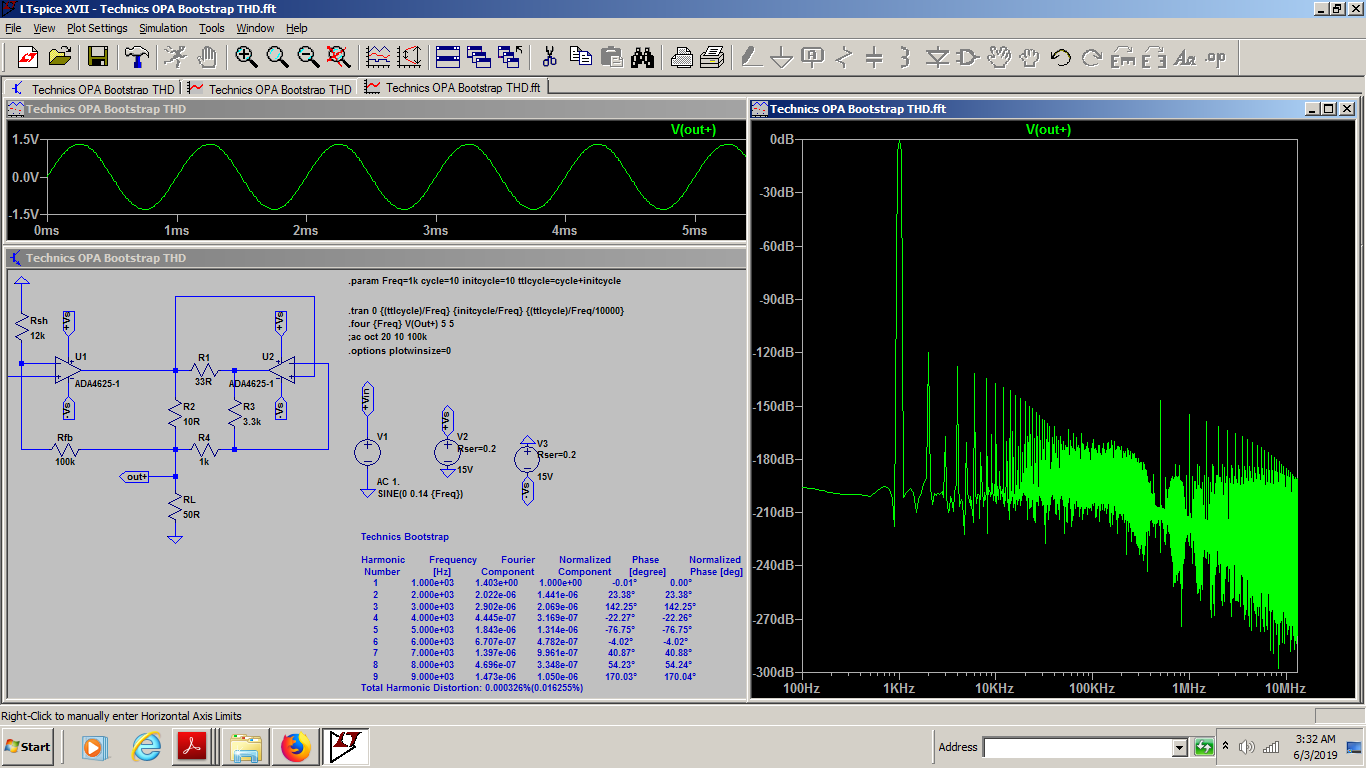

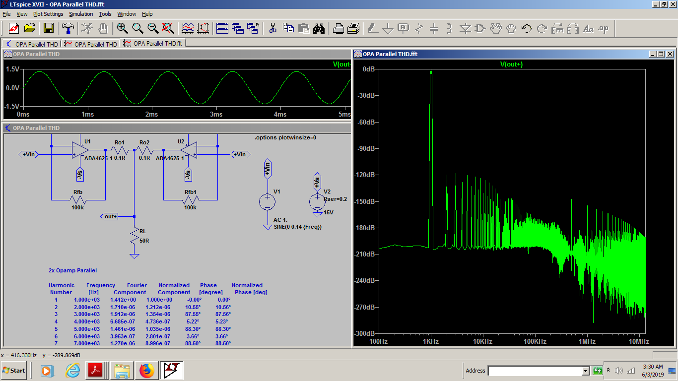

first of all you don't have equal value resistors, or even the schematics values, second you got the feedback from the wrong net. The bootstrap version is mainly even harmonics and lower!
By the way, i already built it into an i/v converter for my NEC player and it sounds very, very, very well! I'm going to build the same thing into my Denon player too.It's too good ! Technics knew their sh.t.

When you study the Technics schematics, that's mostly disappointing. The quality in the 80's and 90's was below average at Technics.
Except that this buffer was used in their best and most expensive products:
slp-2000, slp1200, slp 1000, slp 999, slp 990, slp777 and probably some other that i won't bother to know, but these were sold over a decade period which tells a lot!
Please don't get me wrong! I never knew about this buffer until 2 weeks ago and i found them by looking for a schematic that would make a better i/v converter for pcm56. I never had a Technics cd player .
I have to thank the people here to point me in the right direction with the explanation for its functioning and i also thank EUVL for its spice directives :)
So i dared to build it and I'm so happy with the idea, that I'm going to replicate this buffer in any piece of equipment i intent to restore just because it works really well.
Now you couldn't think of a more emblematic schematic for this buffer than the slp-1000:

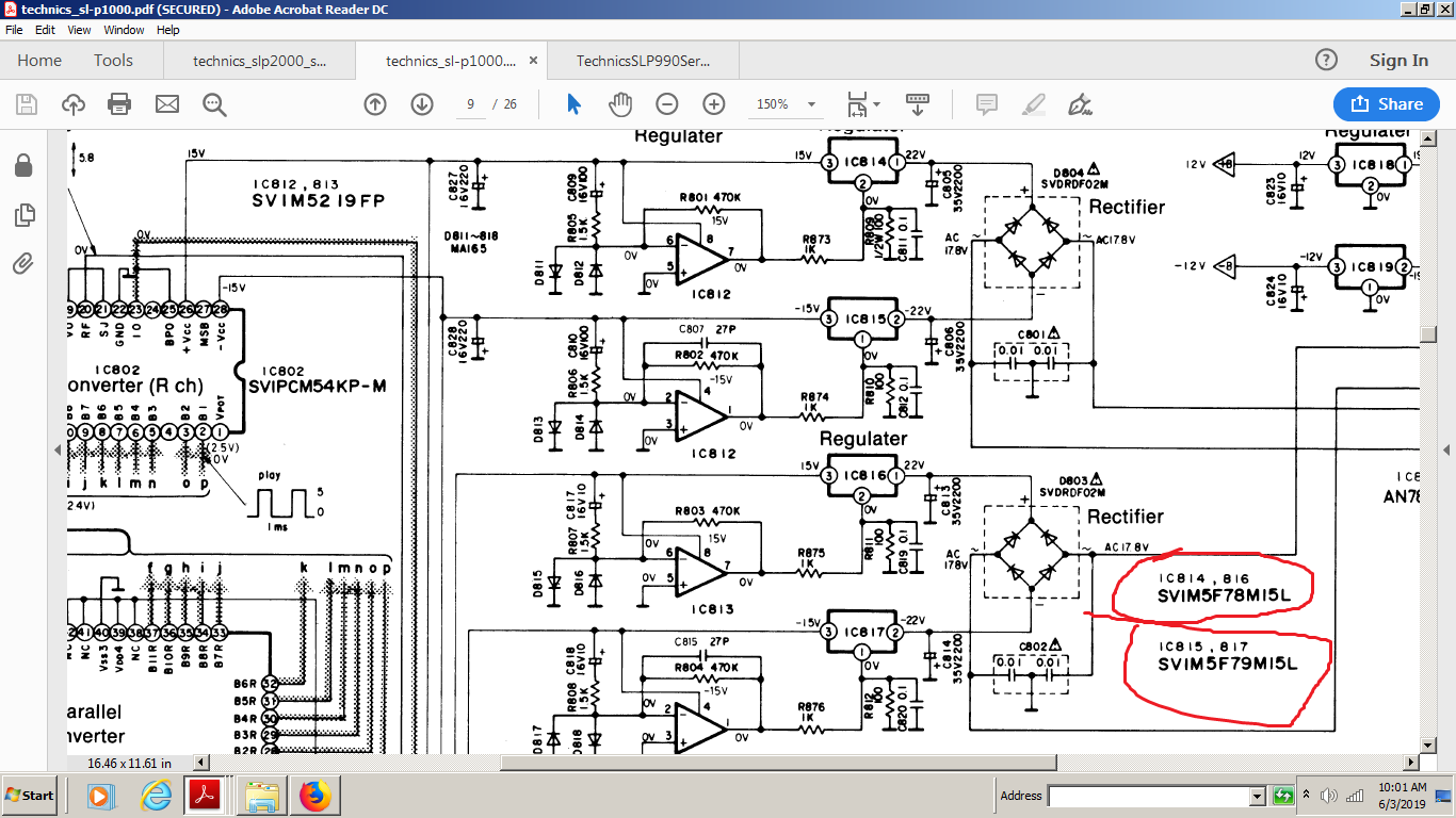

I hope you'll excuse me for this small offtopic that hopefully didn't ruin Groner's findings , but just because i dived into these Technics schematics i wonder if anyone saw the regulator sections and had any question about it.I never saw an op-amp regulating lm78xx before.These Technics "Anti high end" guys did it...
