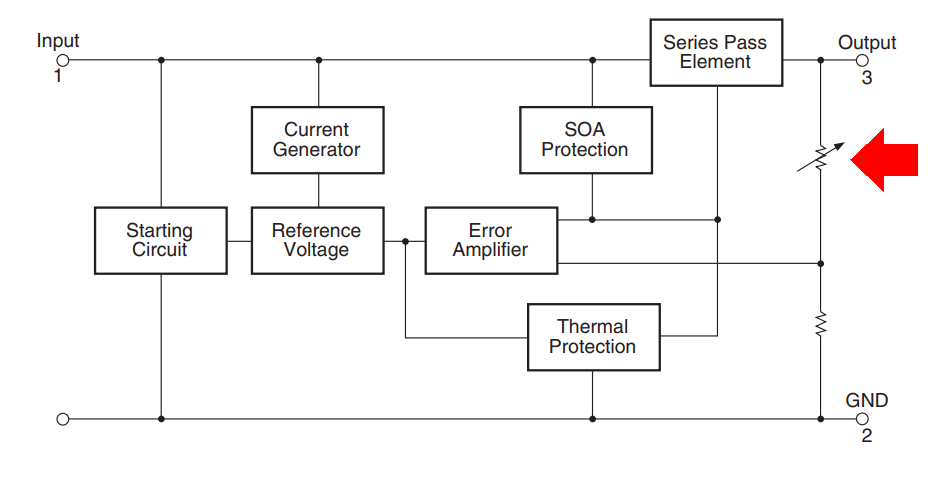

I'd have a question for anybody who's knowledgeable on this:
Is it possible that the 7805 regulators are faster than the rest of 78xx higher voltage regulator?

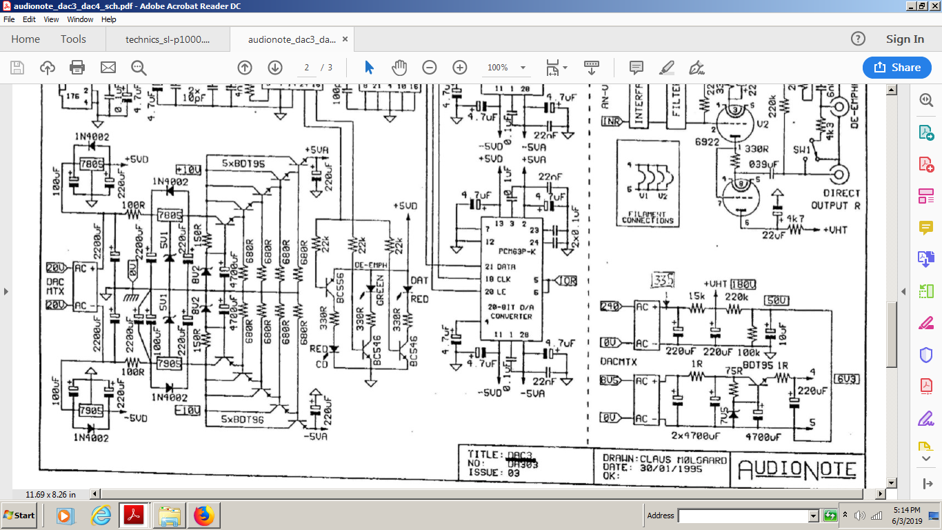

I saw the Audio Note dac 3-4 schematic and it made think about that.
In the end Groner's or other fast composite op-amp might need an equally fast regulator so we might turn this off topic into something useful.

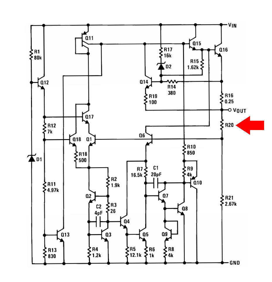

Of course it is possible. It may not be true, but it definitely is possible.
All you need to do to answer the question, is to find out how the different models in the 78xx product line differ.
This is easily discovered by merely studying the schematics given in the datasheets.
The only difference between a 7805 and a 7818 is the value of the red resistor.
Now that you know this, just decide for yourself
- When we increase the value of the red resistor, does output voltage rise, or does it fall?
- When we increase the value of the red resistor, does the regulator get faster, or does it get slower?
