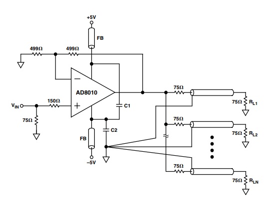

I always place one direct between the Vcc and Vee pins of the package footprint, bottom side. That seems to work well.
I've gone away from placing decoupling caps between Vcc/Vee and ground, never good to couple ground stuff into the supplies. In very low distortion circuits, that sometimes gives unexplainable (for me) higher-than-expected distortion.

The currents through the push and pull parts of a class-B op-amp output stage are essentially half-wave rectified signal currents. When they enter a ground plane or ground track with nonzero impedance at different locations, that could lead to some extra even-order distortion.
I remember that someone wrote that for that reason it is good to first combine them with a capacitor between Vcc and Vee and then use a capacitor from either Vcc or Vee (but definitely not both) to ground. I'm not sure how that is supposed to work, though, unless there is something obstructing the signal current flow via the power supply to ground.
To get rid of this effect, one could give each op-amp a floating 30 V supply or a 30 V shunt regulator between Vcc and Vee, use a common -15 V supply from Vee to ground, and put decoupling between the Vcc's and Vee and between Vee and ground. Trying to force the output stages into class A could also help.

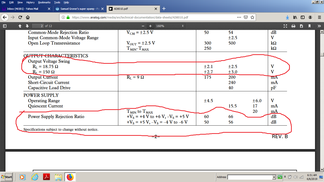

I was one, this was the only way to meet broadcast diff-gain diff phase performance for 8 back terminated loads (18.75 Ohms) from an SO8 op-amp.
But they get better at frequencies where it's needed because of the falling PSSR.
The issue I was considering is distorted currents flowing through ground wiring, which has no relation to PSRR.

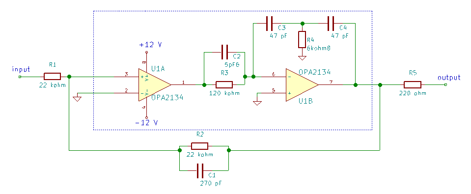

Like I implied in an earlier post, I've become a bit fascinated with the idea of using conditionally stable composite op-amps to make a low-distortion two-integrator oscillator. As an intermediate step, I've been playing a bit with a root locus program and a pole-zero extraction program trying to find a way to make a composite op-amp from two identical op-amps, for example a dual op-amp (which has the disadvantage of supply, substrate and thermal coupling between the op-amps, but the advantage that it's cheaper and more compact than two separate op-amps).
Today I built up the result on a piece of perfboard, see the attachment. I actually want to use LM4562 op-amps with R3 = 18 kohm and R4 = 1 kohm, but not having any LM4562s in the attic, I scaled everything for an OPA2134 for this first test. Basically R3 and R4 have to be inversely proportional to the gain-bandwidth product of the op-amp, assuming unity-gain-stable op-amps with normal first-order roll-off up to unity open loop gain.
The part between dashes is the composite op-amp, the rest is the feedback around it. I've made a simple inverting amplifier to see if it works at all. Simple functional checks look OK: all bias voltages make sense, there is no hand effect and when I played a Tracy Chapman CD and some dancehall reggae through this amplifier, the tweeters didn't go up in smoke and the music sounded normal. Temporarily reducing R1 to overload the amplifier also didn't cause any disasters.

Why R5 so big / what's the smallest R5 that can be tolerated ?

I haven't a clue how low R5 could be, probably about the same as for a conventional OPA2134 voltage follower. It could obviously be 0 ohm without any capacitive load, but as I'm driving a 5 m-long cheap cable, I just picked a value that's likely to be much greater than the open-loop output impedance of the OPA2134.
