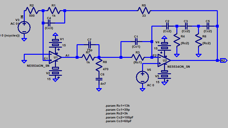

I wanted to look into it halfway 2019, but never got further than a basic functional check of this OPA2134 circuit:
https://www.diyaudio.com/forums/ana...amuel-groners-super-opamp-24.html#post5819098
That was an interesting approach and I played with LTspice to extend the idea, target being to exploit the full Aol @ 20kHz for master and slave opamp, running at low noise gain. I also breadboarded it and as expected it didn't work that well... at least I managed it stop being an Oscillator at some point.
In the Bode plot, top to bottom @ 10Hz:
- composite open-loop gain (red)
- composite loop gain (green)
- master OpAmp Aol (brown)
- slave OpAmp Acl (cyan)
- noise gain (blue)
Btw, the sim was also double-checked with Tian loop gain probe and it showed little difference, basically only slight changes above 10Mhz.
Basically, if all is under full control and can be trimmed and extensively tested this might be a workable circuit for experimental purposes. Then again, low gain inverting isn't just that rewarding after all. Non-inverting is... if we manage to control CM distortion (eg by rail-shifting the master OpAmp with the signal).

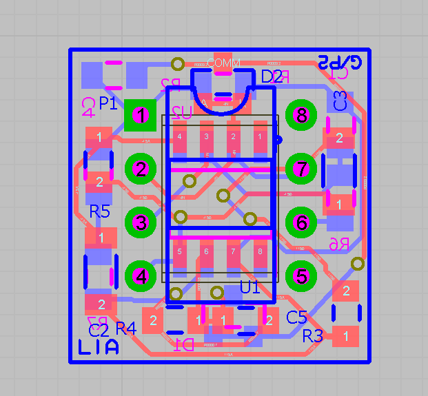

I've got some I don't need anymore. This is a very small PCB, and it takes a regular DIL08 spaced adapter to fit a DIL08 footprint. See attached.
Tiny components - you need good dexterity and a fine solder point.
