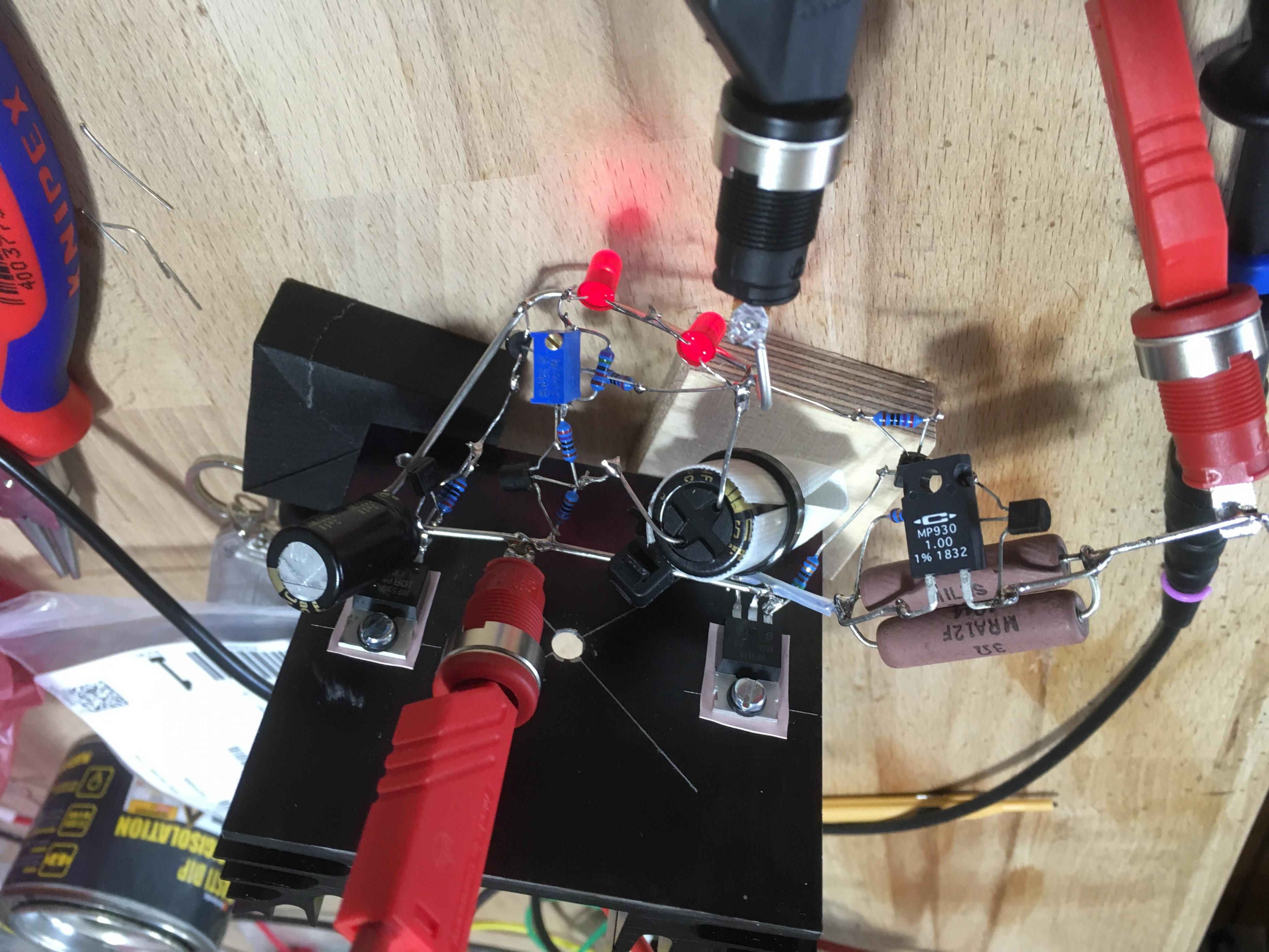

The line was so straight, that I spent quite some time trying to figure out where the error in my measurement setup was.... 😎
Point to point can sometimes lead to less parasitics but I wasn't sure about it in that case as I assume that many of my leads are longer than the traces on the pcb. Anyhow, the regulator works as hoped for. Voltage falls slightly over about 10 minutes after switch on and remains stable.
It will help supply a DDDAC, I can't say anything about the subjective effects on sound quality as I haven't used that DAC with any other supply and for now am too lazy to try.
Source is a SMPS, filtered with ferrites on + and - and 560uF leaving 2.4mV RMS at 64kHz.

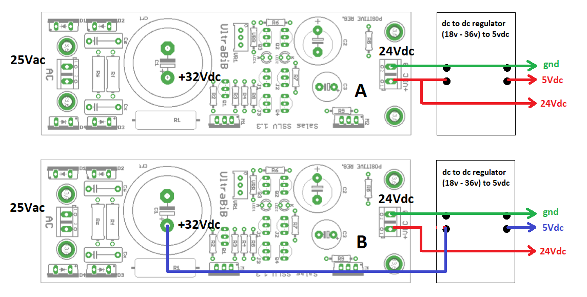

hello salas,
i need 2 dc voltages regulation, 24v and 5v.
i am planing to use one ultrabib for 24v, and one small dc to dc reg. for 5v.
is it better to put the small 5v reg. after 24v or before? (as picture)
thanks.
Jumping in with as a bib user opinion:
I would avoid jumping to 5V from so high anyway(dissipation concern or switching noise otherwise);
also i would not burden the shunt with more than the exact calculated and expected load indicated as first step (choosing R1)
least but not last, a voltage regulator after a current regulator is at least weird.
The DC/DC collaboration is going to contaminate the Ubib's ground path with some switching noise anyway. Surely tap on the raw DC available at the main reservoir capacitor when you can't have an independent voltage source for the converter. Include a GND cable from C1's (-) to the switching converter. So both current paths to it are away from the output nodes at least and its not limited by the constant current source, avoiding extra heat also by not having to set extra constant current for it.
okay thanks. noted.

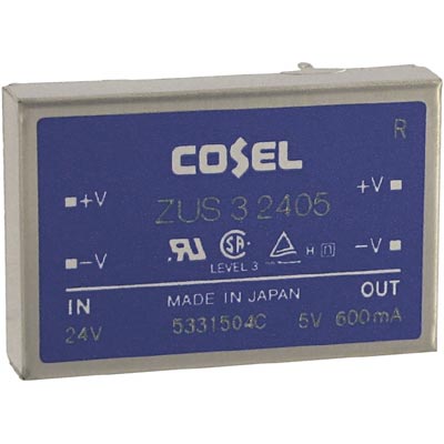

btw for 5v i'm using cosel dc/dc converters. (this is what i have in hand)
datasheet says it can handle 18v-36v input for 5v output.
They are very versatile those things for practical purposes. I tried a CUI one recently for some instrumentation op-amp phono experiments. 9-36V input, +/-24V output. I put a common mode choke on its input and RC filters on its output. To drop the rails voltage and improve on the noise. The opamps have very high PSRR anyway and the main switching noise is far beyond audio so lets try it I thought.
Although the phono's audio band was looking very clean on FFT because there are no hum frequencies in a DC/DC as it switches in the hundreds of kHz, and I could avoid a transformer's field near with using a wall wart, sadly the hiss went much noticeably up through wide band integration and the sound quality was off for dynamics and tonality too. Ultimately I replaced it with a Ubib and the sound went so much better. Night and day contrast better. Lesson is be practical for size and efficiency if you can but compare to know the compromises if any in various applications.
