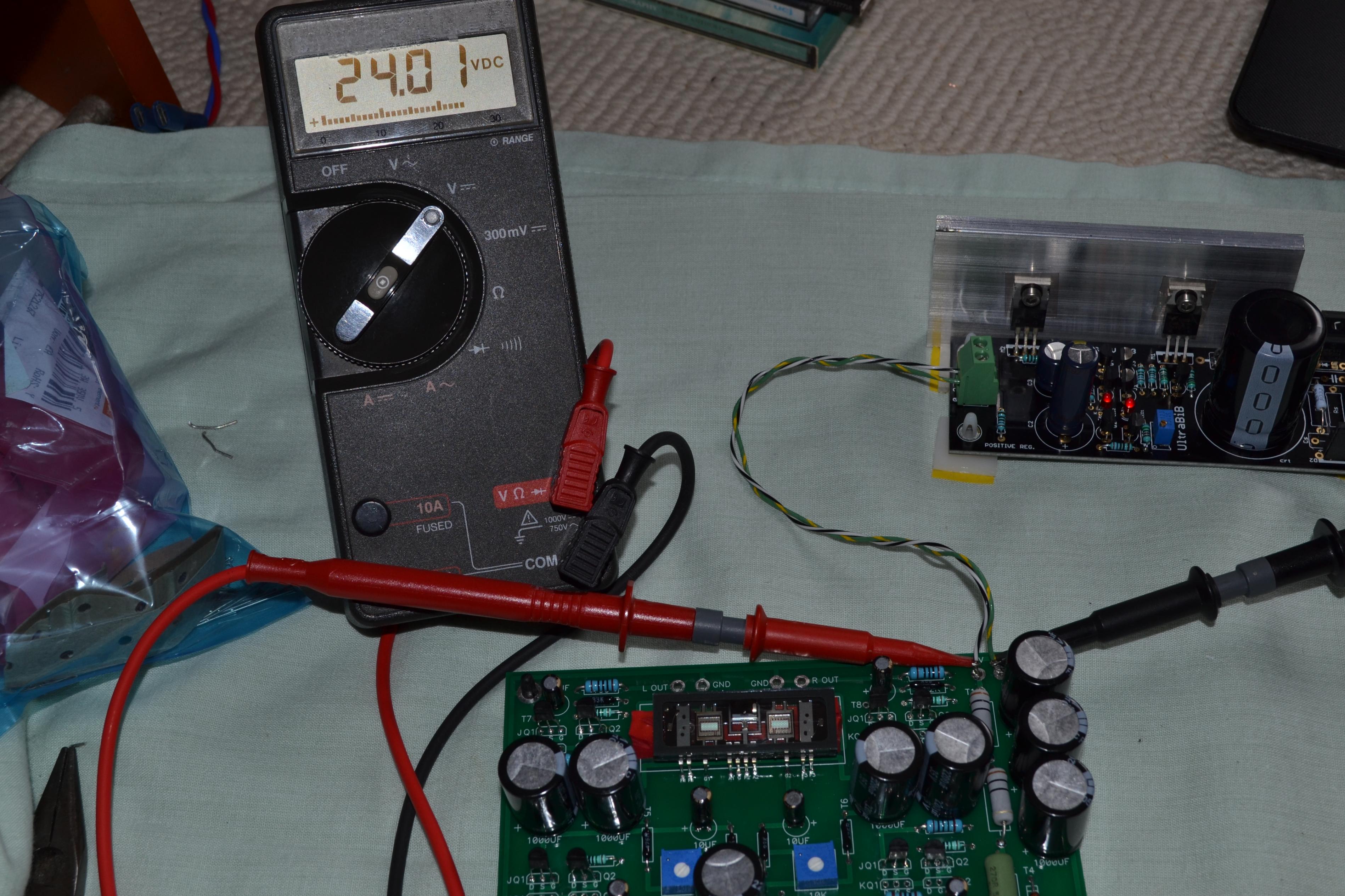

some measure
over R1 0.59 volt on pos and neg board R1 2 ohm
from 0 to 0 i measure 18v
have tried all places to see if i can measure some volt from heatsink to component on
pos and neg board no volt to measure
just use 2 18vac
problem solved
thanks so much Salas
now it is time to try it in the real world
Best bjarne
problem solved
Best bjarne
Congratulations. Let us know how you will like it. By the way, the current limiter sections saved your PSU from burning by this mistake.

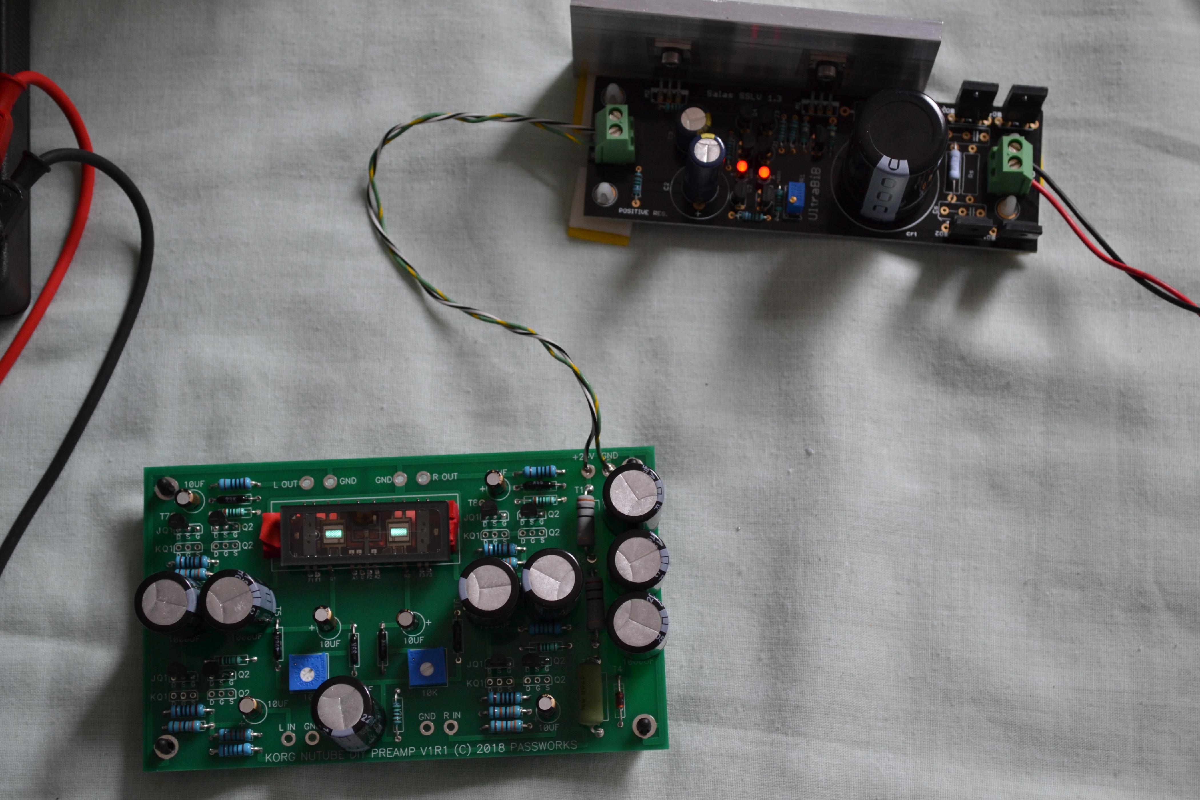

Have now tried the reg on my dac
but the neg will not start op pos will
have make a test with a 33ohm resistor the neg reg can deliver about 490ma R1 1 ohm
can it have something to do with the 5.5vdc supply,,, it share 0vdc with the 15vdc
i must try to figure how my dac is connectet
the supply i use now is a supply where 5.5vdc and +- 15vdc is on same board

The current consumption of the various loads must be covered by the settings, all AC secondaries must be isolated, all Mosfets must be isolated.
Check for no voltage difference between any 0V points at the reg outputs.
How big should the heat sinks be? Current I use will be 450mA, toroid has rating of 18V im using 15V...
M1 should be dissipating about 3.3W in your case, M2 depends on how much power it shares with the load. If its another 3W it burns then 6W total, a 3C/W spec shared sink for M1 & M2 should be enough.
