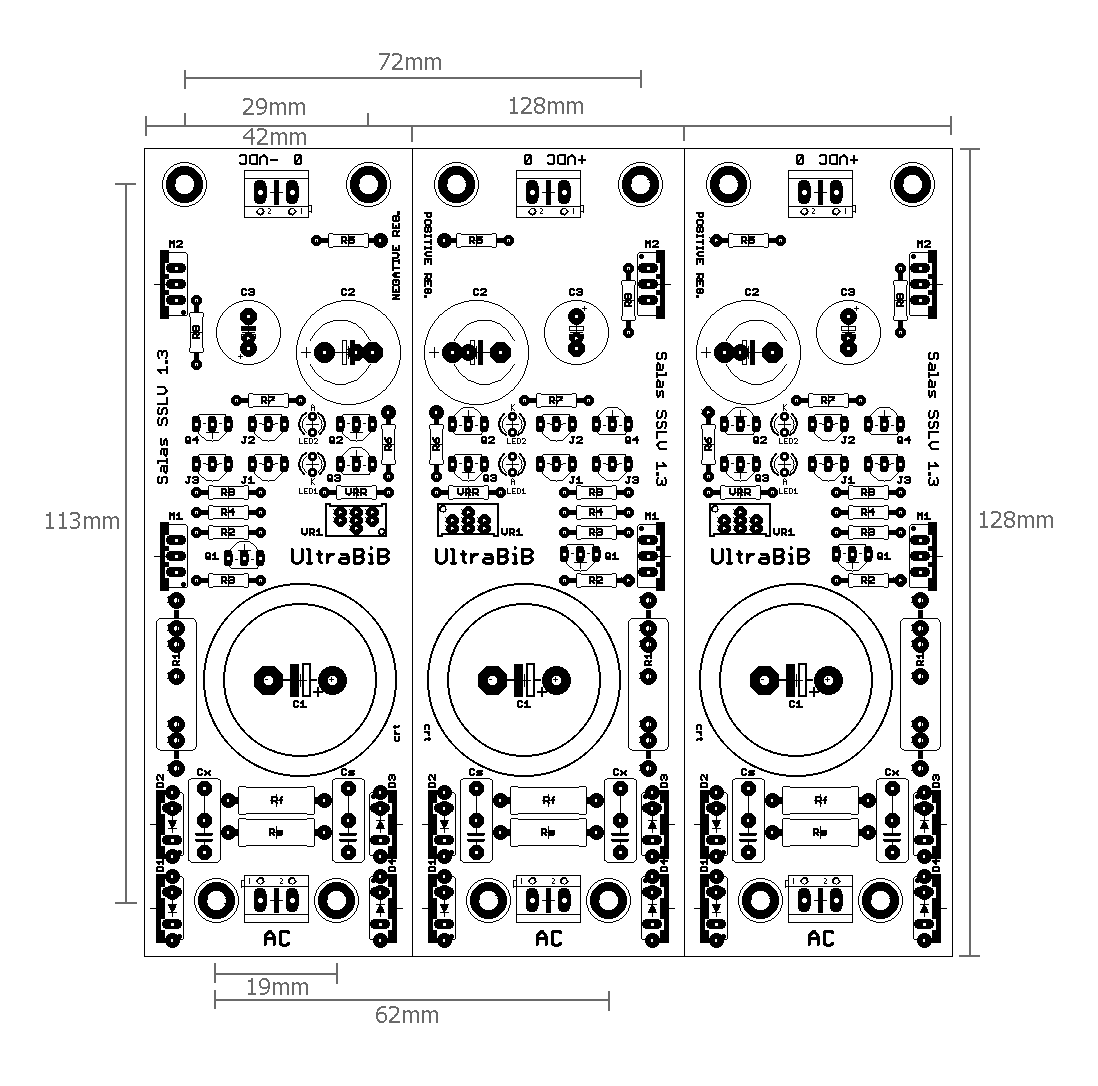

I made a dimensions picture for you guys (also added in post#1)
