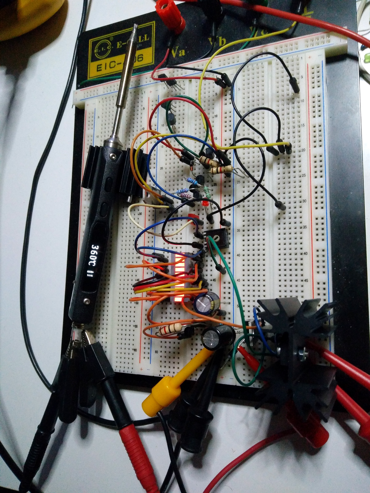

Bring over the RPI if you can so we will be able to see what is going on with its PSU requirements and settings. I have already tested the breadboard L-Adapter loaded with a TS100 soldering iron and a 40+40W SMSL amp on 4Ω speakers with success.

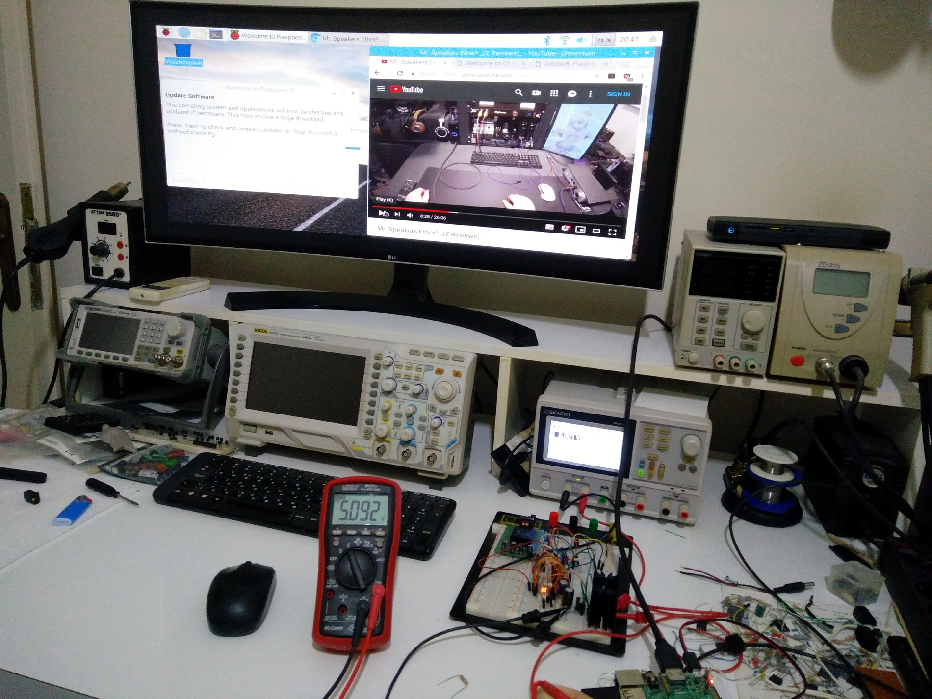

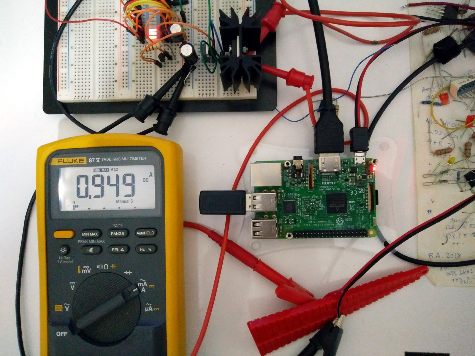

I did a little stress test. I put the meter in series between the PSU and the RPI3, then booted it and tried to throttle it with two media streams playing along. Live web TV and an HD movie trailer on YouTube. Used Wi-Fi. No storage peripherals. Just an old wireless keyboard & mouse receiver stick. It showed up to 95% CPU and did few frames & audio hick ups. 0.95A was caught by the Fluke's min max function. After shutdown it still pulls circa 110mA.
Maybe it bursts for even more current faster than the Fluke can catch? Maybe. But it never reset or did anything funny like freezing the OS. The 38mm tall board level sink stood quite nicely for 3V Vin-Vout difference (8Vin 5.1Vout).

Suspect the Fluke did what Flukes do - worked properly. Read somewhere that, without loading it down with periperals, the 3B runs at around 700mA.

During boot it recorded 598mA max, when not pushing it but opening media and forum windows it hovered higher pushing around 700mA. Occasionally 750mA. I used the latest official Raspbian Stretch Nov 2018 OS.

Has a "waveform" chart function instead which is silly, does squat jaggies but it does not record numbers, not even has numbered dents across the XY. The Fluke is faster also I believe. It now caught a 0.679A during the boot in min max mode. But the supply never displayed more than 0.56A during that. Lost it between updating digits. So that is why they mentioned 700mA.
