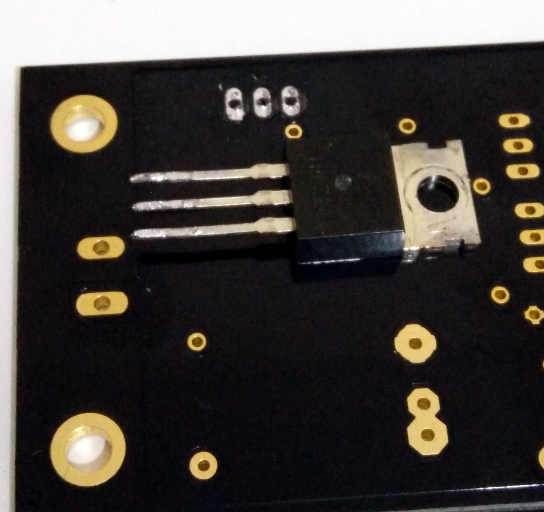

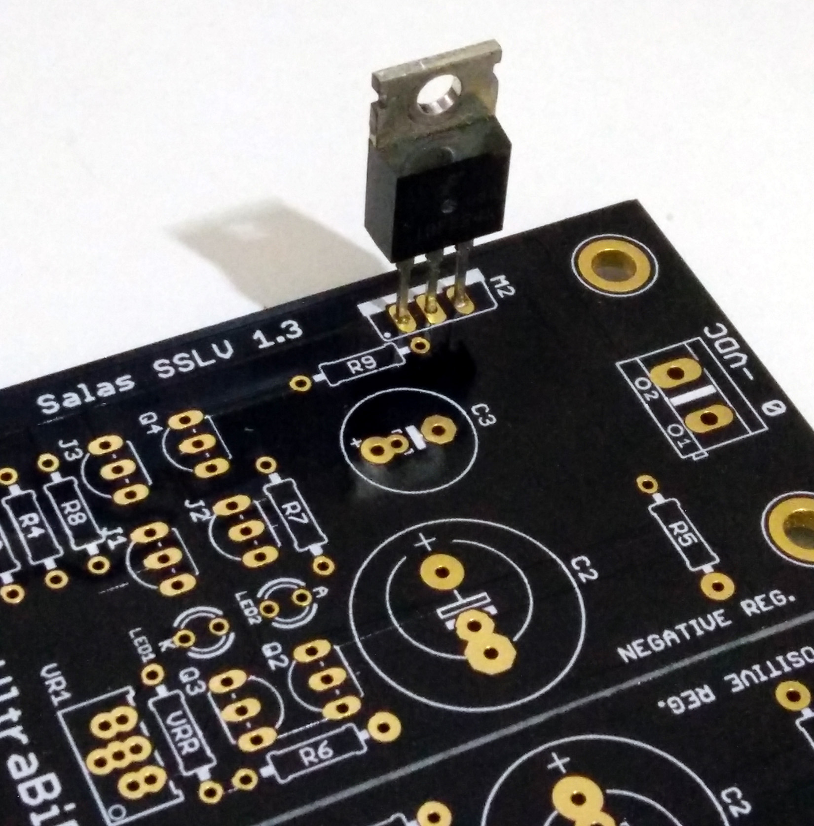

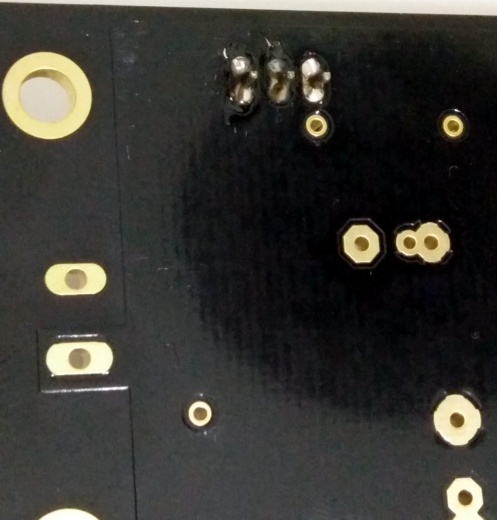

You got me worried and I just performed a desoldering test. Not the easiest board I agree, it took some time, but I managed. With an 80 Euro desoldering station gun (ZD-915) in bad enough back-filter and nozzle state. I also used the cheapest greyer leaded 0.5mm solder wire I had around. It wasn't flowing too well during the soldering phase under my 90W Oki/Metcal iron... Just tried to make the situation worst possible.

i dont know. im not faulting the product. i know it is my problem but i have tired everything i could, i ruined one positive board. oredered all compoents, bought a newe soldering station weller WD1 and then ruined the second positive board and im not even gonna bother trying the remove the components again. the transitory just never come out. the caps are the only ones that i can remove. all resistors are very difficult too. im just so frustrated.

Use a dim bulb tester next time you power up. Although you won't repeat such a big electrical mistake as having both rails MOSFETS non insulated on a common sink, you never know what can go wrong next. Leave it aside for a while, build a bulb tester. When the frustration will go away try again. Money on a good iron like a Weller WD1 is money well spent anyway.
P.S.
Pick each leg of a resistor with long nose pliers from the upper side and pull as you heat up the pad on the bottom side. Clear the holes in the end with a sucking tool.
Dadbeh, I didn't read the backstory, but Salas is using a desoldering station with vacuum and you are using a very nice soldering station. Desoldering with braid, etc. on thick PCBs with heavy ground planes is never easy and risks the board. A desoldering gun/station makes ALL the difference! My Haako desoldering gun is invaluable for the rare times I need it. I never really mastered desoldering braid + soldering iron - too many lifted pads. With the desoldering gun component removal is a 30 second, no stress affair with a 100% certain outcome.
BK
BK
thanks man. i looked it up it is 300 bucks. i can not afford it.
