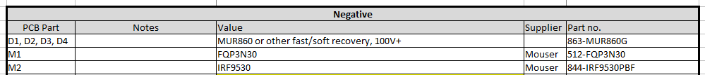

i need to buy the mosfets for both positive and negative. i see in the first post but i remember that the ones in kit were different and better. i am not able to read it off the mosfets themseves. could someone please give me part numbers or mouser links for the correct mosfets that tea bag includesi n the kit for both rails?
Positive side: M1 PMOS M2 NMOS. Negative side: M1 NMOS M2 PMOS. Make sure they are not put in wrong order. Maybe they aren't broken. Shine with a flashlight on them from near enough distance and you can read them.
Those are not from Tea but from an order a local friend done during the early beta testing (DimDim). I don't know of any different or better.
