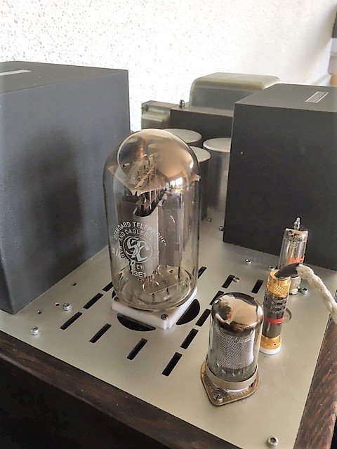

Attached a simplified Schematic of an amplifier with C3M and 13e1se.
I replaced the cathode resistor/bypass cap of 13e1 with the 1.3 BIB.
One monoblock is running fine the first 15 minutes or so, wi music, then the 13e1 starts to oscillate. wiring between reg and cathode of 13e1 is ca 10 cm.
The other amp similar, but running without this issue.
13e1 160ma, 24v at cathode. Input to 1-3 reg is 22v Ac. R1 2,4 ohm
Suggestions ?
The tubes may differ in something between the monos so swap them first and if it happens again change the Ubib's C3 cap with one of bit lower ESR in the troublesome channel and/or increase the wiring length a bit I would guess
Thanks : Spot on. Oscillation followed the tube. I have been playing with 13e1's about ten years, so I should have known...

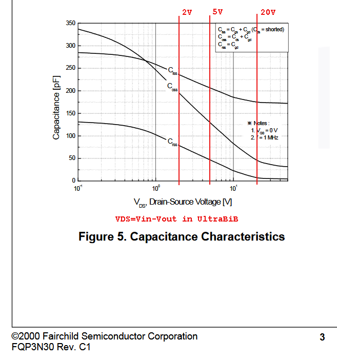

Am I ok to use a transformer with 22v secondaries to achieve the 17v needed for the DCG3.
Apart from extra heat on M1s, 22VAC is good for M1s PSRR because more voltage drop vin-vout across them linearizes their parasitic capacitance. They are characterized for pF at 25V VDS for that reason. But heat will bite you if you haven't got the sinking when CC is also high. 18VAC is middle of the road. It would work for 17V output even on 15VAC since it takes little to drop to hang on there in reality, (CCS mA sagging starts at Vin-Vout <1.7V for ~200mA CC settings. At 600mA CC it starts at Vin-Vout <2.5V), but the CCS quality will be lower and not enough space will be left for mains play either. 5V drop vin-vout good 10V nice 20V very nice. Heat on M1 good, bad, super bad. You win some you lose some.

33uF/50V ES has lower 100kHz ESR than same KZ on my meter and Pana FC 100uF/50V is in the middle. But look about higher value grid stopper to the temperamental one first or play with some physical arrangement like the cabling length and dressing or the bias point because some parasitic that changes with temperature seems to set it off due to mechanical tolerances maybe. Is it the CV type or the normal type British tube? Rare beasts those.
"P.S. Using a shunt reg instead of cathode resistor//cap certainly changes the parameters of the tubes circuit. Since only one of the two valves finds trouble after 15 minutes of heat either try a third one if you got or tweak the circuit values a bit before tweaking the shunt seems like a logical procedure."
I have several 13e1's . Different types. The one pictured is "behaving" well with your reg. It's predecessor lasted almost 10 years. The text on the tube will fade during fall. The temperamental one is certainly of the the same making. As these tubes differ a lot I use a variabel voltage regulator for g2 supply ( John Swensons regulator, files for pcb downloaded from Gary Pimm's website many years ago).
If memory serves the lady get's more temperamental with increasing g2 voltage. I remember that many suggested that high g2 voltage was a key to get lower distortion. However I found this not to be the case. The key to lower distortion was regulation of the g2' supplies. I tried several solutions back then, vr tubes, emitterfollower, maida, and the Swenson regulator was choosen because of it's merrit, and because it is easy to alter vg2 ( matching the tubes). The difference in THD at 30w was almost 1.5 % between regulated and unregulated Vg2.
As for your 1.3 regulator: It certainly "thightens the bass" vs the resistor/cap
A nice improvement!
I swapped in another 13e1 yesterday, it went through the roof after a few minutes. So I will proceed as pr your suggestions. First step is to turn Vg2-Vk down below 100v and then slowly up it to check at what value it "take off"
I guess you are going to solve it by tweaking the valve settings since one such type behaves already. Upping its grid-stopper value could be helpful too (?). Good luck and keep us posted.
