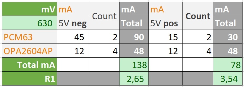

I bought 3.3 ohm resistors, will they suit my requirements?

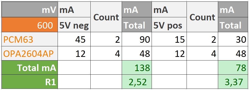

I put a table in Excel and took the information on mA from the datasheet.
Whatever total mA load add 100mA more for headroom (mAFinal). Then calculate R1=600mV/mAFinal.
3.3 ohm, suitable for -5V and +5V?Whatever total mA load add 100mA more for headroom (mAFinal). Then calculate R1=600mV/mAFinal.
The minus shows 2.5 ohms. Plus, shows 3.3 ohms in the table.
Can I put 3.3 also for the minus? Instead of 2.5? How critical is a difference of 0.08 ohm?
Its 0.8Ω actuallyCan I put 3.3 also for the minus? Instead of 2.5? How critical is a difference of 0.08 ohm?
Yes, I accidentally added an extra zero.Its 0.8Ω actually
I had to buy an additional 0.75ohm
to reduce 3.3 ohms.
