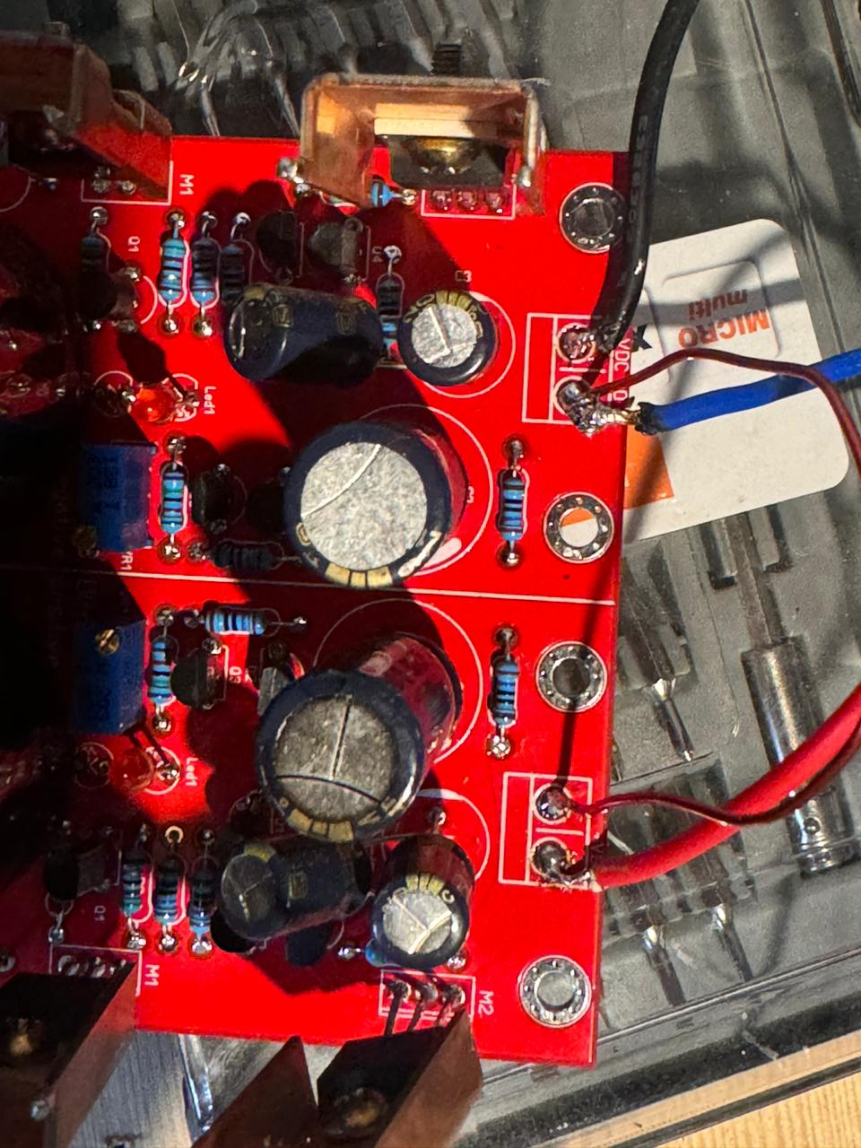

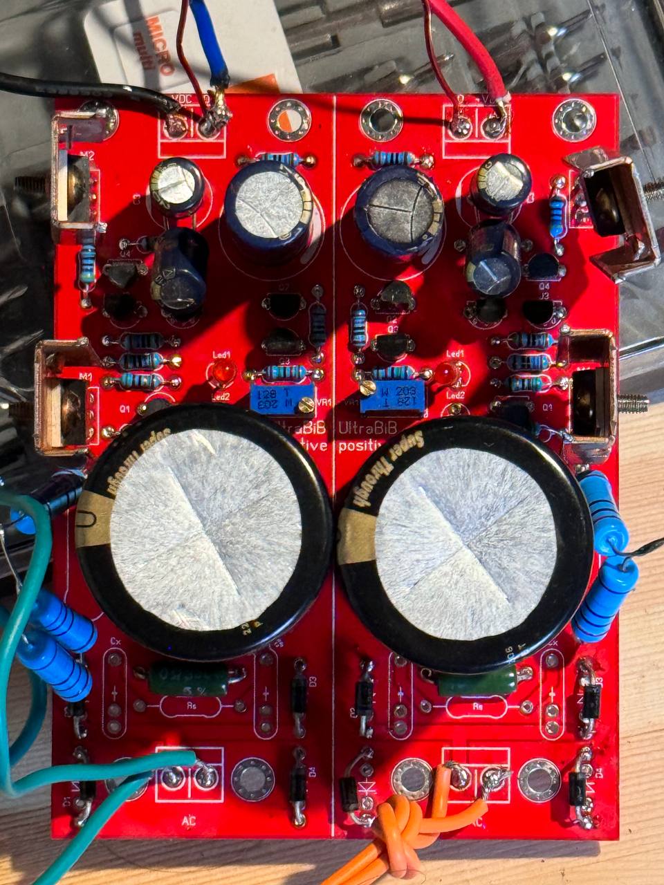

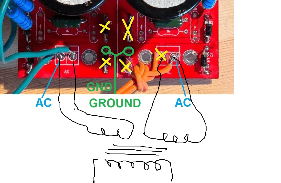

The blue wire is the total ground, when I turn it off, everything works.
If you turn it on, it doesn't work.
The positive part of the board does not work, the light blinks and the sound is boom boom and that’s it.
What should I do?

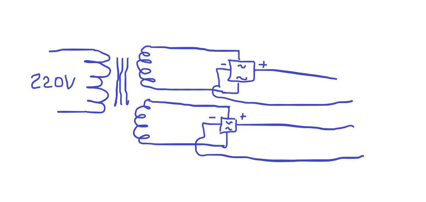

As I understand it, you need a dual polar transformer with a single common ground.
But to which “AC” do you need to connect the common wire from the transformer?
if there are two different windings... then where can I get a common ground?
The best practice is to keep the grounds of the positive and negative regulators separated until you get to the load. There you can have the two grounds connect to each other.
What you have shown in the picture will not work. You need a transformer with two separate secondary windings and two full wave bridge rectifiers.

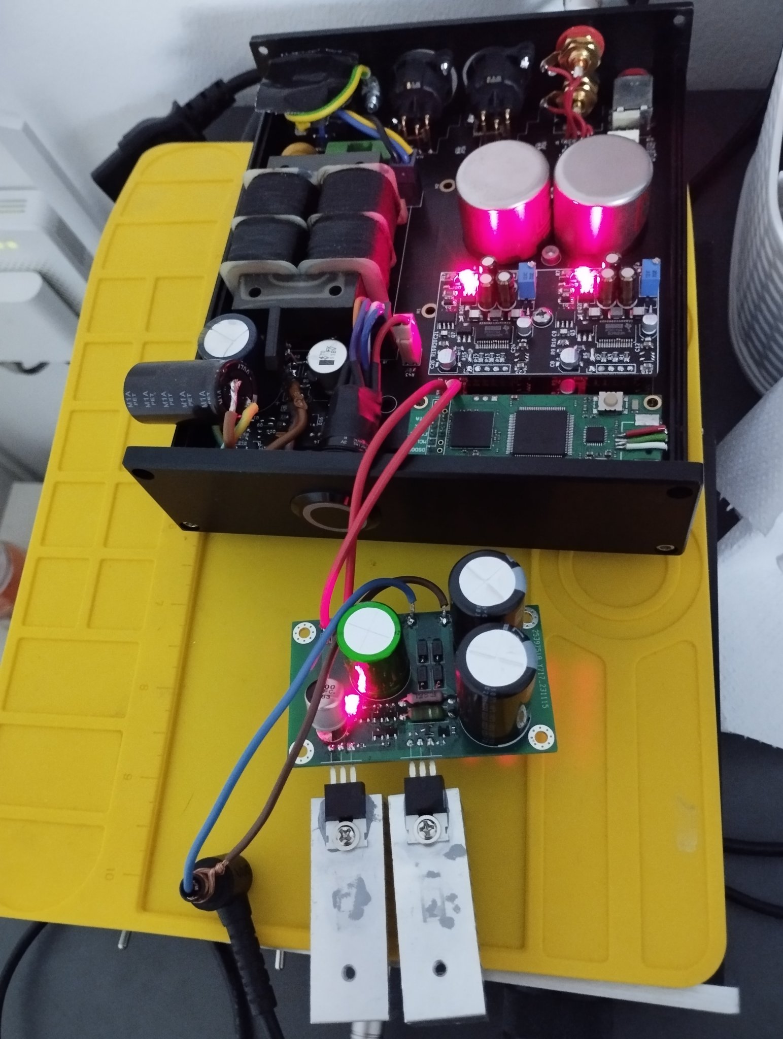

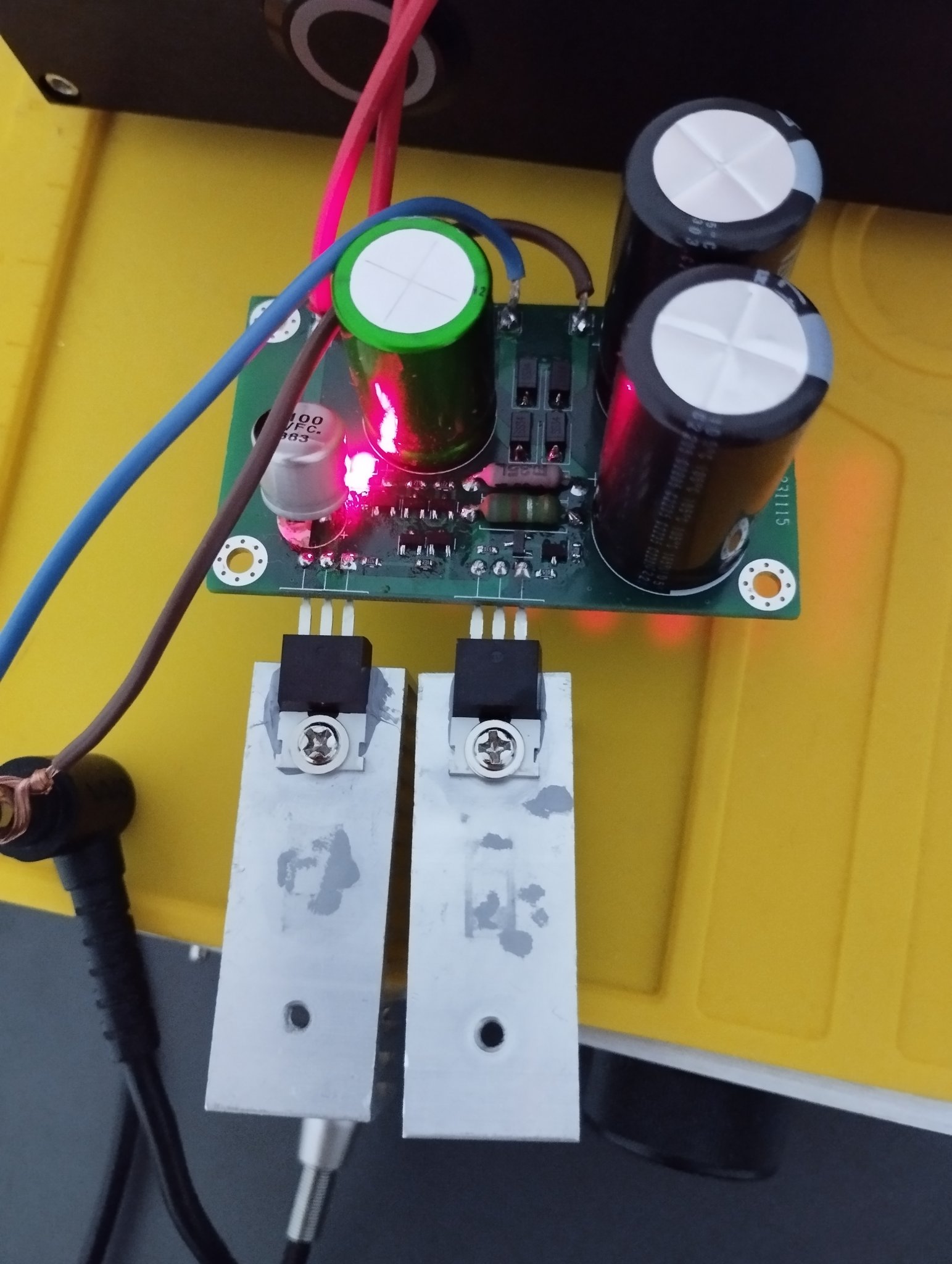

I made a small smd regulator pcb for my diy dac. The sound is absolutely fantastic. Better in every aspect than my current super regulator (which i maybe didn't tune very well i guess).
For now i feed it with smps wallwart, but I will buy suitable transformer soon.
19VDC smps input (will change to toroidal transformer 12VAC soon)
10,5VDC output
CCS setting-700mA
M1-IRF9610
M2-IRF530
BC859C and BC807-40 transistors
SUSUMU RG 0603 resistors 10-25ppm
2SK209-GR jfet-s for CCS-s (135R degeneration resistors, 1.8mA current)
Lite-On RED leds - will change that to HLMP-6000
C1-2x Nichicon 4700uF, 35V
C2-Nichicon ES 470uF, 35V
C3-SMD PANASONIC FC 100uF, 35V (0.15ohm ESR)
PCB is 4 layer of which 3 layers are GND. I wanted to have top and bottom layer separated by just 0.2mm
Out of 700mA CCS setting i have 500mA constant load (4 mini local shunts) 100-120mA spare current and the rest is used by digital portion
Is the ccs jfet suitable for my build? Is it not degrading the regulator performance?

Nice construction!
Did you design the DAC? Could you share the design?
Thanks!!!
