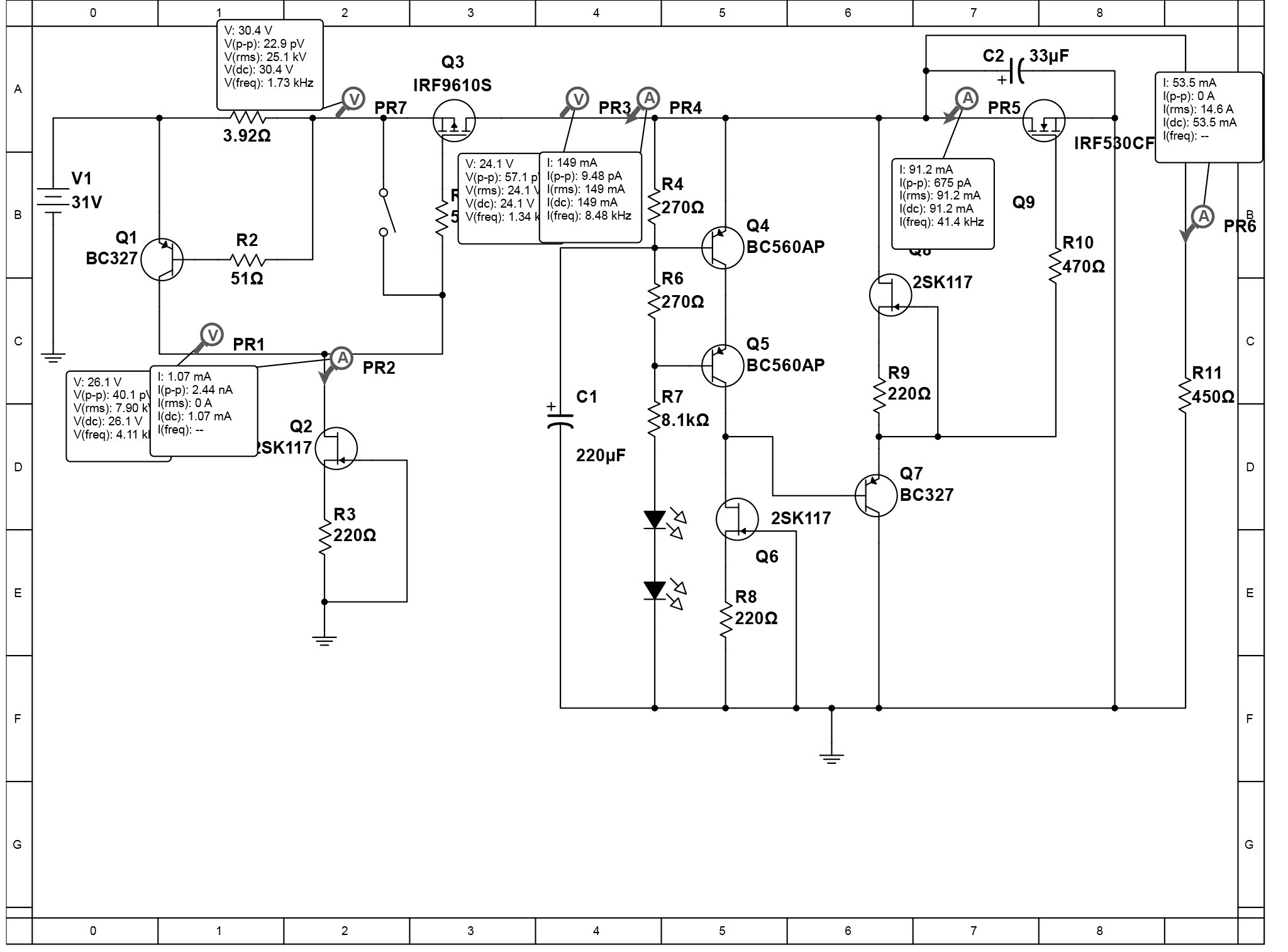

I use 4 salas ultrabib for +/-24V for my UGS muse preamp.
I would like the salas regulators to be power on when the preamp turned on or when coming trigger input signal, and to be power off in standby mode.
I don't like that when the preamplifier is in standby mode it gives heat continuously 24/7.
I don't want to disconnect the transformers (I use them and for others psu) or large charging currents before the capacitors.
Does anyone see a problem with low power latching relays to switch M1 transistor (Q3, IRF9610 on schematic) to OFF state ?
Simulations with Multisim show no problem.

Theoretically its OK to short M1's Vgs cutting off the current source as control. Better test to see practical aspects of it like if transients are created during the switch that can threaten the gate junction or any form of oscillation. So to know what to expect or solve before integrating the idea into some expensive project.

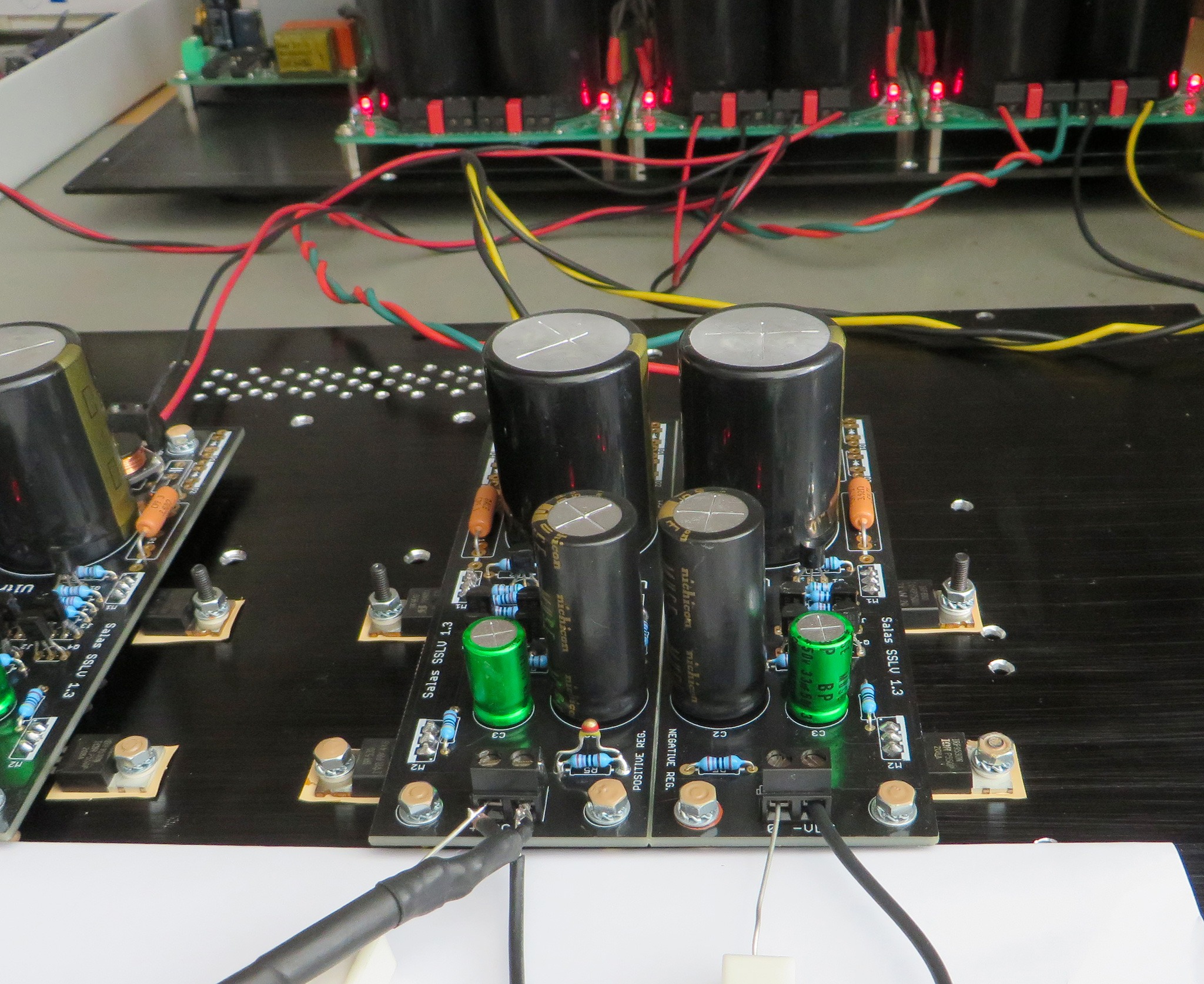

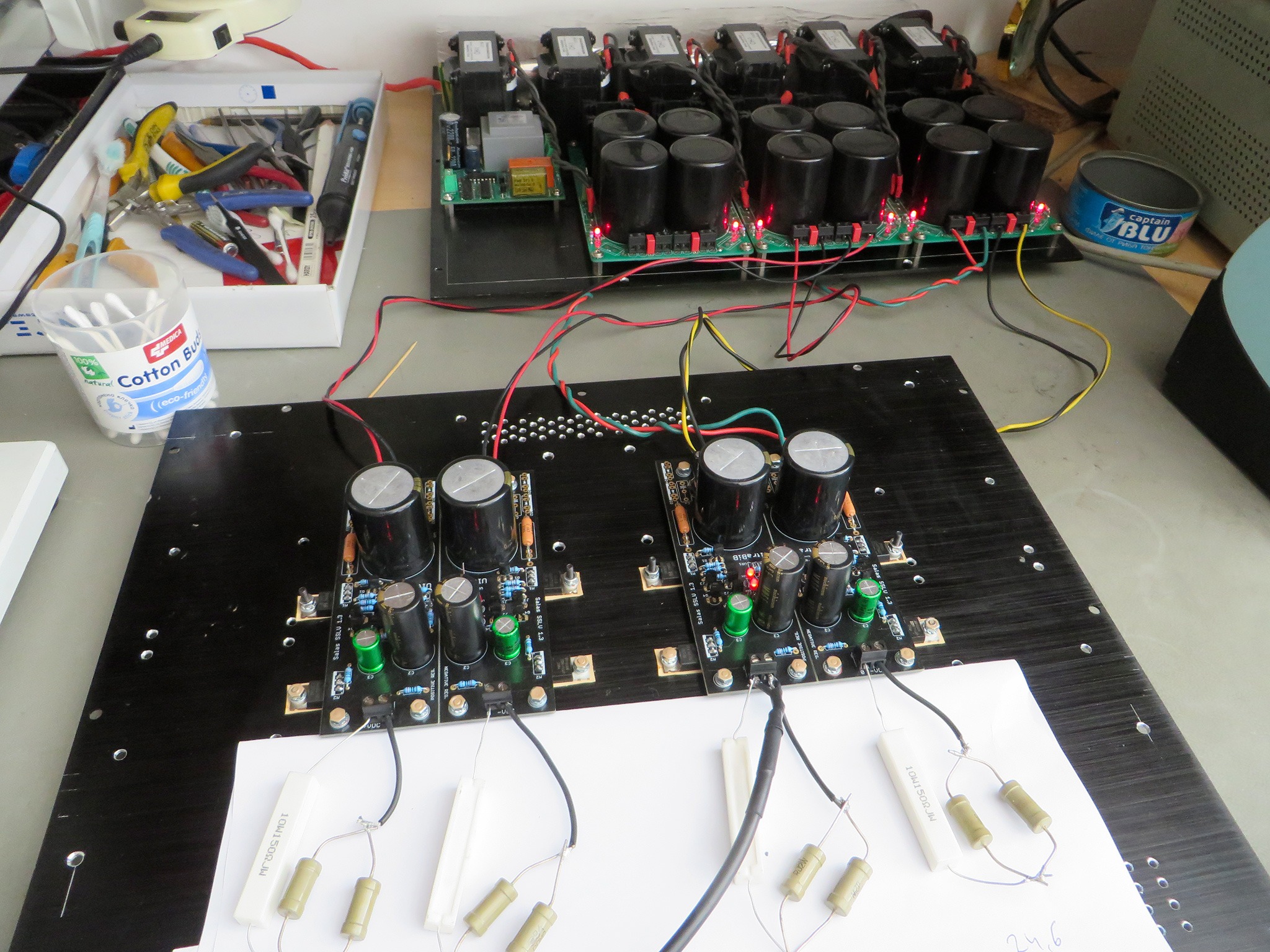

Temperature drift on my regulator:
Time between measurements 1 hour.
Vdc(T1)=24.68V
T1(air)=22°C
T1(Q2)=22°C
T1(M1)=22°C
T1(M2)=22°C
Vdc(T2)=24.01V
T2(air)=27°C
T2(Q2)=34°C
T2(M1)=38°C
T2(M2)=40°C
ΔT(Q2)=34-22=12°C (Is it correct to measure the temperature difference here?)
ΔVdc=24.68-24.01=0.67V
Total temperature coefficient of regulator: ~ 55.8mV/°C
I don't have trimmers for Vref. Metal film resistors (1%, 50ppm) only.
I assume the high drift is caused by the LEDs (KINGBRIGHT L-934ID).
Is this so?
But I chose them because of their lowest measured noise (from a one thread here).

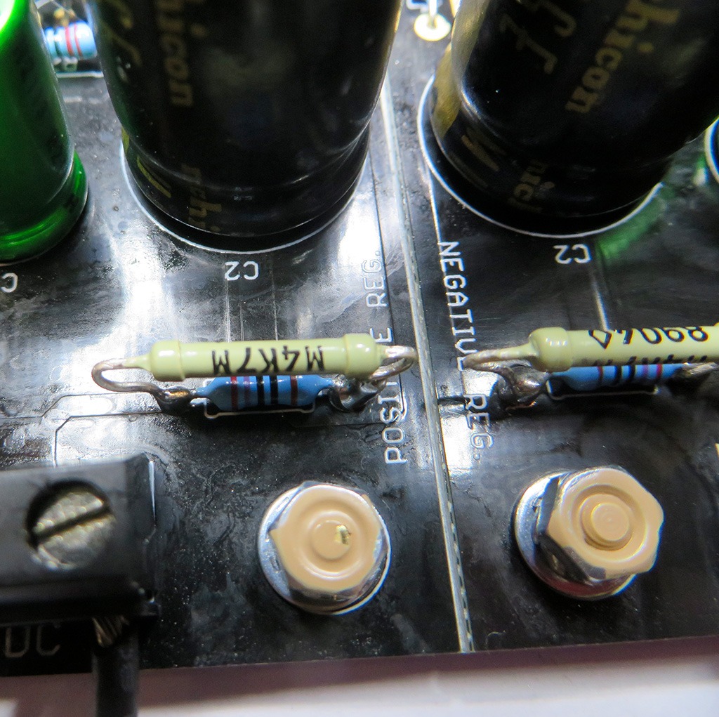

Temperature drift with Vishay NTCLE100E3472JB0 4.7K B25/85 3977K across R5 (270R).
Vdc(T1)=25.95V
T1(air)=27°C
T1(NTC)=27°C
T1(Q2)=27°C
T1(M1)=27°C
T1(M2)=27°C
Vdc(T2)=25.89V
T2(air)=28°C
T2(NTC)=34°C
T2(Q2)=34°C
T2(M1)=39°C
T2(M2)=42°C
ΔT(Q2)=34-27=7°C
ΔVdc=25.95-25.89=0.06V
Total temperature coefficient of regulator with NTC: ~ 8.6mV/°C

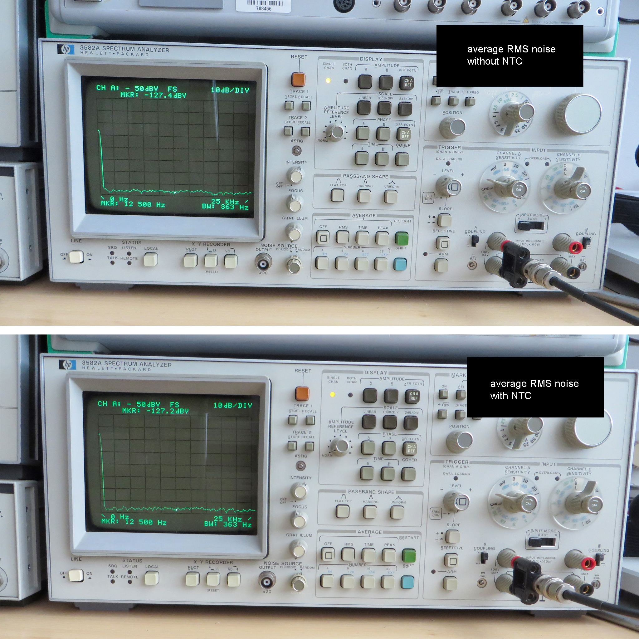

When measuring the noise (with and without NTC) no visible differences are observed.
Analyzer settings:
PASSBAND SHAPE: FLAT TOP
AVERAGE: RMS
AVERAGE NUMBER: 64

Its mainly due to Q2's negative Vbe tc. Normal drift for this reg. Not dangerous because it shrinks output instead of climbing above target. Both your tc and very low noise results are correct. Use of NTC resistor helps when you want no changes. I put R5 somewhere accessible in the layout. As Vbe applied over R5 lowers with temperature's rise the Iref drops. But the NTC resistance//R5 system drops Ω too and the Iref goes up again. You tuned your build right.
Spelling error. I mean : of cource coefficients are negative...Off source coefficients are negative....sorry.
Yes. R5 is very comfortable to work with.I put R5 somewhere accessible in the layout.
If your target was 24V and you want to avoid a trimmer you must drop the value of the I-->V resistor now a little. Because NTC 4k7//R5<270R originally.
Yes it is.
I'll fine tune the Vout (24+0.2V) tomorrow.

-127.2 dBV over 25kHz is exactly 2.2nVrtHz as Tombo's findingWhen measuring the noise (with and without NTC) no visible differences are observed.
Analyzer settings:
AVERAGE: RMS
AVERAGE NUMBER: 64

Vishay NTCLE100E3472JB0 4.7K B25/85 3977K is unsuitable !
At an ambient temperature of about 40 degrees and above, its tempco tends to dominate the tempco Q2 and the output voltage tends to slow increase.
gionag and Eric06 use NTC with B25/85 3590K. So look for those.
I dug through the my old stock from 30 years ago and found some 4K7 Russian thermistors (M4K7M) with unknown characteristics. They fit perfectly.
