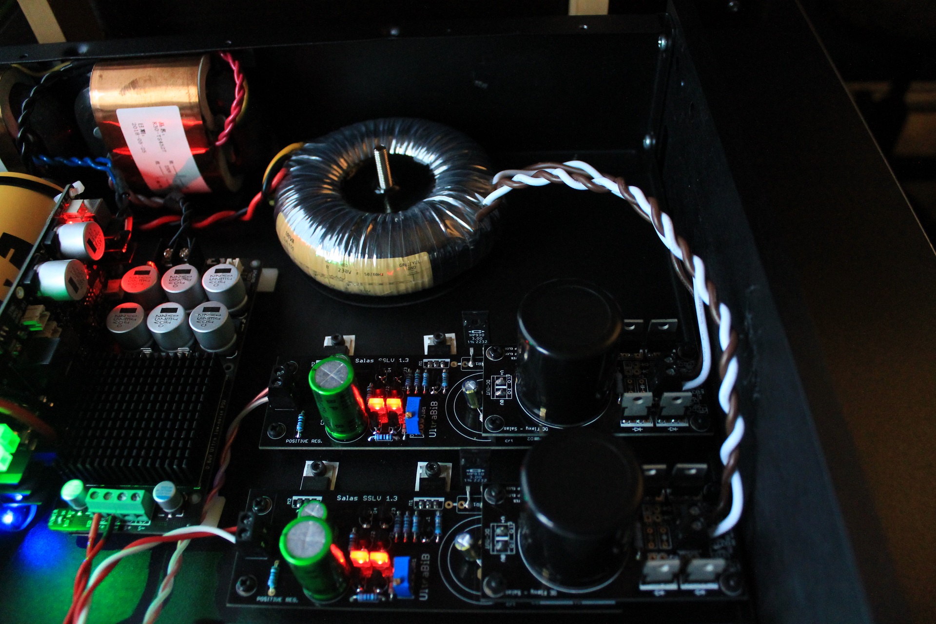

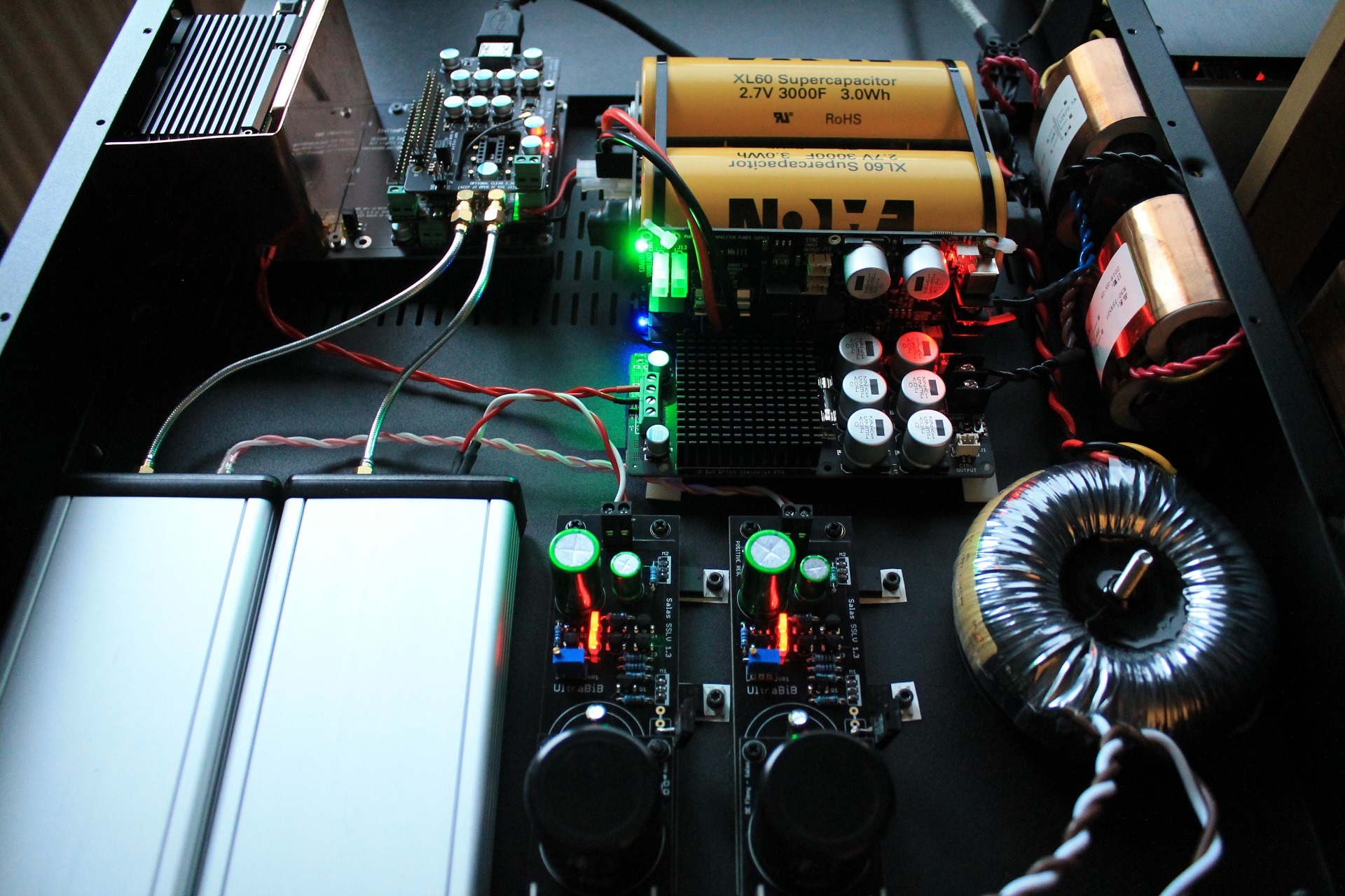

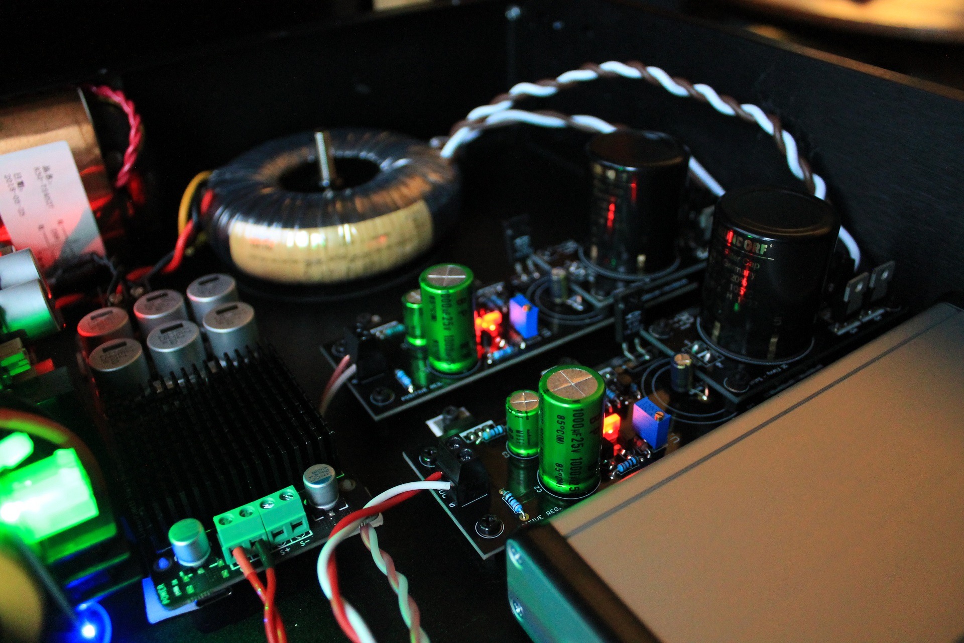

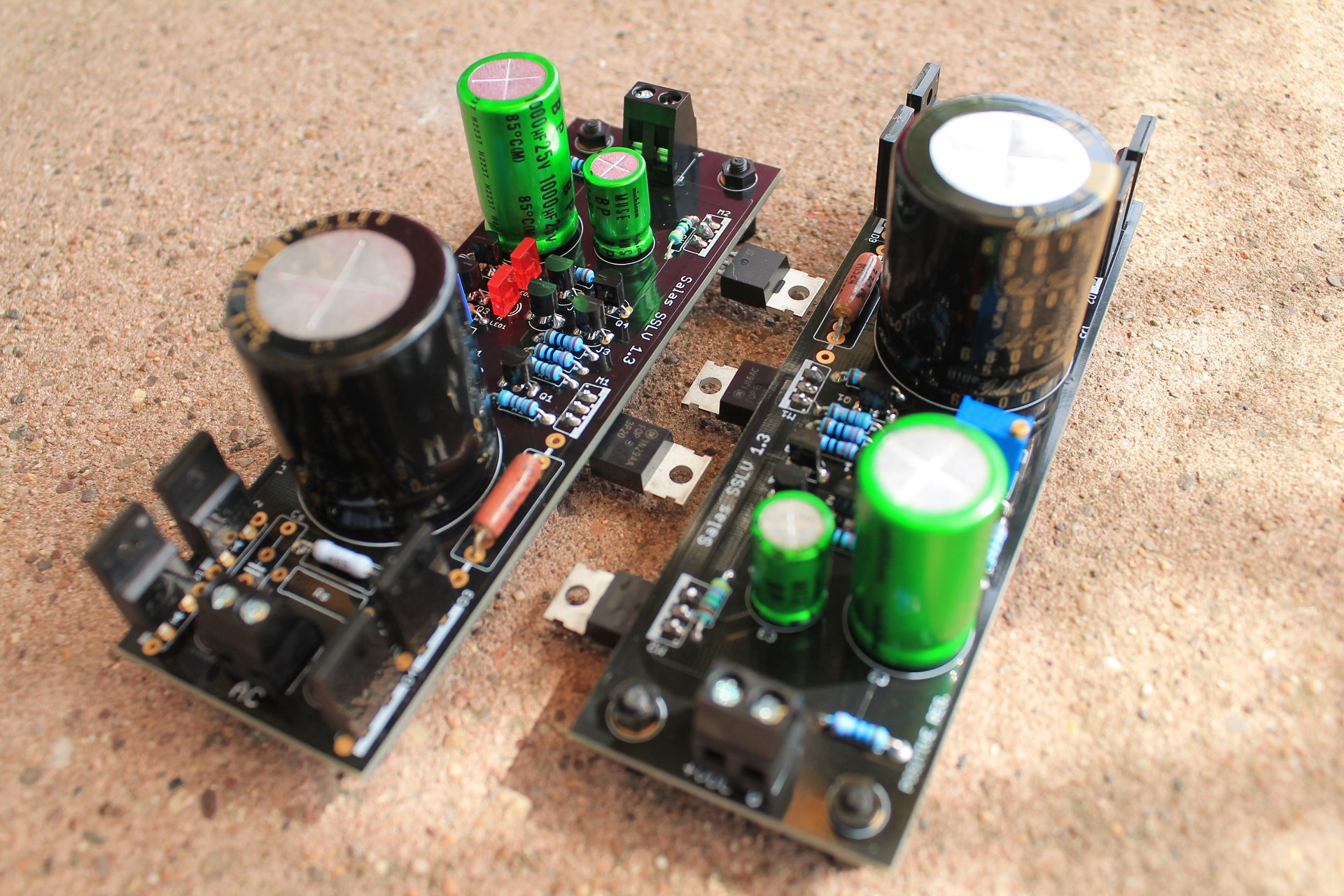

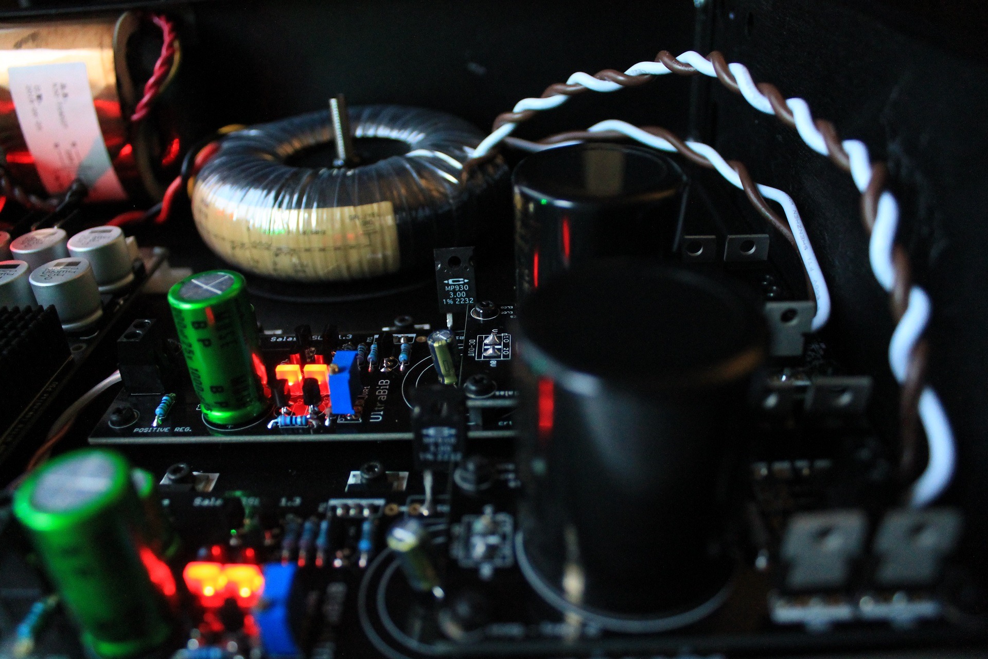

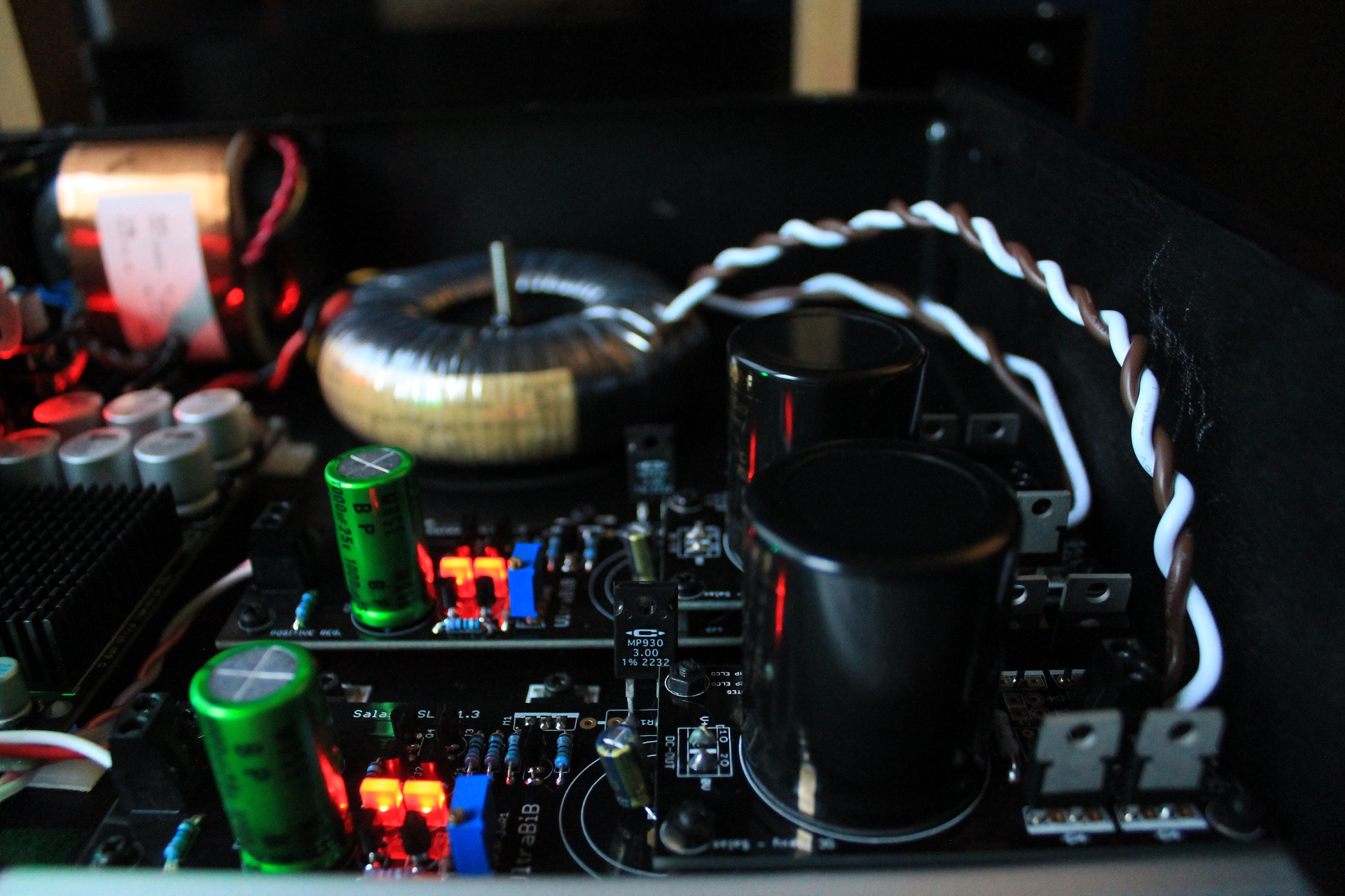

I finished the UltraBIB for my streamer clocks,tweaked with a Flexy for Use a Mundorf 4 pole capacitor,This time I used a magnificent 100VA O Core transformer from James transformer.
The UltraBIB gives a completely different dimension to my clocks,thanks Salas.
wiring is not over
The first version for my dac clocks

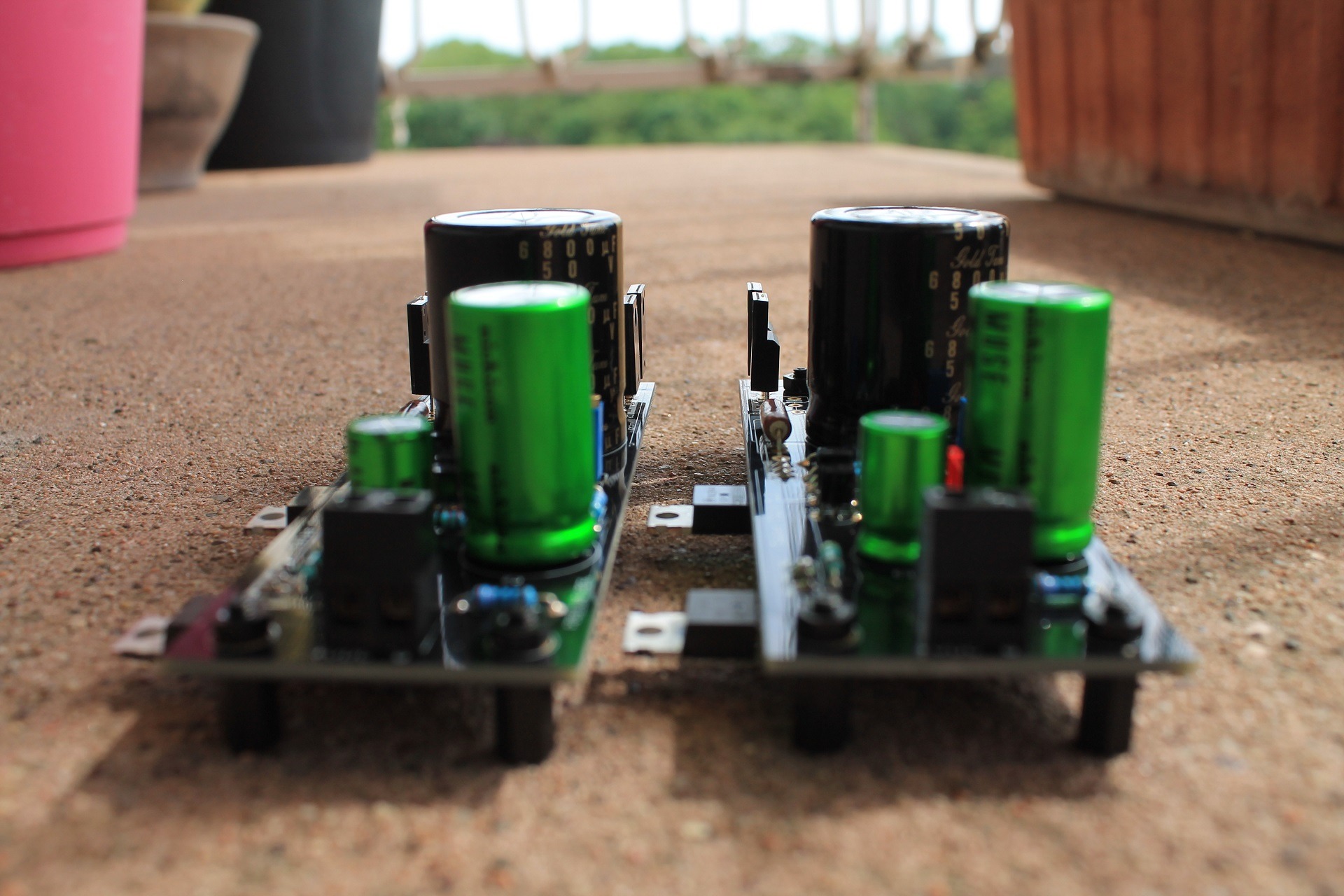

Too bad I missed this one, keep getting back to it due to dimensions (height).
If you ever do another batch or 1.4 that would be welcome!

To find out R1’s value you need to take the maximum current that your load draws(150mA in your case) to which you need to sum the spare current of the regulator(100mA). The total here is 250mA
You will need to divide 630mV to 250ma which will give you the value of R1 in ohms. In this case it will be 2.52R
R1 = 630mV / ((shunt spare current mA) + (load maximum current mA))

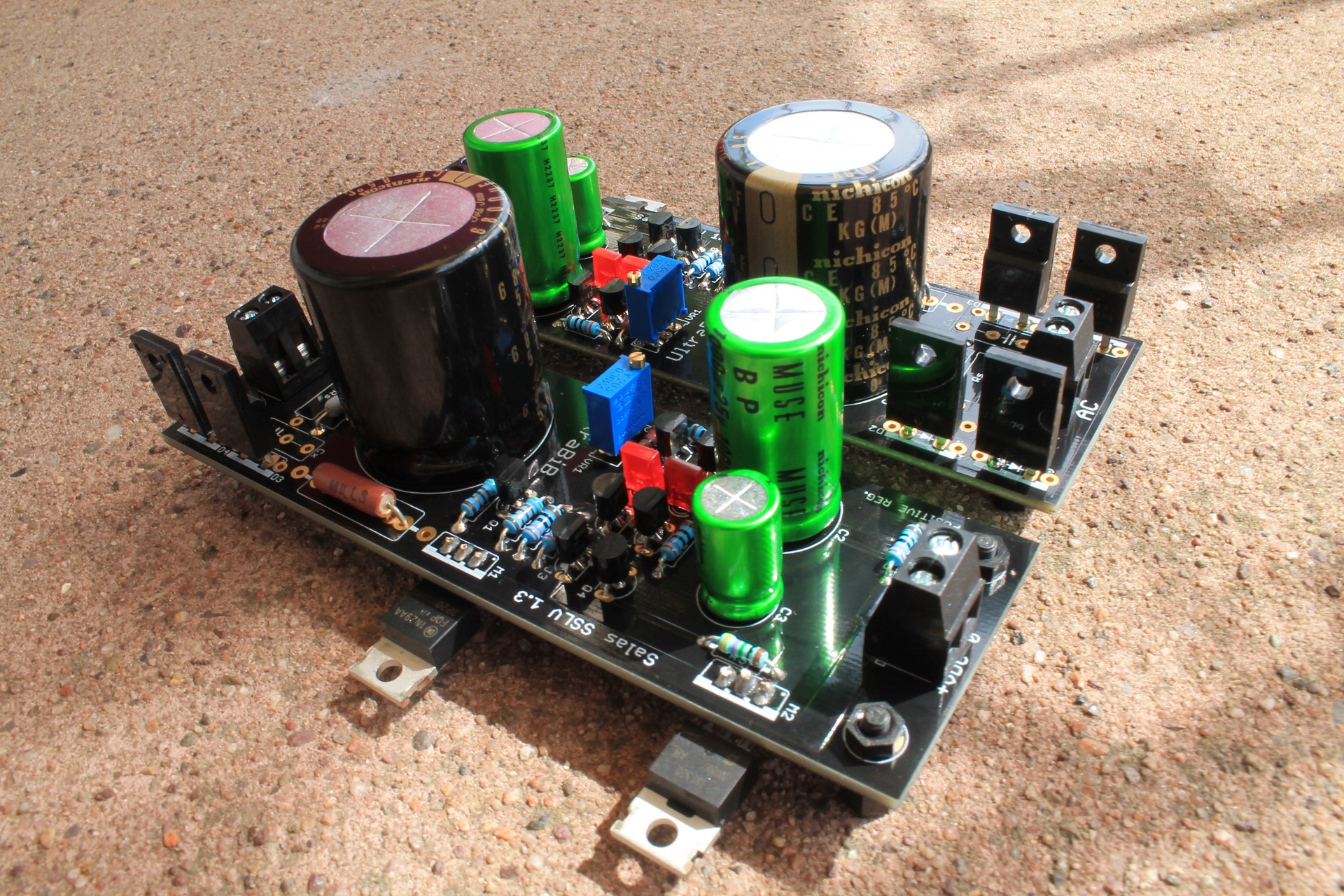

I have BlackGate capacitors 100uf25V, 47uf25v at 220uf16v
Can I put them instead of C2 in C3?
Which ones are better to put where?
What is the output voltage are you aiming for? What is your application?
For c2 bigger capacitance gives lower output noise and longer startup times. If something digital on the rails maybe you don’t want long startup times..
For c3 you have to select your cap as suggested by Salas(it needs to be in a certain impedance range 0.12-0.22r @ 100khz).
You can play around with c2 but not with c3 unless you have an oscilloscope and know what you are doing.

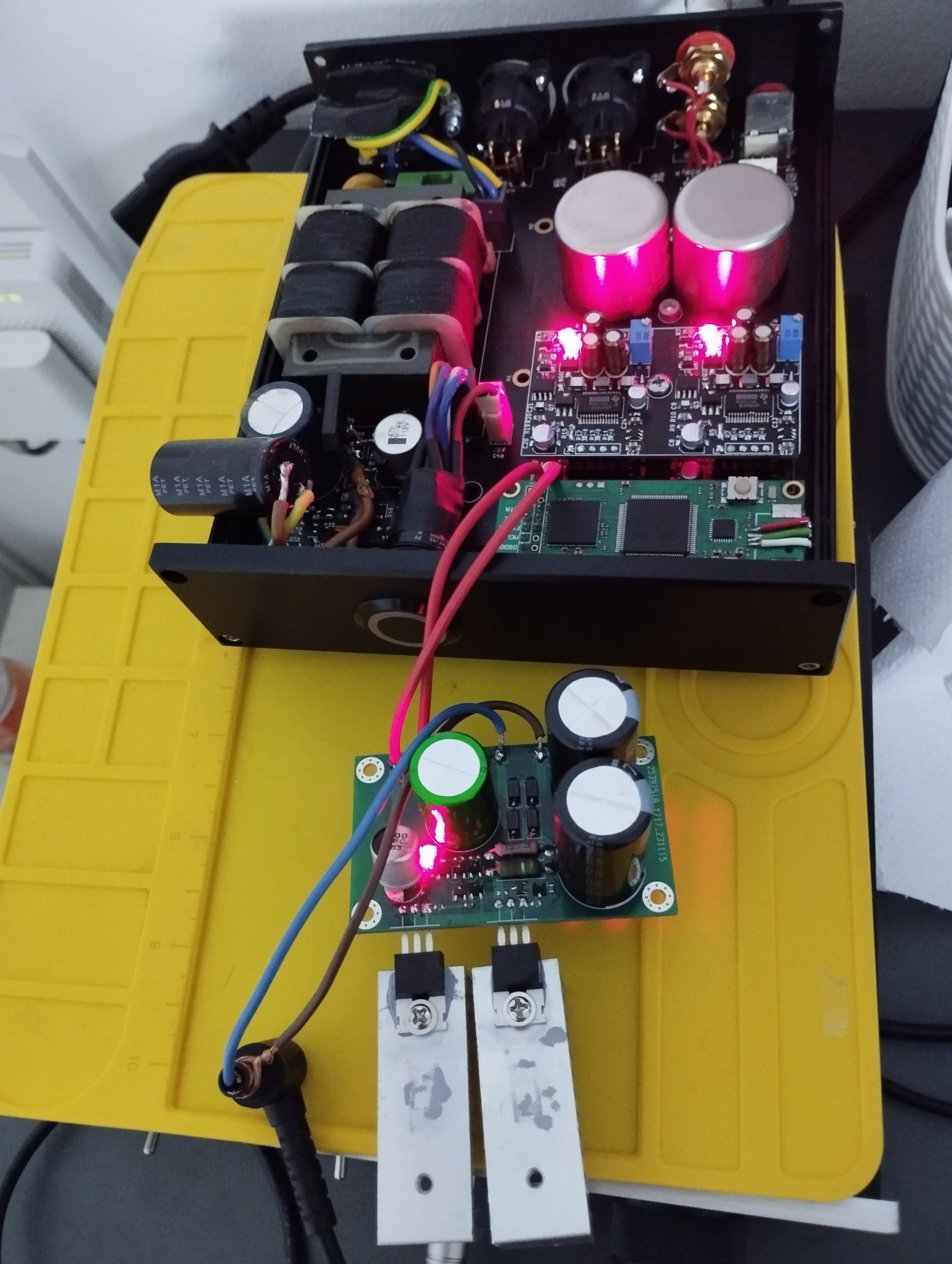

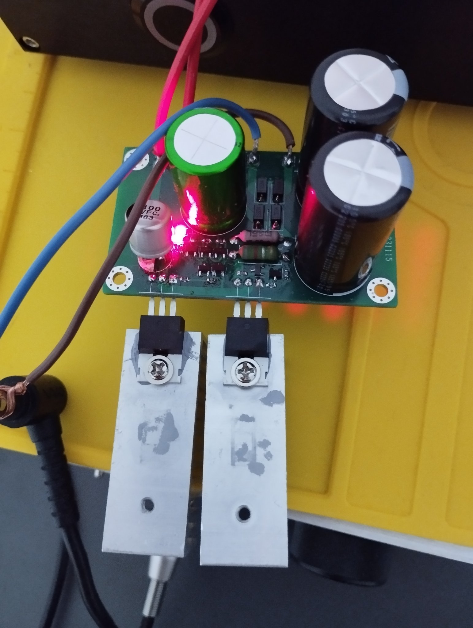

Salas I want to thank you for sharing this great regulator with us.
I made a small smd regulator pcb for my diy dac. The sound is absolutely fantastic. Better in every aspect than my current super regulator (which i maybe didn't tune very well i guess).
For now i feed it with smps wallwart, but I will buy suitable transformer soon.
19VDC smps input (will change to toroidal transformer 12VAC soon)
10,5VDC output
CCS setting-700mA
M1-IRF9610
M2-IRF530
BC859C and BC807-40 transistors
SUSUMU RG 0603 resistors 10-25ppm
2SK209-GR jfet-s for CCS-s (135R degeneration resistors, 1.8mA current)
Lite-On RED leds - will change that to HLMP-6000
C1-2x Nichicon 4700uF, 35V
C2-Nichicon ES 470uF, 35V
C3-SMD PANASONIC FC 100uF, 35V (0.15ohm ESR)
PCB is 4 layer of which 3 layers are GND. I wanted to have top and bottom layer separated by just 0.2mm
Out of 700mA CCS setting i have 500mA constant load (4 mini local shunts) 100-120mA spare current and the rest is used by digital portion
Is the ccs jfet suitable for my build? Is it not degrading the regulator performance?

@juliobozek
"2SK209-GR jfet-s for CCS-s (135R degeneration resistors, 1.8mA current)"
"Is the ccs jfet suitable for my build? Is it not degrading the regulator performance?"
-The 2SK209 is essentially a 2SK117 in SMD form. So its a good low noise Jfet suitable for the purpose.
"The sound is absolutely fantastic. Better in every aspect than my current super regulator"
- I am glad that you like it. Congratulations for your build and enjoy the music.
