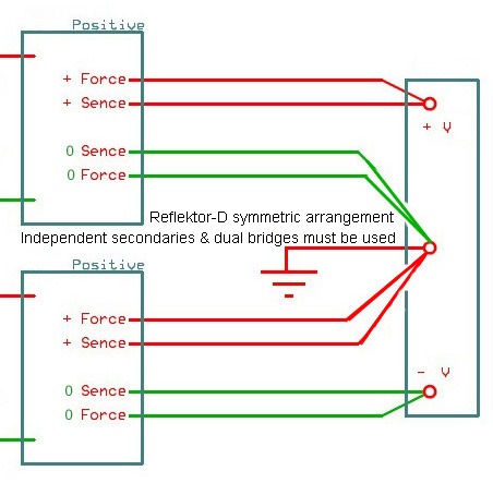

Yes if arranged with a virtual ground in a batteries like manner along with more sections or other floating power sources. See an examplle of two positives making a positive and a negative. SSLV1.3 Ubib doesn't have sense lines so ignore those you see in the example. Think of +Force 0 Force as the Ubib's +Vout 0V outputs.
