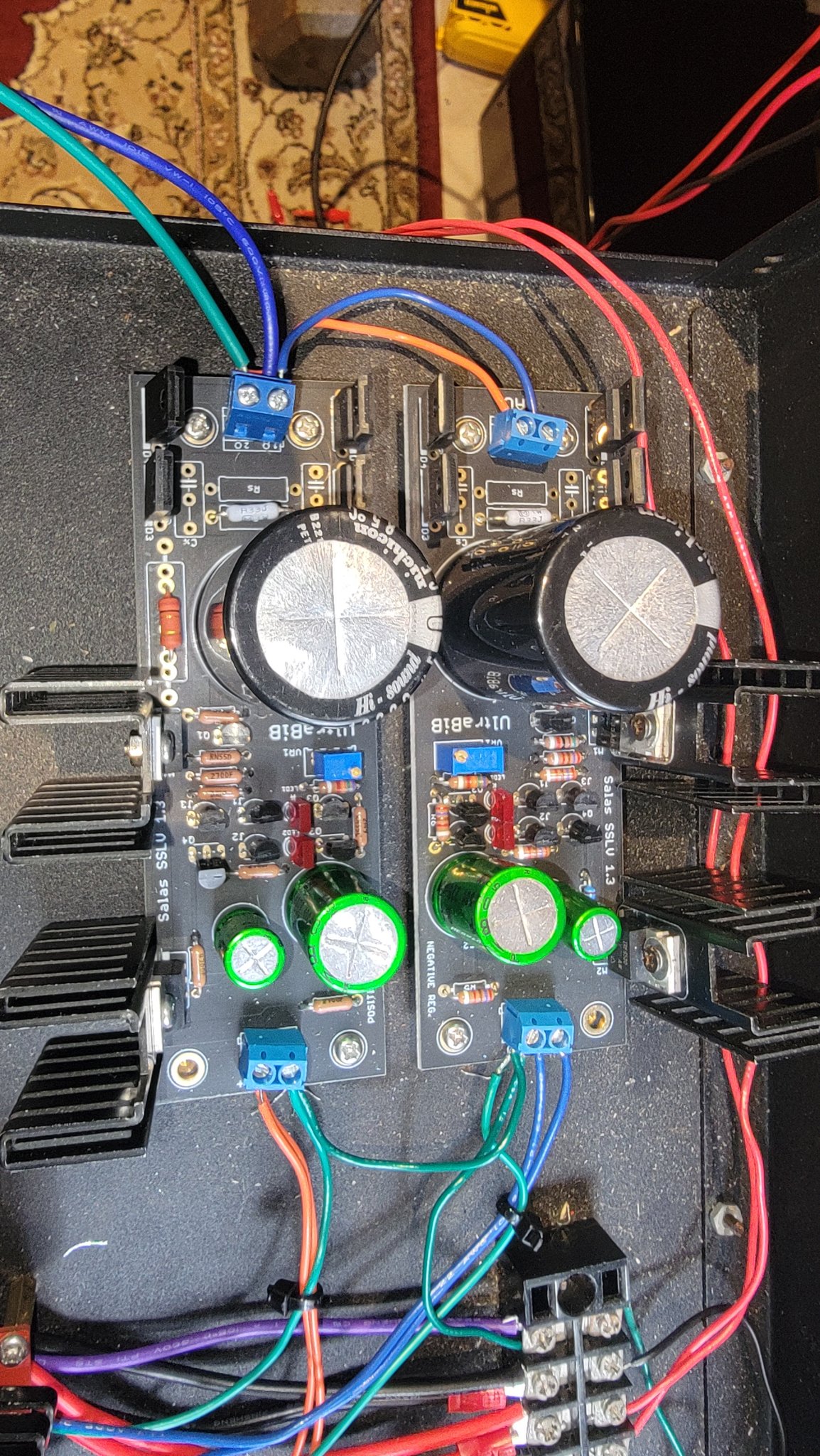

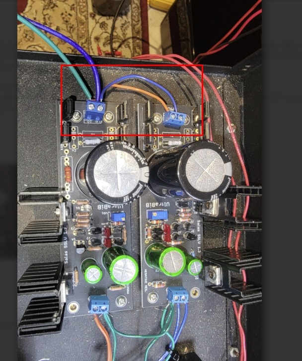

Aloha! Finished rebuilding parts of a BA-3 preamp fed by a set of Ultrabibs! I'm having a repeat issue, though; when connected to the BA-3, D1,2 on the positive board and D3,4 on the negative overheat. These are brand-new boards and components as opposed to sets from my previous post and I'm at a loss to understand why this is happening.
-The BA-3 is biased; used my DC power supply to feed it.
-Diodes do not overheat when a dummy load is placed at the DC-out (120R, 13W resistor). Output is set to 25V via dummy load.
-Grounds are tied to IEC ground.
Thanks for your help!

Fascinating! Since you asked, I put a separate winding on each reg board and that seems to have fixed it! I had asked many many moons ago if I could use one transformer for two sets of bibs and was told that wouldn't be a problem. Obviously there were some details missing...sigh.
I have one set for the BA-3 and another for a Pearl 2. Can I use one set of windings for the two pos and the other for the negs? Or will I be back at a current-overdraw situation?
I owe you beer, thank you!
