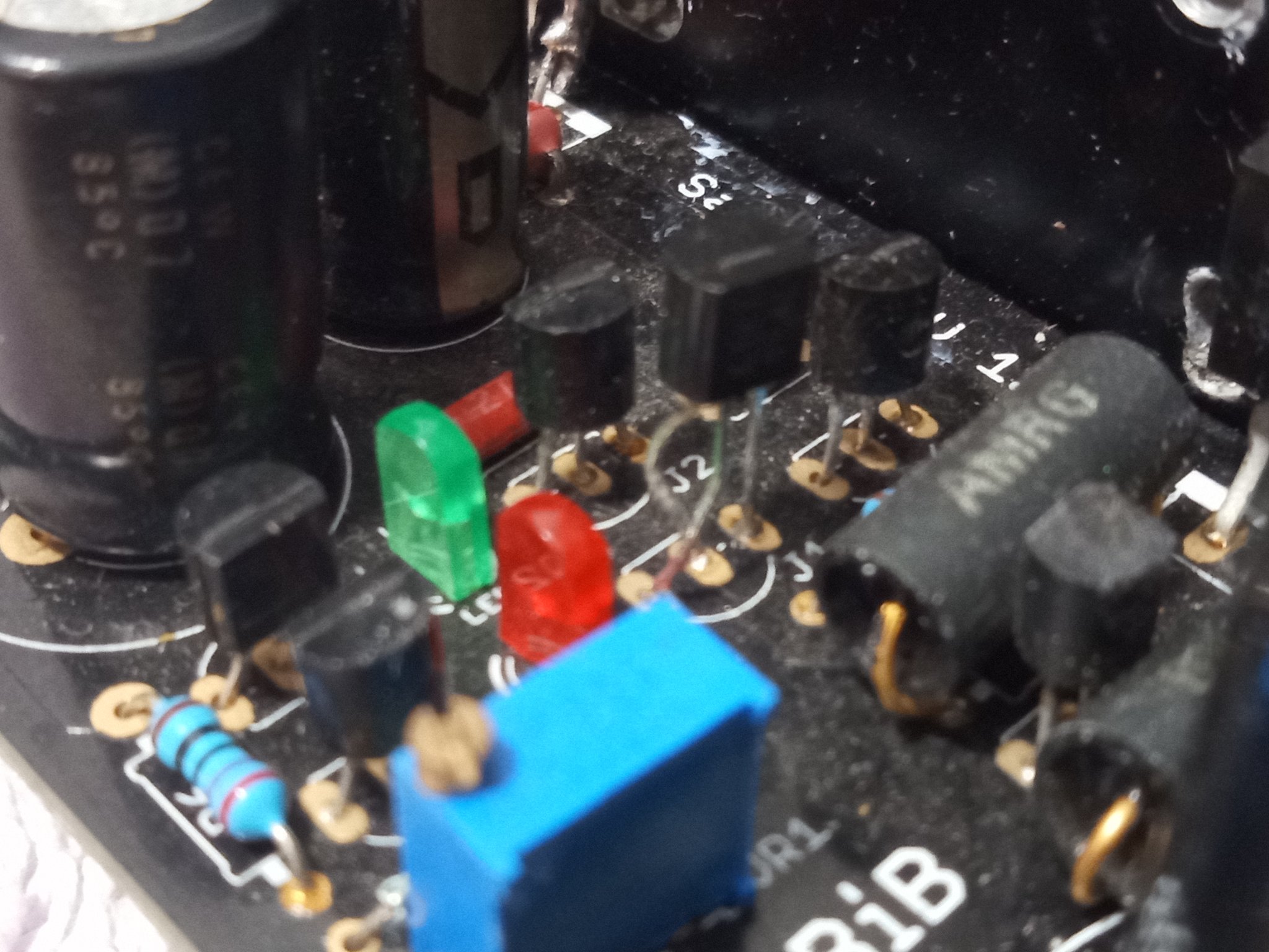

Remind me what was the situation?It’s a mod suggested by Salas.
Not enough mA of Idss at J1 and used other component with other pinoutRemind me what was the situation?
So we made some some special direct connection skipping its source resistor?Not enough mA of Idss at J1
SurelySo we made some some special direct connection skipping its source resistor?
At least your target vout has now been nearly achieved.I have some improvements even with the pot turned all the way down V is 5.2V
What is Rf's Ohmic value and Wattage? Did you use more than 0.33Ω?Rf is cooking and smelling
