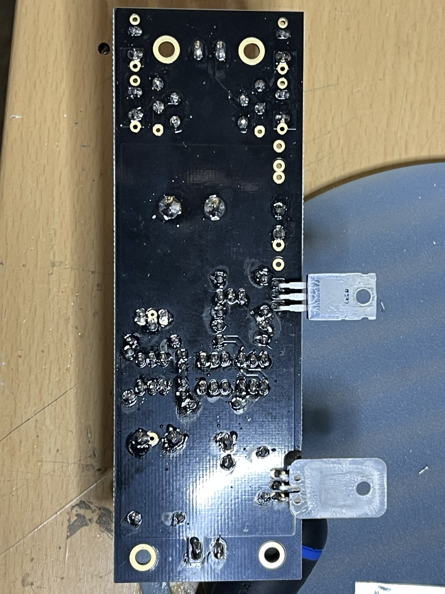

Be care for, with heatsink!I don’t have a replacement
It was a new Cadock 15W .3ohm
It measures .3 ohm in the circuit
Have you checked? How about thicker wire between reg & load?R1 must drop voltage or reg. doesn't work properly check all between the PSU and R1
Have you tested the diodes & snubber connections? Visual inspection for some solder joint smoked like a cold solder?
